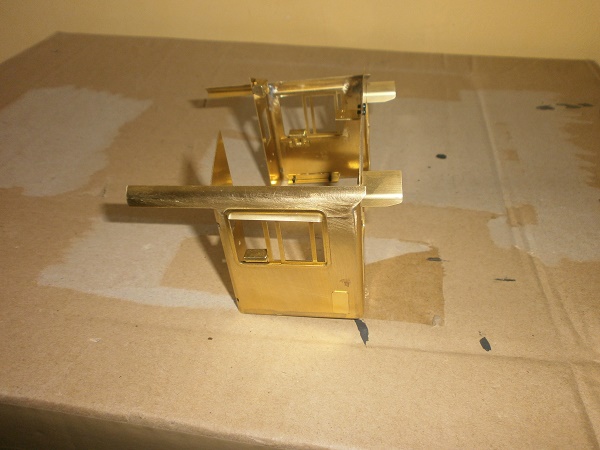

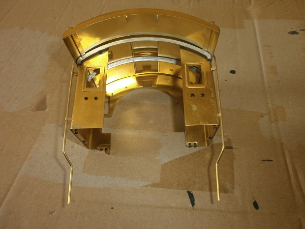

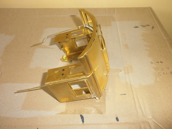

Hi Andy,
Good to see the use of soldering. Certainly the cab lends itself to the technique.
Dennis

Are you soldering with a torch or an iron? I used to do a lot of soldering at Boeing. ..Also have soldered some copper water pipes. I guess one can't mix solder and epoxy methods as heat causes epoxy to soften.
Gary
D51, Senna McLaren. Pocher Alfa Romeo 8C-2300 Monza 1931 1/8 scale. Pocher Lamborghini Aventador white roadster.Tamiya 1/12 Ferrari Enzo. Toyota GT2000.
#203 Posted : 19 May 2014 16:29:58
BigGrin Hi Dennis

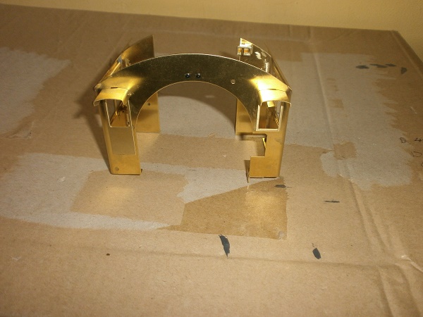

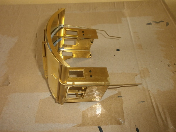

Thanks for looking in and your comments , the cab certainly needs to be soldered as a butt joint where it is will never hold with just glue in my opinion
#204 Posted : 19 May 2014 16:38:25
BigGrin Hi Gary
I used a 70 watt equivalent butane gas soldering iron that you can use a solder tip or the tip is removable so there is a flame only. For this I used the flame as I wanted to heat the metal up quickly, I put the solder on the inside and let it flow through the joint my only mistake was using to much solder but it will clean up ok with a little elbow grease.
I got the soldering iron off flea bay there is a wide choice, hope this helps

You clean up like I do but without the steal wool bit generally your right about most of the glue joints being well catered for with super glue or epoxy, it was just in this case that I felt solder was the way to go. When you see the parts Im sure you will agree and the solder helps fill the gaps here aswell

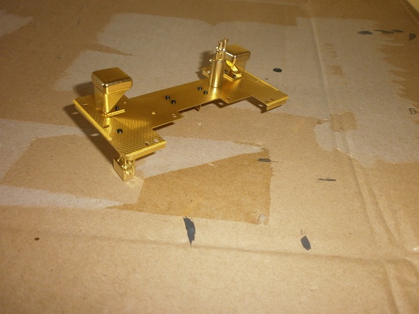

More bits for the cab and cab floor this month and a little to add to the boiler

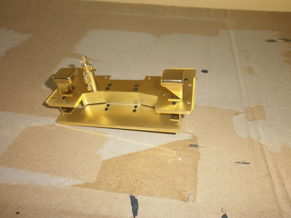

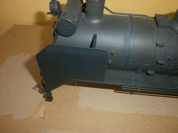

#208 Posted : 25 July 2014 15:57:09
BigGrin Hi All
More done on the D 51

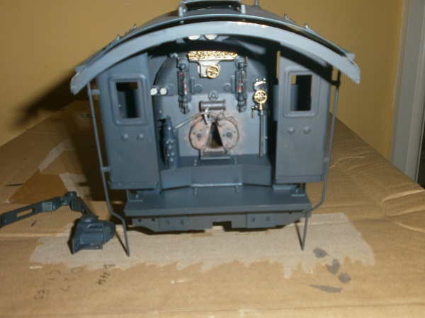

Added seat backrests, gutters, window frames, roof bars and roof with all its extra's to the upper cab. added the two plates to the lower cab floor and then made up the 1st of the smoke deflectors, painted them and added to the front right hand side.
More soon

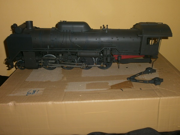

#213 Posted : 17 August 2014 19:42:05

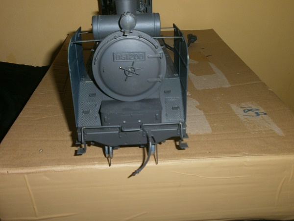

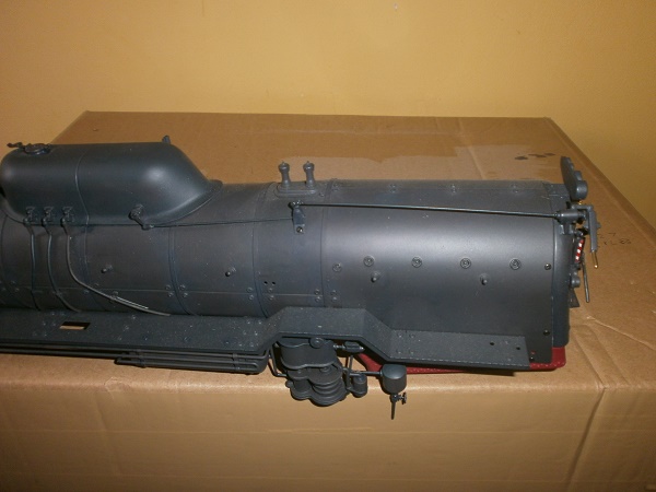

BigGrin Hi All

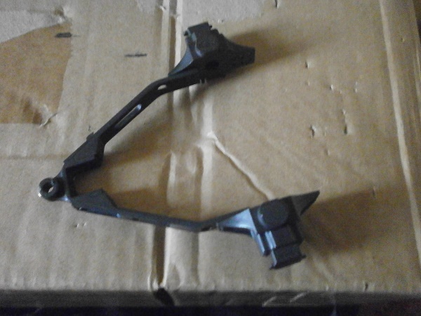

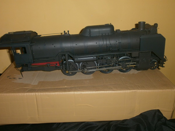

The front pony wheel frame has been added after making up and painting it as has the trailing frame for the rear wheel.
The other smoke deflector after painting has also now been added to the front of the engine.
The cab floor,cab and fire box has now been fixed in position upon the engine but the cab roof has not been permantly fixed as yet. More soon
