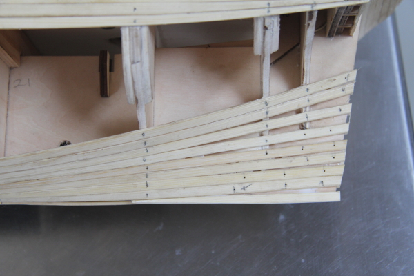

I have got as as far as row 8 on the bottom. That's all the ones that needed a 90 degree twist at the stern. The twists worked quite well with a soak in cold water then clamping round a bit of battening.
The bow is looking a bit crowded. There are still seven more planks that are supposed to terminate on the bow former. They will have to be tapered to about a millimetre at the tips, to fit them all in.

#206 Posted : 24 August 2013 22:38:21
Looking good DavidCool Cool
I think that although you could fit drop planks,because this is unsupported first planking,you will get the best shape by tapering as you say.
Kind Regards Nigel

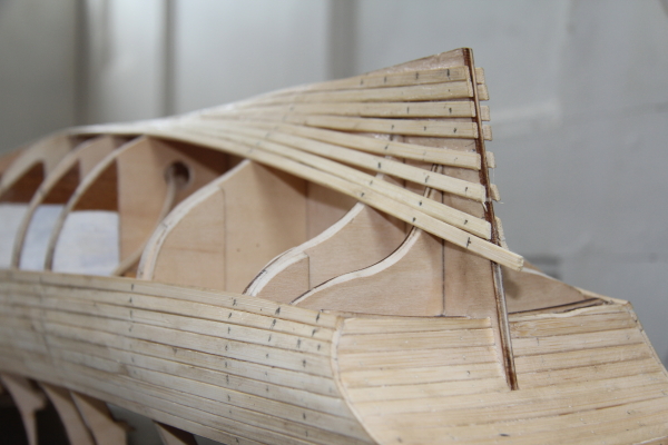

Two changes from the official instructions for the planking.
At the bow, I couldn't sand the tip of plank layer 11 to a smooth curve. So I decided to use a drop-plank method - at least, that's what I think you call it. This worked much better for me and the next plank went in easily.
At the stern infills, the instructions tell us to put in an offcut next to the bottom plank, then a tiny piece below that. I couldn't see how that little piece would glue in strongly - it has to overhang 2mm at the keel but there is barely any glueing area for it. So, I reversed the infill arrangement. Now, the bigger piece is fixed below, with a good glue joint. The little infill will go above.

#209 Posted : 30 August 2013 11:04:16
Looking good just remember not to force a plank to do something that is not natural putting stress on the plank and misshaping the plank fall. Also it's good to keep your mind on the plank two or three ahead so in your minds eye you can see how the planking will look. I may be wrong but from the pics you have shown your planking at the stern may be rising above the middle plank lay too quickly.

I was worried about the gaps between the planks at the stern. Every gap quoted was different and so, I started adding them up.
It is easy to fix them slightly out, with the twist and so on.
After 4 layers, I added up the gaps I should have, plus 5mm for each plank, then marked out for the next plank to the total depth I should have achieved.

Nicely done David and Jase gives good advice on letting the planks lay where the want to go, never force into position... also bear in mind the bamboo layer will sand down very nicely to give you the aim of a very smooth hull, all in preparation for the 2nd layer... Lovely job so far.... Cool Cool

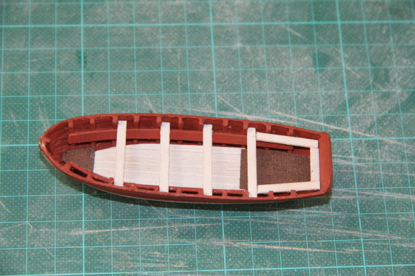

The planking has got to me a bit...
So, this is where I have got to with the launch.
The floor assembly painted and fitted.
Fore and aft gratings painted and fitted.
Thwarts etc fitted.
I painted the gratings with a Tamiya brown, rather than blackening. I am assuming that these are supposed to be hardwood gratings, so brown would be more realistic. It took two fine coats to get the brass covered, without too much filling in of the mesh. Yes, I know that I have glued the aft one in a little askew!
I have not fitted the thwarts exactly as per the instructions. I have discussed this elsewhere but I was puzzled by the positions of the oar slots - relative to the thwart benches - in the official build. The oar slots/rowlocks should be placed just in front of the rower, who will be facing aft. In the instructions, they are placed randomly, with no relationship to the seats. The way I have done it, the slots can be cut just next to the seats, without fouling a rib.
It all looks a bit messy on a blow-up photo but I think it looks OK in real scale.
