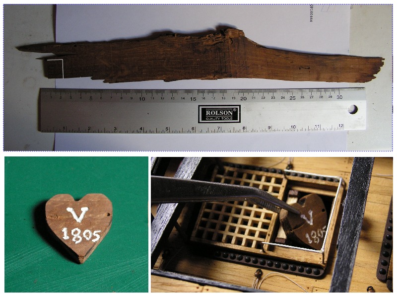

Thanks to all for the above, and you're right Sparks, in the 'old days' what we now use plastic for might have been scratch built in ivory or bone. Times and materials change, it's the final effect that counts! BigGrin
This post is a little 'personal' thing that I had been thinking about for some time. I only wish I had done it much earlier but on thinking back I didn't actually have the item below until long after I began building the main hull so I probably could'nt have done it anyway!Blink
The top photo below shows one of my 'sacred' possessions: a large chunk of the real Victory's oak! This piece is Certificate No. T/793h and is just one piece of the large quantities of 'less than pristine' wood which is removed from the Old Girl during her periodic renovations. This bit actually has worm holes going through it! As you can see in the photo, the wood is well over a foot in length and was originally a couple of inches longer still, a couple of inches longer in fact than the glass fronted frame in which I will eventually mount it together with a selection of Victory photos and text. I cut off the excess and mounted that with a single photo in a 6" x 4" frame, and that was my nephew's Christmas present sorted! Blushing
Looking at the wood again a few days ago, I suddenly thought "What if?" and that was followed shortly after by "Why not!" so here it is....
I cut off the piece of wood shown by the dotted white line, removing it didn't adversely affect the overall appearance of the main piece at all. I then cut and sanded the small square into the shape of a heart and using the dremel-ish tool engraved a 'V' and '1805' which was then in-filled with Admiralty White and sanded smooth once dry.
The last photo shows the 'Heart of Oak' going down the main steps onto the deck below. The DelPrado book of instructions shows that this lower deck is just a dummy and doesn't infact reach to the edge of the hull, once down there it was tipped sideways and dropped down into the bottom of the keel.
So that's it! Nobody can ever see it again but for as long as my model exists she'll have a 'Heart of Oak' which once belonged to the magnificent Victory herself!! Cool
These souvenir pieces of oak are still available from Portsmouth and on Ebay so if anyone else out there hasn't started or completed their hull planking, why not get a piece yourselves and incorporate it into the build. As I said, I would have loved to have glued my bit into the skeleton of the ship but I left it too late for that. They also do pieces of reclaimed copper sheathing too - now there's a thought!BigGrin
Back with some 'proper' building soon!
Robin

#203 Posted : 10 June 2013 21:50:23
That is a fantastic idea Robin and makes the model all the more special? Only thing I would have done differently, is to have written and added a little folded up note with the 'heart of oak', stating that it is a piece of genuine oak from the Victory and detailing when it was placed in the hull and by whom? That way, if the model survives you, then a future owner might understand the purpose of the little wooden heart that he found inside when he was renovating (again!) his old and weary model of the Victory that he bought at auction? Wink Wink

A lovely little touch Robin.

I was thinking of doing just that Kev, at first I was going to attach a small white plastic label to the heart with a length of thin wire but it was a little too tight to fit it down the hatch!
I will do out a little paper roll I think and slide that down inside with the heart, with that gun port box that fell inside during the build she's really starting to rattle now!!BigGrin BigGrin
Alan! Cool Cool Cool Drool Drool Drool
Those are some really great artifacts, definately top of the range! I think putting something like this inside a model build is almost like putting a 'soul' into the model and really does make them special. (Alan I want to see your DelPrado balanced on that copper rivet for it's base!!BigGrin )
Glad you liked the idea and thanks again.
Robin

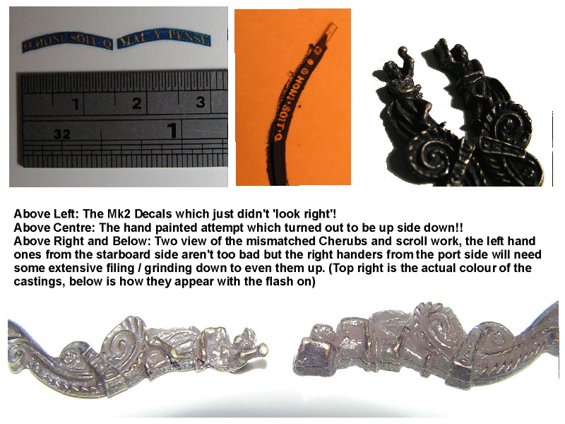

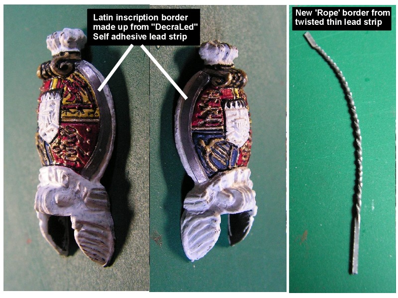

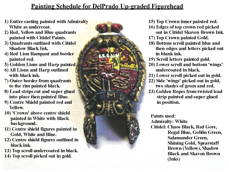

This post is the first part of the up-grading of the DelPrado figurehead, you'll see why it's the first part below! Blink
I had hoped that this little job would be simply giving it the best paint job I could manage, unfortunately the quality of the casting meant considerably more work was required than that!
The supplied figure head comes in three parts, the main central heraldic device and two 'Cherub with scrolls' for the side supports. The main casting wasn't too bad to be honest with one exception, there is supposed to be a scroll which wraps around the shield with the words "HONI SOIT QUI MAL Y PENSE", a Royal motto which reads 'Shame to him who evil thinks'. All I had on the casting was a series of curved ridges where the flat scroll should have been which meant I couldn't even attempt to paint the words in.
I decided to add the scroll over those ridges by cutting a thin strip of the self adhesive DecraLed which I had used on the cannon and rudder hinges. I say self adhesive, but my supply of this material is well over 20 years old now so it's just a bit tacky rather than sticky which actually works out really well here, it will stay in position for measuring and cutting but can be removed for painting and superglued back again!
The first photo below shows these strips 'tacked' on in place with the first stages of painting underway. On the right is an even thinner strip of the lead which has been twisted to form a 'Rope edge' to replace the non-descript edge of the casting. The 'rope' was painted with Citidel Paints "Shining Gold" and left to one side until needed.
Photo 2 is fairly self explanitory, I decided to try and create a decal for the Latin scroll with my Corel Print house and a sheet of Inkjet decal paper. On the first attempt I made two straight decals which was a mistake, they just wouldn't curve around the lead strip, even with Decal cote 1 and 2. The second try is pictured top left, this time I found out how to curve the original design on the PC and made a second pair. These did fit the scroll but I just wasn't happy with the result, it looked too artificial and didn't fit in with the rest of the effect so it was time for Plan C - try and paint the damned things by hand!
The centre pic shows the first attempt on a new length of strip and I must admit it went pretty well, that Citidel paint is specially designed for figure painting and flows really well on a tiny 000 paintbrush tip. It was only when I had completed this first half that I realised what I had done - I'd painted the flaming words upside down, they were supposed to be following the opposite curve! DOH! I thought there was no way that the lead would bend the other way without distorting the lettering so that piece was discarded and I switched to Plan D! Instead of making new strips and gluing them over the ones already on the casting I'd try and paint the words in situ. This I duly did, becoming quite light headed and seeing double at one point but the result was perfectly ledgible and not too bad at all (thank God!, I was running out of plans by this point) The result can be seen in the final photo with a complete rundown of the various stages followed.
The last two pics in the second photo show the reason why this is a two part exercise - the Cherubs (should be Cherubim I think). The starboard side one is a lovely little casting and will only require a careful paint job, as for his brother though JEEZ! Where the first Cherub has a dainty little arm and hand to hold the shield, the other casting is the complete opposite. The head and arm are just the top of an ugly thick pad of metal which is going to take a lot of grinding and filing to get it right. I've made a start with a rotary tool disc but it's a slow job which I will probably go back to just to break the monotony of other jobs and tasks so more of this part in the future.
The final photo, as I said, shows the completed Figurehead with it's added scrolls and rope edging, the painted Latin inscription can just be made out together with the ET MON part of the lower scroll, getting that to match up with the DIEU and DROIT parts which are on the Cherub scrolls will be another 'fun' task I expect!Crying
Hope you will find this useful and keep those 000 brushes clean!!Cool
Robin
PS After it was all completed I tried bending that strip with the upside down lettering on - it bent into the correct shape with no trouble at all, the words remained perfectly OK ! Cursing

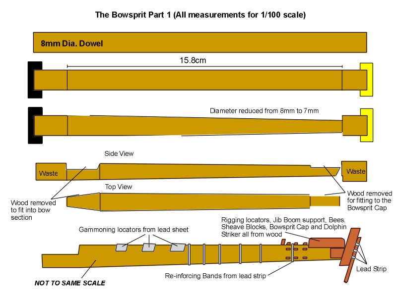

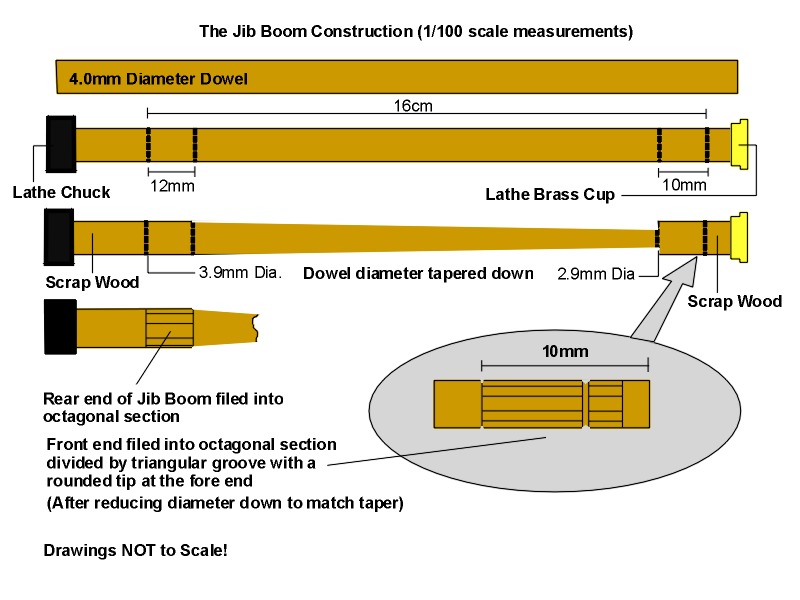

Hi to All and thanks again for the kind comments, I'm glad you are finding some useful bits in amongst my 'experiments'!Blushing
At the moment I'm working on the Bowsprit. I only really wanted to make the actual Bowsprit (the first section that runs from the bow bulkhead to the cap (the vertical joint at the tip of the bowsprit itself). I need to get this part installed so that I can rig in the gammoning ropes and finish the Marine's Walk but the design of the whole of the Bowsprit means that it would be more difficult to build the Jib Boom and the Flying Jib Boom once the Bowsprit is in position than it would to do it all in one go, but leaving the two Jibs to glue in later. (I could do the whole thing now, but that's a hell of a long piece of 'snappy off' wood to have poking out when I will be needing to swing the whole hull around to work on each side of her!!)Crying
I've nearly completed it now but still have to put the diary photos together so here's a couple of 'pretty pictures' (just for Hans) to illustrate the main points. 'Proper' pics to follow shortly!
(I just like putting graphics together really!Blushing )
Robin
