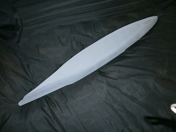

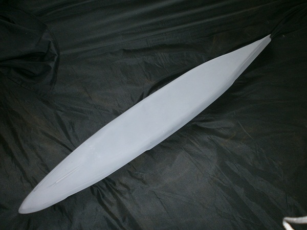

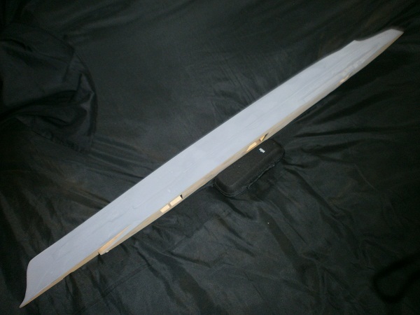

got a couple of coats of undrcoat on her now,think i might have thinned the paint down too much but its undercoat so not a major problem.As always all coments and questions are welcome

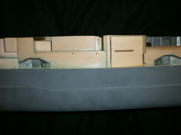

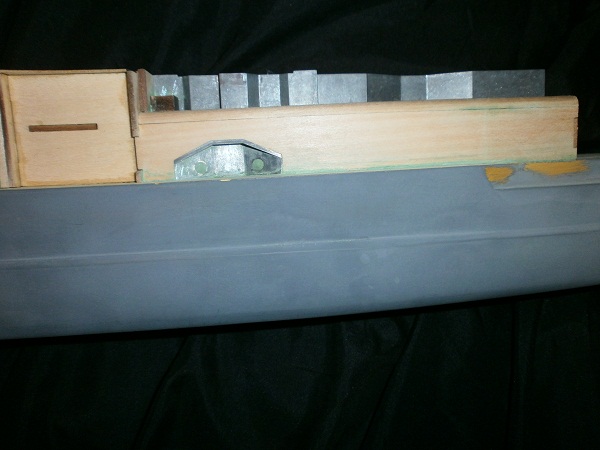

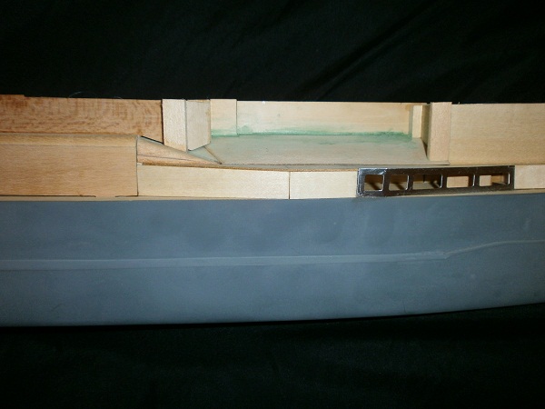

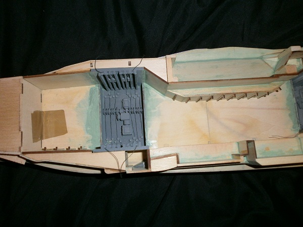

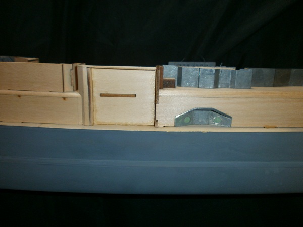

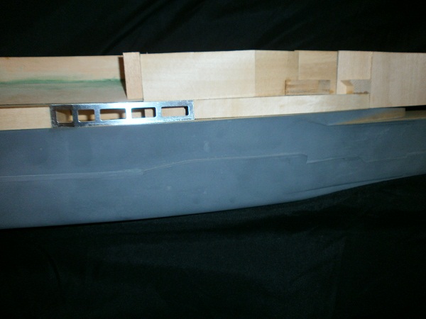

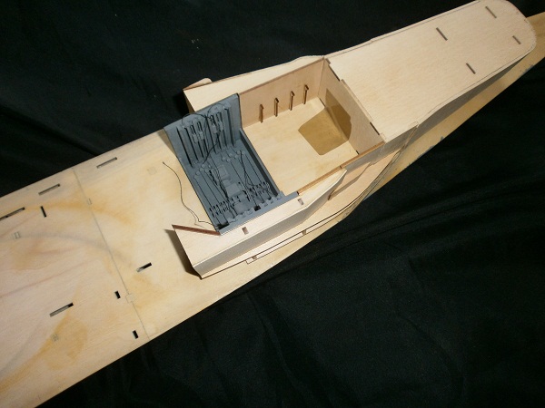

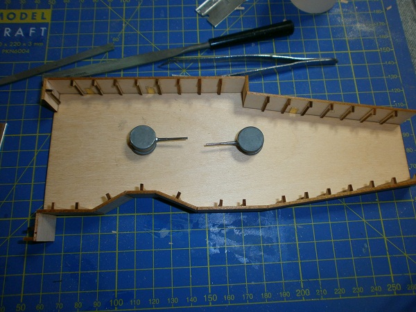

started attaching the hangars, no serious problems were encountered here just some small alterations to get the tabs to fit in the hull.Like Mr T i chose to assemble the starbourd side in situ straight to the hull. I also didnt cut the side panel into 3 parts as per the instructions but scored the back and bent the panel to shape.As always all comment/questions are welcome

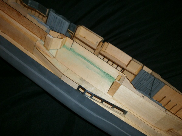

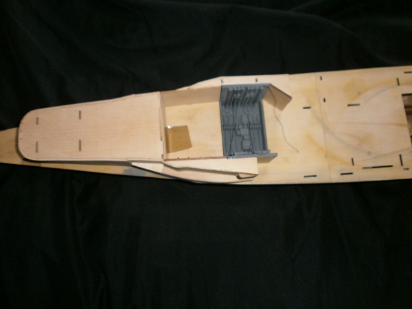

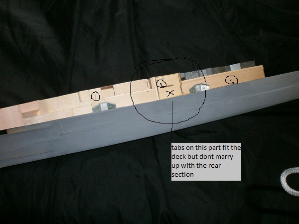

#211 Posted : 26 August 2012 11:49:40
BigGrin Hi All

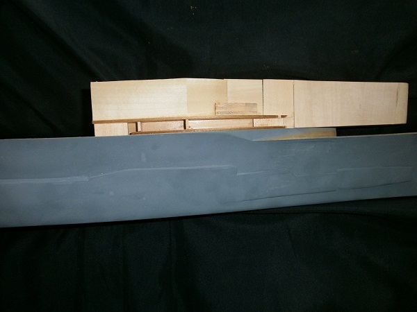

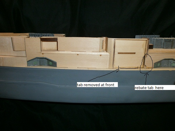

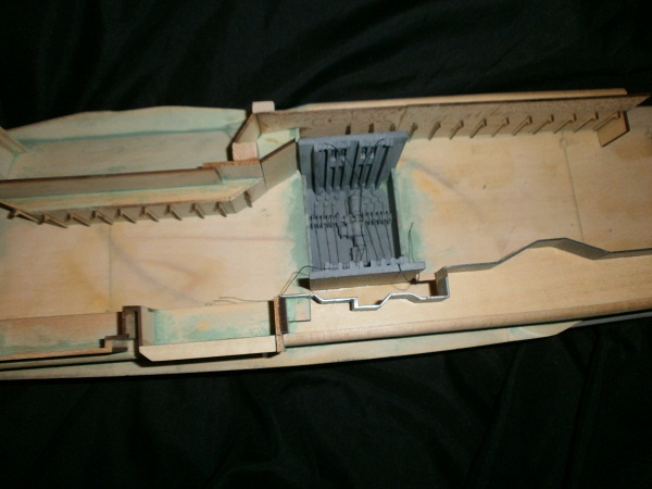

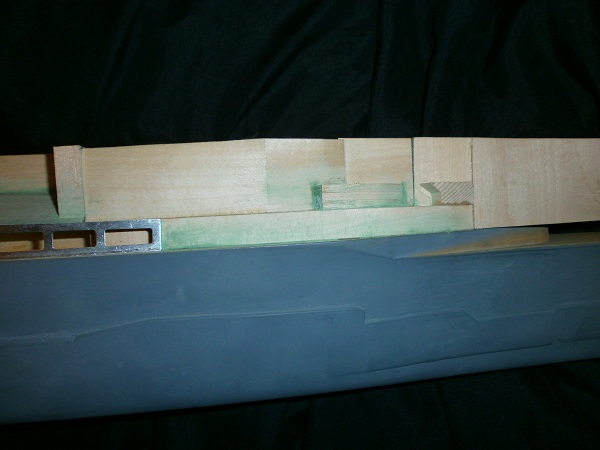

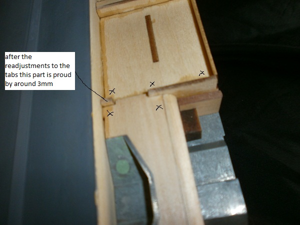

some more pics of the hangar section atachments,as Karl pointed out earlyer the tabs on the various sections dont always fit together correctly so i had some problems here.
The section marked as 1 in the pics fits the deck holes for the tabs if the tabs are shortened slightly.
The part numbered 2 is set too far back by about 3mm if you use the tabs in the deck.
Part 3 will not fit where it should if part 2 is not corectly relocated.

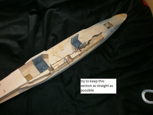

Heres my solution to the fitting of these components,parts no 1 and no 3 will fit fine in the deck slots if the tabs are shortened a little,its part no 2 that needs some relocating[ note parts 1 and 2 should run in as straight a line as possible to each other].with part 2 i compleatly removed the middle tab that faces outwards and trimed back the two side tabs untill i got the alignment i wanted this gets pieces 1 and 2 in there corect positions.Now part 3 has a tab that fits in to part 2 that should make them both flush with each other but because of the relocating of part 2 the tab slot needs to be rebated another 3mm to fit it,this leaves parts 2 and 3 being slightly proud of each other but it keeps the overall alignment of the sections.I may decide to add a fillet of wood here when it comes to the finishing of the hangar decks,also the use of filler and inserts to fill gaps will be done later,hope this helps and as ussaul all comment/questions are welcome

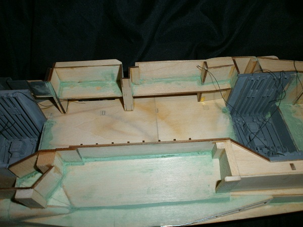

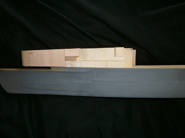

A few more pics of progress on the hangars,iv got about as far as i can with the hangars untill i get the final lift parts then i can compleat this stage.No real problems with this side just some moving inwards by half a tab to get a better fit and some of the parts leave some large gaps for mr filler to rectify later on.As ussual all comment and questions are welcome

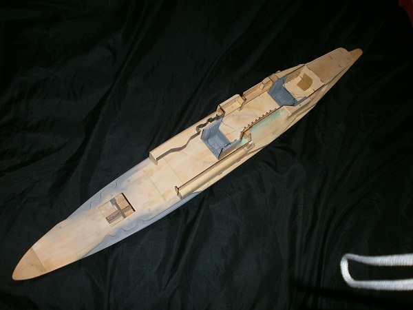

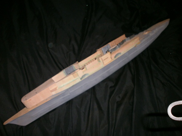

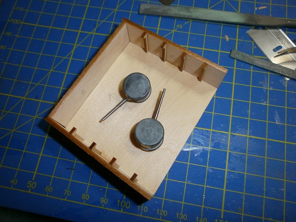

Mr filler came out on the hangar sections today so whilst that went off i constructed the 3 internal hangar trays and made up the 6 hull anti aircraft guns.I still have some things to do but i have now more or less caught up with pack 14 due next month.I will post more pics of the hull after the fillers taken back,as always all questions comments are welcome

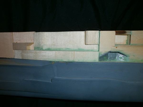

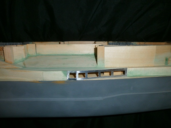

BigGrin Hi All

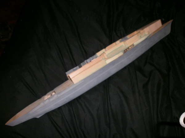

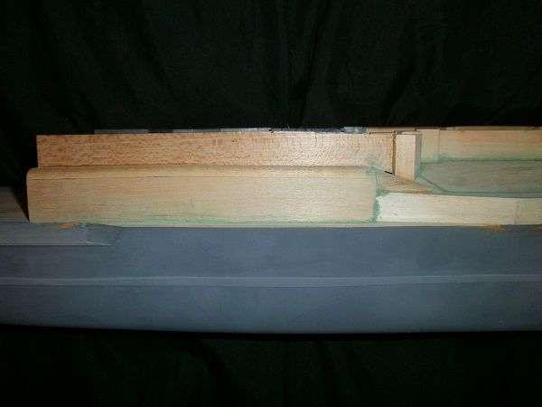

As promised a few more pics of progress with the filling and sanding of the hangars[note this is the first fill and sand back still more work to be done here].As karl mentioned earlyer its a bit of a lottery trying to get all the parts in there correct locations and keepimg any gaps to a minimum,luckily i managed quite well to get them together with the minimum of gaps so all that was needed was a small amount of filler to rectify things.Initial impresions after the 1st filling sanding is that shes starting to come together nicely.As always all questions and comments are most welcome
