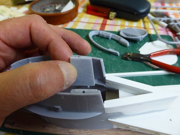

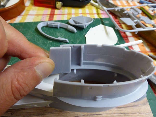

I then removed the conning tower deck and proceeded to fit two part-works supplied pieces that make up the interior profile. The attached photo shows where the port side section will be fitted. Sticky Wickett attached the following image(s): Completed projects: 1/43 scale Bedford HA van / 1/43 scale MG TD sports car Current projects: 1/48 scale U-boat [U230] Future projects: 1/148 scale railway diorama / 1/50 scale R/C Volvo F89 logging truck / 1/148 scale Thunderbirds Fireflash

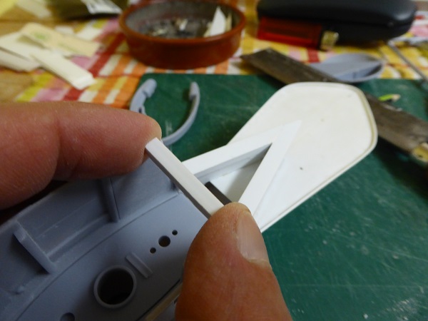

The starboard section being fitted. Sticky Wickett attached the following image(s): Completed projects: 1/43 scale Bedford HA van / 1/43 scale MG TD sports car Current projects: 1/48 scale U-boat [U230] Future projects: 1/148 scale railway diorama / 1/50 scale R/C Volvo F89 logging truck / 1/148 scale Thunderbirds Fireflash
 Rank: Super-Elite        Groups: Registered
Joined: 20/10/2016 Posts: 4,504 Points: 13,548 Location: Wiltshire

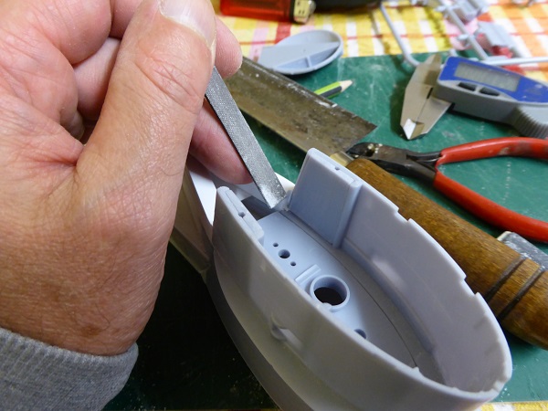

I then glued in place the conning tower main deck as mentioned before and filed the corners of the square strip, as seen here, to allow for supports to be added. Sticky Wickett attached the following image(s): Completed projects: 1/43 scale Bedford HA van / 1/43 scale MG TD sports car Current projects: 1/48 scale U-boat [U230] Future projects: 1/148 scale railway diorama / 1/50 scale R/C Volvo F89 logging truck / 1/148 scale Thunderbirds Fireflash

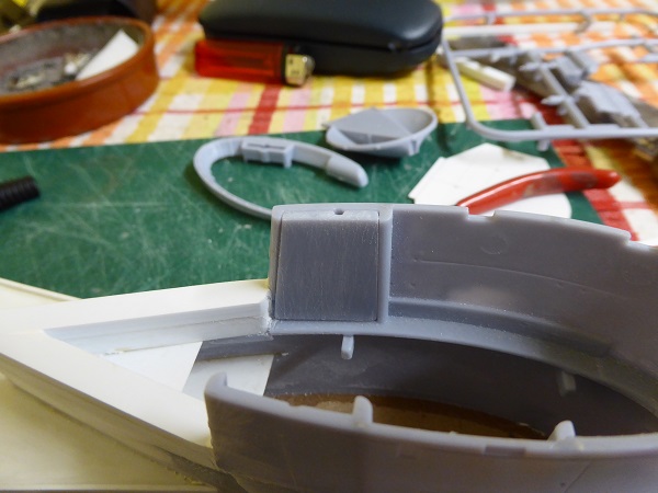

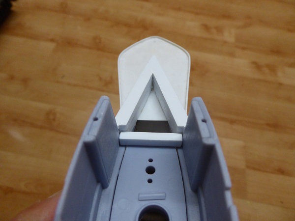

The attached photo shows the first of two supports I made that act to 'blank off' the void in the vee sections of the upper and lower decks. These supports also double up as a 'step-down' into the main conning tower deck as per U995 and provide support for the upper deck. Sticky Wickett attached the following image(s): Completed projects: 1/43 scale Bedford HA van / 1/43 scale MG TD sports car Current projects: 1/48 scale U-boat [U230] Future projects: 1/148 scale railway diorama / 1/50 scale R/C Volvo F89 logging truck / 1/148 scale Thunderbirds Fireflash

First support piece fitted. Sticky Wickett attached the following image(s): Completed projects: 1/43 scale Bedford HA van / 1/43 scale MG TD sports car Current projects: 1/48 scale U-boat [U230] Future projects: 1/148 scale railway diorama / 1/50 scale R/C Volvo F89 logging truck / 1/148 scale Thunderbirds Fireflash

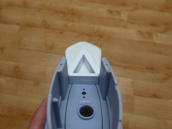

I then spent a bit of time adding filler to any gaps and sanding all of these parts true. During this time I also glued in place the upper deck and left it overnight to cure. The next step, as seen in the attached photo was to mark out where the tapered profile that sits underneath the upper deck will locate and fit additional strengthening strips. Sticky Wickett attached the following image(s): Completed projects: 1/43 scale Bedford HA van / 1/43 scale MG TD sports car Current projects: 1/48 scale U-boat [U230] Future projects: 1/148 scale railway diorama / 1/50 scale R/C Volvo F89 logging truck / 1/148 scale Thunderbirds Fireflash

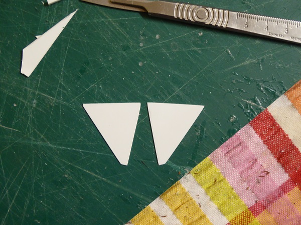

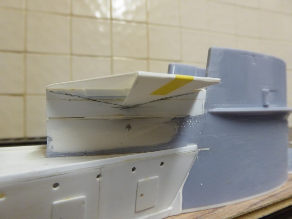

The next job was to make the first two tapered sections that connect the upper deck to the main conning tower body. The attached photo shows these two pieces cut out. Sticky Wickett attached the following image(s): Completed projects: 1/43 scale Bedford HA van / 1/43 scale MG TD sports car Current projects: 1/48 scale U-boat [U230] Future projects: 1/148 scale railway diorama / 1/50 scale R/C Volvo F89 logging truck / 1/148 scale Thunderbirds Fireflash

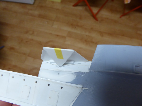

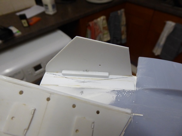

The attached photo shows the first tapered section on the port side. I taped it in place to ensure the correct location and added small beads of glue to fix it. Sticky Wickett attached the following image(s): Completed projects: 1/43 scale Bedford HA van / 1/43 scale MG TD sports car Current projects: 1/48 scale U-boat [U230] Future projects: 1/148 scale railway diorama / 1/50 scale R/C Volvo F89 logging truck / 1/148 scale Thunderbirds Fireflash

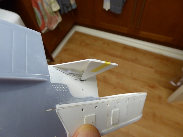

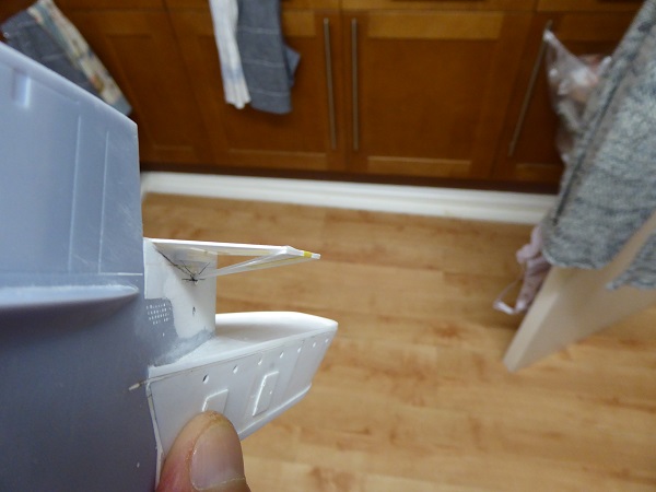

Starboard side tapered section, taped and glued in place. Sticky Wickett attached the following image(s): Completed projects: 1/43 scale Bedford HA van / 1/43 scale MG TD sports car Current projects: 1/48 scale U-boat [U230] Future projects: 1/148 scale railway diorama / 1/50 scale R/C Volvo F89 logging truck / 1/148 scale Thunderbirds Fireflash

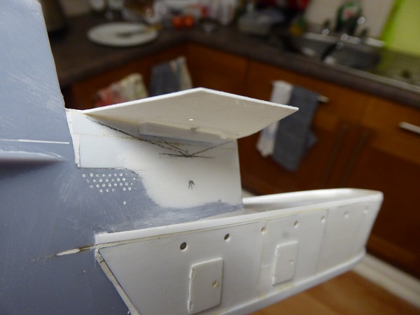

Starboard tapered section from another angle. Sticky Wickett attached the following image(s): Completed projects: 1/43 scale Bedford HA van / 1/43 scale MG TD sports car Current projects: 1/48 scale U-boat [U230] Future projects: 1/148 scale railway diorama / 1/50 scale R/C Volvo F89 logging truck / 1/148 scale Thunderbirds Fireflash

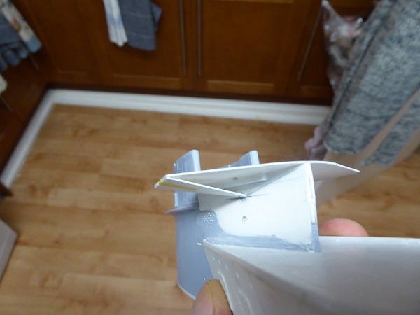

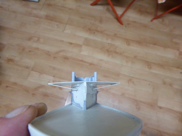

Rear view of the conning tower showing the first two tapered sections in place. Before i remove the tape I will add further supports to strengthen these pieces. Sticky Wickett attached the following image(s): Completed projects: 1/43 scale Bedford HA van / 1/43 scale MG TD sports car Current projects: 1/48 scale U-boat [U230] Future projects: 1/148 scale railway diorama / 1/50 scale R/C Volvo F89 logging truck / 1/148 scale Thunderbirds Fireflash
