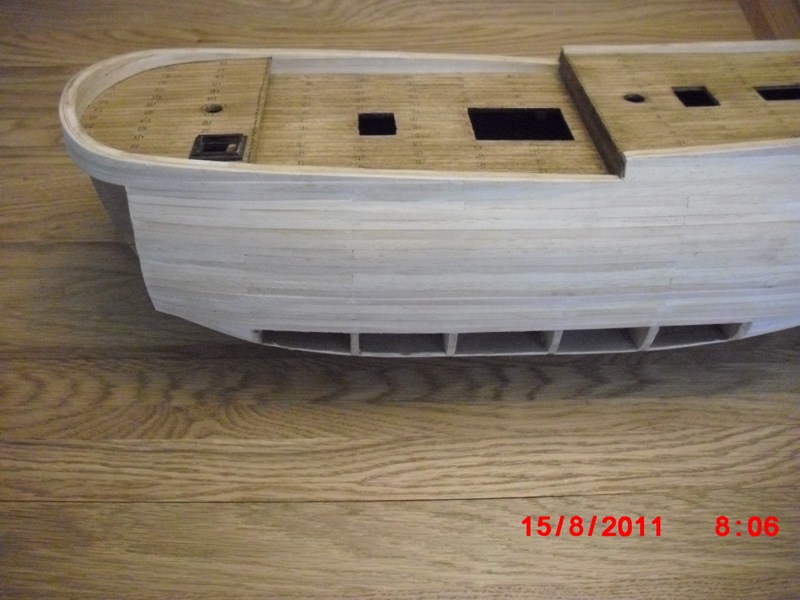

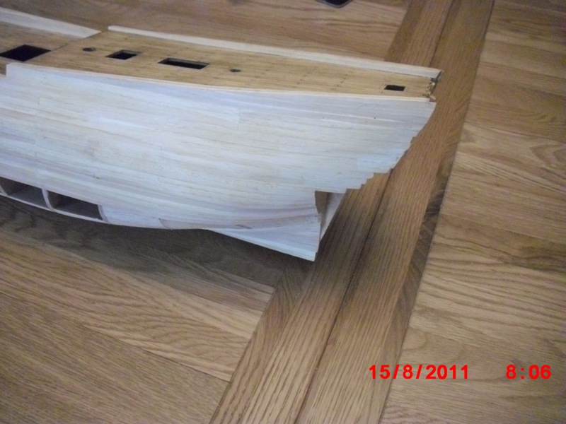

#204 Posted : 15 August 2011 09:25:15

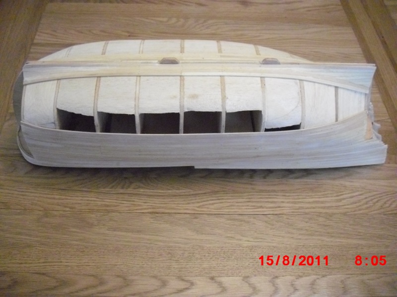

Hi everyone, here is my latest offering from this weekend.
I have run out of planking but she is 3/4`s planked now, still has to be sanded more next timeBigGrin

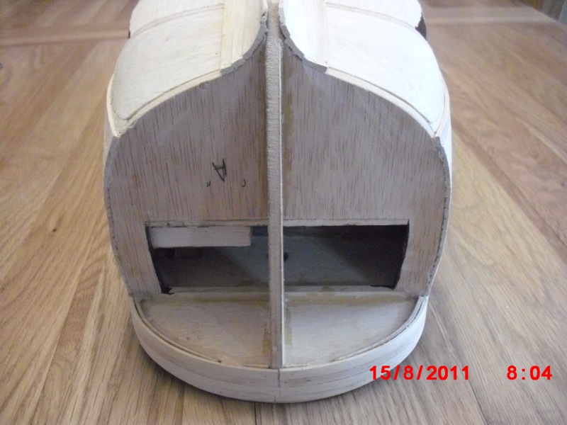

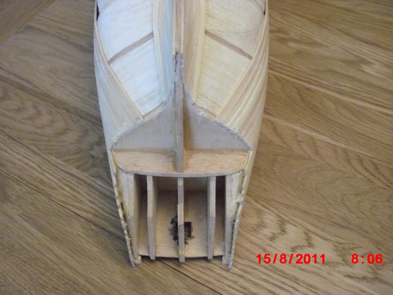

#205 Posted : 15 August 2011 09:27:15
As you can see I have started to trim the Bow and SternCool

#206 Posted : 15 August 2011 09:51:46
Nice one mate. Looking good. Had me worried then. Looking at your top pic the fillers between the bulk heads look like bumps. But scrolling down the the last pic the filler only goes half way creating an illusion at a different angle. Lol LOL
Chris.
#207 Posted : 15 August 2011 09:57:48
I can see why you would hve been worried!!! strange photo effectConfused Cheers for the commentsCool

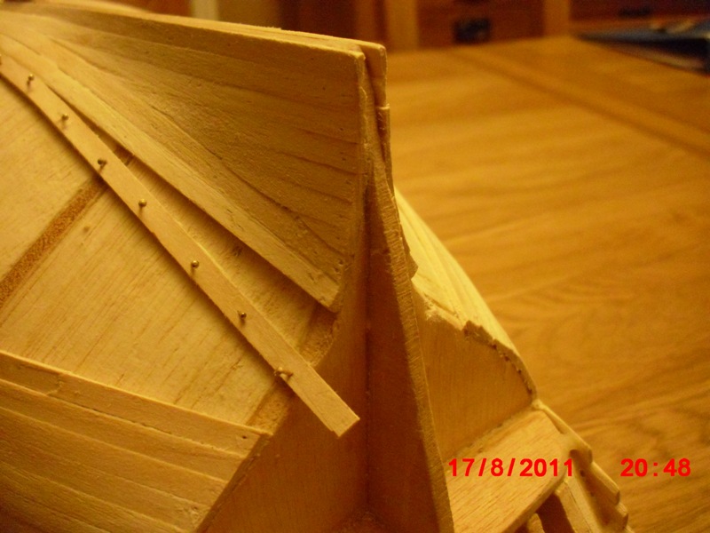

#208 Posted : 17 August 2011 22:12:15

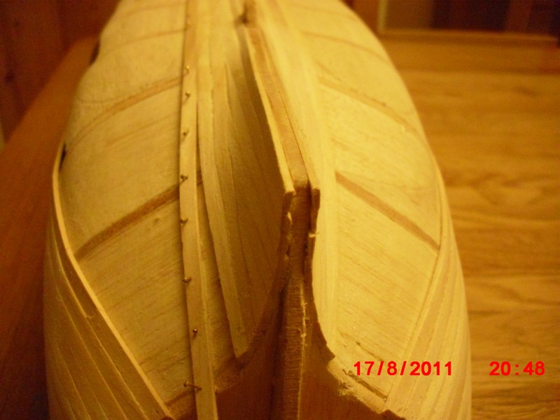

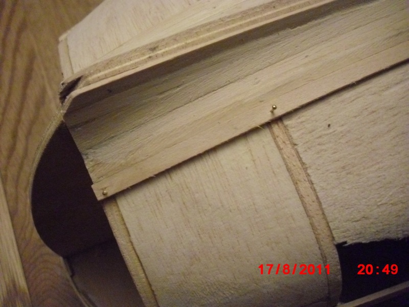

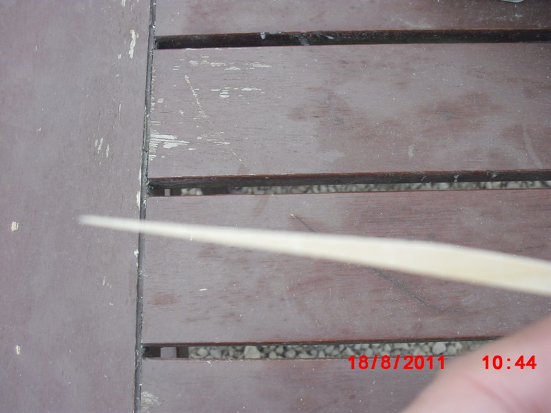

As I was planking,I felt I would show people new to modelling how a plank will show you which way it should go.
You will see that the plank suddenly feels better going another route, and therefore avoids `clinkering` and stressing the plank, the gap above the plank (towards the Keel) I will fit tapered planks.
As this is the first layer of planking its not critical, the second layer will be.
Other modellers will have their own methodeBigGrin

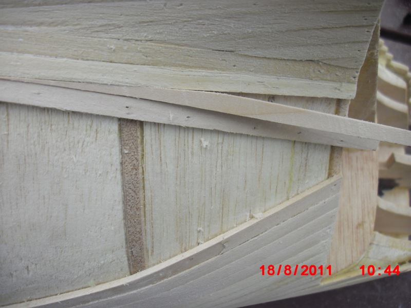

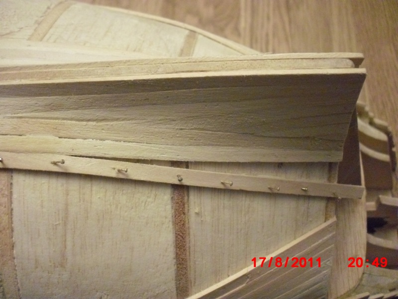

Last time in my Diary, I covered letting the plank go its own way, now I thought I would cover how I filled the space towards the Keel.
First I shaped the planks to fit the space :-
#215 Posted : 18 August 2011 18:47:26
Then I offered them up and fitted same:-
#216 Posted : 18 August 2011 18:53:23
Notice how I use pieces of offcut planking to use with a pin to hold the plank in position, so it does not split the wood.
Thats all for now, thanks for watchingBigGrin :-

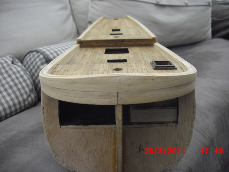

#220 Posted : 28 August 2011 18:21:53

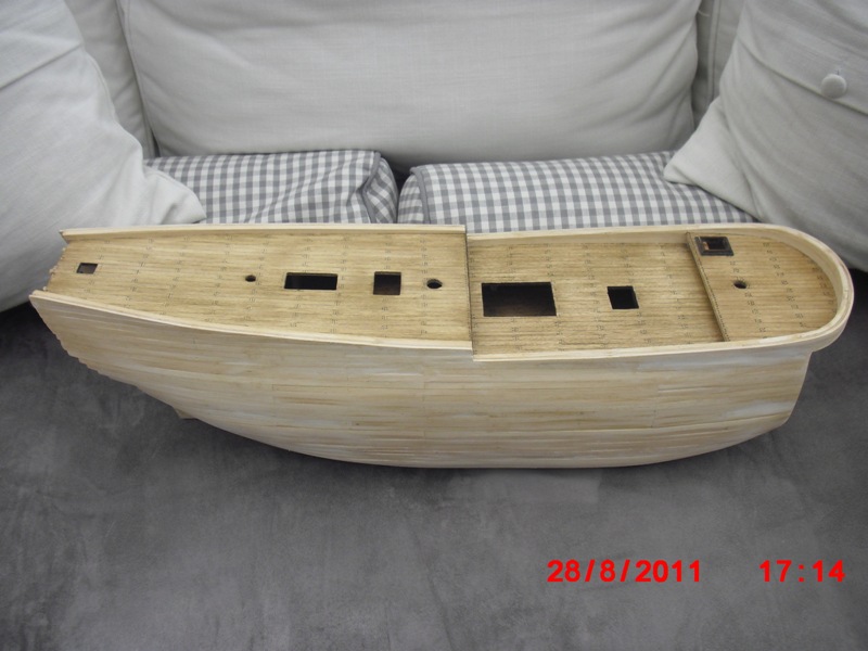

Well the first planking is finished, I will concentrate on getting the Hull perfectly smooth for the second planking, here are the photos:-
