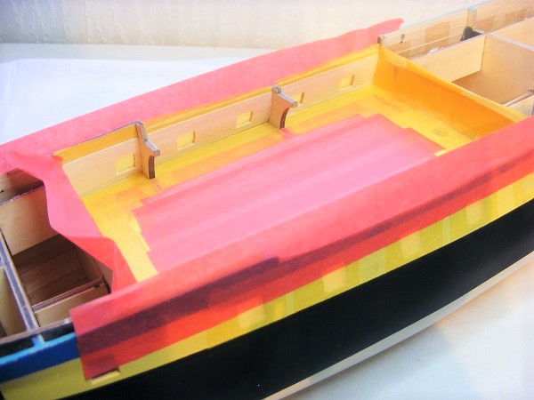

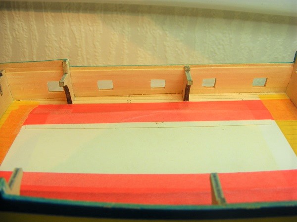

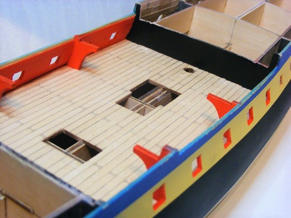

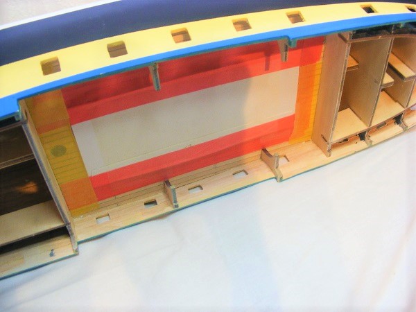

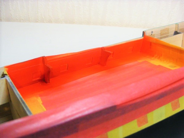

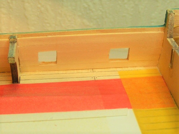

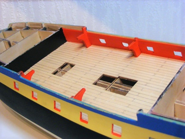

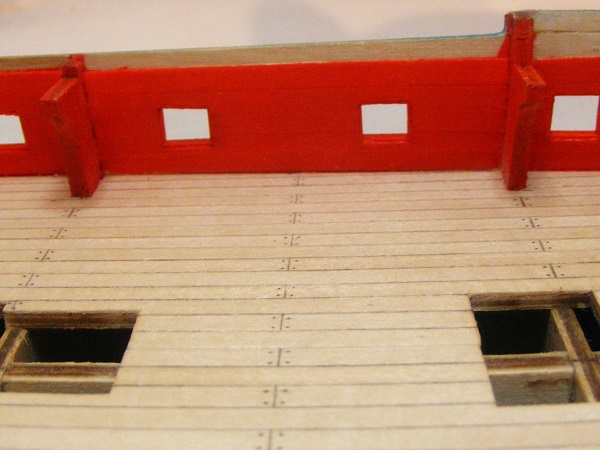

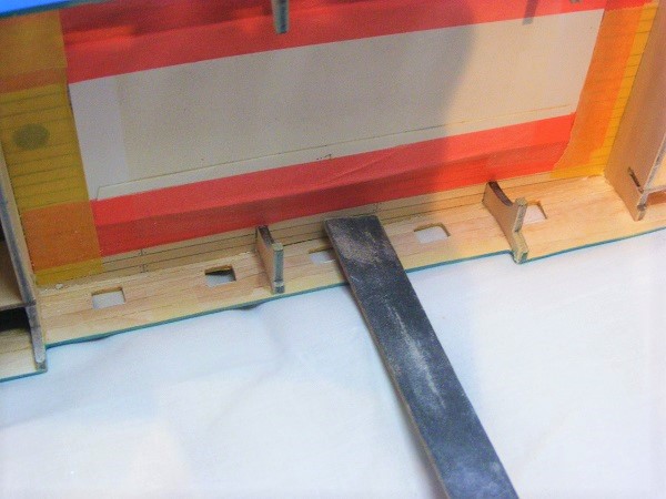

Made some more progress where we started work on lining and painting the bulwarks and bulkheads around the deck area. First task was to sand smooth the inner bulwarks, this was achieved using a fine nail file. Then fitted 0.5 x 4mm veneer strips, cutting clear the gun ports before giving it all a final sand down with fine grade sanding sticks... Next we masked off the complete deck area, masking the outside of the gun ports to avoid any paint bleed on the outer hull area. Using an airbrush then painted the inner bulwarks red. Lastly, when dry then removed the masking tape and painted the bulkheads flat black, these were painted using a small paint brush.....Cool Cool
Next job, the wonderful task of tidying and lining all 30 gun ports, a fun job but has to be done.....Cool Cool .. Until the next update, happy building all....Cool Cool

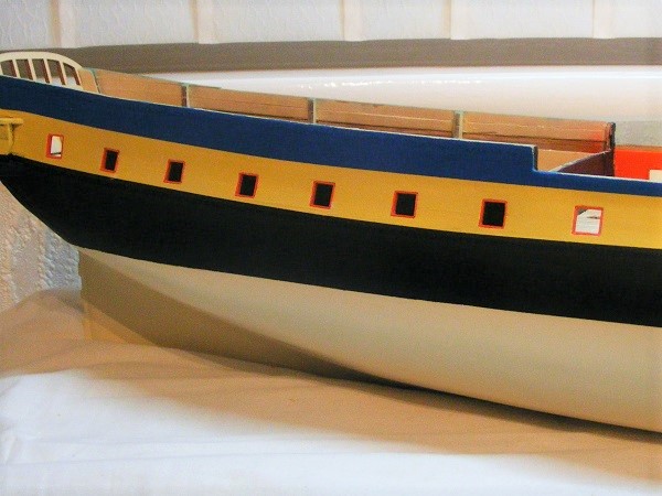

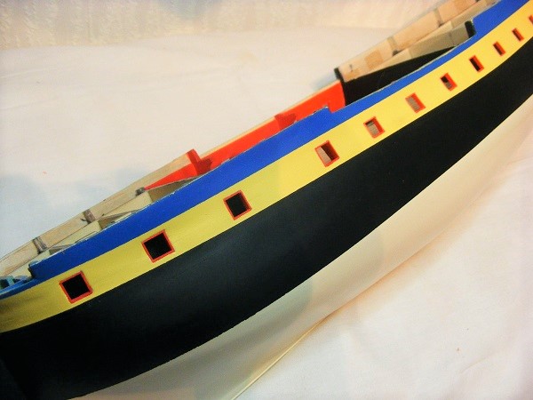

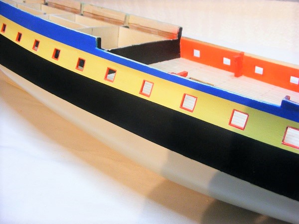

#217 Posted : 18 December 2017 00:18:36

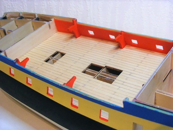

Thanks for looking in guys, appreciated....

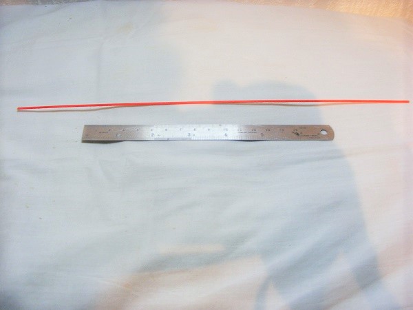

The tedious task of lining the 30 gun ports is now complete and brings an end to stage 16. Lining the ports started by painting red a number of wood strips 0.5 x 2mm and leaving them to dry. After tidying up the ports the strips were cut, trimmed and fitted into place. Once complete the ports were then touched up with red paint to get rid of any minor imperfections.... Cool Cool Cool .. Now for stage 17....
