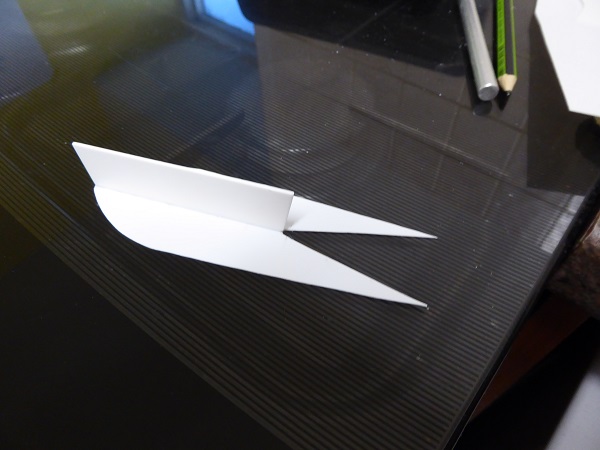

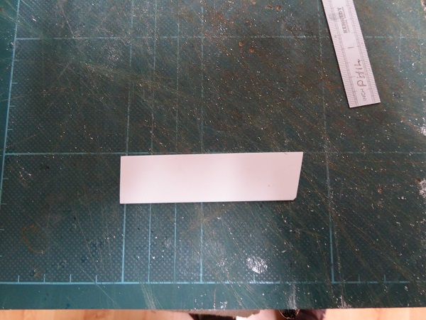

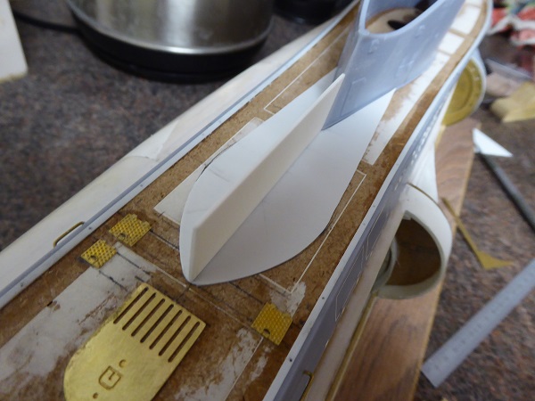

I also fashioned a vertical support from 1mm plastic sheet so I could fix the plastic profiled piece to the conning tower.

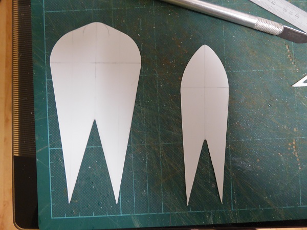

#202 Posted : 14 February 2017 20:33:11
Using a similar technique for drawing curves and cross-referencing photos of U995 I made a profiled piece to represent the upper deck of the lower conning tower platform. It was when I got to this stage I felt that I was relying to heavily on guess work so I came to the conclusion that more research was required.
#203 Posted : 14 February 2017 20:34:23

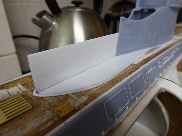

This picture shows the smaller of the two profile pieces fitted with the 1mm support I mentioned before.

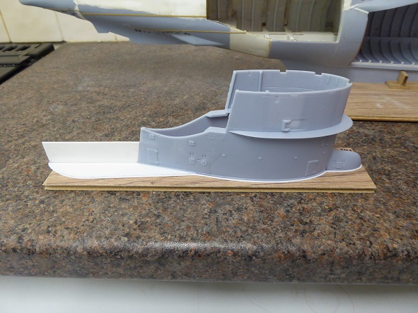

#204 Posted : 14 February 2017 20:35:52

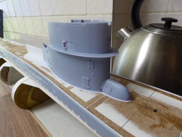

This image shows the profile piece and support located against the conning tower. Dry fit only at this stage.

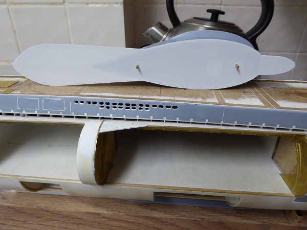

#205 Posted : 14 February 2017 20:39:13
This view shows the larger piece that makes up the floor of the lower platform in place. Alas, it is too wide. After studying the U995 photos for ages I realised, as I've mentioned before, that a measured drawing or a donor model is the only way to absolutely get this part correct.

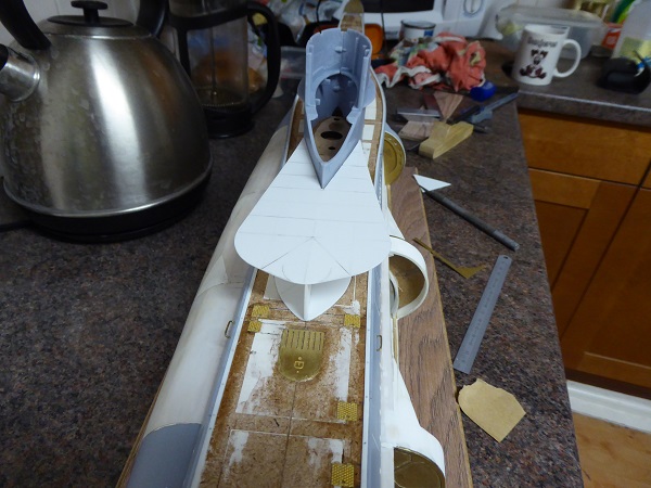

#206 Posted : 14 February 2017 20:41:33

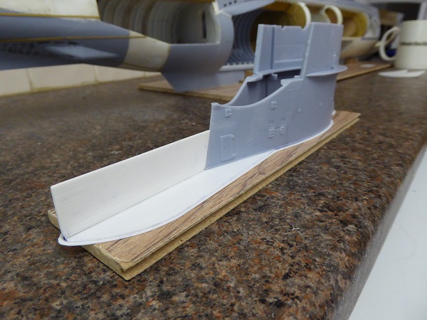

This photo shows the lower profile and support fixed to the conning tower and the whole assembly posed on my temporary laminate stand.
#207 Posted : 14 February 2017 20:45:06
This picture shows the conning tower sub-assembly mounted on the laminate stand with a slightly wider 0.5mm sheet fixed underneath the tower and profile piece. This sheet acts as a support and ties the tower and profile together preventing warping and disfigurement. It protrudes about 1mm around the border of the tower and rear profile.

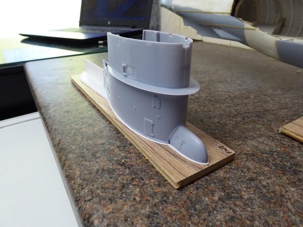

#210 Posted : 14 February 2017 20:50:58

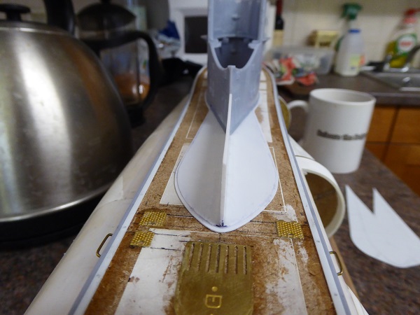

This picture shows a rear view of the conning tower with modified profile and support. You can also see the border around the edge as mentioned previously, tying the two sections together.
#211 Posted : 14 February 2017 20:54:24

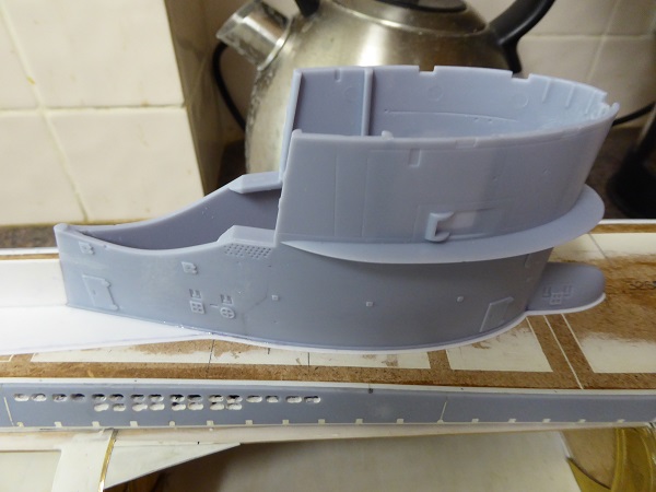

The attached photo shows the conning tower on it's side, clearly showing the 0.5mm plastic sheet, cut to shape, holding the tower and profile piece and support together.
#212 Posted : 14 February 2017 20:55:58
The whole sub-assembly, dowel located, on the top deck.
#213 Posted : 14 February 2017 20:57:13
A starboard side view of the conning tower sub-assembly.
#214 Posted : 14 February 2017 20:58:39
A 3/4 rear view of the conning tower sub-assembly.
#215 Posted : 14 February 2017 20:59:48
Rear view of the conning tower, profile and support.
