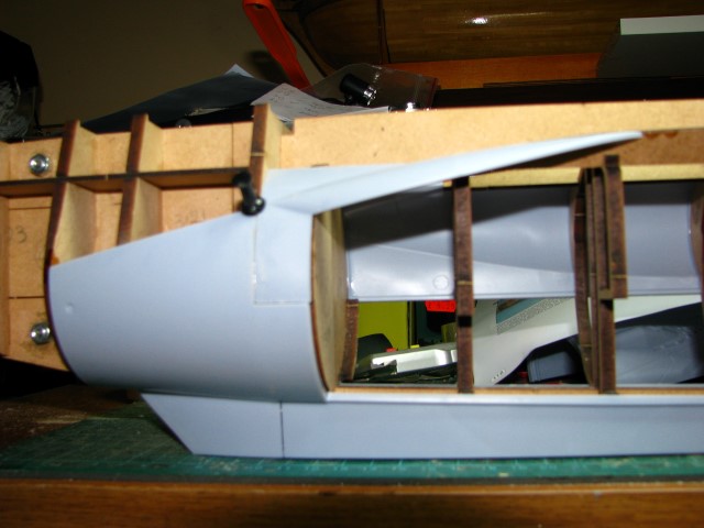

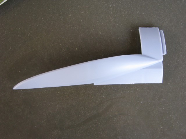

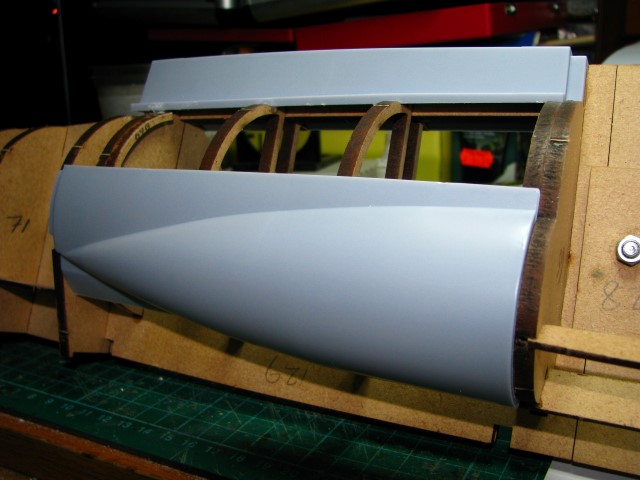

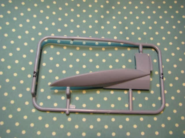

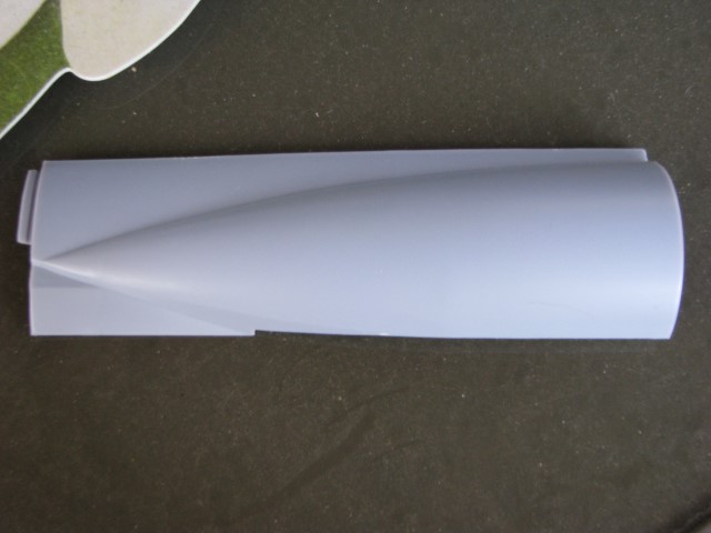

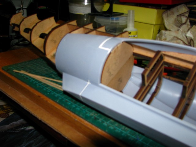

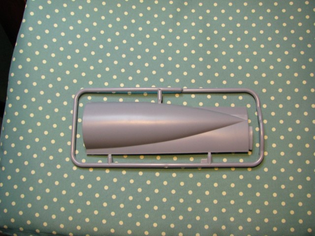

BUILD UPDATE #28
Hello again my friends,
This week's update is for issue 28 and covers the fitting of part #75, the plastic cladding with the contours of the rear end of the saddle tank.
First I had to remove the part #79 (from issue #27) which was held in place temporarily with sellotape which wasn't a good idea because it left a sticky residue on the surface of the part which had to be cleaned off, so I must remember not to use sellotape again (I had some masking tape which I'd put away somewhere, but as there was a roll of sellotape on the desk I took the lazy option and I paid the priceBlushing ).
Anyway, part #75 was cut off from it's sprue, cleaned up and offered up for a test fit. No extra work was required as it sat nicely in it's correct position, so it was glued in place with thick C/A glue.
Part #79 from issue #27 was then offered up to check the fit and I found that transverse frame #33 needed filing down on it's inside edge to allow the part to fit correctly, but it still left a small gap where it mated with part #75 so after the assembly was dry, it was filled with plastic putty.
Just as a note here, I shall not be smoothing down until all of the cladding and planking of the hull is finished.
That's about it for this week, thank you for looking in and as usual comments welcome.
Happy building
David

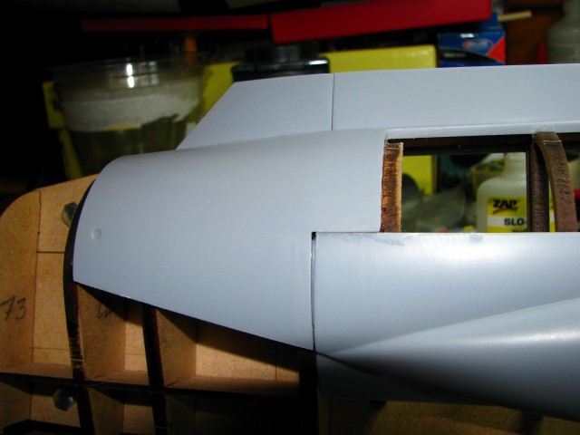

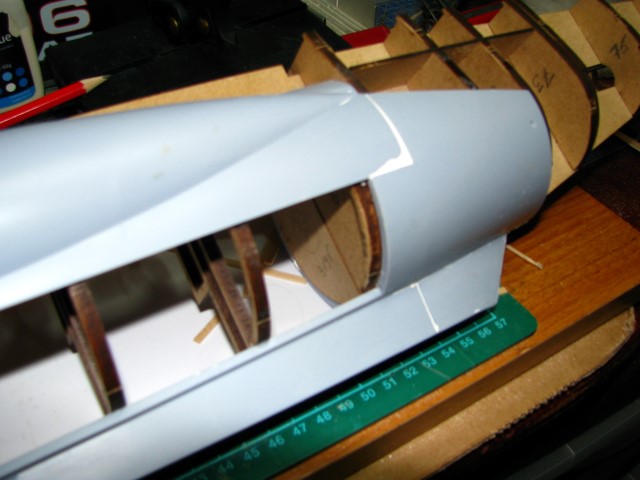

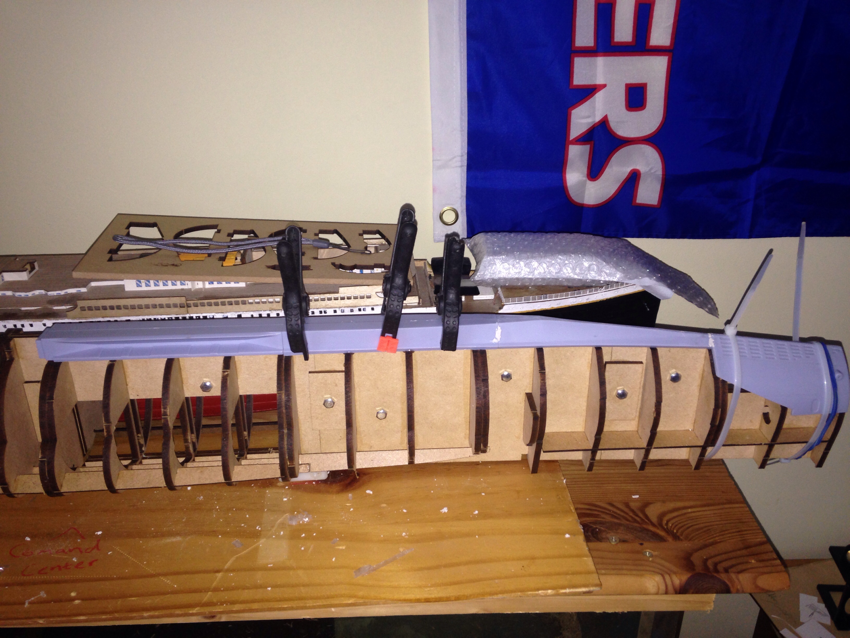

BUILD UPDATE #29
Welcome back to this week's build update.
Another single part to fit this week, part #74 (the right-hand rear cladding for the machine room cutaway).
After removing part #78 which was held in place temporarily, part #74 was cut away from the sprue, cleaned and offered up for a test fit. A small amount of filing of the longitudinal strengthener #86 was necessary to make the part sit correctly, after which it was glued into place with thick C/A glue and held with rubber bands until set.
Part #78 was then glued back into place and the 2 parts should butt up against each other in an 'L' shaped join, but as with the left-hand side, a small gap was left which needed filling with plastic putty.
Well, that's it for now. The next update will be issue #31 (the start of the planking) to allow me more time to work on the part supplied with issue #30 (part #80) which has over 100 ballasting vents which need opening up. Thank you all for the comments and thanks for looking in.
Happy building
David
