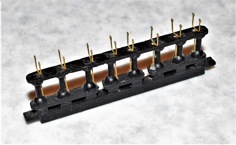

tonights effort has been drilling holes in the quarterdeck rail for the hammock frames, the stanchions for these are extra long as they go through to the bottom of the rail.
Waist Rail1.JPG (322kb) downloaded 21 time(s).
Gibbo attached the following image(s):

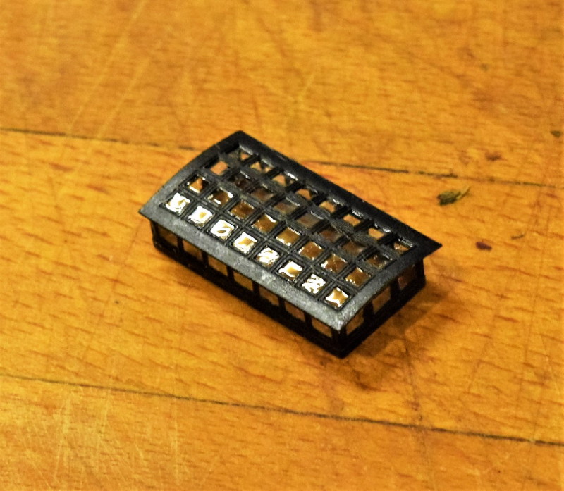

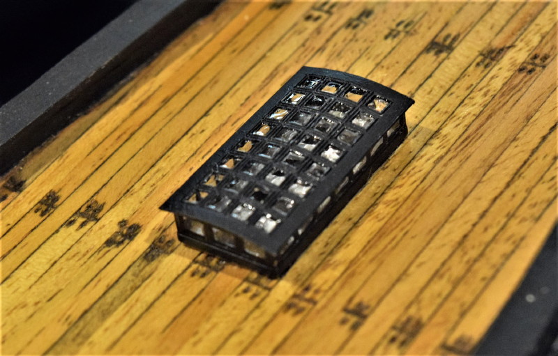

The skylight has now been painted and glazed with Humbrol Clear Fix, i found it was easier doing the glazing from the inside out, i will be cutting the planks off of deck under the skylight to add a frame and some beams to be seen through the skylight.
#206 Posted : 22 January 2018 14:59:34
Never occured to me, that those stanchions go right down to the bottom!
Nice detail!
#207 Posted : 22 January 2018 15:52:12
BigGrin Looking fantastic Paul.Cool

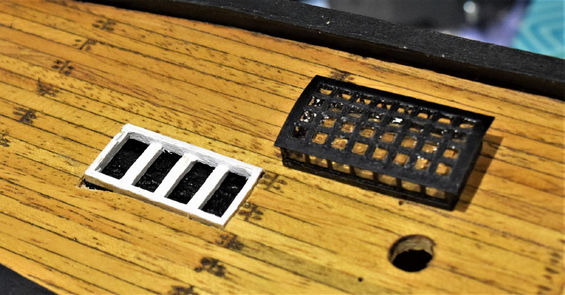

The skylight has been added to, first the deck planking was marked out and the planks removed then the base painted black, ( yep, more chopping up ) then a frame was made up with three beams across and this was painted white, then the frame was then glued into the hole and the skylight sits over the top, you can just about make out the frames close up with the naked eye.

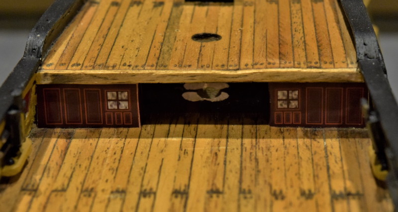

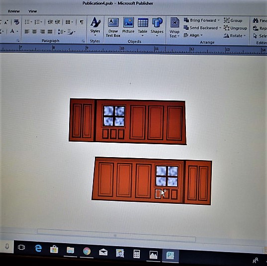

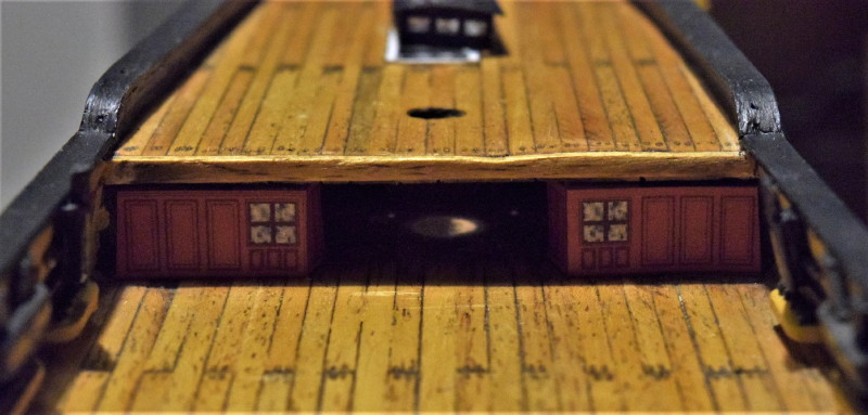

Before i started any work on the steps to the Poop Deck i had to work out what i was going to do to the cabins area, all it had was what looked like a square blob with a window in it so i decided on making it wider with a couple of square bits of Balsa, this gave me an area of 28mm long X 13mm high to work with on each side, (so not a lot) so i decided to do it in computer graphics, by the time the cannon and the poop steps are in place you're not going to see too much of it, this is not the finished article as i'm still playing around with the colour.

#211 Posted : 27 January 2018 01:10:32
Joined: 26/05/2014
Posts: 912
Points: 2,773
Location: East Sussex UK

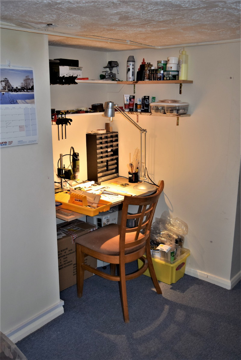

So after jigging around and printing different colours of dark brown on different paper i went with glossy photo paper with the highest DPI to get the sharpest detail, i also took the man cave from the cold lonely loft into the warmth and comfort of a corner in the basement, no more mucking about with the loft ladder and all that nonsense every five minutes, happy days.
#212 Posted : 27 January 2018 11:15:17
That look tasty, very well done.....Cool Cool
#213 Posted : 27 January 2018 11:46:26
Posts: 6,968
Points: 21,211
That looks excellent.
#214 Posted : 27 January 2018 17:36:42
BigGrin Looking good a very clever idea Cool
Martyn
#215 Posted : 27 January 2018 21:50:03
Posts: 2,083
Points: 6,244
'Ere, why didn't I think of doing it that way!Cursing Seriously though, the printed walls look excellent!Cool
As for the comfy warm basement - Blink In my youth it was a table and chair on top of the flat roof in all weathers!!BigGrin Actually it was a built on workroom at the back of the garage (though not much warmer) Youngsters today - I don't know!Flapper
PS Those mast plans are currently being re-scanned up to 1/72 scale for a 'forth coming project' hint hint!Blink
Looking great!
Robin.

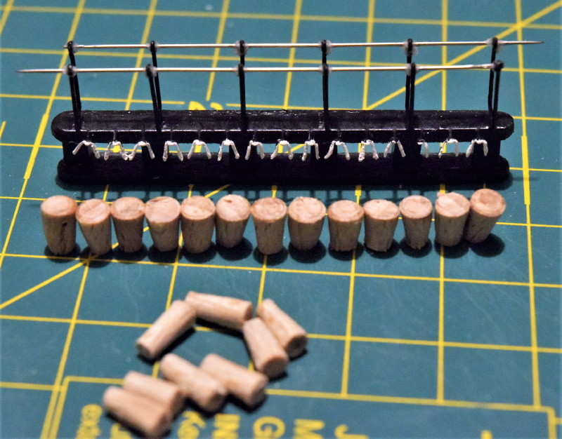

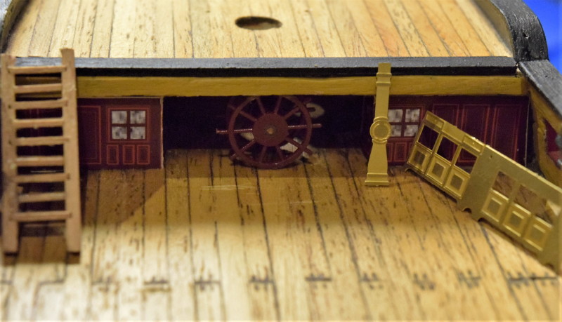

After looking around on tinternet the only ships wheels i could find were 14mm 8 spoke metal ones from CMB for about a fiver each without postage, so i decided to go with the 14mm 10 spoke ones from the Heller kit, i had to cut off the bottom two spokes and the top two with part of the wheel to get it to sit under the poop deck, so this was a lot easier to do with plastic than metal and the previous owner had already painted it (result), the PE stanchion you can see in the picture will have to be cut down top and bottom to match, also in the picture you can see the PE Binnacle which is also too tall so i plan to take the bottom off of that too.
I bought myself a cheap £40 wood lathe and am attempting to make some fire buckets for the poop rail, the ones shown are too wide so ineed to make them with a smaller diameter dowel, stick them together and fit them as one unit
#218 Posted : 04 February 2018 09:02:32
Posts: 6,968
Points: 21,211
Nice update, looking forward to seeing how the buckets turn out.BigGrin
#219 Posted : 04 February 2018 22:01:39
Posts: 2,083
Points: 6,244
Lovely work again there Paul!Cool
I've been thinking on those buckets too - in 1/100 scale they're tiny! I might try shaping one or two from either plastic rod or even a resin cylinder and then make a mould to cast a set (finding ever more uses for this stuff!)BigGrin
Looking great!
Robin.
#220 Posted : 05 February 2018 22:13:13
nice job on your cabin fronts Paul. look forward to seeing your buckets come to life.
Ian Cool BigGrin
