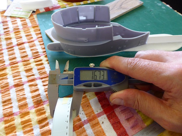

This photo shows the donor model being measured with vernier calipers. Prior to this I measured the overall length of the donor, multiplied this measurement by a factor of 1.5 to give me the correct length for 1/48 scale and then compared this with the actual length of the larger version. Surprisingly, the 1/48 scale version came out spot on [within 0.5mm anyway], which I was very happy with.BigGrin
I continued in this way, measuring corresponding points of both models to gauge the difference between their footprints.

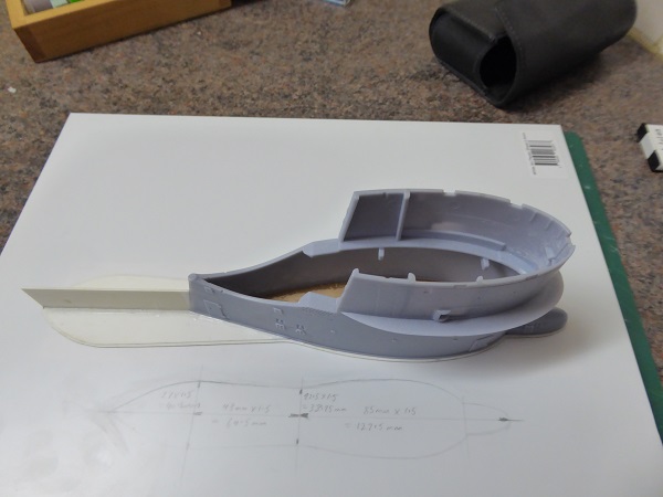

The next step was to draw the outline of the donor model conning tower onto 0.5mm thick plastic sheet.
#2083 Posted : 17 May 2018 22:18:08

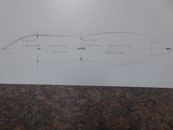

A centre line was drawn through this outline and specific points marked out that correspond to the 1/48 scale version. These points were measured, noted and then multiplied by a factor of 1.5 for the converted measurements and also noted onto the outline.

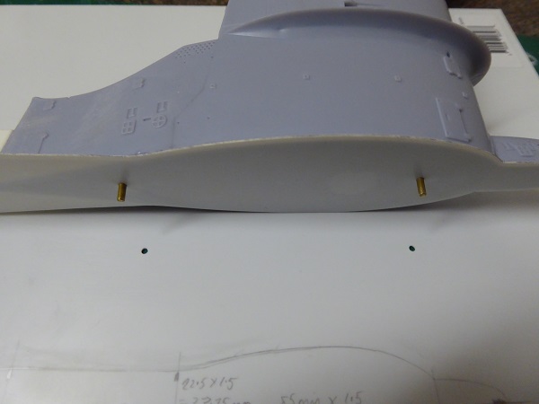

The starting point was to drill out two locating holes on the same plastic sheet as the 1/72 profile that match the dowels on the 1/48 conning tower as can be seen in the attached photograph.

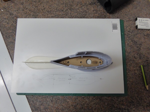

#2094 Posted : 31 May 2018 19:27:58
1/48 scale conning tower located via its dowels onto the plastic sheet with the 1/72 scale profile next to it.

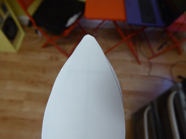

Same view, this time from above.

I then drew around the original profile of the 1/48 scale conning tower.
#2097 Posted : 31 May 2018 19:34:11

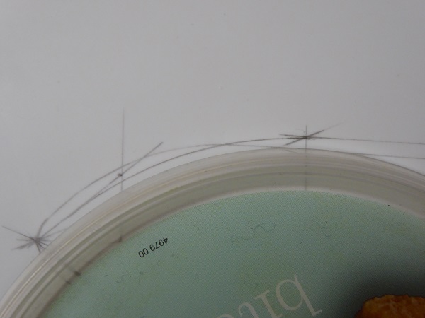

Drawing out some of the curves. In this instance I had to use a food container lid to get the correct curve!LOL
#2098 Posted : 31 May 2018 19:36:52

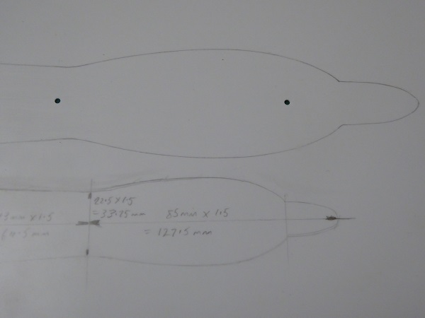

The completed 1/48 scale profile drawn out alongside the 1/72 scale version.
#2099 Posted : 31 May 2018 19:47:22

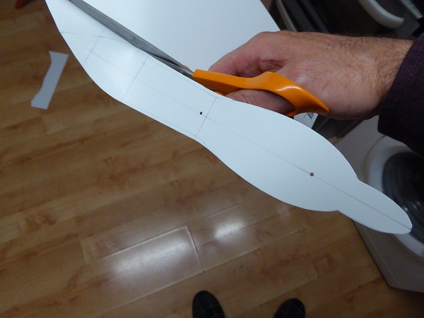

The profile being cut out.
#2100 Posted : 31 May 2018 19:49:35

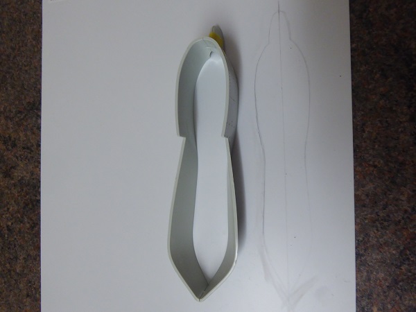

I then glued the new profile to the bottom of the conning tower so I could gauge how much of the original profile would have to be removed to match the new shape.
