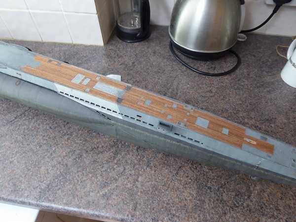

From above.
#2062 Posted : 10 May 2018 19:50:56
This photo shows the completed decking along the full length of the U-boat.

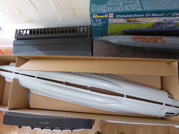

The attached photo shows the box opened revealing the two halves of the pressure hull.

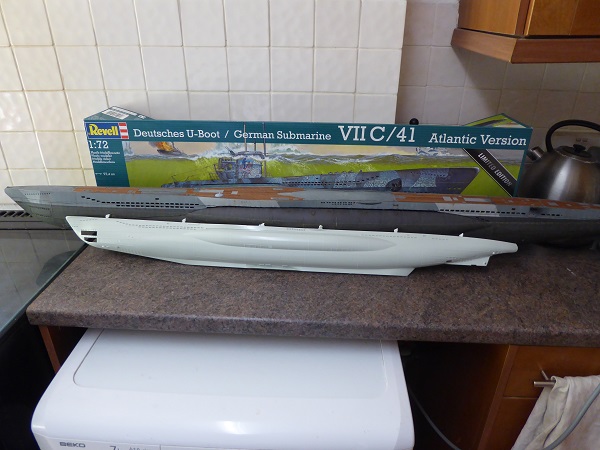

The 1/72 scale port side pressure hull against my 1/48 scale U-boat pressure hull. Needless to say the 1/48 scale is a beast. It weighs a fair bit now; roughly 4 to 5Kg's!Blink
#2071 Posted : 17 May 2018 21:43:13

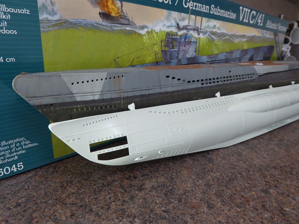

Close up of both port bows.

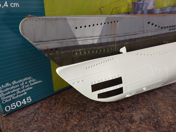

Photo taken slightly further back to highlight the difference in size.

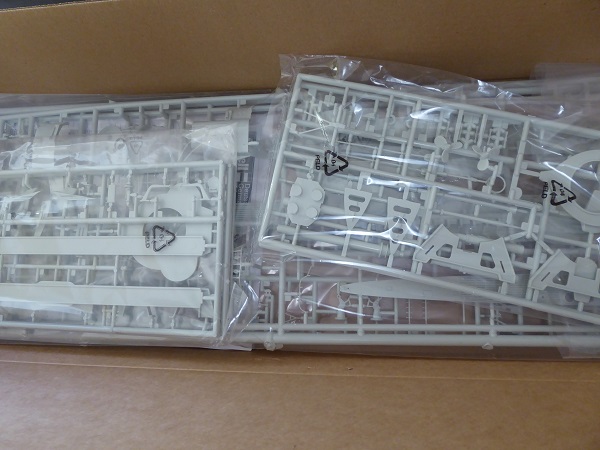

Photo shows several bags of parts.

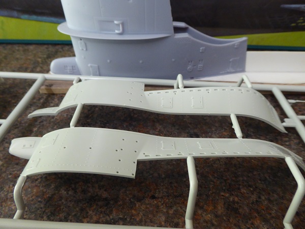

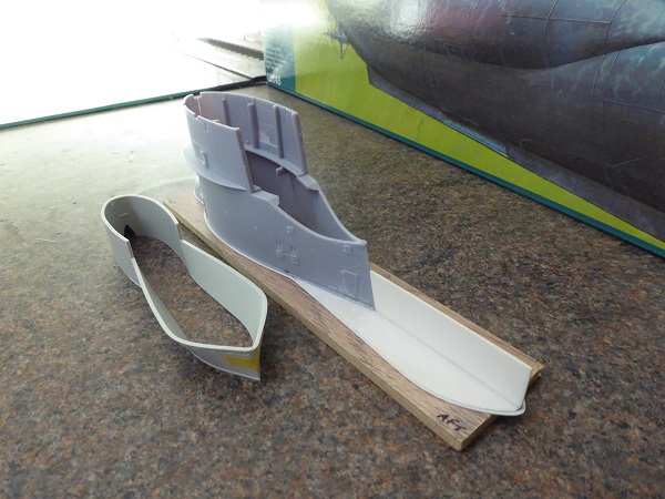

This photo shows the 1/72 scale conning tower base next to the 1/48 scale version. It's this base that I will start with on this modification.
#2075 Posted : 17 May 2018 21:51:01
From another angle.
#2076 Posted : 17 May 2018 21:55:20

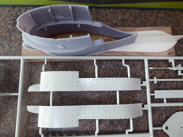

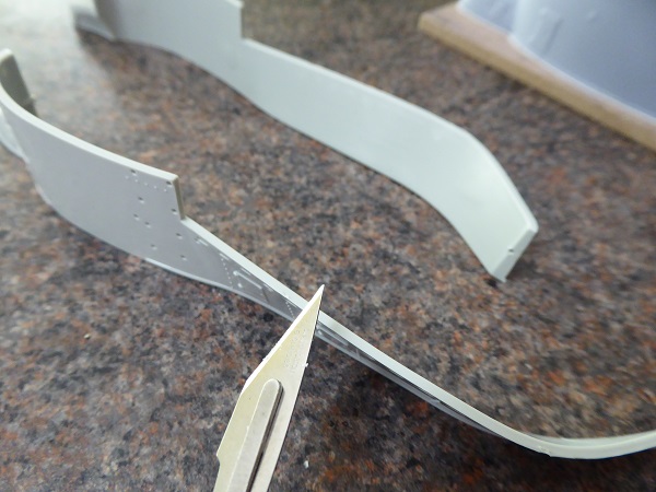

With snips i carefully removed the two halves of the donor conning tower from their sprues and cleaned up these areas with a craft knife ensuring they were smooth.

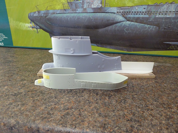

#2077 Posted : 17 May 2018 21:58:20

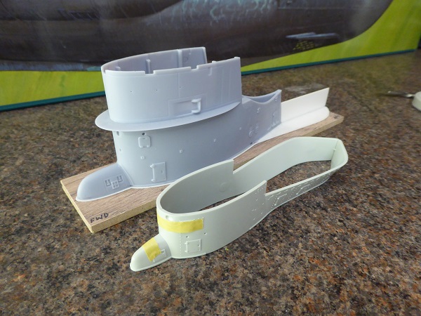

I then used masking tape to hold the two halves together. I'll be looking to sell this kit once I've obtained all the measurements, so i'm taking extra care with these parts. No glue involved, keeping the parts damage free.
#2078 Posted : 17 May 2018 22:01:06
Photo from above showing the compound curve of the conning tower bases. My 1/48 scale version isn't too far out considering I only used photos, but still, a little work required to get that curving conning tower base spot on.

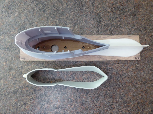

#2079 Posted : 17 May 2018 22:04:49
Looking at both conning towers from the front. You can see that the 1/72 scale version not only curves to a point at the rear but also the sides taper out along its length. In another update i'll make formers that match the tapered angle of the donor model and use them for fixing the tower sides.
#2080 Posted : 17 May 2018 22:05:46
In this photo you can see the tapered tower sides.
