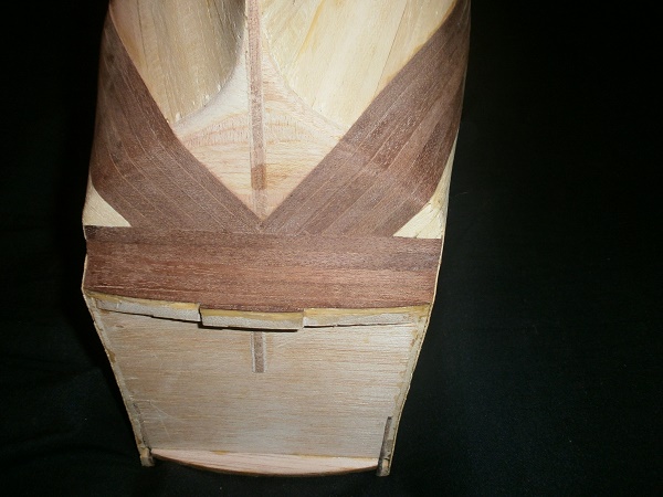

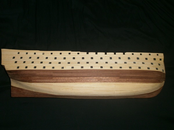

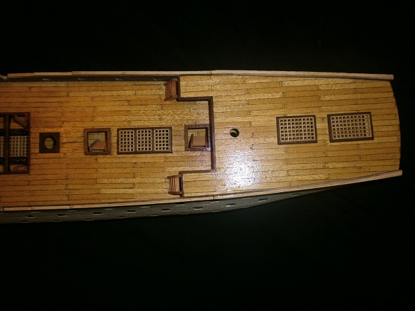

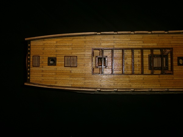

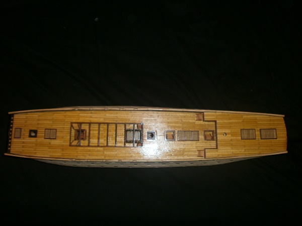

This post will conclude this months build, the hull has now had the fillets attached to the front and rear so awaiting more planks here.
The lower deck has had the ladder column's and handrail fitted with cannon balls on each corner , also the cannon ball rack has been added around the grating on the same deck. Finally the cross beams have been added in this area.
The forward railing base has been added as have two of the mast supports , bow and mainmast.
More soon

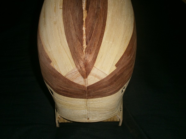

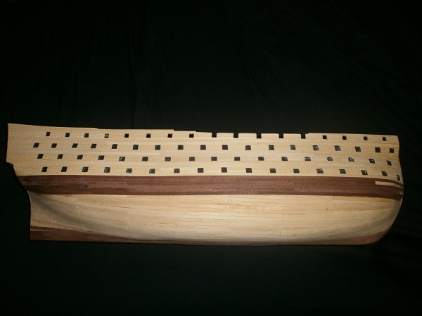

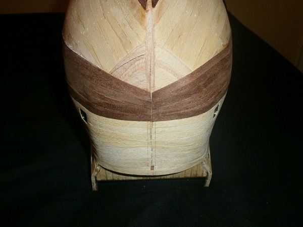

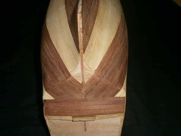

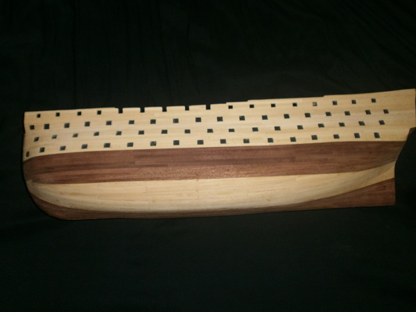

#193 Posted : 01 June 2014 21:37:16
BigGrin Hi All

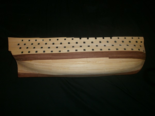

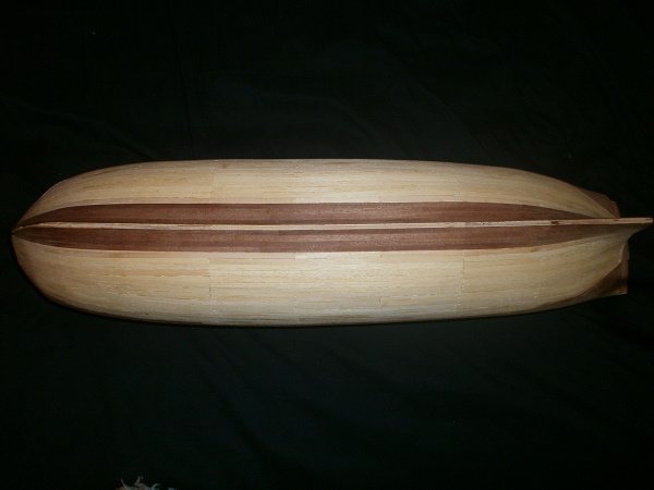

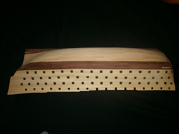

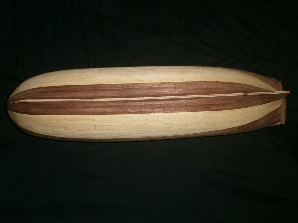

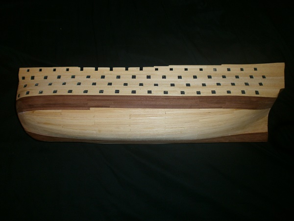

Slowly getting the secondary planking done and taking my time as I want it looking as good as possible. One thing I will mention is some of the planks have a natural curve along there length, these can be saved and used at the bow and stern to aid in curvature of the hull .
You may have noticed I am deliberately planking into the false keel areas at the bow and stern, this will be trimmed back in these area's to accommodate the keel when it gets fitted.
More soon
