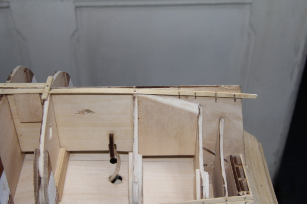

Well, that's the garboard planking on both sides now...

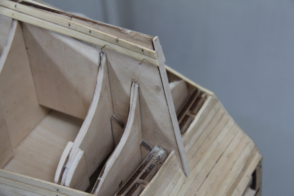

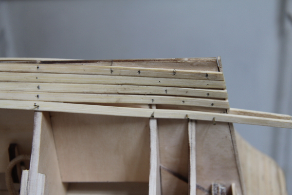

Third row going in...

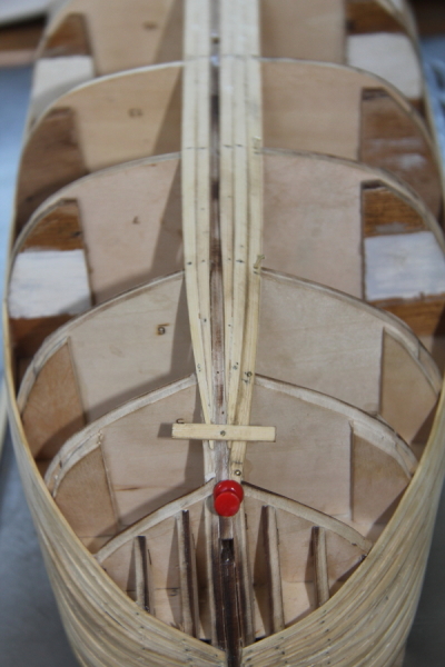

I had an idea about trimming the stern planks at the end of the keel.
Later on in the build, we are instructed to trim back to a 2mm overhang and then sand to a taper.
Why not do it straight away, as we go along adding the planks?
All it needs is a piece that is 4mm wide (the keel thickness) and 2 mm thick, added to the keel.
The correct size wood was supplied with issue 12 - the deck support beams. I ended up with a lot of spare stuff of this size, 3 complete lengths and 4 half-length offcuts. An offcut is long enough for this job.
I have not glued or pinned this in. It just sits there as a marker for cutting the planking to the correct length.

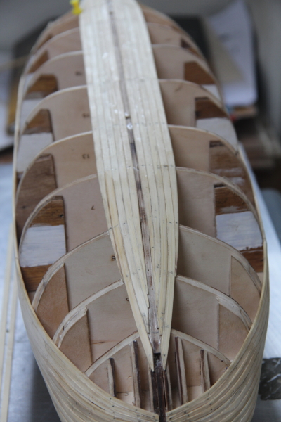

Row five done on each side of the bottom, row six soaking and bending.
I am a bit puzzled by the "bearding line" shaping of the keel brace plates. None of the planks come anywhere near it - except for a tiny bit of row 4.

Great work DavidCool Cool You are obviously in the swing.I think with the reinforcement pieces,it was just to make sure they didn't foul the planks.If they were to be actually used to support the bottom edge would be curved and the chamfering more complex.

It was just extra work, then, getting rid of the excess bits of the keel braces!
If I had known that when I glued them in, I would have just cut that triangular section off first. Easier than gluing it in place then chiselling it off again!
