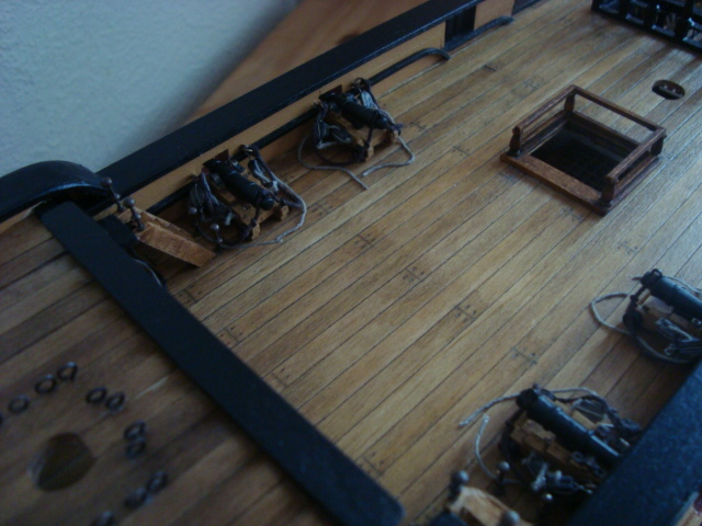

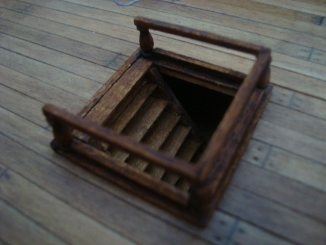

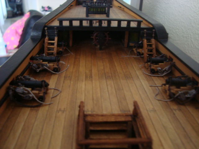

Next was the companion way stairs and railings, this was to be oak coloured even on the painted build so I used burnt umber oil paint for this, I think it looks "oakey" and I have run out of dark woodstain anyway, Im happy with it though. This was standard build but I did narrow the steps a little, instead of using 5x1 strips I used 3x0.5 to give a more scale appearance.
#182 Posted : 20 October 2013 18:38:26

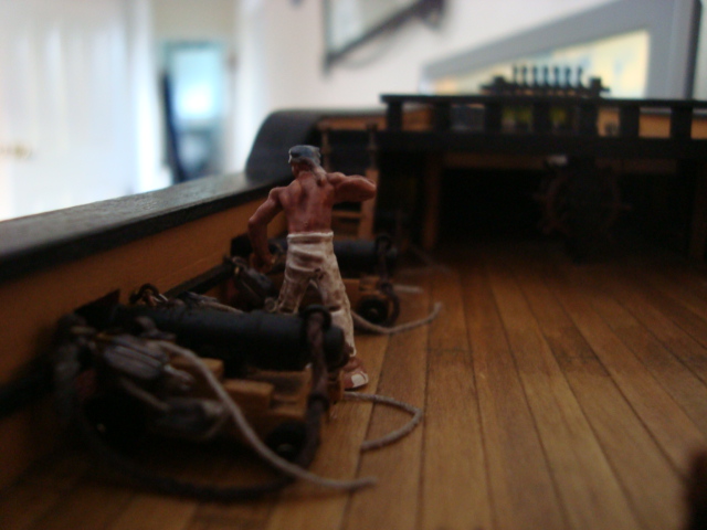

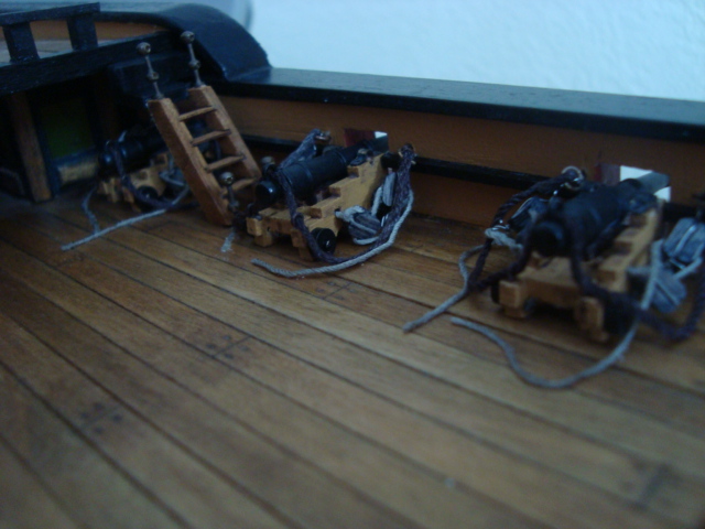

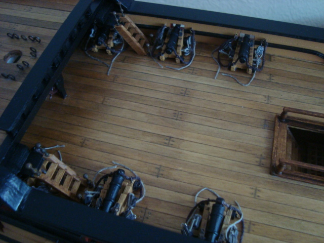

Next up were the cannons on the quarter deck, all standard to the instructions apart from the ebony stain on the block - the blocks are way over scale, 2mm blocks would probably have been better but I dont have any, so I think by staining them it does take the eye off them slightly so they are not so noticeable.
The ladders to the poop deck are also new additions and these were also narrowed and thinned for scale, just the wire to add for the rails next, the posts are have been dulled down with "blacken-it" if you just dip them in quickly they will tarnish instead of blacken, I started this build with the idea that I wont be having any shiny brass fittings so now have to continue thisBigGrin
The chap looking busy is not glued down, he's just there for effectLOL

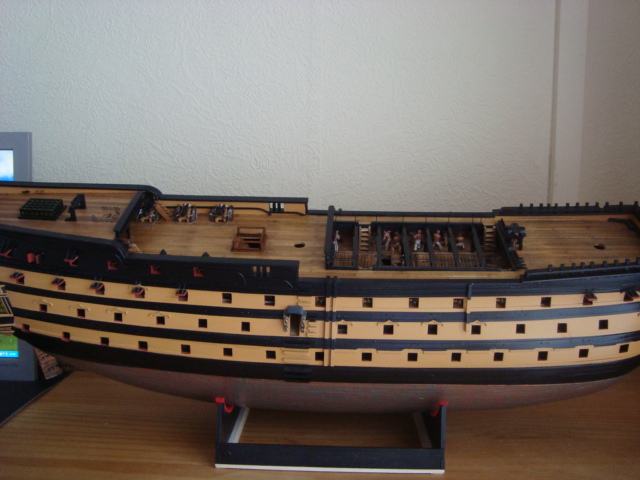

#183 Posted : 20 October 2013 18:51:06

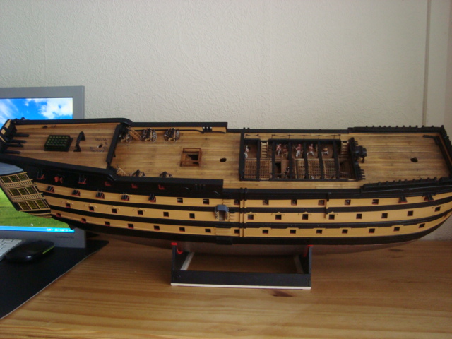

Heres a final long shot to show where 84 issues will get you, bearing in mind that all masts and yards are also complete (except the bowsprit)
