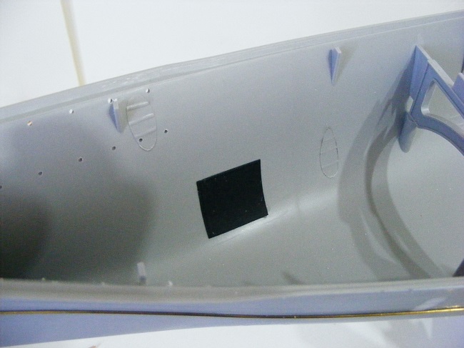

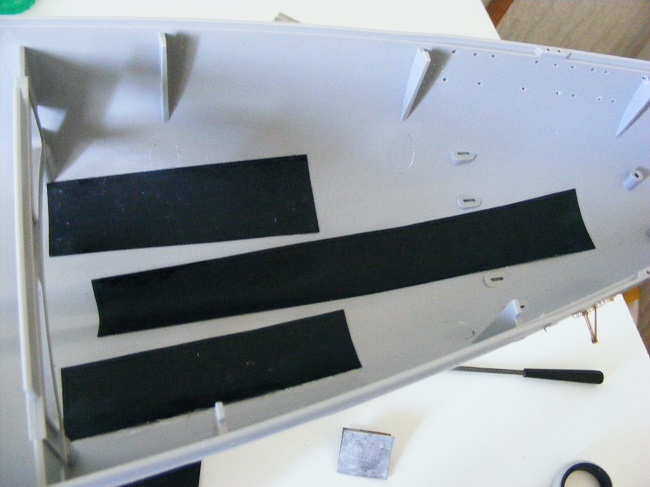

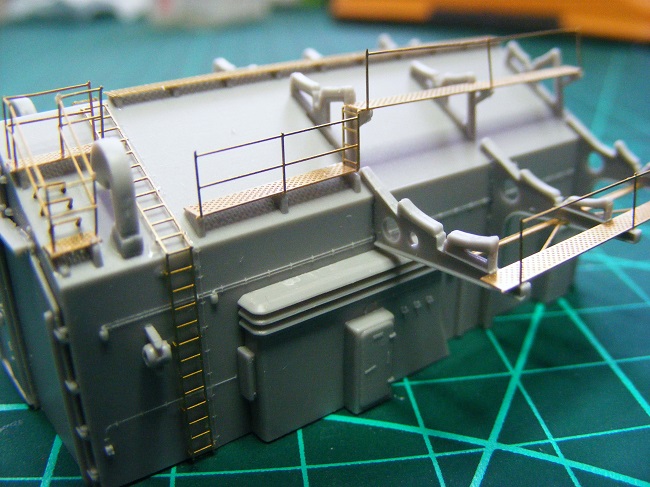

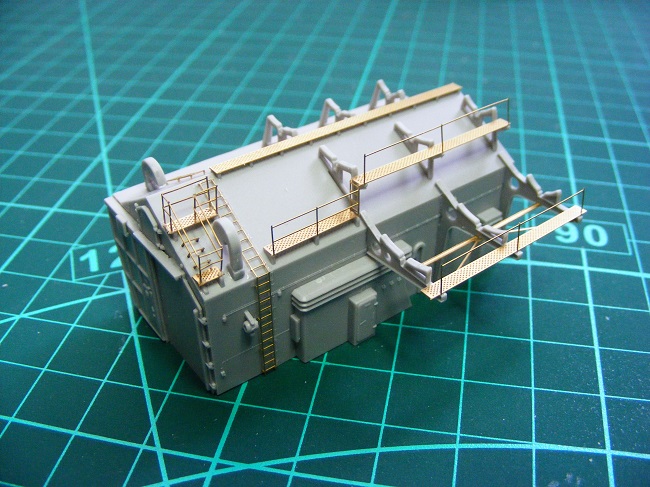

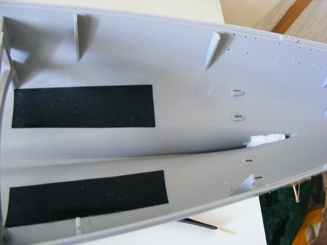

Moved this one forward a little more by first conducting a lighting test on the hull, primarily to identify any major light bleed areas that need taking care of. I found that the thickness of the hull meant that there was no light bleed to be seen apart from where I drilled the position of the new forward sonar array and the plastic around the propeller shaft housings proved to be a lot thinner. Resolved these areas by gluing some thick black card over the areas and the retest proved the problem to be solved.
For now, I'm happy with the hull prep but am not ready to prime. Can only spray outside so will wait until the weather improves before carrying out this task.

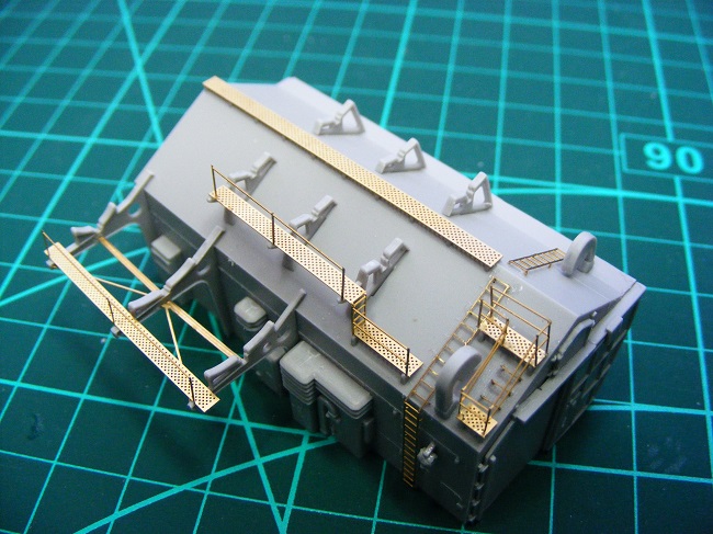

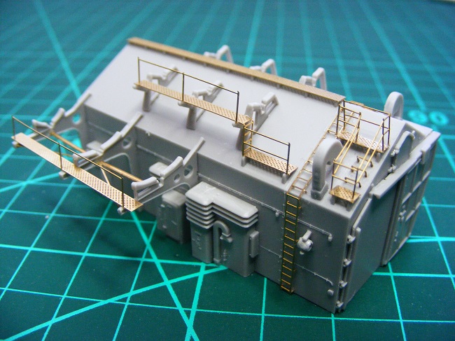

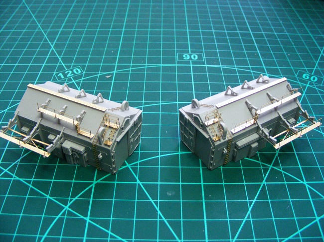

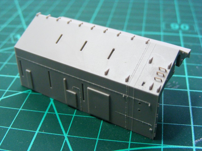

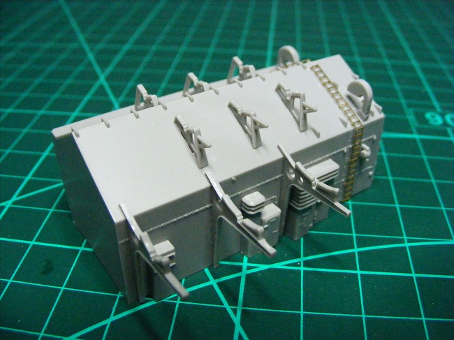

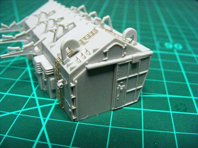

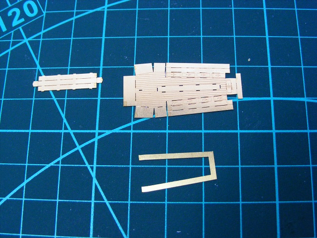

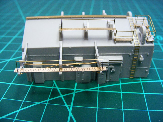

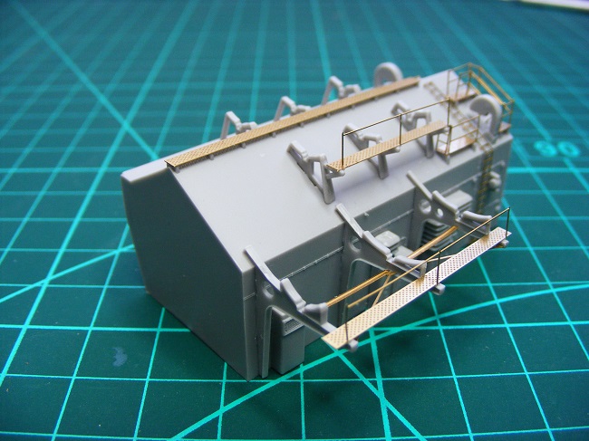

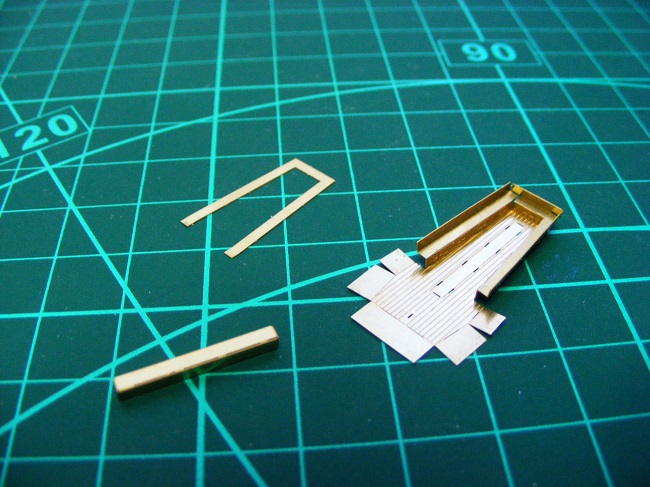

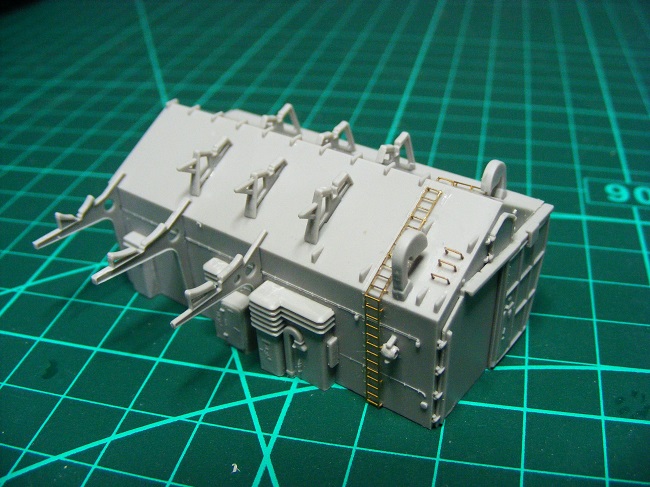

Moved onto assembling the two hangers, first by following the kit instructions and attaching all the necessary plastic fittings. Then started fitting the etch, some of which were really delicate to handle, namely the railings. These are now ready for priming.....
Until next time, happy modelling all.....Cool Cool

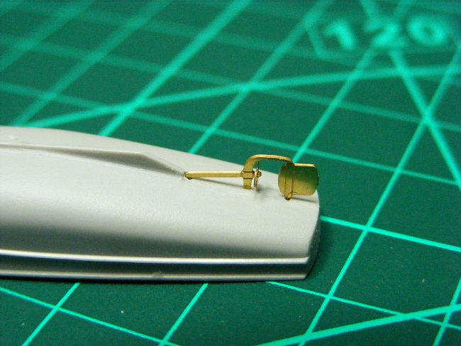

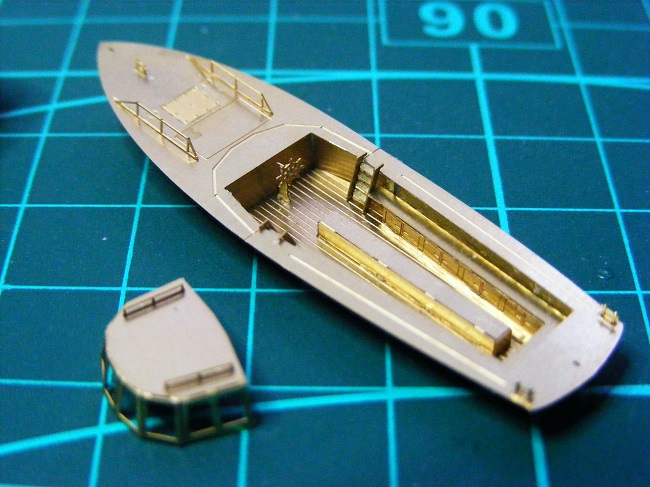

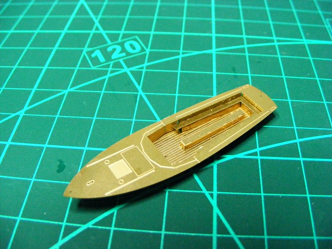

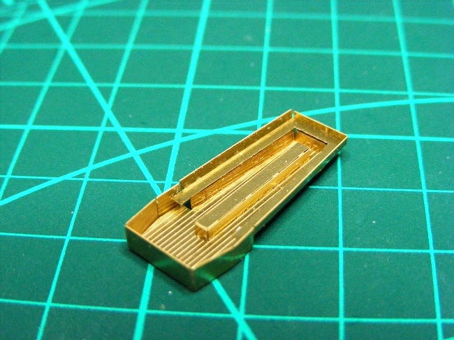

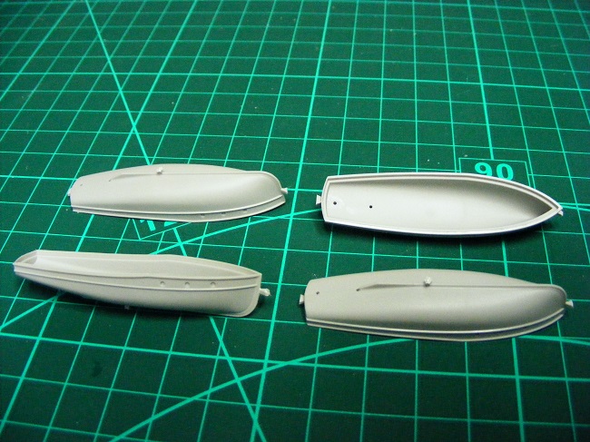

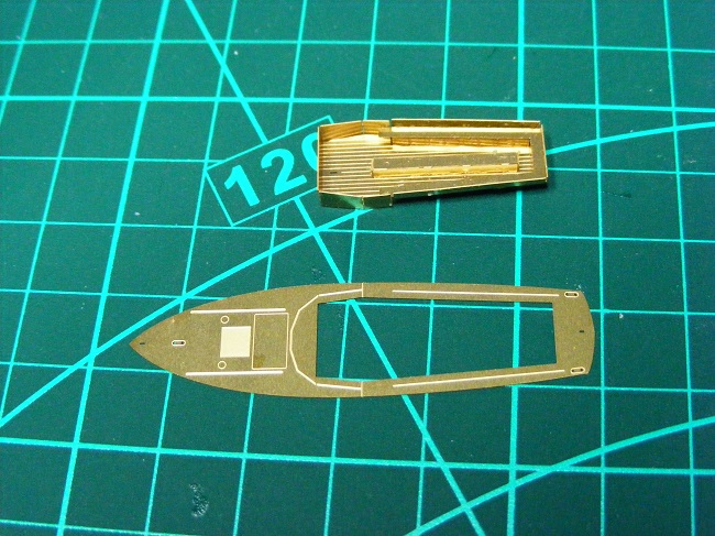

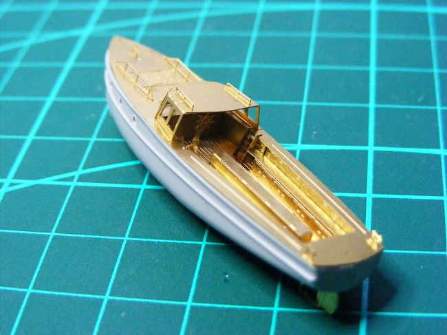

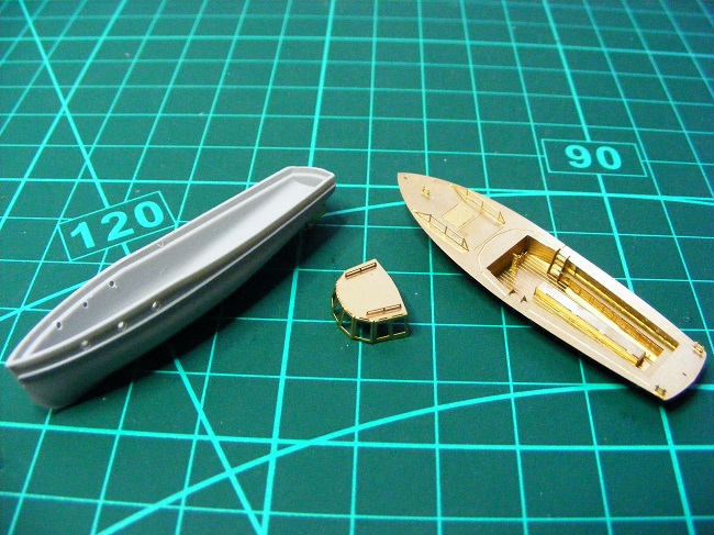

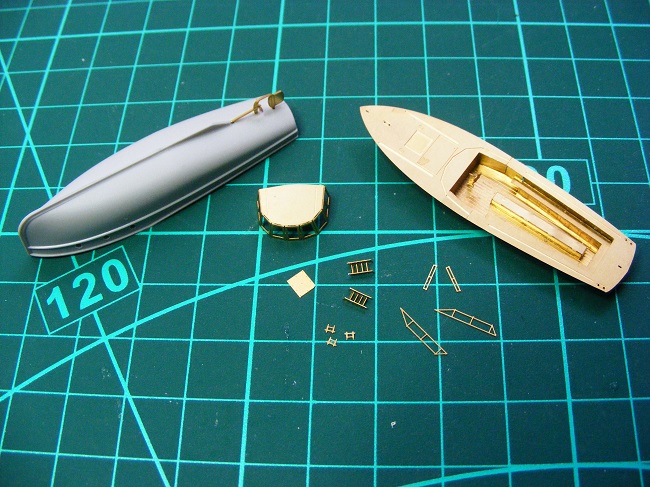

Had a think to see what to do next. Noticed that this build has a total of 11 small boats, all very detailed so decided to make a start in putting them together. There a four transportation boats so thought I'd do these first.
Started with the hull section, cleaned up a little flash then drilled out the portholes using a 0.8mm drill bit. That's the easy bit, this was soon followed by lots of etch work and again, some of it is very tiny. This one is now ready for priming and painting, the final assembly will be done once painted. Now got another three to do in exactly the same way so until then, happy modelling.....Cool Cool
