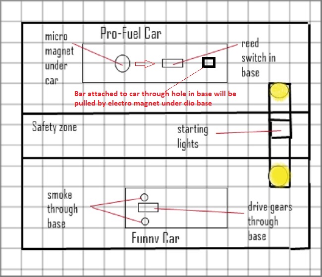

#184 Posted : 01 November 2020 15:29:18
Hi all, BigGrin
This update is to show the layout of the dio base (bad draw pad exercise), that I hope will give insight as to what I`m up to. The general idea is that I don`t want any permanent connections between the electronics base and the dio base, because the dio base must lift off the lower electronics base to refill the smoke generators with oil and give access to all the electronics. (Just in case Crying )
The smoking Funny car will be rigidly fixed to the dio base as will the rear axle drive, but not connected together. Saves shaking the car body to bits if the rear wheels get a shake on. So, as can be seen in the diagram a hole is required for the drive gear to pass through and work the rear axle, plus two holes to let the smoke through to the rear wheels. Hence the previous test beds I`ve made.Blink
The smoke generators will be supported by a frame no more that 2mm below the dio base and the electric motor and gears will be adjustable to get the correct gear mesh to the back axle
The longer Pro-Fuel car will move approx 3-4mm to get into the final start position. A bar that can be attracted by an electro-magnet will be attached to the underside of the car and through the dio base. A magnetic reed switch will be supported to sit in a cut-out in the dio base, but not attached to it. A micro magnet will also be attached under the car in a position that it will operate the reed switch when the car moves forward that short distance.
The switch in operation will start the next stage of the starting lights.
The attached pic is the badly done draw pad exercise I mentioned earlier that may help with the explanation above. By the way the final dio base will measure 740 X 450mm.

#185 Posted : 01 November 2020 15:50:57
Posts: 6,864
Points: 20,909
Nice work Derek,Love Love see everything is well planned. Base is going to be quite a size.Cool Cool
#186 Posted : 01 November 2020 15:57:35
Derek
That is all very well planned out.
Looking forward to seeing that baseboard starting to come together.
#187 Posted : 01 November 2020 18:28:15
Posts: 5,058
Points: 15,320
Crikey!
This is turning into a real epic! Looking forward to see it finally come alive.Laugh

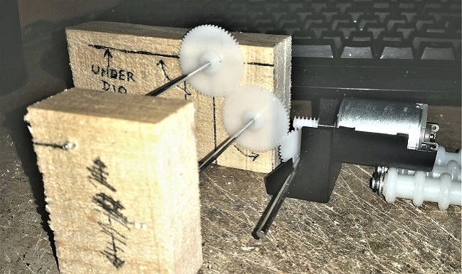

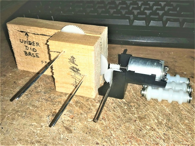

#188 Posted : 08 November 2020 18:13:03
Hi All, BigGrin
The next stage in the "Epic" having worked out the end height of the dio base was to make the exact gearbox drive to get the motor drive up to the rear axle of the Funny Car.
To save cost of hard wood the prototype is made from balsa block.
The gear height has to be millimetre accurate from the electronics base to the dio itself so the gears mesh accurately through the dio base.
So two pics:
1: Showing how the gears are set.
2: Showing how the gears will be enclosed.

#189 Posted : 08 November 2020 18:56:29
The way this has evolved as the build has gone on is brilliant Derek. Very impressive indeed and I have no doubt will look amazing when done. Love Love Love
#190 Posted : 08 November 2020 20:19:19
Posts: 6,864
Points: 20,909
Looking very good Derek. I can see this going into production after the prototype.LOL LOL
#191 Posted : 08 November 2020 20:24:24
Derek
I am impressed with just how you have thought all of this through and put thoughts into actual structure.
