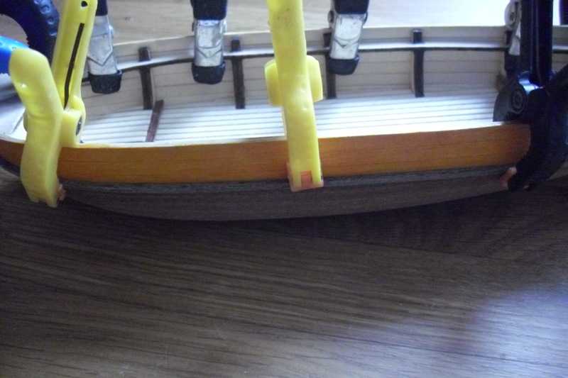

FORMING THE RUBBING STRAKES
While the wood is still wet I bent them (using mini clamps) around the hull and left them to dry thouroghly ( at least 24 hours ):-

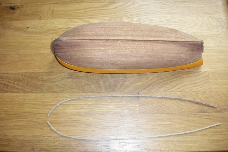

You can now see the shape firmly set in the wood, ready to fit.
as you can see I take my time to achieve the build I want, it is not a race.

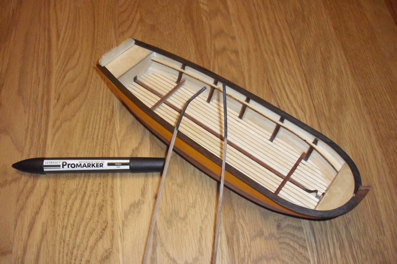

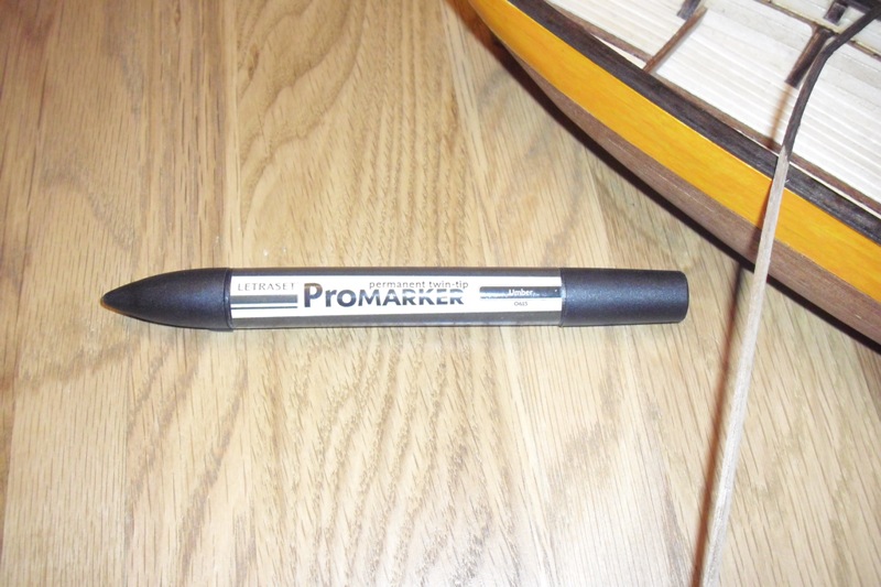

FORMING THE GUNWALES AND RUBBING STRAKES
Hi Team as you know I have been experimenting with different colours of ink, which I am now using instead of paint, it gives a better scale coverage. In the photo you will see the ink as orange on the Longboat.
I have also been experimenting with good quality felt tip markers and I am very impressed with the permanent twin tip PROMARKER by Letraset the colour I have used is umber.
Please see the result on the Gunwales and I have added a bit on the end of the Rubbing strakes which are apple wood this product really brings out the grain, see what you think:-

BigGrin Very nice work Mike, i too have used those inks in the past they give a very nice opaque finish as you say that shows the grain off well.My only concern with the pens your using is the fade over time if alowed to sit in bright light but i might be wrong there
#193 Posted : 14 July 2012 11:45:14
Hi Andy thank you for your comments, you are right about the fadeing, you must fix the surface after with a satin water based varnish.
