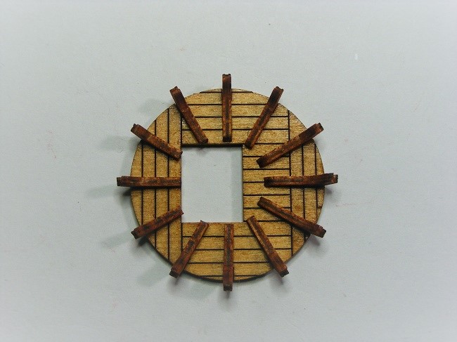

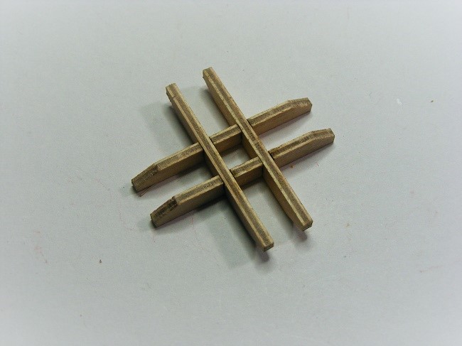

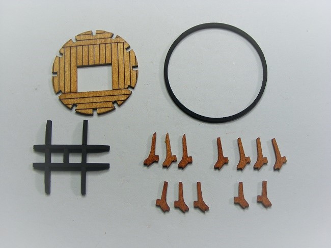

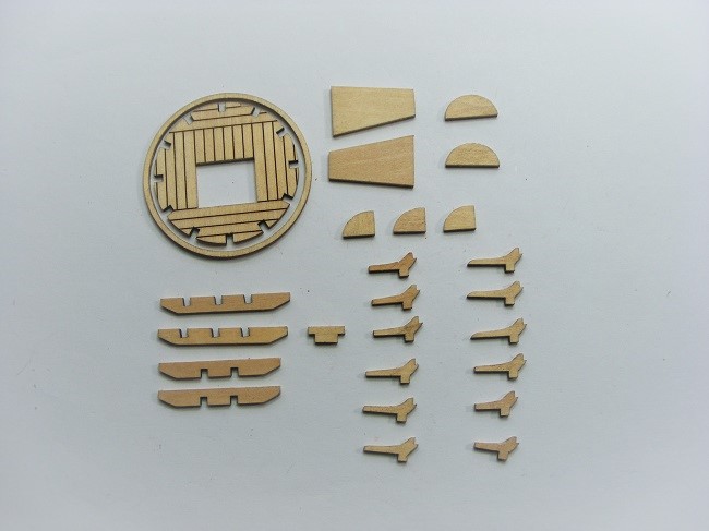

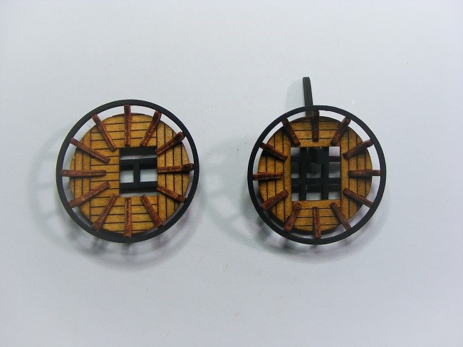

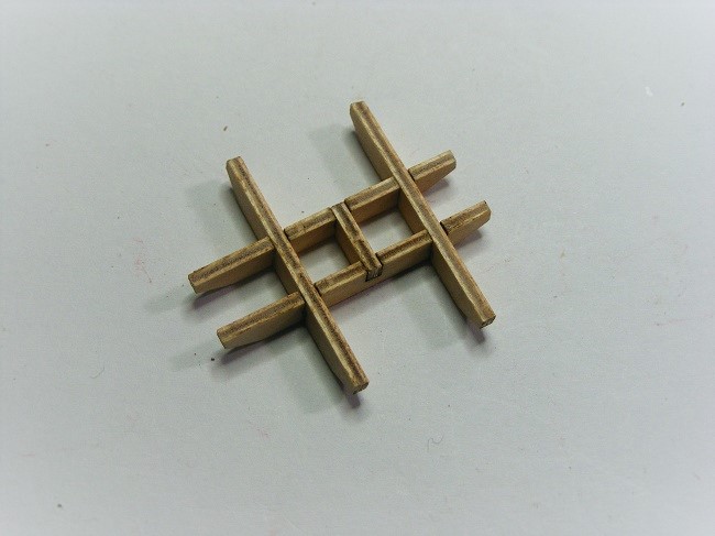

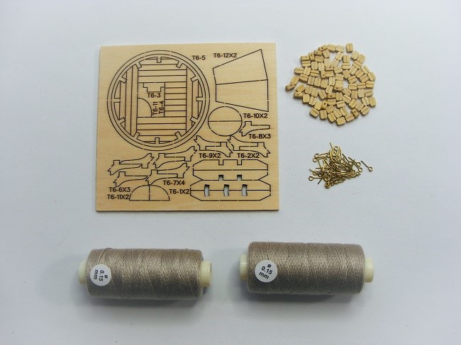

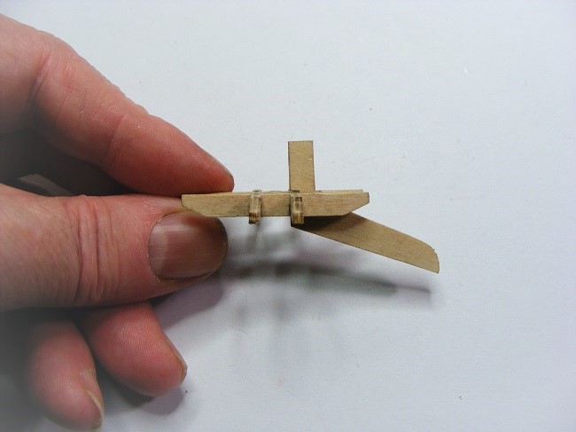

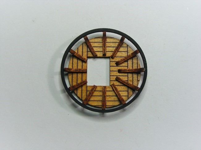

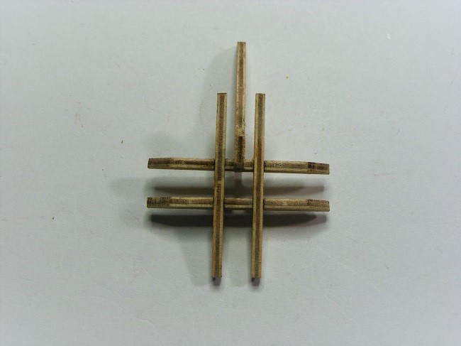

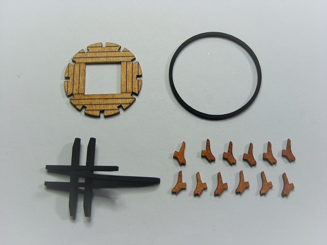

Stage 112 Contents: Mast Top fret, Single 4mm Blocks, Eyebolts and Natural Thread.
Remove the parts from the mast top fret (T6) and sand the edges smooth. Note: The staining/painting of the fighting top was completed as outlined in build stage 95 so won’t be repeated here.
Fit and glue the two crosstrees and the chock into the slots of the two trestletrees. Make sure that all the parts are at right angles to each other. Note the different lengths of the two ends.

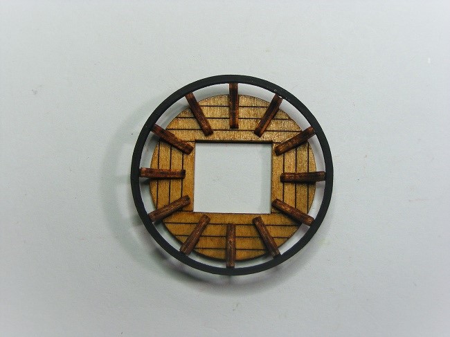

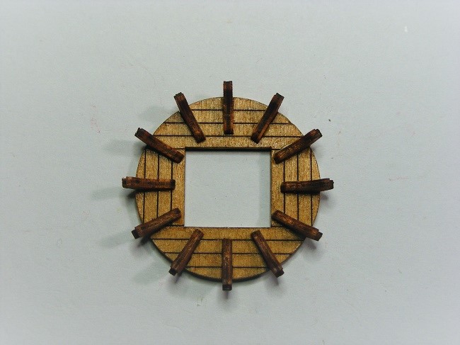

Test-fit and glue the ribs into the platform as outlined in steps 3 – 8 of the instructions. When dry, glue the circular rail onto the tops of the ribs.
Now glue the crosstrees onto the underside of the platform, over the opening. Pay attention to the position of the crosstrees ends.
Remove the parts from the fret (T5) supplied with stage 109 and sand the edges smooth.
Test-fit and glue the crosstrees together making sure that all the parts are perpendicular to each other. Glue the knee between the crosstrees, placing it centered and perpendicular to the trees.
Now test-fit and glue the twelve ribs into the notches in the platform. When dry, glue the rail onto the tops of the ribs. Glue the crosstrees onto the underside of the platform. Check that the crosstrees are centered over the opening.
Store the mast top assemblies and any unused parts in a bag labeled with this stage number.
This stage is now complete.

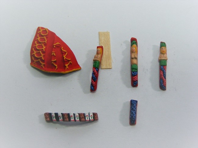

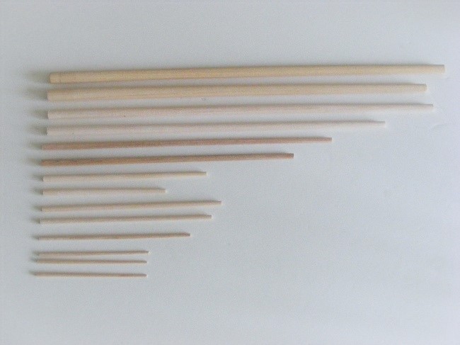

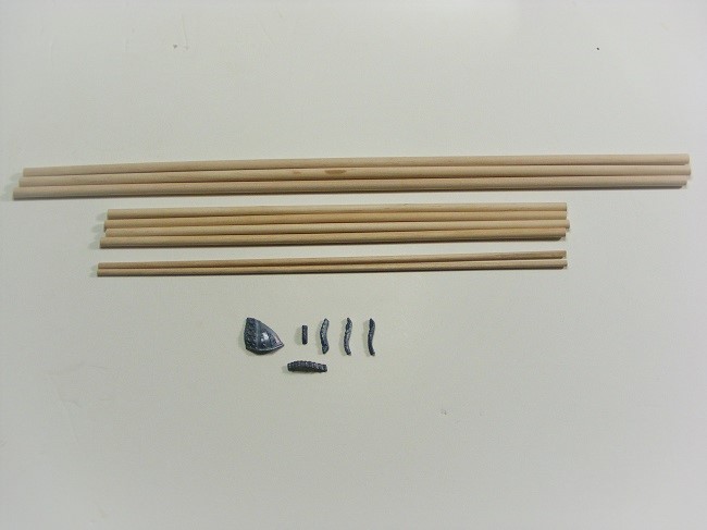

Stage 113 Contents: Various Wooden Dowels, Gallery Roof and Decorations.
Remove any burrs or flash from decorations C152, C152a, C152b, C152c, C152d and C152e supplied with this stage, then apply a coat of metal primer and leave to dry. Now follow the painting guide provided within the instructions to paint these decorations. When dry, carefully store the decorations in a bag labelled with this stage number.
In this build stage you will now prepare all of the mast sections. Use your own selected method of tapering the sections.
Retrieve the 12 x 400mm dowel from Stage 111 and cut to 395mm in length. Taper the dowel so that it is 12mm at one end tapering down to 9mm at the other, ensuring the taper is even along the full length of the dowel. Label the dowel as MM1. Now take the second 12 x 400mm dowel from stage 111 and cut to 374mm in length. Taper the dowel so that it is 12mm at one end tapering down to 9mm at the other, again ensuring the taper is even. Label the dowel as FM1.
Retrieve the two 10 x 380mm dowels from stage 111 and prepare them in the same way. First dowel should be 377mm long, tapering from 9mm at one end down to 7mm at the other. Label the dowel RM1. The second dowel should be 326mm long, tapering from 9mm at one end down to 6mm at the other. Label this dowel as BS1.
Now retrieve the two 7 x 300mm dowels from stage 111 and prepare them in the same way. First dowel should be 278mm long, tapering from 7mm at one end down to 5mm at the other. Label the dowel as MM2. Second dowel should be 240mm long, again tapering from 7mm down to 5mm. Label the dowel as FM2.
Retrieve the 6 x 300mm dowel from stage 111 and cut into two lengths, one of 156mm long, tapering from 6mm down to 4mm. Label the dowel as RM2. The second length should be 117mm long, tapering from 6mm down to 4mm. Label this dowel as BS2.
Take the two 5 x 300mm dowels and cut the first to 168mm long, tapering from 5mm down to 4mm. Label as MM3. Cut the second dowel to a length of 160mm, tapering from 5mm down to 4mm. Label as FM3.
Finally, take the remaining two 4 x 300mm dowels from stage 111. Cut the first dowel into two lengths, the first being 141mm long, tapering from 4mm down to 3mm. Label as BS3. The second length should be 102mm long, tapering from 4mm down to 2mm. Label as MM4. Take the second dowel and cut two lengths of 102mm, tapering both lengths from 4mm down to 2mm. Label these dowels as FM4 and RM3.
Store the mast sections and any unused parts in a bag labelled with this stage number.
