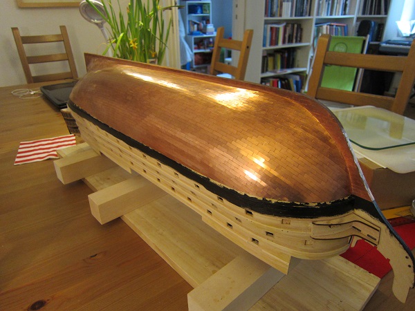

Hi, my friends!
Yesterday was a day to remember. Not only did the Austrian Ski-Heros (male and female) win the FIS-Worldcup once again (which i know, won`t be of much interest in a british forum BigGrin .
No, also - after 2 years and 2 months i finally finished the copper plating of the hull!!
I must say i´m very satisfied with the result as both sides really look symmetrical.
[size=8]Of course it`s not perfect and i will have to do some tidy up here and there (e.g. at the stern as i saw on one of the pictures). But as i said i`m very happy as it is. I never would have thought that i could achieve such a result - doing this for the first time.
I will now let it oxidise the plates for a while and then apply matt varnish.
Next steps (when i find time) will be the stern gallery and the rudder, which i would like to finish before turning the hull on its feet again.
Thanks for looking in,
z8000783

Looks pretty well perfect to me.
Wonderful job.
#184 Posted : 23 March 2015 19:28:17
A beautiful piece of work. That tiling looks so complex and I can just imagine how long it took but what a great finish you have achieved.
It will make such a difference to your finished kit.

Its a heck of a job but truly satisfying when done - nicely done
#187 Posted : 24 March 2015 00:18:37
Very impressive piece of work with the tiling Walter, well worth all the time and effort you have put into it....Cool Cool .. Very well done...

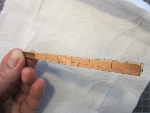

But here already comes my next problem:
How can you attach the rudder-hinges to the hull without destroying the plates?
Should i have attached the hinges before plating?
Or should i just super-glue the hinges onto the plates and make "fake-nails". Cause i don`t think i get the nails through the plates.
How did you manage this problem?
Thanks,

Hi Walter,
Great work BTW.
I just glued mine onto the copper plates.
Below is an extract from my build log.
While my attention is on the copper plating, I will mention the rudder.
Again,because of the time involved, I can't remember exactly, but the rudder supplied by Del Prado was incorrect. I think I used their rudder and re-shaped and sized it by adding additional timber.
I made the gudgeons and pintles from small brass tube,strap and rods, shaping as required and soldering the parts together, then painting black. Below is a close up of one of the gudgeon plates.
The rudder was then copper plated and the pintles fixed to it.
Here is the finished rudder with all the gudgeon plates next to it.
Also notice the spectacle plate above the copper on the right, I made this in the same way as the gudgeons and pintles. Below is a photo of the rudder in place, I have lifted it slightly to show the pintles fitting into the gudgeon plates.
#190 Posted : 24 March 2015 18:17:02

Thanks for your tips.
Steve, i certainly thought of pre-drilling holes through the plates - but i`m afraid this will deform (?) some of the plates or make them come off (excuse my english).
But i guess, i will have to try it and who knows, maybe it will work.
For me every step is try and error :)
I will let you know of the results.
But first i will finish the gallery supports.
#192 Posted : 24 March 2015 20:07:28

Stick a couple of copper tiles to a piece of plank off-cut, get a nice sharp micro bit in a pin vice and have a try. If you are only going to drill through the copper then a drill of the same diameter as the pins will do. If you are going to drill through the planks as well then a hole of a smaller diameter will be needed to make a tight fit for the pins.
You will also need to shorten the pins used in the rudder.
#193 Posted : 24 March 2015 20:38:31
The method I used was to gently hamer the nail point in through the hole in the hinge then remove the pin cut it short add a blob of CA and then push back in with a pin pusher. the sharp point will go through without deforming the copper tile.
