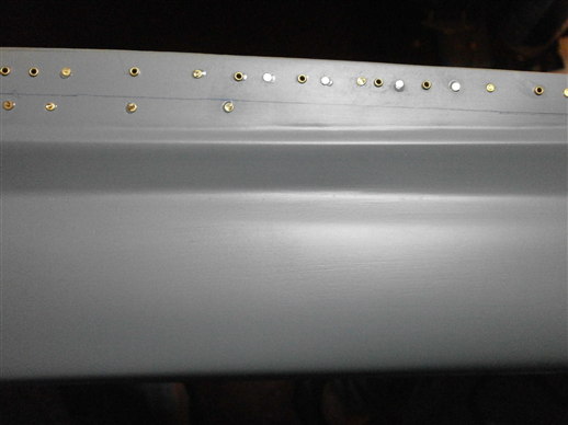

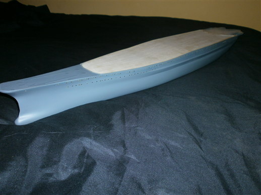

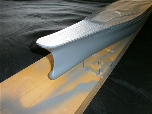

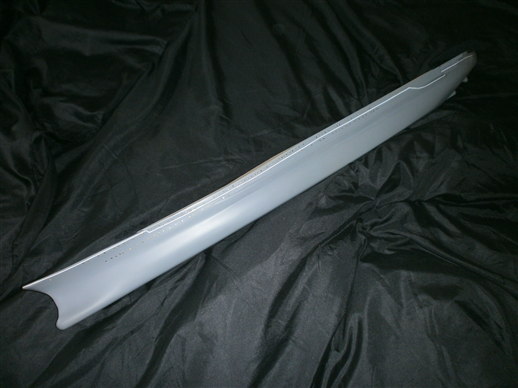

BigGrin Hi all

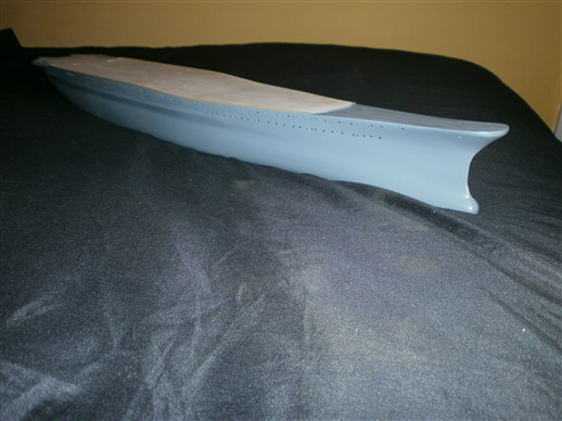

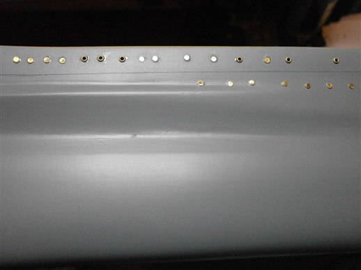

I managed to get all the front section portholes/blanks compleated with the suplied blanks [hope theres more to come so i can finish the stern areaBlink ].Next will be to add the degausing strips to the hull as ussual all coments and any questions are welcome

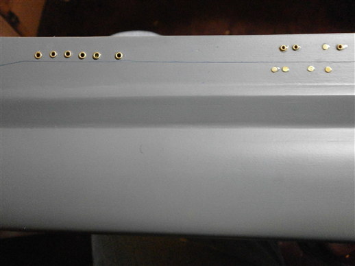

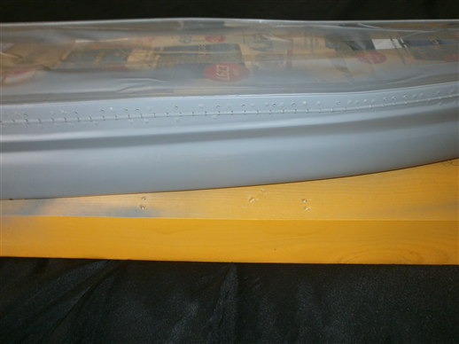

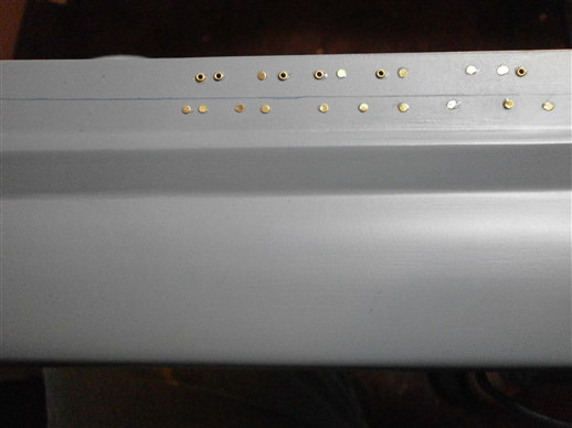

BigGrin Hi all

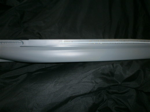

some progress on the degausing strips now 3 parts finished ,i will have to wait till i get the next issues porthole blanks to finish the stern area . As ussual all comments and questions are welcome

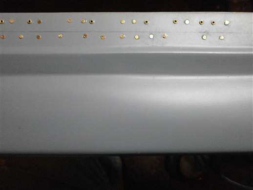

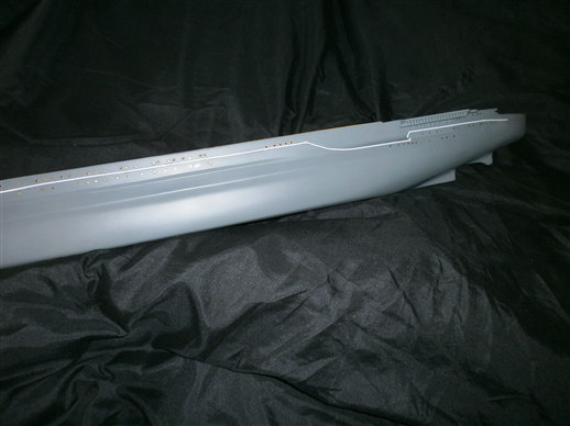

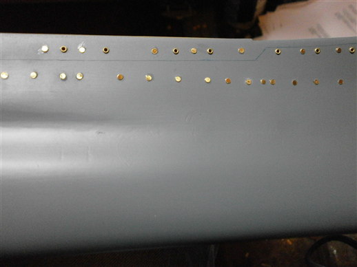

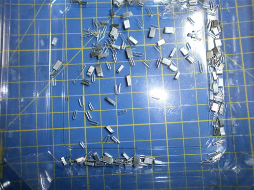

BigGrin Hi All

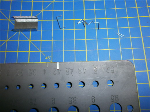

Another enhancment im adding is the fixing straps to the armoured degausing trunking, to do this i used staples cut in half then bent over a 1mm thick steel sheet to get the desired shape.To obtain the spacing im using an unused plank cut to size to drill small holes either side then the straps/staples are pushed home[probably way out of scale but its the look im after].It will take me a while to do but as my Akagi shipment went missingCrying in the post this month and iv had to reorder iv got plenty of time.All in all i think its improved the look of this area,as ussual all comments and questions are welcome

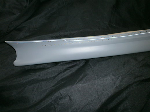

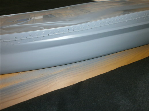

#191 Posted : 05 May 2012 15:14:50

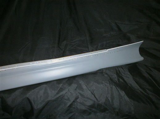

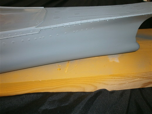

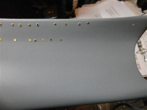

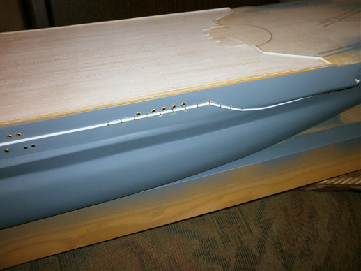

BigGrin Just a few pic,s of the bow/ midships with the brackets added,bit of filler to go on in places but overall the desired effect has been achieved i think.The stern area will be finished when i recieve the next issue, as ussual all comments and questions are welcome

The surface of the hull is very beautiful! Especially this code looks like a genuine article. I like it very much!Love

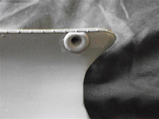

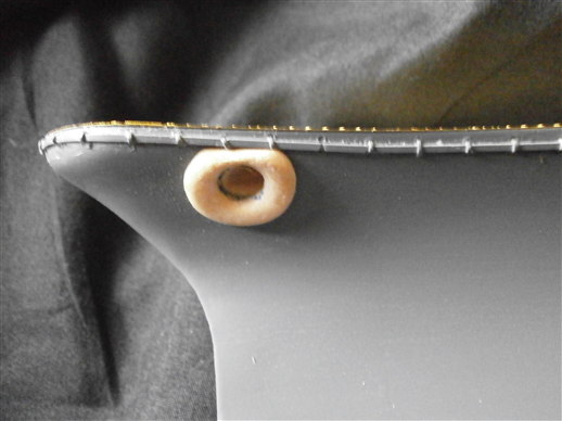

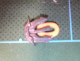

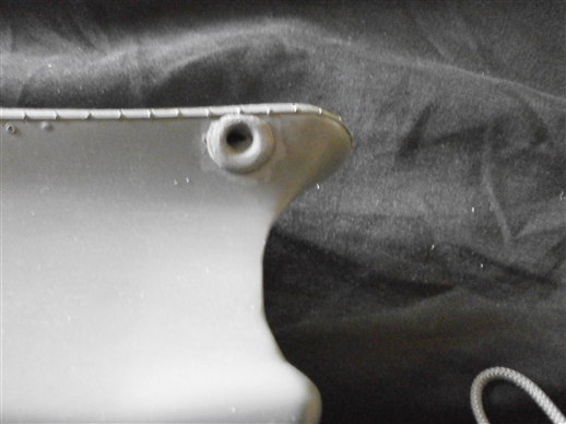

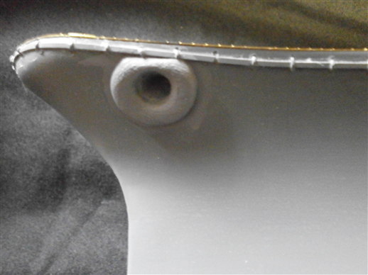

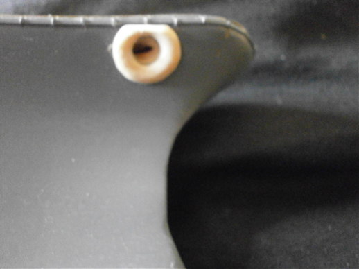

BigGrin Hi All

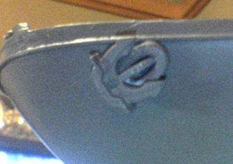

Another small enhancement added but 1st why i did it,in the official build the hawse pipe is represented by a piece of shaped wire but Mr T substituted a 7m plastic part made by himself.This although a good substitution it was never going to look right in my eyes so this is my solution.
Firstly i stuck four pieces of left over planking[2 by 5mm] together to form a plate[20mm by 65mm],then i drilled two 7mm holes through it.After that i marked the outer circle onto the wood and cut out both blanks.I then used sand paper and my dremel type drill to shape the pieces to the profile i wanted.
I had to do a little triming at the top as the degausing strip was slightly in the way[ on the full size Yamato the d/strip went round/followed the contour of the hawse pipe]but after some more shaping it fits quite well and now in my eyes looks more realistic.The parts were sealed and have only had a coat of undercoat so far.As ussual all coments questions are welcome

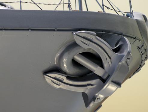

Yutaro HONMA
#198 Posted : 07 May 2012 15:45:21
Joined: 21/04/2012
Posts: 747
Points: 2,233
Location: Tokyo, Japan
Hi Andy!
I also support your reconstruction of the hawse pipes.Laugh
I send you a material that is a picture of the hawse pipe in 1/10 the YAMATO model in Kure YAMATO musium, but I was not able to judge if the hawse pipe was an ellipse or a circle.
Next pictures shows the hawse pipes of my Yamato model. They were made of putty. Although I did not have a strong evidence, I selected ellipse then.
Even if the hawse pipe is an ellipse or a circle, I recommend you not to remove the part of it because I have indicated the first picture.
That is my comment.
Best Regards,
Yutaro
#199 Posted : 07 May 2012 16:45:32
BigGrinHi All
after posting the last pics i decided that the hawse pipe still didnt look right[and as Yaturo-san has pointed out]so a small amount of reshaping has taken place at the top end, looks better now i think still needs a little finishing

HI Andy!
Great! Love I'm very surprised at your prompt work!
Best Regards,
