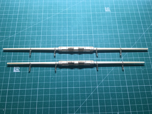

Issue 71 almost completed:
Fore yard fully rigged, only studdingsail booms require to be tapered, painted and fitted.
Will be done tomorrow.
Happy building!

Issue 71 completed:
Both studdingsail booms tapered with my usual well working method.
The they were painted and fitted to the fore yard assembly. Now it's completed.
Started to work on Issue 72:

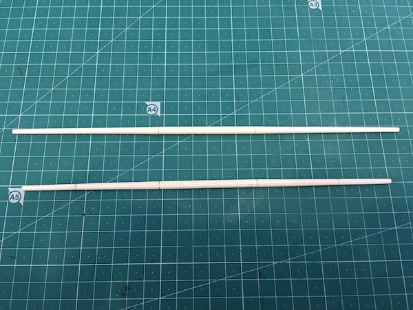

Faced with a problem immediately, the dowel for the fore topmast yard is bent due to a knot in the wood.
I will give a go with the tapering to see if it makes better, however I might end up to go to the local DIY shop and buy a straight 5mm diameter strip.
Happy building!

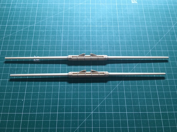

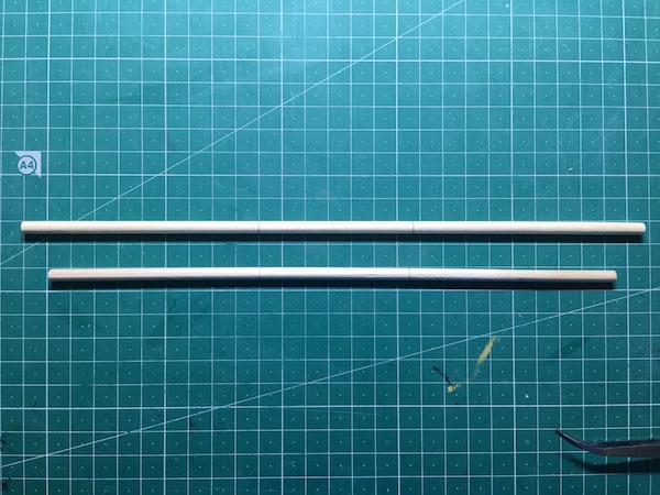

Started Issue 72:
The dowels for the main and fore top yards tapered to the required level, again, using my well working method with a pillar drill.
The fore top yard dowel is the replacement pine dowel. It looks/feels OK, it's not more bendy as the original one.
By the way... Happy New Year to all of you!
Happy building!
Laszlo

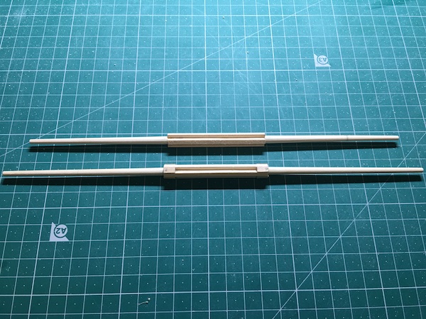

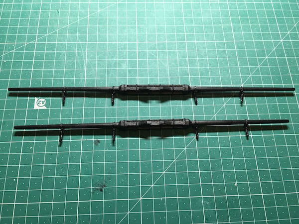

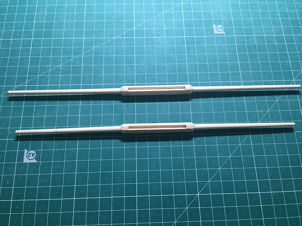

A bit more new year's eve activity on Issue 72:
- Central octagonal section carved on both yards
- All of the long strips added to both yards
- Filler strips added to one of the yards
Happy building!
Laszlo

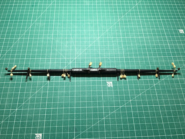

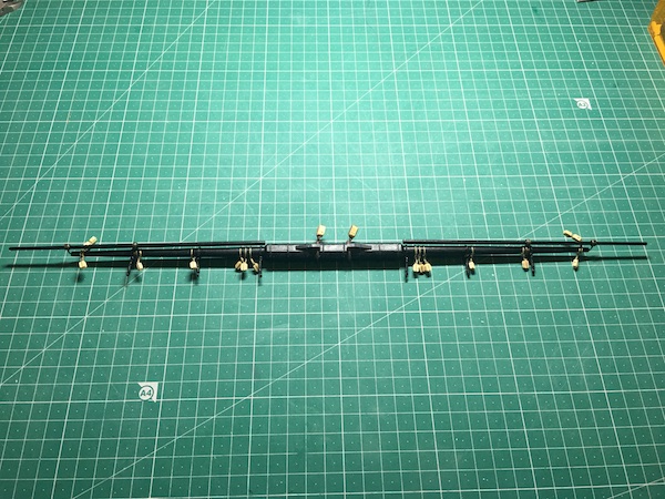

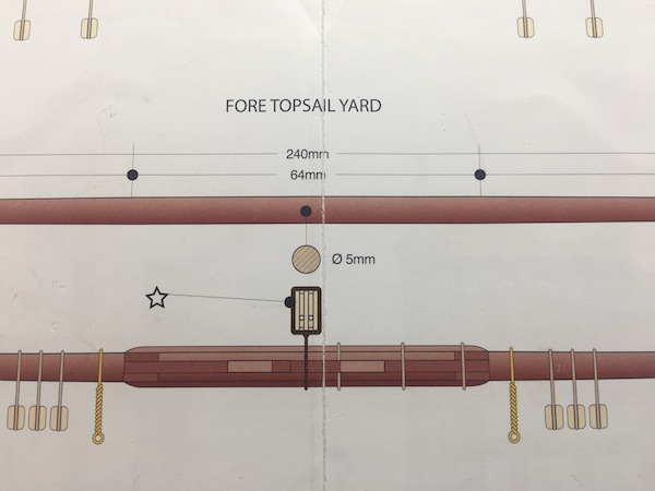

To celebrate the new year some more work done on Issue 72:
- Missing filler strips added and the octagons chamfered and sanded smooth.
- Slings and bindings added... by the way has anyone noted that there is an error on the fore topsail yard plan? It's not showing three bindings on the left hand side.
- Eight footrope supports made from thread, replacing the brass wire supplied in the kit.
- Footrope supports added to the yards
- Both yards painted black
Happy building!
Laszlo
