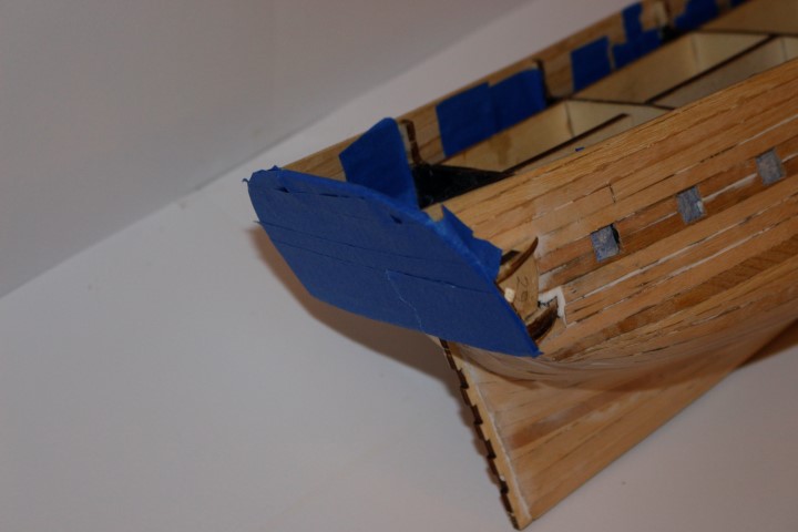

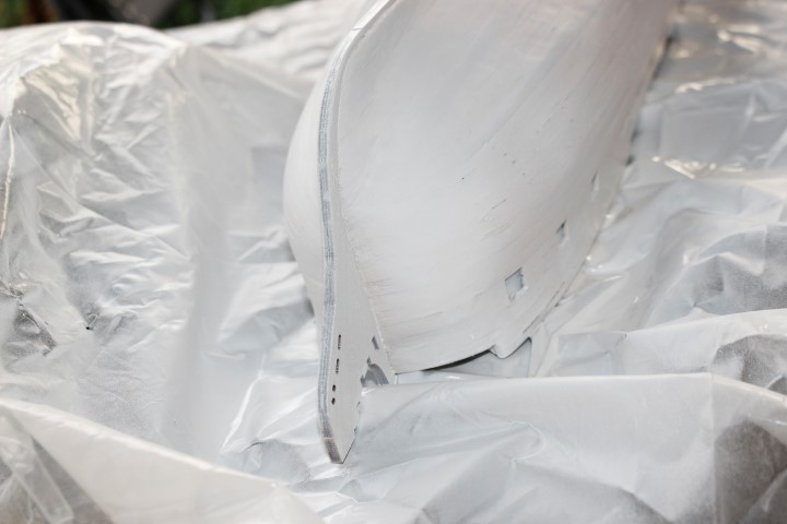

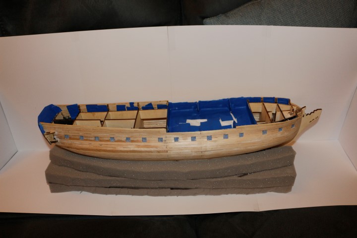

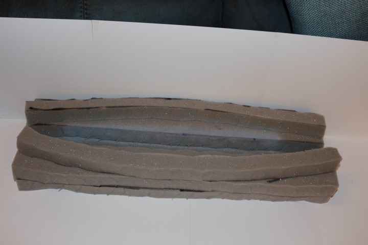

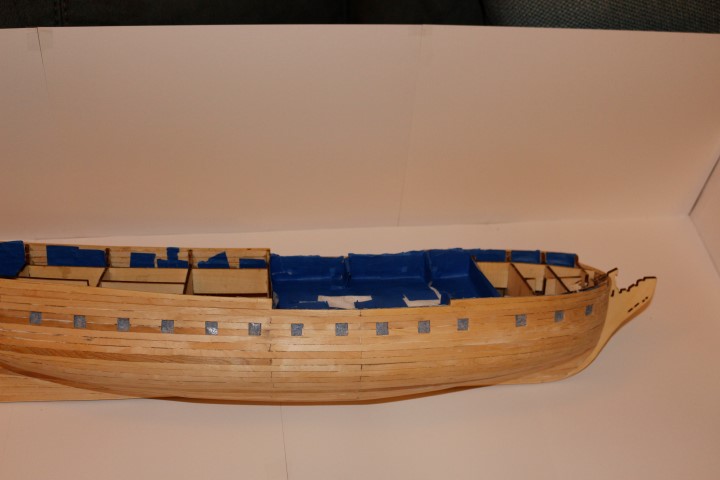

Small update on the HERMIONE build
STAGE 14
Welcome back to a small update my friends.
Stage 14 is concerned with laying a coat of primer paint on the hull. I haven't got quite that far yet (it's going to happen in the next day or so).
In the meantime, here are a few pictures of work so far.
The first 2 images are of the hull all masked up and ready for the primer coat.
The 3rd image is of a foam 'dry dock' which I have knocked together from some spare foam I had laying around. After the hull is painted, special care will need to be taken to prevent any damage to the paintwork whilst further work is carried out on the build.
So to that end, I came up with the idea of this foam dry dock which, although it's a bit 'rough and ready, it does serve its purpose. The last image is of the Hermione sitting in her 'cradle'.
I'll post another update over the weekend after the primer has been applied.
Thanks for looking in and special thanks to all who took the time share their comments with me.
Happy building
David

#184 Posted : 29 September 2017 20:44:33
She's looking good. I like the idea of the foam dry dock - simple but effective.

I needed something that would give protection to the paintwork as well as support the model while I continued working on her and the kit display stand just didn't seem as if it would be up to the job.
It's only 5 pieces of 1-inch foam cut from a roll I had lying around -
1 x large piece for the base,
2 x slightly narrower pieces to support the keel area and
2 x square profile pieces to cradle the hull.
All held together by a liberal application of PVA glue left weighted down overnight to cement the pieces together.
Like you say - simple but effective. She sits perfectly in it without any movement and I'm satisfied it work just fine for the purpose I have in mind.
Happy building
David

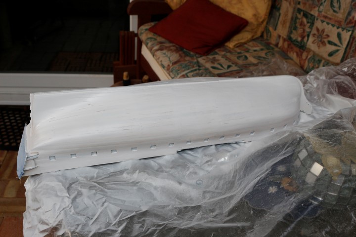

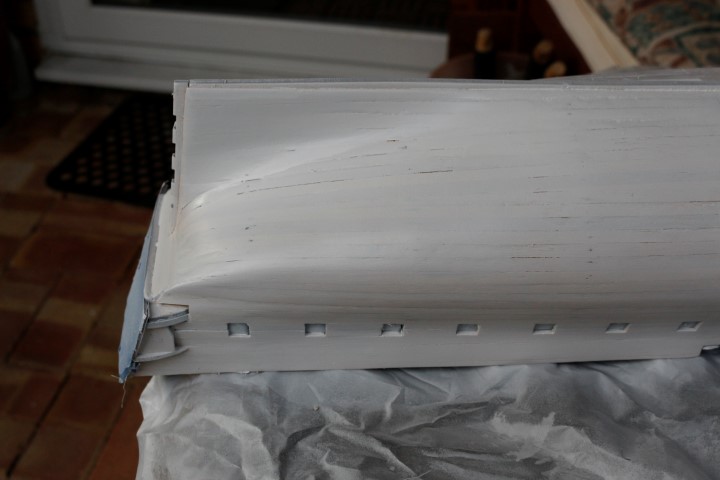

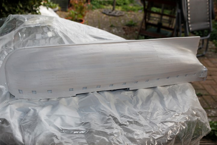

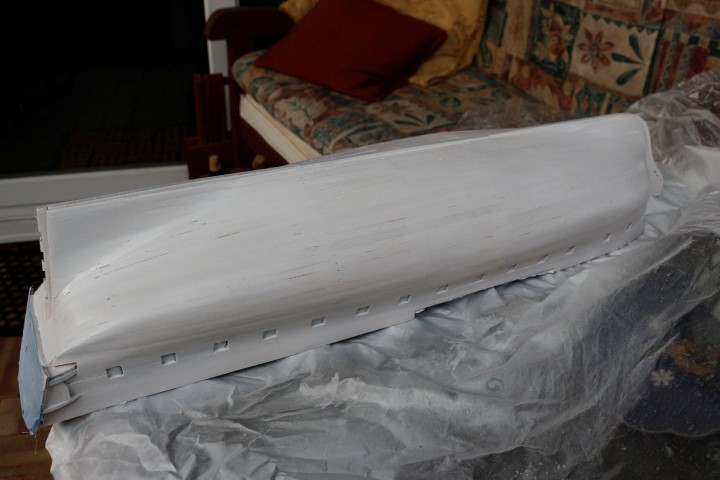

Update on the HERMIONE build
STAGE 14 (contd)
Hi again and thanks for looking in.
Well, today I got the first coat of primer onto the hull.
Although I was aware that the primer would show up any more imperfections, I never really knew just how much. Was I in for a shock!! It seemed like all the hard work I had put in was for nothing. There are lumps, bumps, cracks and holes everywhere, and the pictures don't really show how bad it really is.Crying
So it's back to the workbench for more filling and more sanding so watch this space.Mellow
Thanks for all the kind words and encouragement.
Happy building
David
#192 Posted : 30 September 2017 23:58:35
BigGrin Hi David
Do not be disheartened.
To get a good finish on a single planked hull takes a fair amount of preparation. Take a look at my Yamato build as this kit is also a single planked model. Stages #151 to #164 should be of interest:-
http://forum.model-space...osts&t=2756&p=9
Your previous hard work was not in vain as you got the planking to a reasonable finish and as always the first coat of primer will show up any defects as you have found.
What to do next.
Refill all obvious gaps with filler and sand back to get the hull back to the primer stage. The primer you have now will act as an indicator as you flatten back so you dont take off more wood in the wrong places.
Once your at this stage you need to respray with your white primer let it dry then respray with grey primer and allow that to dry. Next its more sanding as you sand the high portions will cut through the grey and white primers til it matches the rest of the hull, it will also show any dips that will need extra filling.
After this stage you should have a hull with no bumps but maybe a few dips that need filling so you now have two choices you can do , use a filler and sand back to the primer as above or get a primer filler like the one sold at Halfords [ the yellow one] respray the hull with a couple of coats and sand back. All the yellow should disappear and only stay in the dips which should be filled by the primer to make the hull smooth.
Finish off with a couple of coats of white primer and give a light sanding to provide a key for the top coat colours you will be applying.
Hope this helps.
