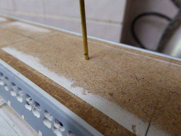

Once happy with the 0.5mm holes, I replaced this profiled piece back into the bottom of the tower and lined the whole assembly up on the top deck. Using the 0.5mm diameter holes I could mark out their position on the top deck. I then removed the conning tower and drilled through the top deck with 0.5mm dill bit in a pin vice followed by a 2.0mm drill. The reason was that I wanted to fit brass dowels to the tower so that I could work on it separately in the future knowing that it would always locate correctly on the top deck when it comes to fixing it.
I also used a small off-cut of laminate flooring as a temporary display stand for the conning tower. The same procedure followed as per the top deck, marking out the pilot holes using the profiled piece in the tower then drilling through with a 2mm drill bit to except 2mm brass rod. The advantage of this is that the tower remains flat even though it has two brass dowels protruding from the bottom.
The attached photo shows the brass rod being worked into the 2mm hole on the top deck, making sure that the fit wasn't too tight.

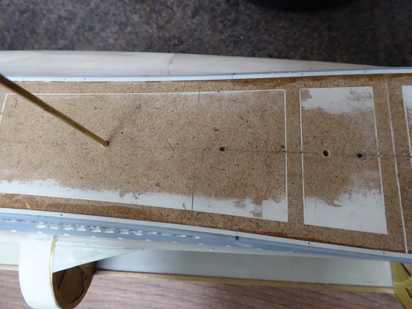

#189 Posted : 14 February 2017 19:38:58
The next phot shows the same procedure for the second locating hole. You can see the first hole here also in the picture.

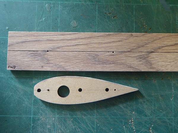

#190 Posted : 14 February 2017 19:42:37

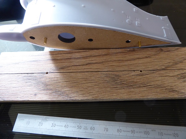

In this photo you can see the mdf profile piece lying next to the off-cut laminate i'm using as a temporary stand for the conning tower. The two 2mm brass holes have been drilled through on the laminate to except the brass dowels and the mdf profiled piece has the holes ready.

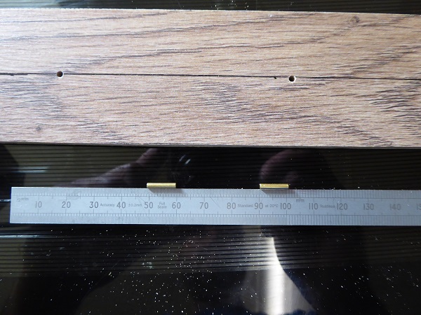

#191 Posted : 14 February 2017 19:43:53
The attached photo shows the two brass dowels cut and filed to size.
#192 Posted : 14 February 2017 19:46:10

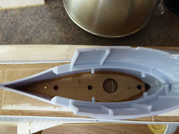

This photo shows the 2mm brass dowels fixed in place on the profiled mdf piece. At this stage the mdf was also glued and fixed into the bottom of the conning tower.
#193 Posted : 14 February 2017 19:47:28

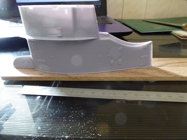

This photo shows the conning tower lined with the laminate stand.
#194 Posted : 14 February 2017 19:48:45
This photo shows the tower in place on the laminate stand, the dowels holding it in the correct position.

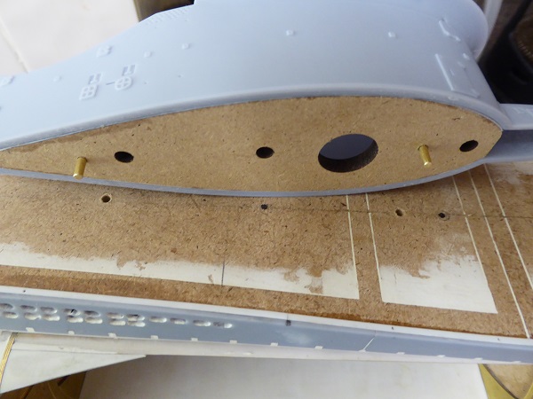

#195 Posted : 14 February 2017 19:50:09
The attached photo shows the conning tower dowels lined up with the top deck locating holes.

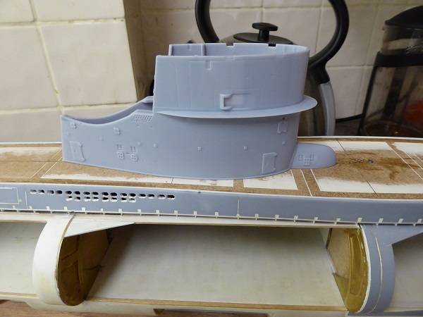

#196 Posted : 14 February 2017 20:19:58
This picture shows the conning tower in place on the top deck.
#197 Posted : 14 February 2017 20:21:12
This view is looking down into the conning tower wher the brass dowels can be clearly seen.

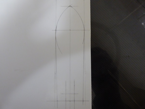

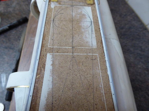

The attached photo shows the start of the marking out on the top deck of the modified conning tower profile. Getting all those compound curves to line up with a nice, smooth flow involved a good old dig around in the food cupboard for jars and glasses.
I think I used a half pint glass and a jar of mint sauce to form the curves. LOL

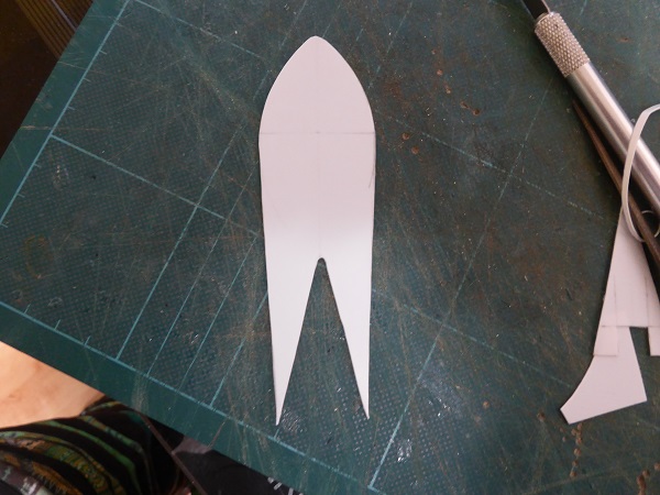

Using the same patented [ahem] technique for marking out the curves on the top deck I then drew out the same profile on a piece of 0.5mm plastic sheet.
#200 Posted : 14 February 2017 20:28:30
This photo shows the plastic profile cut out.
