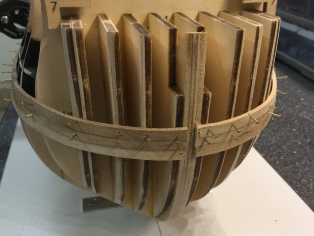

Thanks M8s. Here she is with all of the third, and part of the fourth, course of planks. I've put up a big sign with bold letters on my bench that just says "Chamfer" as I forget until after one edge of the plank is covered in glue. All-in-all looking pretty good for a first planked hull kit.
BigGrin BigGrin BigGrin
DSoldano attached the following image(s):

And here's the bow with the gap for the keel.
Planking definitely gets much easier after the first course.

#193 Posted : 02 July 2015 14:07:41
looking good.
Just make sure the plank ends at the bow go suitably far over the keel edge to alow you to cut them back without leaving any gaps. you will need a 4mm gap so you need the gap to be narrower for now.

#196 Posted : 02 July 2015 20:35:28
DSoldano wrote:
Johnny, Thanks.
Jase, thanks for the info, I was going by the photos in the official build and wasn't sure of the correct gap. I just measured my work. It turns out that except for the first 2 planks laid (the first course - 1 per side) it's exactly 4mm at the moment - dumb luck i guess - I'll be sure to make it narrower going forward.
Hi Dominick, look at the official diary, issue 21 again. Instructions do say to leave a 4mm gap between the planks ends at the bow, they don't need to be any narrower than this. Later in issue 39 you will widen the gap even further to 6mm to accomodate the stem. Cool Cool .. Hope the helps..

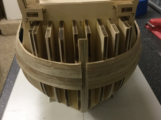

I took a bunch of pictures of the first 6 rows of planking. I only have the iPad, the wife and I are on a mini holiday over this weekend. Its Independence Day here in the U.S. So I will need to upload one per post - I wonder why I can't correctly upload multiple photos to a post from the iPad?
The first few are of the bow area.

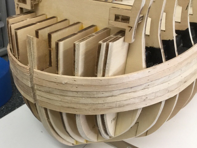

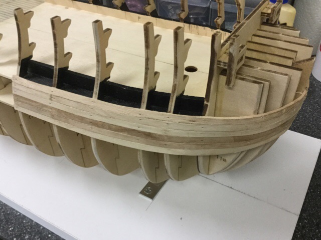

DSoldano
#199 Posted : 04 July 2015 00:04:03
Joined: 25/04/2015
Posts: 154
Points: 462
Location: Northern California, USA

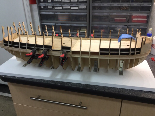

#200 Posted : 04 July 2015 00:04:53
Joined: 25/04/2015
Posts: 154
Points: 462
Now the sides...
