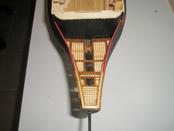

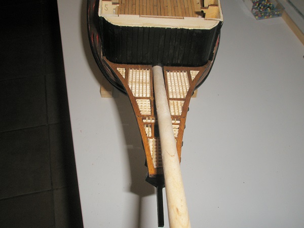

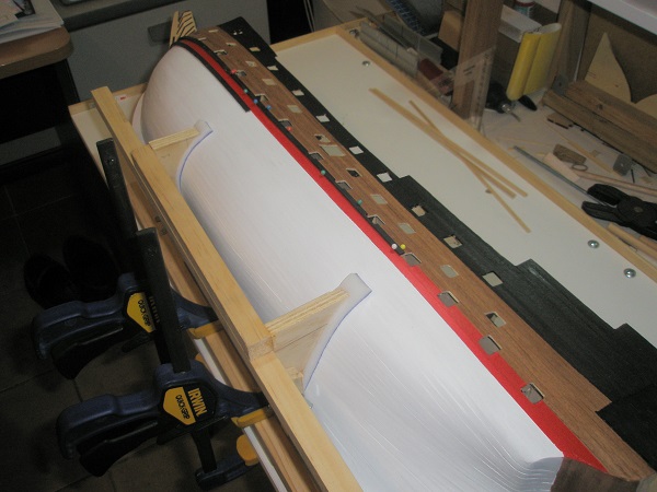

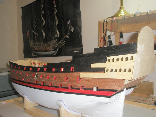

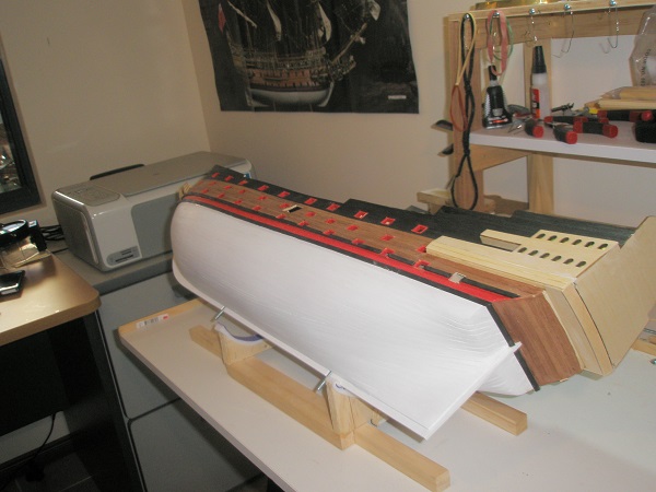

#184 Posted : 30 May 2015 04:22:52
Joined: 25/04/2014
Posts: 374
Points: 1,134

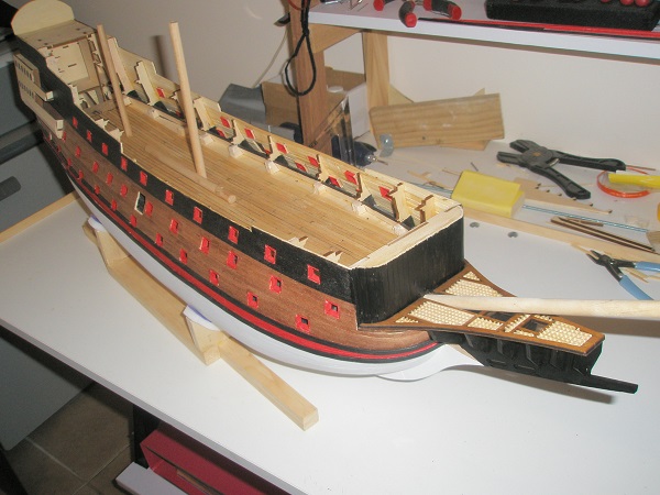

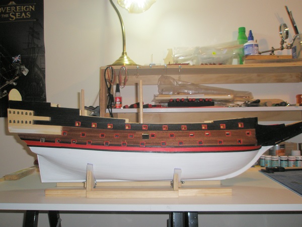

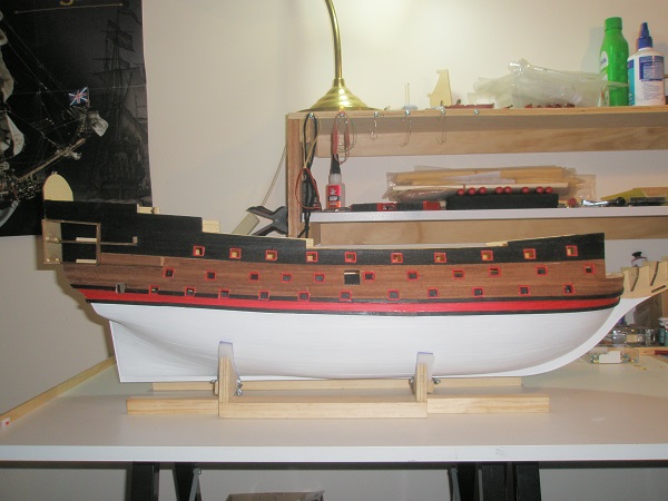

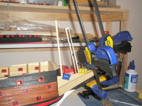

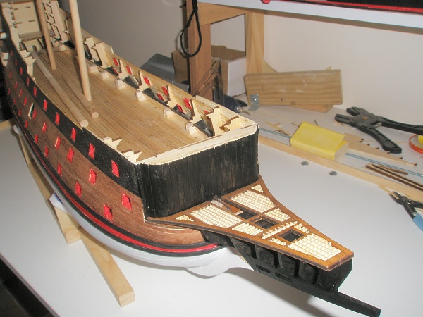

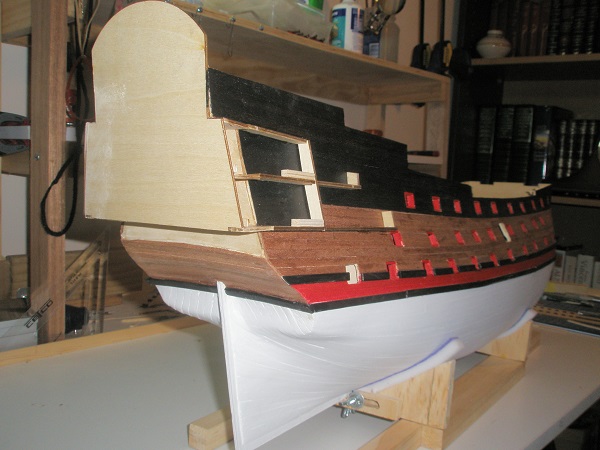

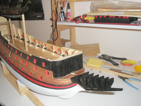

Hi Everyone
There was no Progress for April and the first couple of weeks of May 2015...Blink
However, the last 2 weeks of May were reasonably productive and Progress is reported below;
Working through Issues 40, 41, 42 and 43.....
- Completed gunwales and gun port linings Port side...Cool
- Installed Stern galleries both sides. Had a bit of bother with the little bamboo planks under the gallery window panels, but a little packing here and a little wood filler there had it fixed to satisfaction...Cool Cool
- Installed and painted forward bulkhead and Beak support...Cool
- Beak platform constructed and dry fitted, together with bowsprit ( which as supplied is warped at different angles in 2 different places) A new piece of 10mm dowel will be needed to replace it...Cool
- Beak platform garniture installed - some serious clamping required here to ensure it all stayed stuck where it was supposed to stick!...BigGrin BigGrin
- The last photo shows my build looking similar to step 22 of issue 43, for which I am quite happy about...BigGrin BigGrin
Happy building to All
Best regards
JohnP

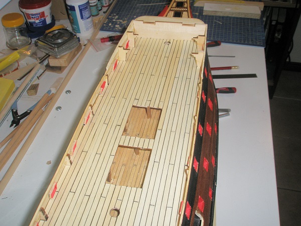

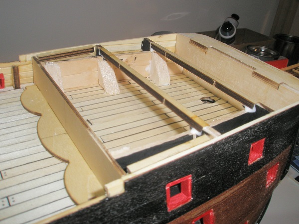

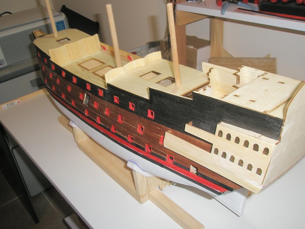

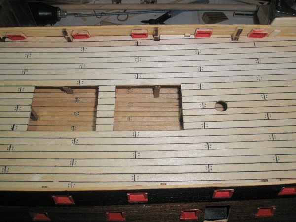

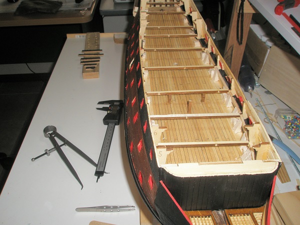

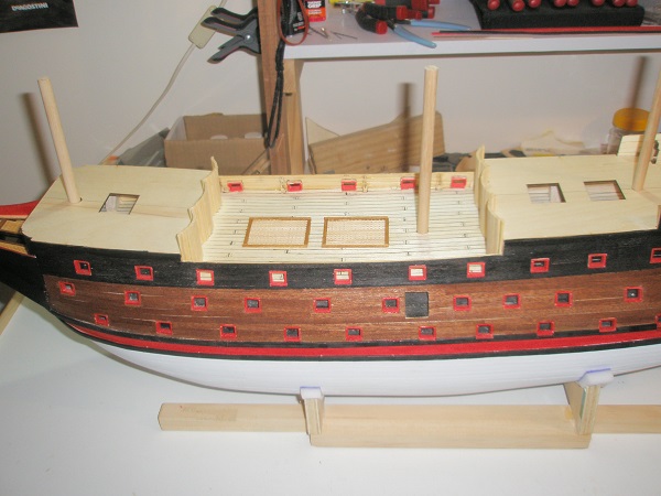

John Passmore
#191 Posted : 30 June 2015 09:37:10
Joined: 25/04/2014
Posts: 374
Points: 1,134

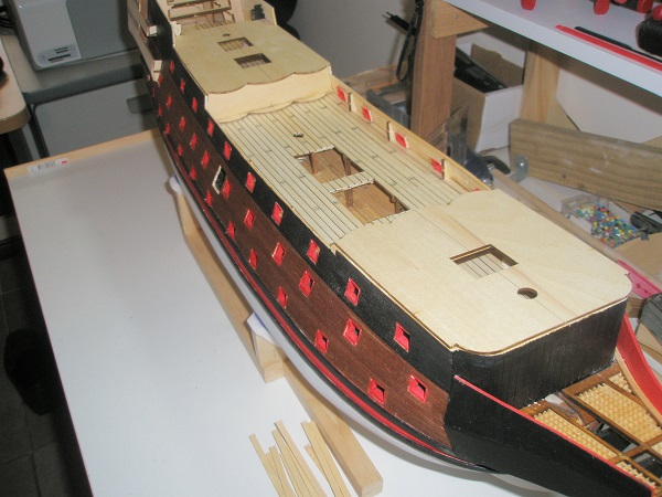

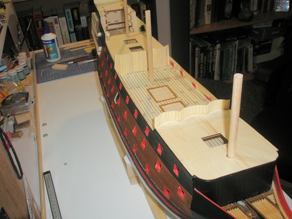

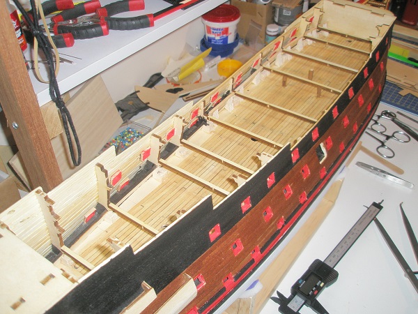

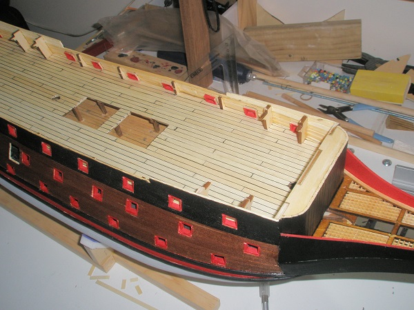

Hi Everyone
Below is my progress for June 2015
Working through Issues 44, 45, and 46...BigGrin
Installed false cannon supports with additional buttresses...and 3rd deck support beams...BigGrin
Thought I'd be a Smart Alec and fit the 3rd deck planking before installing the deck plates...Blushing Poor decision that...Blushing as I had decided to use 0.5mm black rigging thread for the caulking. I had not considered the difficulties of achieving accurate continuity of the planking across the deck plate joints, nor the tangle created by all the loose ends of the rigging thread...Blushing The first deck plate finished up looking like a dog's breakfast...Blushing Blushing I've included a photo below...Blink
So I changed course and installed all the deck plates first - as per procedure - after a lot of messing about putting the first piece right...Blink BigGrin
I'm going to leave the deck without surface treatment as I prefer the scrubbed, bleached look I remember so well from my old seafaring days...BigGrin
For the nailed look I just used a HB pencil using a template I made to get a semblance of uniformity...Cool
Then it was time to install the forecastle deck and quarter deck. Once again I buttressed the false cannon supports. The top of the hull strakes under the foredeck were a little too much flared outwards, so with careful use of a long clamp was able to reduce that by 2mm each side. There is still a slight step of about 1mm each side which reduces level at about half way forward...Cool
All the mast holes line up nicely...Cool
The curved bulkhead strips at the back of the foredeck are 18mm above the deck and not 15mm as specified. I cut the strips at 41mm so the conclusion is, the rear edge of the deck is sitting 3mm too low. Can anyone advise if this will be a problem in future?...Confused
The quarterdeck dimension is spot on...BigGrin
I have up to Issue 68 under the bench so plenty of WIP in the offing...BigGrin
Happy building and best regards to All
JohnP

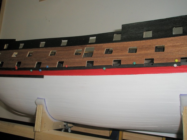

Thanks for looking in and I've figured out how my little problem occurred...Blink
I have shaved too much off the top of the bamboo hull planks so the vertical at half way between 2nd & 3rd gunport is too low...Blushing
I had carefully followed a line from top of rib 2 over tops of ribs 5 & 6 to arrive at that point...Blink
Consequently, when the deck was trial fitted there was a small gap along the forward edge... I fixed that by sanding the platform at the top of the forward bulkhead! What I SHOULD have done is add another bamboo hull plank and then trim to compensate...Blushing
However - all is not lost - I have yet to plank the deck and have a plan of rectification forming - watch this space!...Laugh
JohnP
