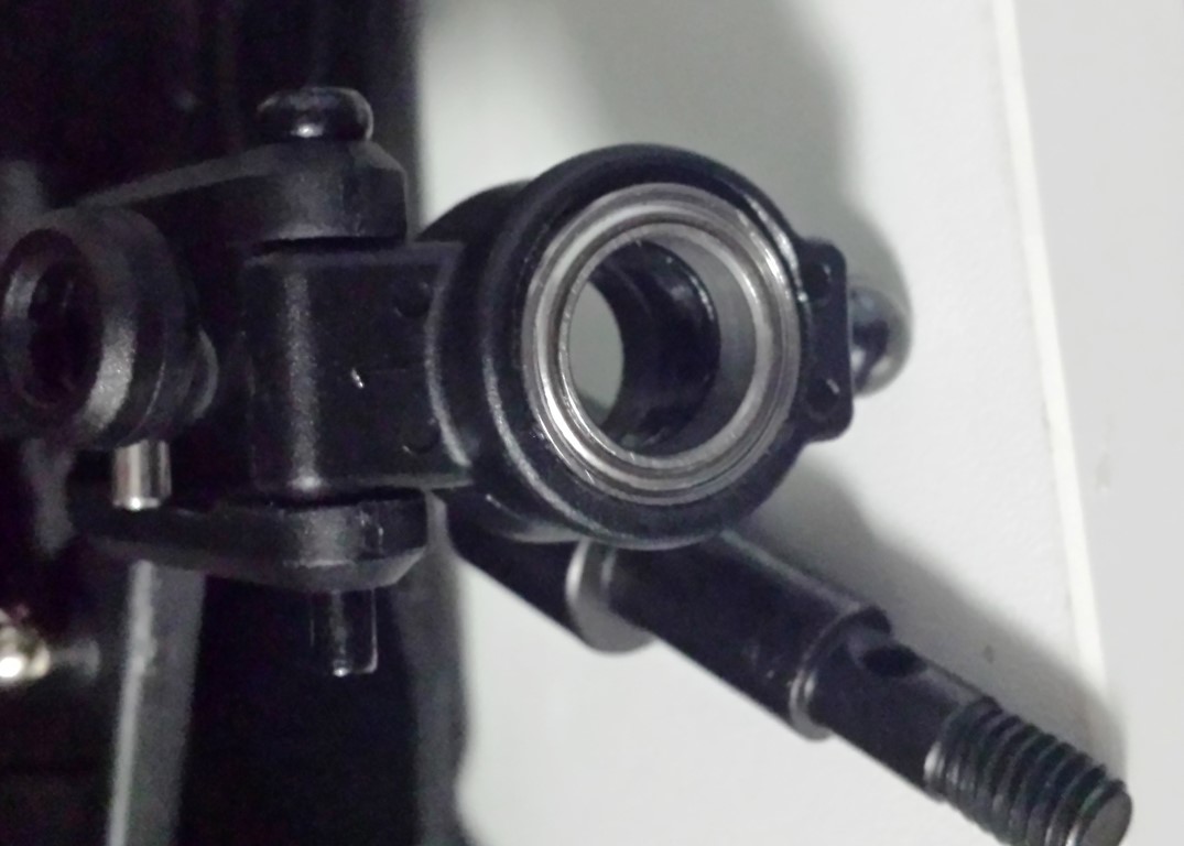

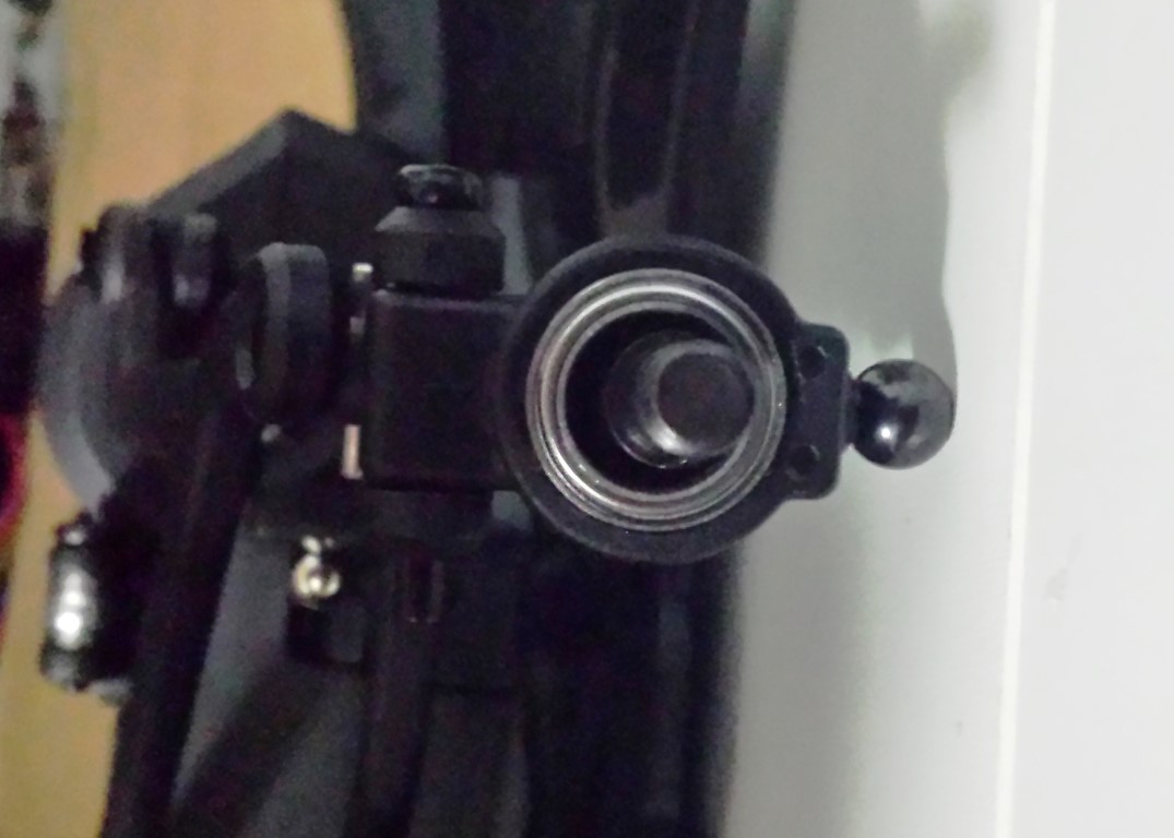

Has anyone else with recent Australian issues 44-47 encountered concerns assembling the left rear hub carrier with bearings?
I found the bearings to be a very tight interference fit in the hub to the point that deformation in the hub plastic is evident after being squarely pressed in.
I also note that there is substantial play inside the bearing to the issue 46 left rear wheel shaft unlike the neat fit visible in the issue assembly pictures as well as the pictures in post #6 here .
Could it be possible that the incorrect bearings have been supplied in issue 45?
#2 Posted : 14 February 2014 09:20:47
Can you post up a photo of your hub carrier and bearing and also provide the overall diameter size and inside hole size of your hub bearings.
rb7coastie
#3 Posted : 14 February 2014 12:01:35
Rank: Beginner Level 1
Joined: 14/02/2014
Posts: 6
Points: 18
Location: Central Coast NSW
The inside diameter of the bearing is ~10mm and outside diameter is ~15mm
The diameter of the shaft is ~8mm
I've since noted the materials list on page 11 of the issue indicates the bearing should be 8x14x4mm which explains the tight outer and loose inner fit
rb7coastie attached the following image(s):
#4 Posted : 14 February 2014 12:26:33
Definately an incorrect bearing size you have there, presumably both bearings you have are of the same size and did they come from the sealed parts pack?
They should certainly be 8x14x4mm
You need to contact customer services for a replacement parts set. In the meantime I'll pass the info to onto the packager, though at this stage we unaware of anyone else having reported the same finding.
