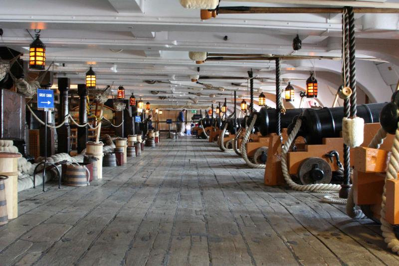

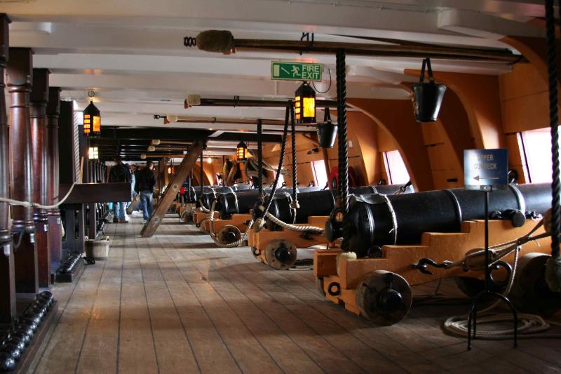

#10 Posted : 08 August 2010 15:59:11
Hi Shipmates! BigGrin
Here is two pictures showing the supports on the gun deck. Just a little shaping to do on the lathe, then square the ends and your got it.
Son of Bulwark attached the following image(s):

Just been looking a few pictures of Mr T's build and wonder if the ply decks will be strong enough and the fact there will be no weight on this deck?
Just thinking aloud here.

Will it be worth lathing them etc? what I mean is will we be able to see them later on? if so, it's worth a try!

Good point, but for those building the Gundeck version a little bit of extra strength maybe good, especialy if scratch building some parts means pushing pins or such into the deck?!?!?!?!BigGrin BigGrin
I wonder if Dag will be supplying the Fire Exit signs. I want it to look authentic for this money.
John
Son of Bulwark
#16 Posted : 08 August 2010 17:43:11
Hi z8000783! Laugh
Nice one! John. You'll only need one if you what it up to date with the last refit and to conform with health and safety. Flapper
