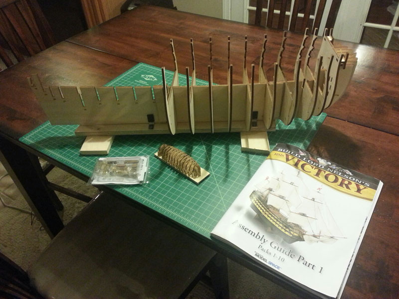

Finally got time this weekend to do parts 1-10. Since we get monthly shipments, I'm not sure if the parts match the UK parts. From reading the main build diary, it looks close, but not exact.
I am having great fun so far. Definitely hooked. My only problem is that I glued in the first few ribs before I read "Tip: Don't glue in the ribs yet". I hope I didn't sabotage myself.
I will create a list of tools/items for folks that have no experience with models and thus having no hobby tools, etc. I haven't gotten to the planking yet. Of course, the right tools make everything so much easier.
My 12-year old daughter wants to do the 34-foot launch once she saw me putting it together. She did do the frame with a 2 recoverable errors. I told her to read twice before doing anything. Of course, she's 12 and knows everything so we'll see how this goes. :) I'll need to order the paint before we go much further so it'll give me and her some time to think about what sort of arrangement we'll attempt.
Here's the US Part 1 (Packs 1-10) with my $4.20 dry dock! BigGrin

Good to hear your enjoying the build and I don't think that you will have a problem with the glued frames if you have used PVA glue wetting the joints with hot water should free them if required.
What a gem of a daughter you have showing an interest in making models and mistakes are only learning curves to do better next time.
The planking can be daunting but with the help of the various diary's on here most problems can be solved with ease , one golden rule is don't force a plank to go where you think it should be let it go where its sitting comfortably. If you look at my latest posts on the Santisima Trinidad build I have shown an example of the use of tapers to plank a hull.
