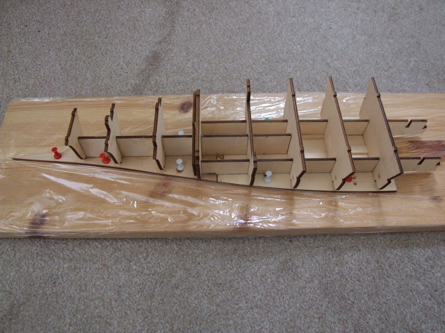

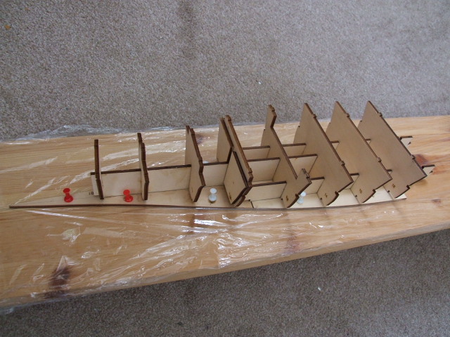

Started by drawing a centreline down my timber base and covered it with 'clingfilm'. (this will be cut back to the keel sections as the build progresses. Marked and drew centrelines on the keel sections and pinned them to the base. Dry fitted all bulkhead sections in place until I have all. Decided at this stage resist temptation and not build any of the metal bits as they are safer in their respective packaging.

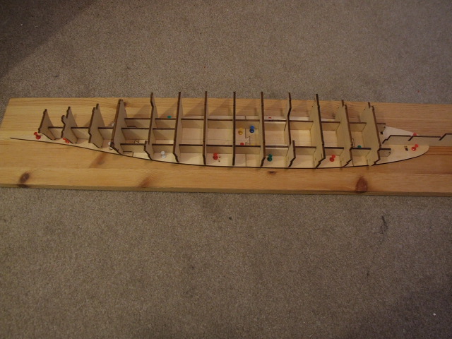

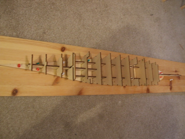

Second package has arrived and have been able to get on with the build. Pinned all the keel sections to the base (predrilled to prevent any splitting) and glued all the supplied frames into place. Still resisting gluing any of the metalwork.

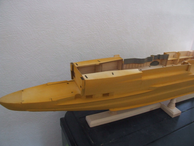

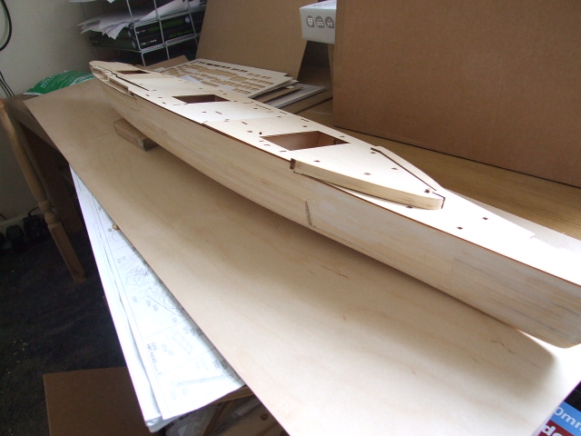

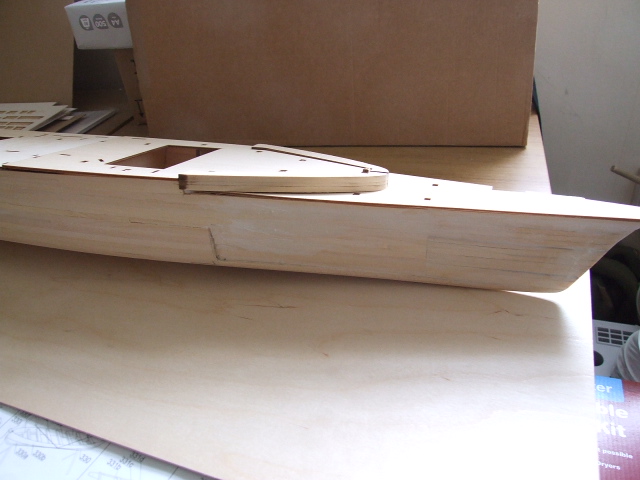

Have been saving issues until I had enough to do the planking in one go. Rough sanded to shape, will complete when armour belts have been applied.
Decks dry fitted at present
Cheers
Ken
Ken attached the following image(s):

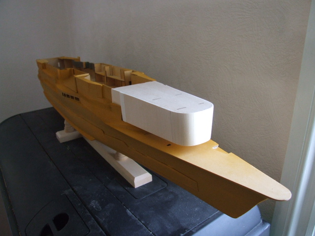

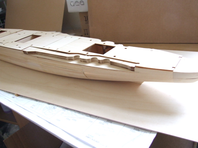

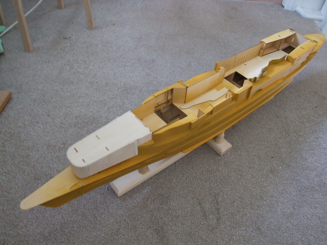

Its been quite a while since I have posted anything. Have been collecting parts and had a session of putting together as much as possible. I have decided to eventually fix the flight deck permanently so will not be fitting any of the internal parts that will never be seen. To date its only the wooden parts that have been assembled. White metal and PE will be assembled and fitted when required.
