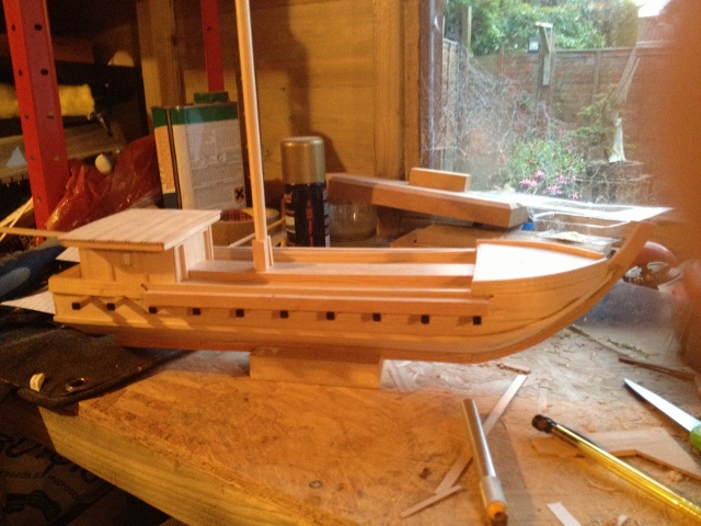

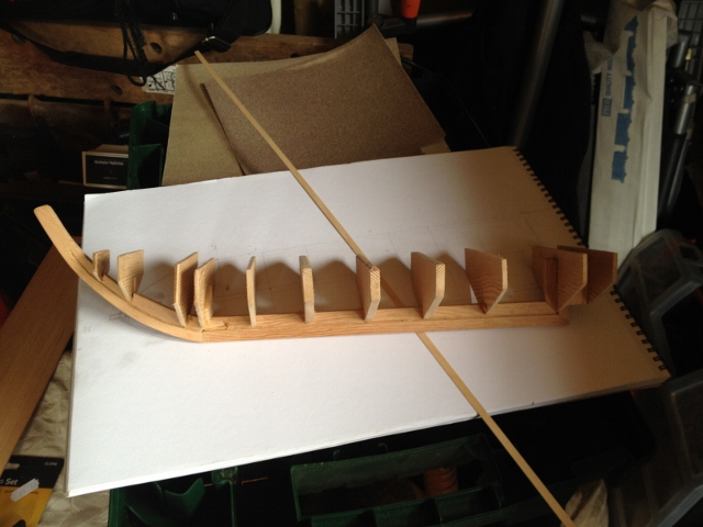

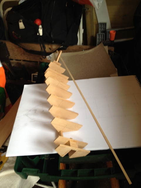

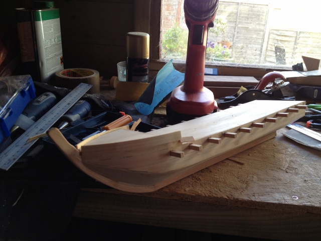

Having never built a wooden boat before and having been a carpenter I thought how hard could it be!!!!
Of course it had to be japanese as well because of my martial arts. I soon found there were no kits on the market and little referance material other than my trusted dvd of shogun,so using the scenes of the samurai galley from the series I produced a whole set of drawings from the dvd and proceeded to scratch build.
I later found that it was due to the period of a 100years forced seclusion that all boats and plans were burnt leaving little reference material.
So here is from the conception and start of the build the build diary of a 1/56 scale japanese galley.
(will resize these photos over the weekend)Blushing

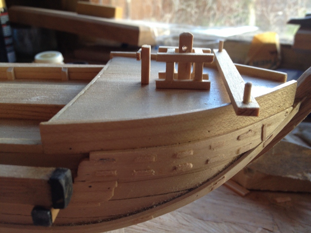

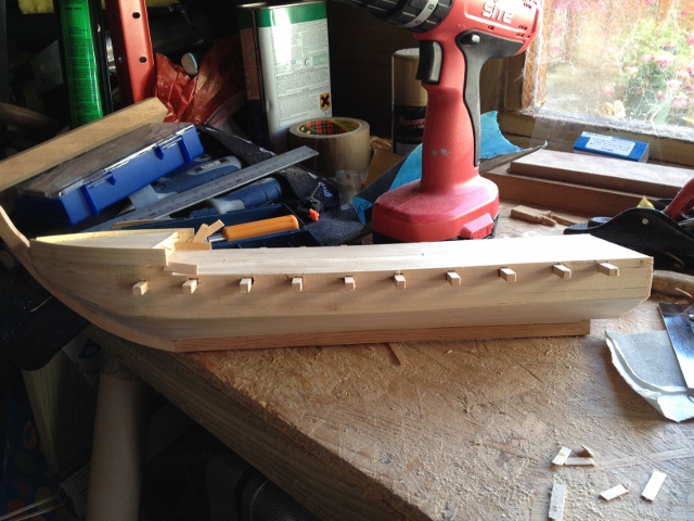

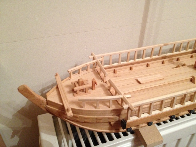

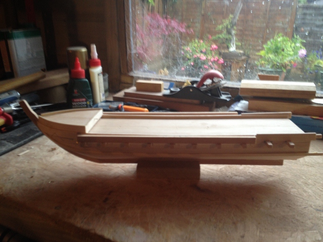

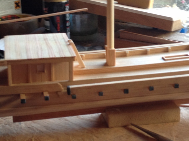

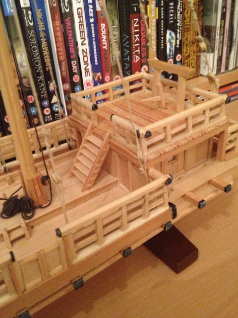

Latest pictures start to show the cabin, bow detal and the ribs.
The bow detail I had to stick slivers on and sand them down to show the tenons holding the sides on and along the beam.
The sairs will come out and be rebuilt later as will the deck hatch

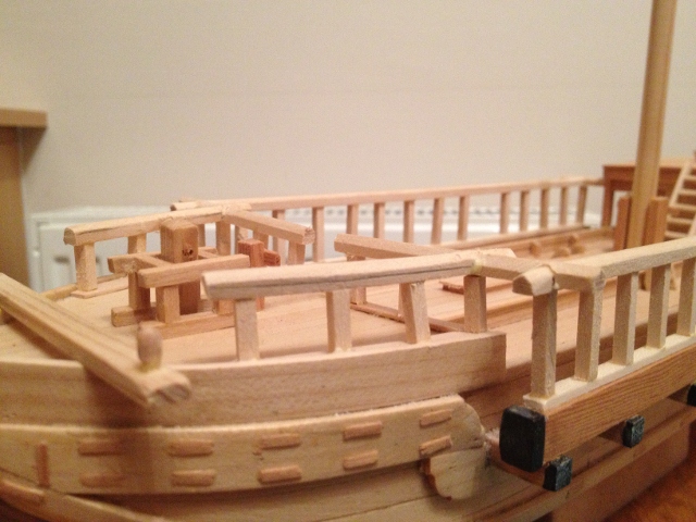

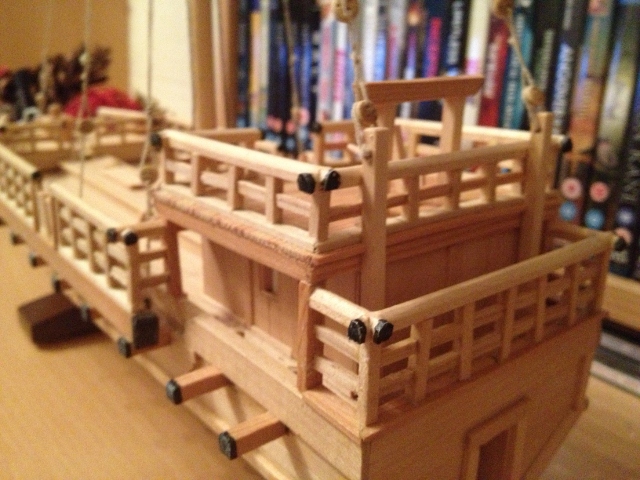

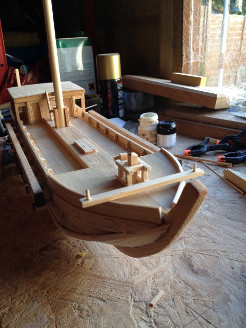

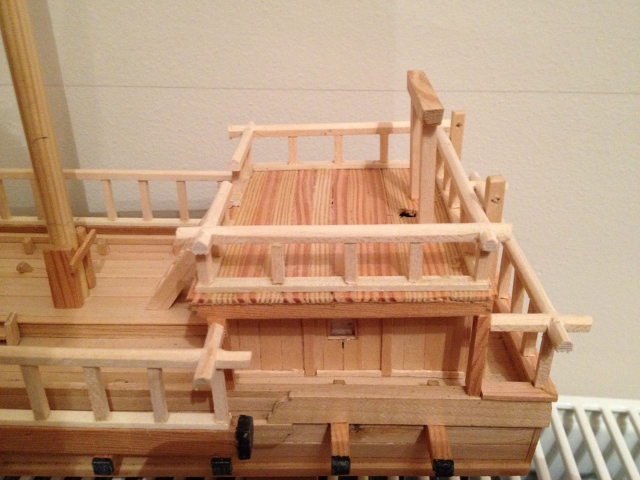

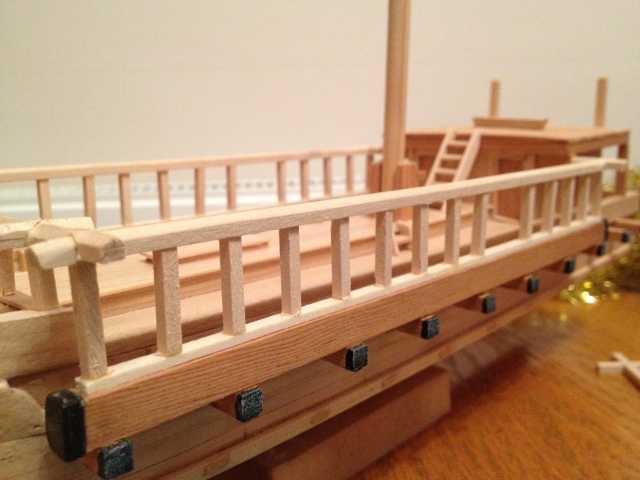

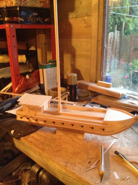

Ok gettijng up to date, these show the outriggers and beams, around the top are the railings 4mm halvened together and the tops chamfferd by hand. The front rails I had to soak and bend.
These need finishing off and all the ends trimming.outrigger posts up

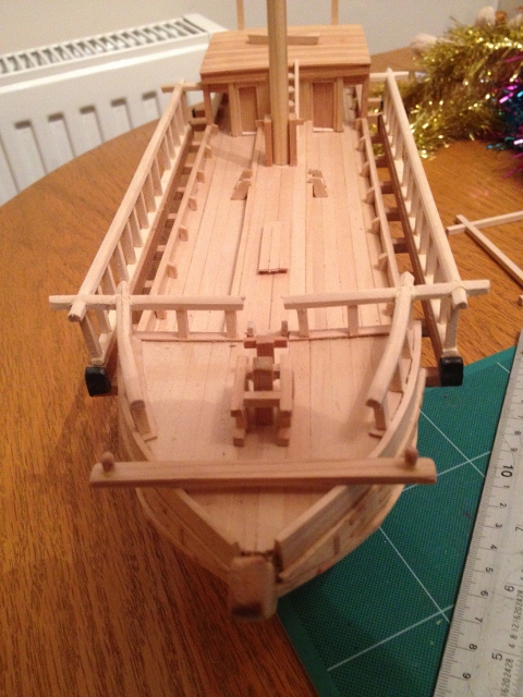

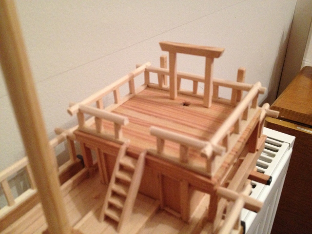

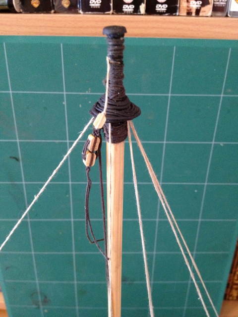

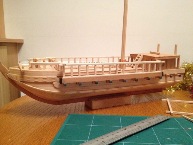

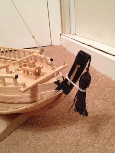

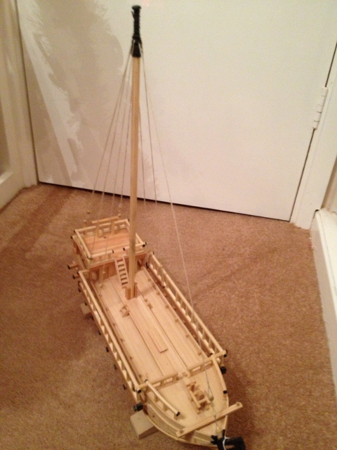

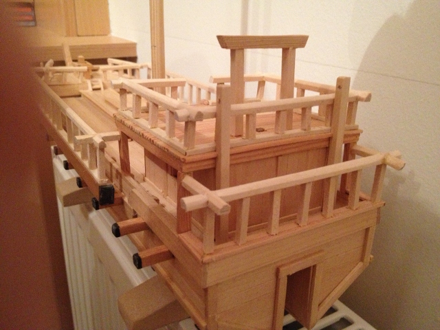

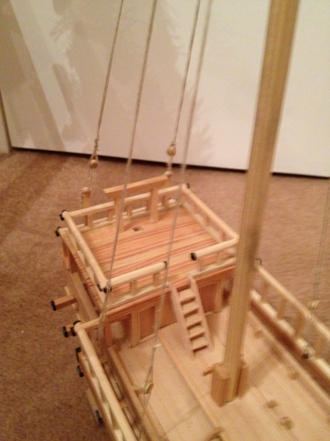

Ok this shows the mast and outriggers in place, also with the prow detail though this has now changed slightly, also the stairs have now been ripped out and a new set built.
The crew access on the deck has been removed and an access hatch put in with stairsits painstaking as some of what you see has been removed and rebuilt any advice is greatfully received.

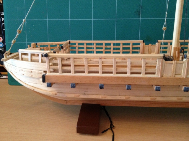

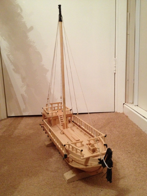

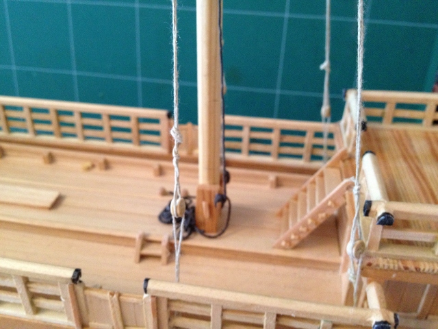

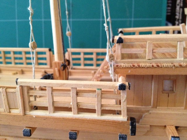

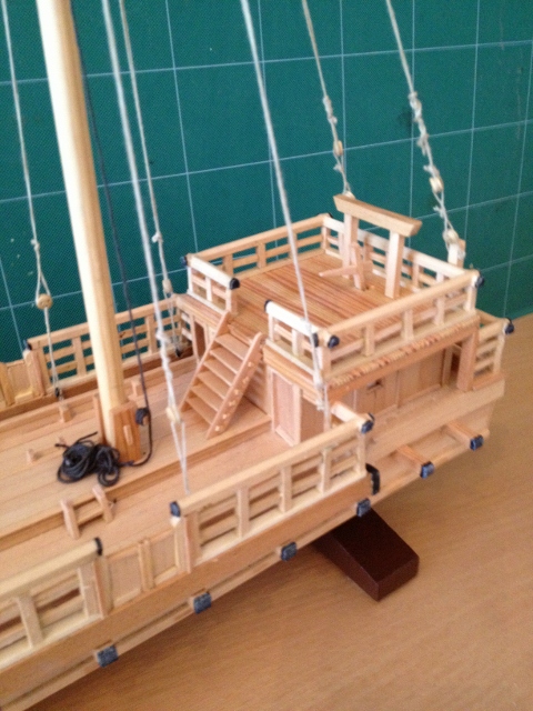

New staircase now put in showing the tenons on the strings. The railings around the ship the dificult part was getting the top set tp line up on the bow, side and stern whilst keeping 3 equal pats on the side.

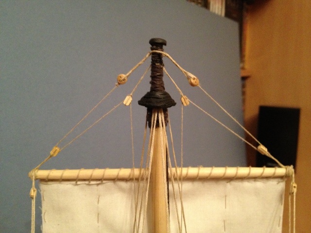

Stern detail showing the railings continuing around and the mast detail at the top and the main rigging and pullies to raise the sail all working, next is to make the sail complete with mon and the spar.
godan61 attached the following image(s):

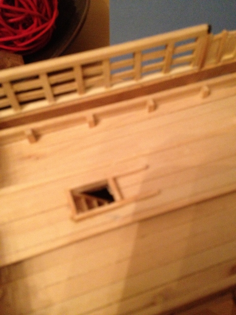

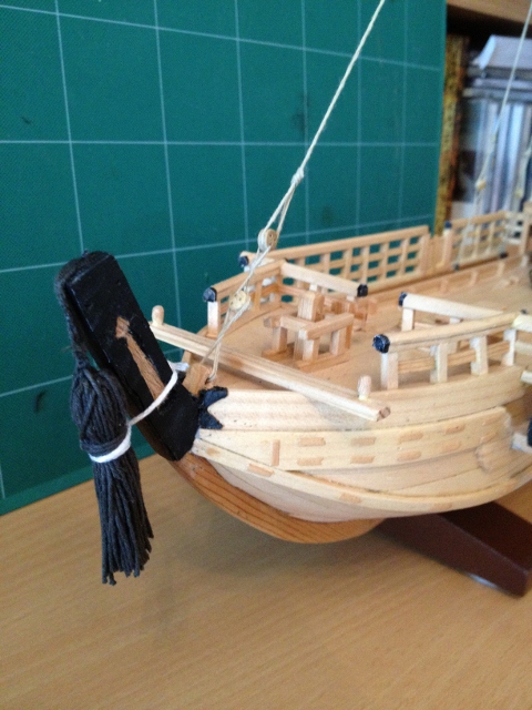

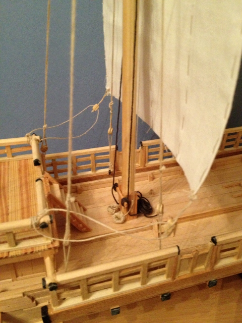

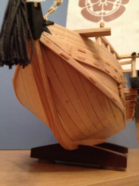

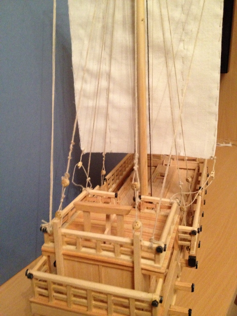

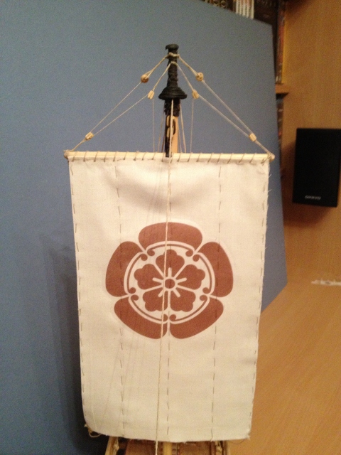

Ok new hatch cut into the deck with stairs, main sail and rigging with ashot of the hull at the bow.
The jpanese idea of securing riging is tie it to the rails, extremelly happy with the way the sail came out though,
