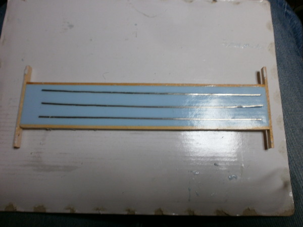

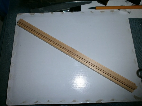

Ok first thing to make is the mould box,there are several ways to do this use cardboard covered in selotape,lego or wood strip as I have done as long as its the right size for the job.The base I used is from the Akagi packaging and has a shiny surface so should stop the mould silicone mix soaking in.

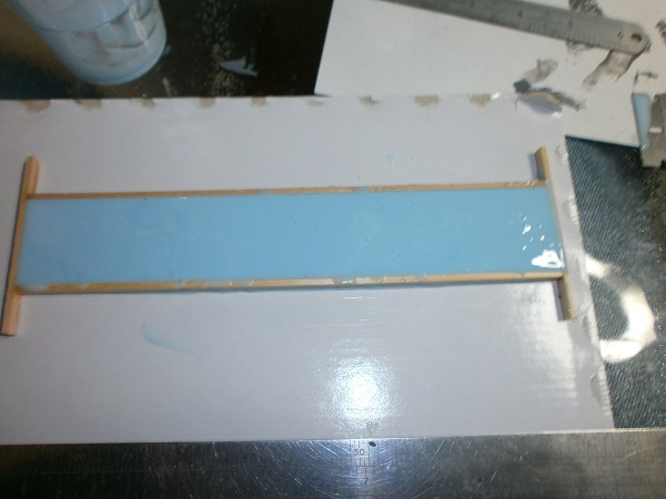

After the mould box is made place the parts to be moulded in the box and mix up the required amount of silicone as recommended in the instructions and fill the mould box with the mix this then needs to be left for 24 hours to cure,when the mould is cured remove the parts from the mould and you will have a master mould to make as many of these parts as required

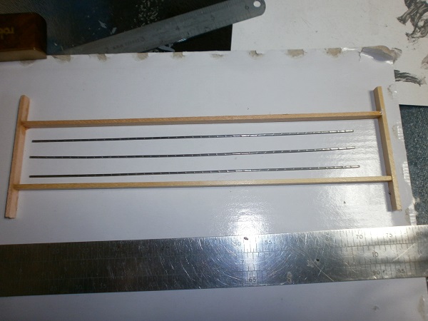

#2 Posted : 15 December 2012 15:08:54
the mould box parts

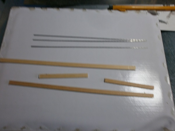

#3 Posted : 15 December 2012 15:09:54
the parts I want to mould
#4 Posted : 15 December 2012 15:11:06
the mould box parts and the mould box ready for the silicone

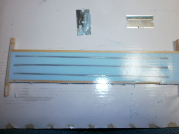

#5 Posted : 15 December 2012 15:13:10
the mould box filled with silicone this is currently cureing I will post more as I progress to the casting stage

#7 Posted : 15 December 2012 20:41:04
BigGrin thanks for looking in Kev, I will say iv done some some moulding using Das before this so I am learning too doing it this way.The mixing can be done by weight or using the syringes to get the mixes right usally around 10:1. I think for larger pieces like an engine block the lego method would be a better idea, as once the mould has set the lego can be recycled into your next mould shape/size so its a better method

#9 Posted : 16 December 2012 09:35:04
BigGrin Hi Rob
The Silicon rubber provided is the GE G1 1000 condensation cure rubber so it cures using the moisture that in the air,heating has no effect on the curing prossess so theres no fumes or nasty smells to cope with. The casting resin Axson F38 gives off some heat during the casting prossess but as far as iv read so far no smells again I presume there may be a smell of the epoxy/car filler type but nothing nasty.Hope this helps

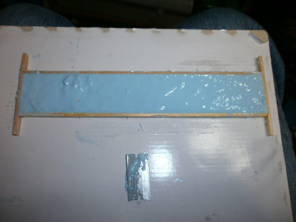

The mould has now cured and its turned out quite well I think,there was a little bleed under the parts so I found running a very sharp blade carefully round the edge of the part before removal made it possible to remove this.If you try to do this after the mould master is removed its not so easy as I found out but replacing the part and a bit of manipulation enabled me to get rid of the flash/bleed.
The moulding material as it is now is quite streachy so im going to leave it in the moulding box and cast with it in situ if this fails I can try it without.
A few more pics to follow on progress then later today I will try the casting in the mould and thanks all for the intrest shown makes things more worthwhile

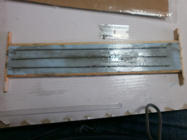

#13 Posted : 16 December 2012 11:30:10
the finished mould it looks a bit lumpy because I tried covering it and adding some weight but this hindered the curing and it didn't affect the casting sideBlink ah well u live and learn

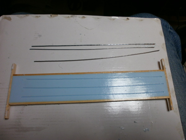

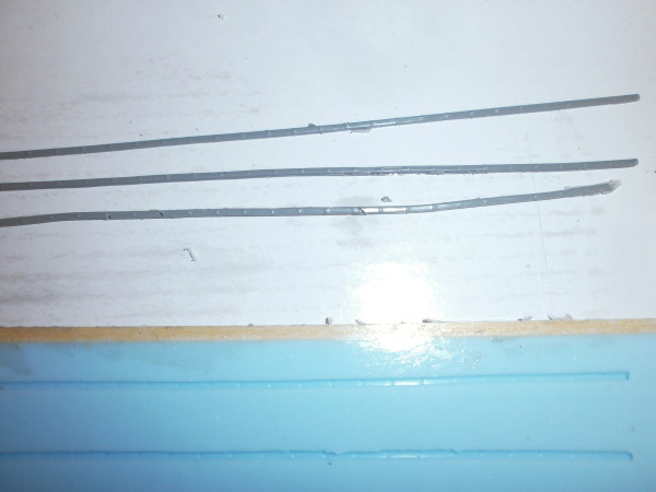

#14 Posted : 16 December 2012 11:32:47
the pictures here show the cast side of the mould,the 1st one show the bleed problem and the last after its been removed
#15 Posted : 16 December 2012 11:35:57
this pic shows the mould after the masters have been removed if you look closely its reproduced the profile exactly

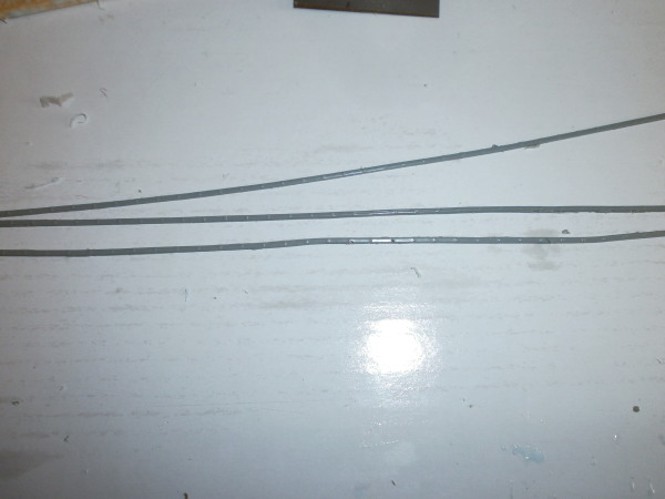

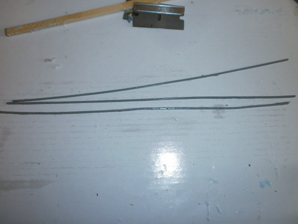

Now we come to the mouldingBlink the resin is easy to mix at a ratio of 1:1 but they say in the instructions its a 1 hour cure but mine went off after about 5 mins max,good job I had filled the mould.
The resin sets fast and creates a lot of heat but no noticeable smell so swift hands are a good idea when filling your moulds.
After waiting for the resin to set I removed the pieces with some trepidation would they break or not,as it turned out they came away with a little bit of manipulation of the mould and they all came out fine apart from one which had 3 air bubbles present but there quite close together so I can use this piece for the smaller lengths.The results speak for themselves I think im quite pleased with the parts I made.
My thoughts on the kit,the instructions are clear and comprehensive although it recommends going online to get information on mould boxes and maybe a little more of the silicone for moulding the moulds would be a bonus but over all its a good way to get into moulding your own parts and will be a boon to scratch builders.All comments a questions are welcome as usual and I hope this may help any builders out there to take the plunge in doing this

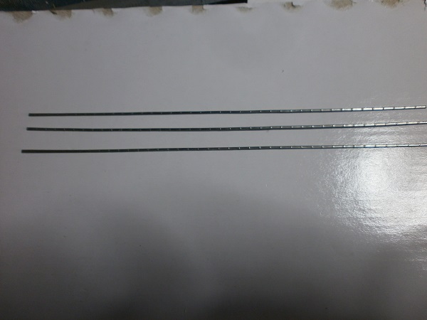

#18 Posted : 16 December 2012 15:08:56
the parts after removal

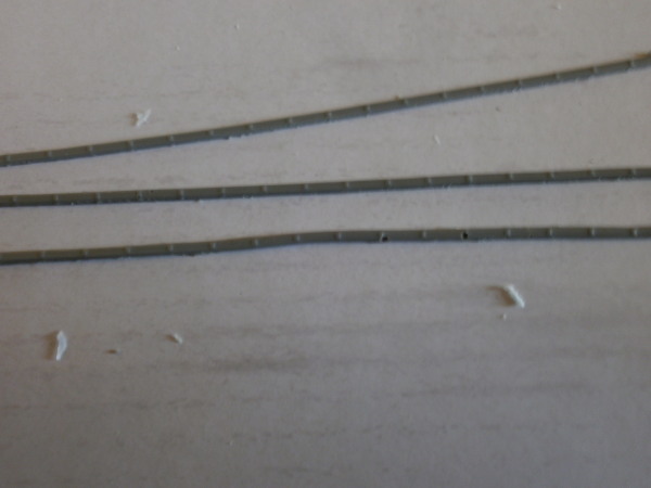

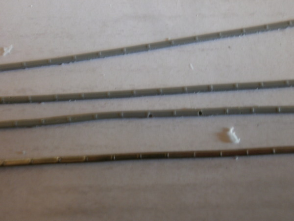

#19 Posted : 16 December 2012 15:12:38
here are some close ups of the moulded parts ,you can see the air bubbles on the lower piece,the last pic shows the 3 moulded parts with the master part as a comparison for shape consistency over all a good match
