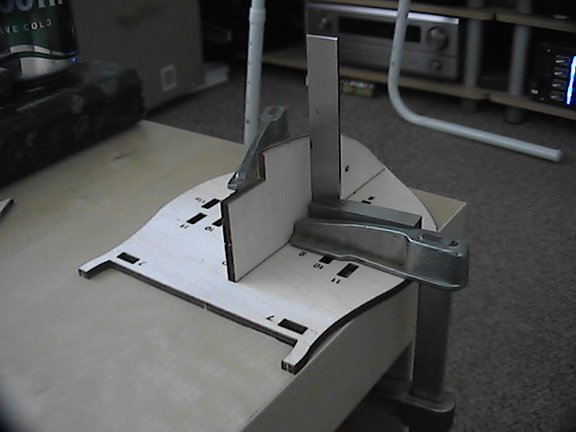

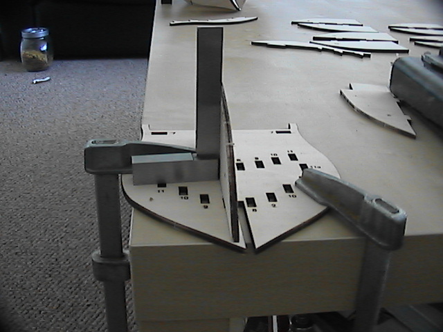

Good day you sea fairing sailors, i know a lot of people are having trouble with parts warping me also No 12 is slighly warped so ive clamped it to the table pva glued the edge of No 8 then squared it up to No12, then super glued where No 8 fits in No 8 and left it to dry. I am going to repeat this op up to No 11a and hopefully it should stay square and level. Confused

Looks like the trick worked No 12 nice and flat, gluing No 8 to 11a while having No 12 clamped has done the trick.

Square as mr brown, superb start mate.

Having also experienced a spot of warping on Pt 12, I shall be following your clamping method to ensure it doesn't happen again.

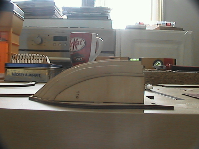

Since checking the bow formers ive discovered most of them are all in some shape or form "warped" very displeasing i must say, when i have finished gluing the rest of them i will keep them in between floor tiles until ive got them all ready for assembly.

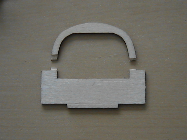

Had some fun with the launch yesterday, but did manage to get it sorted out.
john burgess attached the following image(s):
If you dont suceed at first go to the pub
#11 Posted : 18 May 2010 22:43:54
good repair matey, no problem insurmountable Cool

A very nice repair job in deed John, wouldn't think that it had been broken. Keep the pics coming mate..ThumpUp
