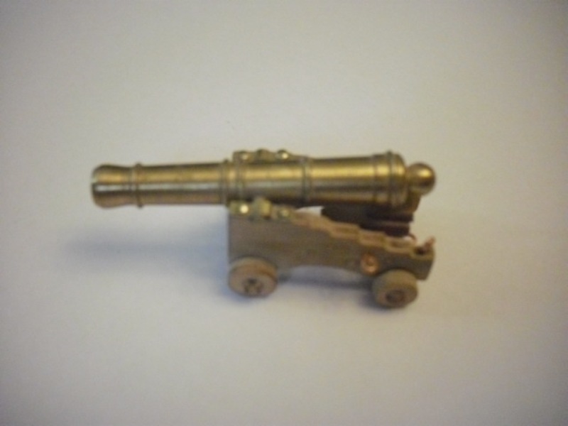

#14 Posted : 20 October 2012 23:37:03
Hi Team I am having all the gun carraiges re manufactured in walnut for My sots, they will be lazer cut, is anyone interested in some? cannons also availableBigGrin Kind regards Mike

#17 Posted : 21 October 2012 04:13:21
court orchard wrote:
Hi Mike,
Just wondering why? Particularly since the build has red painted carriages and therefore the wood doesn't matter. Unless you are thinking of having a natural wood finish, but this doesn't fit with the ornamented style of the SOTS and is more fitting with the later utilitarian 18th/19th century armaments as proposed by Mueller in 1756, when he wrote a paper on the uselessness of ornamental guns.
Hi Andy, You are correct the carriages are painted red but I am using red ink which gives an authentic scale layer of colour which allows the grain to show through, now as we know the wood used in the build has very fine grain and is light in colour, A white wood would never have been used to construct the carriages, now walnut has a definite grain and is the nearest to oak colour and grain at this scale, plus the trucks will be in walnut and so will the axles Cannon of this period did not have metal axles or the type of trucks supplied and so that is why I am going this route, to me it is a very important detail, and I will fit these to my victory also. but to other members it may not matterBigGrin but it is the old story you pays your money and you make your choiceLove Best wishes Mike

#19 Posted : 21 October 2012 12:15:38
Hi Andy I absolutely agree with you its the debate that we have between ourselves that makes the build far more interesting,and creates tips and ideas, so thanks for thatBigGrin Kind regards MikeThumpUp Wink
SandyM
#20 Posted : 21 October 2012 13:19:36
Joined: 13/09/2012
Posts: 149
Points: 435
Location: Highlands of Scotland
Nice photo Mike, good to see you have put the arch in. I have to agree modellers metal is far better than resin and easier to use.
