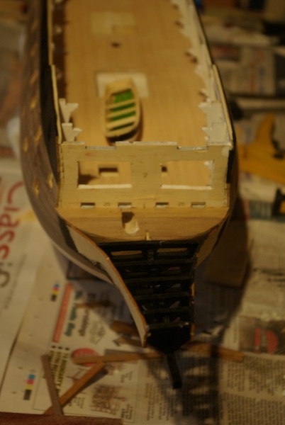

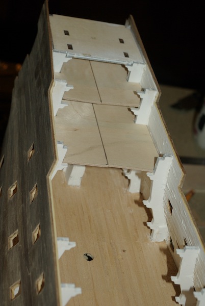

Amended Stern Castle. Still to be tidied up and clad with lime planks before painting. I have made the gun ports 10mm for now as at that size I can fit the canon barrels through the ports onto the trucks.
Cut away on the half frames I also reduced their hight and the top of the stern post by their own thickness enabling frame 47 to be fitted at the same hight as the middle gun deck.
View from the Stern, the Port sub deck dry fitted. As you can see I have also cut a hatch amid ships and two for the anchor cables. the forward bulkhead has yet to be tidied up before painting ( below decks will be painted off white to mimic the lime wash used to protect the wood and reflect light from the lamps).
Sub decks to be trimmed off when fitted
Frame 47 refitted dry for now
View with Stern castle dry fitted
View along the Lower Gun Deck with the Port sub deck in place looks like I will have to trim a little more off the inner uprights.
View along the middle deck. I have still to trim back frames 28 & 29 and cut the embrasure for the tiller as the steering room was at the after end of the middle deck.
like I said mine is not a standard build.
Thanks again Guys
Sandy

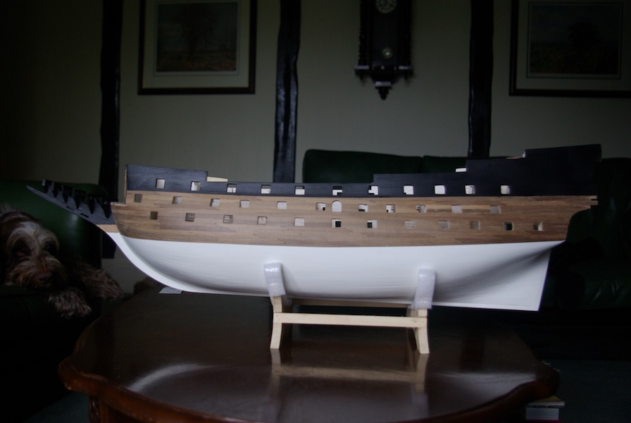

My mods so far
