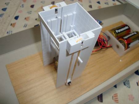

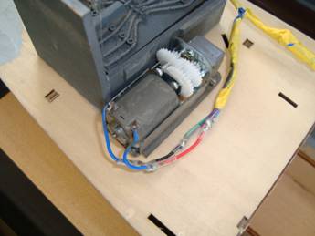

As Andy indicated, the lifts of DeAGOSTINI original model are not really motorized in Japan. I guess it is the same in UK. One of the reasons why I decided to make this model was that this model might have the potential for remodeling the lift.
I tried several type of the lifts (picture 1,2) and now a center lift of my Akagi is motorized .You can see the YouTube movie at the following URL.
http://www.youtube.com/w...edded&v=qOjZ0wDhlf8
Best Regards,
Y.HONMA
#6 Posted : 27 April 2012 13:10:13
Fantastic enhancement Yotura sanBigGrin Regards Mike

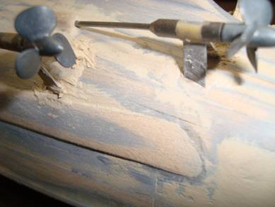

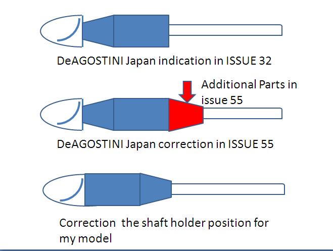

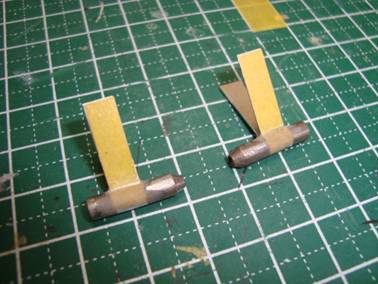

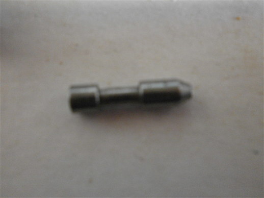

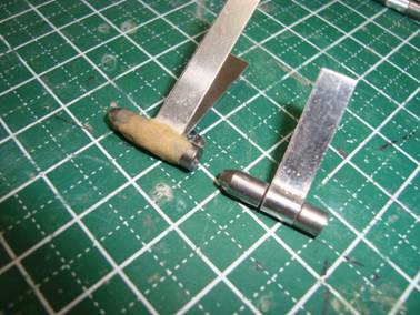

I would report second "mine". However this problem might not be severe, I guess it closes to UK Akagi builders now. It is a problem about screw shaft holders. As it is very difficult for me to explain by only using words, I have drawn three figures.
In Japan, DeAGOSTINI Japan indicated us to set up shaft holders as first figure in issue 32. As I had had made 1/350 Akagi model (Picture 1), I knew it as shown in the third figure and made it as Picture 2.
My friends and I asked DeAGOSTINI Japan to correct it by sending e-mails. They distributed additional parts in issue 55 as shown second figure.
I recommend you to research the materials when you assemble screw shaft holders.
Best Regards,
Y.HONMA

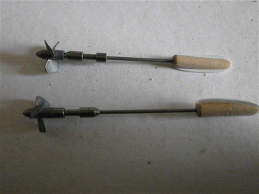

#9 Posted : 28 April 2012 15:19:49
Hi Yaturo
another intresting adition on things to be beware of, i have just reached this stage of the build and include 2 pictures of the supplied parts. The 1st being the supplied part in our build and the 2nd to show that a simple reversal of the part puts it at the corect way round.Again thanks for the input

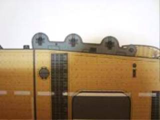

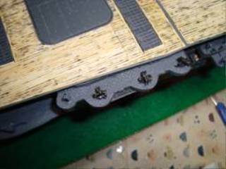

Yutaro HONMA
#10 Posted : 28 April 2012 16:14:23
Joined: 21/04/2012
Posts: 747
Points: 2,233
Location: Tokyo, Japan
Hi Andy

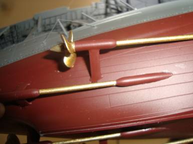

For your Akagi, I will show you my shaft holders.
As I mentioned small level difference in the middle of the holder parts surely, I buried it by putty (Picture 1). Excess putty and aluminum belts were removed (Picture 2) and painted in brown the same as the bottom of the hull (Picture 3). Yellow part is 1.5cm (the length was indicated by DeAGOSTINI Japan) tape and it is used as a guide for cutting. You might find there are rounded delta shaped small pieces, what are made of plastic, at the head of the blue arrow. I also attached them on the hull side.
I hope these information should help you.
Best Regards,
Y.HONMA

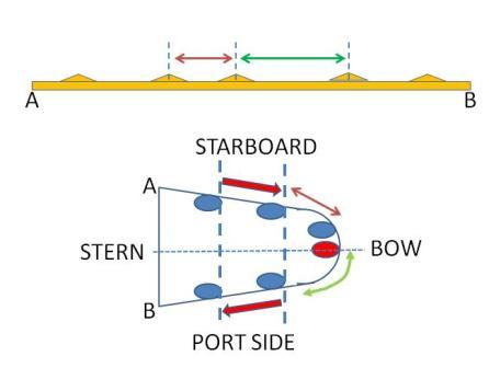

An etching part which was to be attached on the edge under the bow hangar part was distributed in issue 57. Thus it is very difficult for me to explain by only using words I drew a figure attached.
The part is a belt with 5 triangles (Upper figure). Although this part is visible to symmetry apparently, it is not so. The position of the triangle of middle has shifted.
We were instructed to set up the middle triangle at the center of the hanger (marked RED position in the lower figure) in issue 58.
The triangles were the guides of the hunger's 5 legs that should be located on the blue marked positions I think.
Please suppose that the middle triangle is set on the center position as marked RED. Four back legs would be shifted as red arrows.
I recommend you to research the materials when you would assemble here.
Best Regards,
Y.HONMA

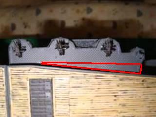

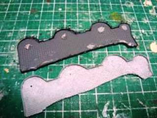

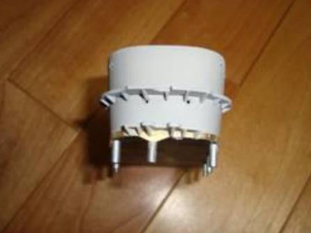

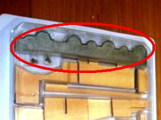

This time I introduce the 4th mine about the platform part of issue 39. There was a trouble in Japan at the end of this part work.
At the issue 92 DeAGOSTINI Japan distributed the paper about "Correction and Apology". The paper said that the platform part in issue 39 was incorrect and they will send the substitute in issue 100 which is the last issue. We, Japanese Akagi builders confused and waited for the substitute till the last issue arriving at us.Cursing
When I watched the substitute, I decided to use original because the shape of the original part resembled much more Hasegawa's 1/350 Akagi model than the substitute.Cool There was one more reason. As the platform had already been glued when DeAGOSTINI published the announcement, I had to remove the perfectly attached platform from the ship.Cursing
I saw "IJN Akagi official build 7" by Mr.T and found that the same platform part (not substitute) was included there. I am afraid the same problem may occur in UK.Confused
#1 The part in issue 39 (red marked)
#2 The paper polished in issue 92
#3 Comparison original (upper) and substitute (below)
Best Regards,
Yutaro

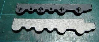

Thank you for discussion about this issue. I read your discussion with big concern.Cool To tell a truth, I used only two original parts of the platform why the shapes of the unused parts were thought to be incorrect for me. Remained two original platform parts were attached on the stern hanger walls of both side and I used scratch building parts instead of the other original platform parts.
For example I show the case of the platform of bow portside hanger wall. I introduced how to make the platform parts with skid pattern in other topic.
#1 Picture of original platform. Carelessly I did not notice the strange situation when I was assembling here.
#2 Picture of the plan at the same position. After assembling there I checked the platform with the plan and noticed here strange.
#3 It was to become certain that original part was too wide (red marked).
#4 Comparison original part and scratch building one
#5 Picture of the place after reforming
This case may be the more nearly better one. As a platform part contained in issue 10 was completely different from the materials of mine, I did not understand what it was at the first time. I checked with some friends of mine just to make it sure and I knew they had the same opinion. I don’t know why DeAGOSTINI Japan provided such parts.
I recommend you to check the platform parts carefully.
