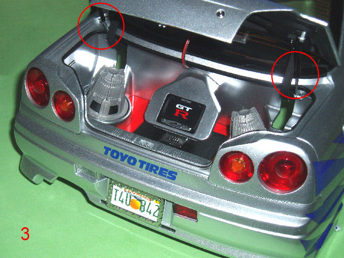

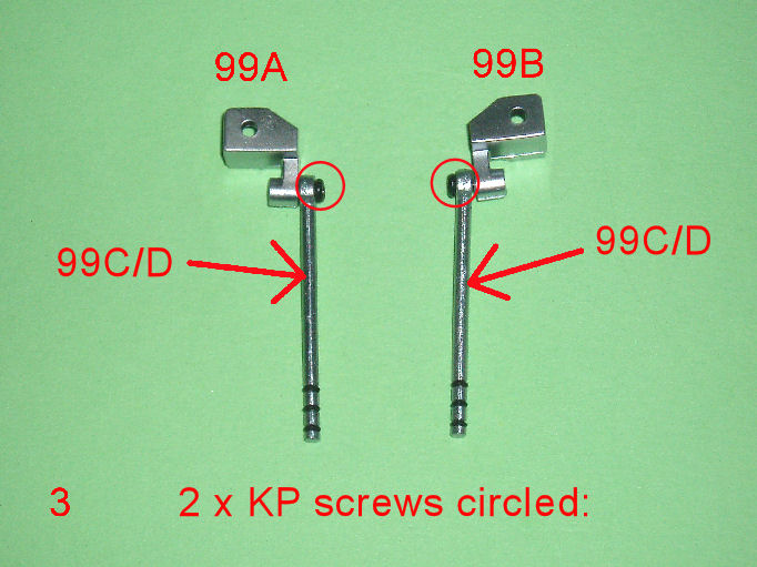

STAGE 99A:
Rear boot and roll cage.

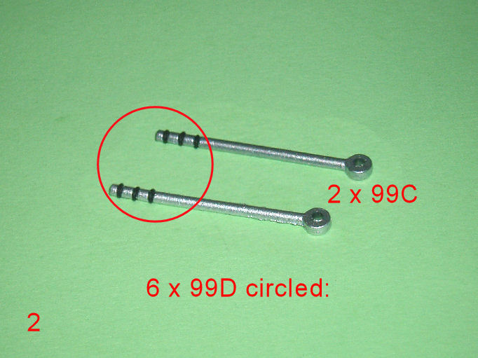

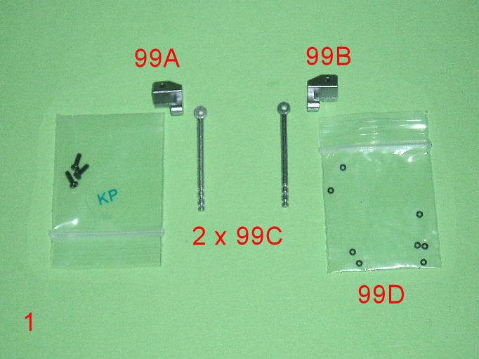

Pic 1: Locate the strut parts 99A, 99B,99C and 99D.
Pic 2: Fit the rubber rings 99D to the struts 99C.
Pic 3: Assemble the struts and brackets as shown and fix with 1 x KP screw in each.

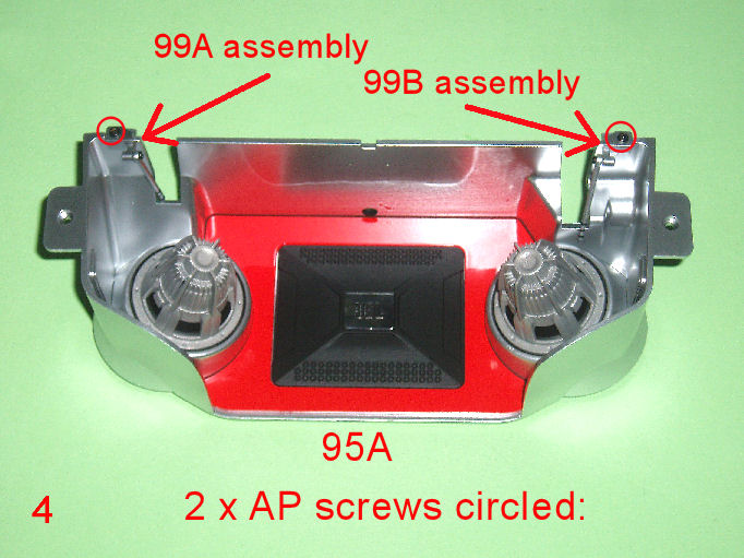

Pic 4: Retrieve the boot interior 95A and fit the assembled struts as shown.
Fix with 1 x AP screw in each.

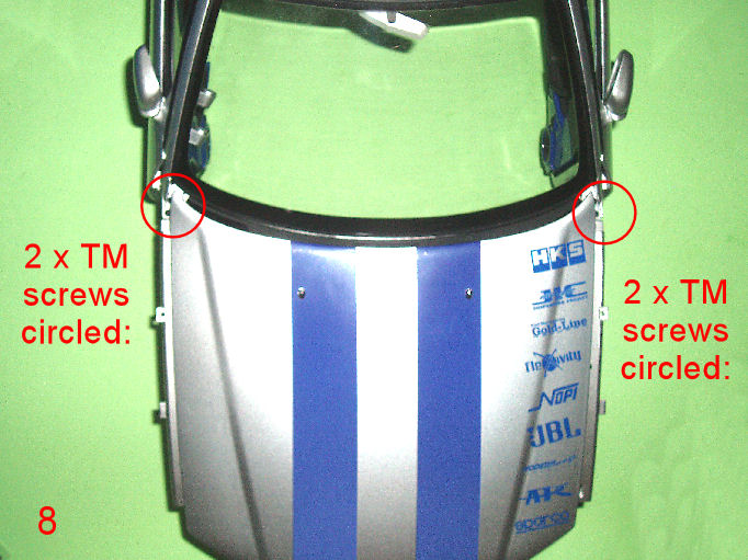

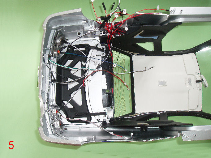

Pic 5: Retrieve the main body assembly and the boot lid.
With the body upside down fit the boot lid in place as shown making sure no wires are left ‘outside’.

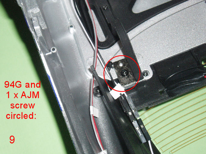

Pic 7: Shows the other hinge position.

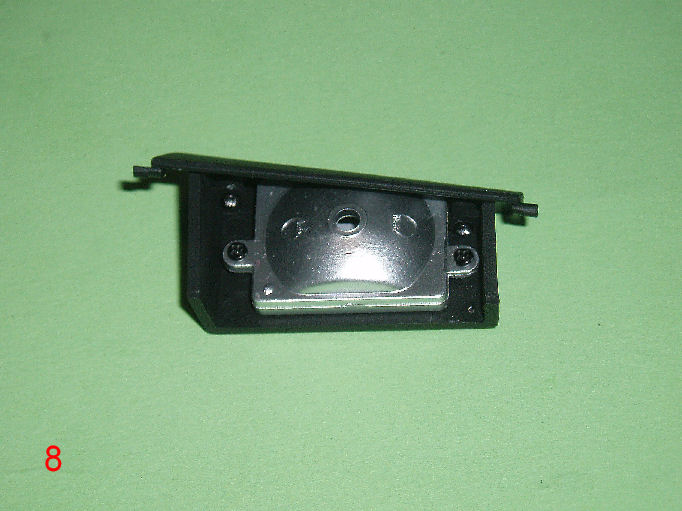

Pic 8: Fit the fixing plate 94G previously saved as shown and fix with 1 x AJM screw.
Pic 9: Secure the other hinge in the same way.

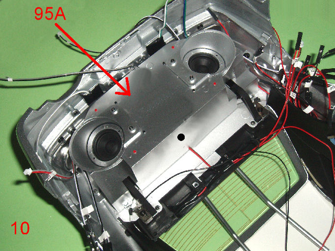

Pic 10: With the body still upside down fit the boot compartment 95A in place making sure all the rear wires are outside of the compartment.
Wire ‘J’ should locate in the small groove in the boot panel.

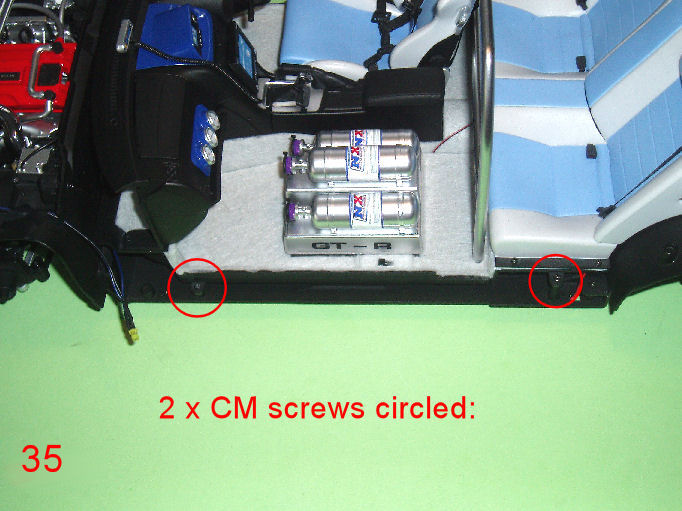

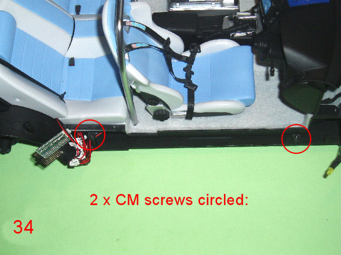

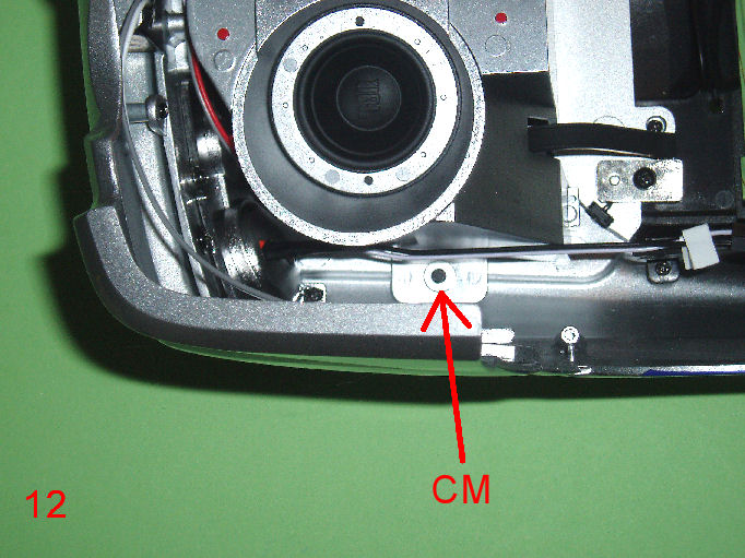

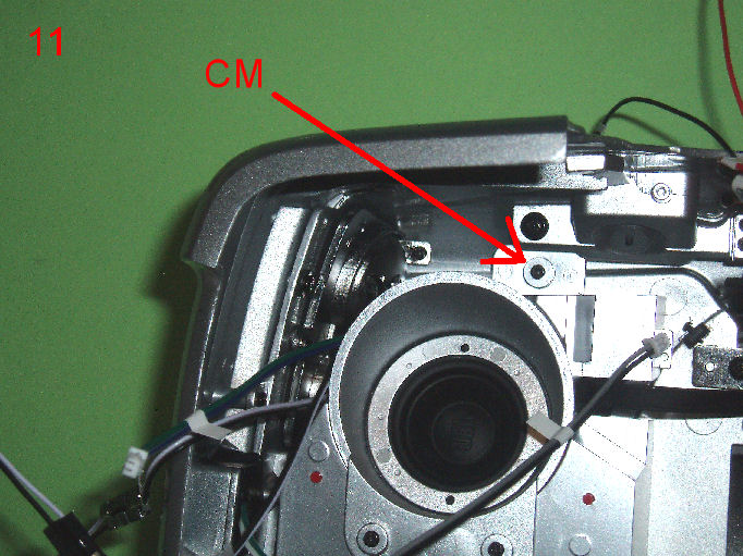

Pic 11: Secure the boot compartment with 1 x CM screw as shown.
Pic 12: Secure the other side of the boot compartment with 1 x CM screw as shown.

STAGE 99C:

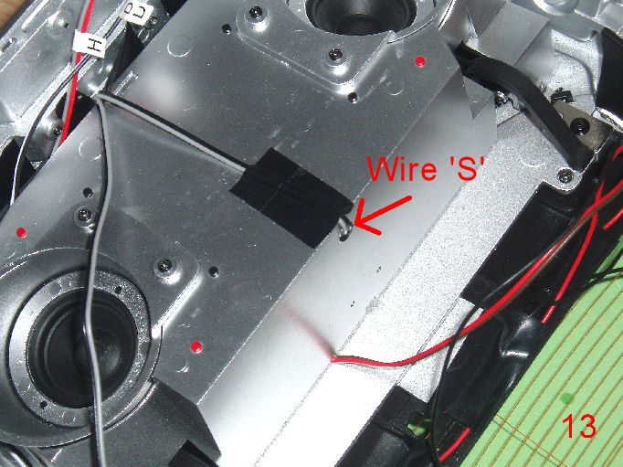

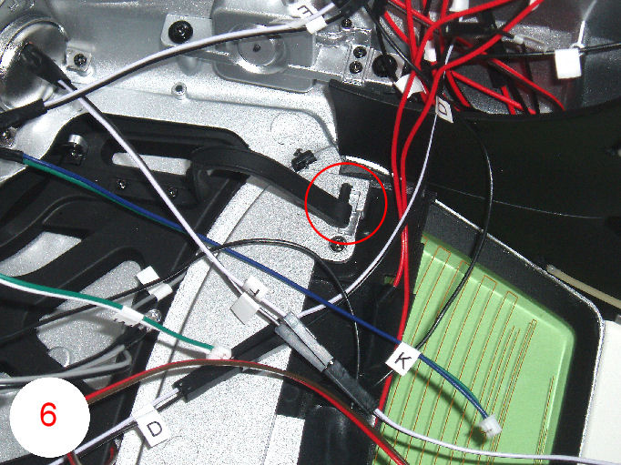

Pic 13: Feed the wire/LED ‘S’ through the hole in the boot compartment.
It will help to tape the wire to keep it in place.

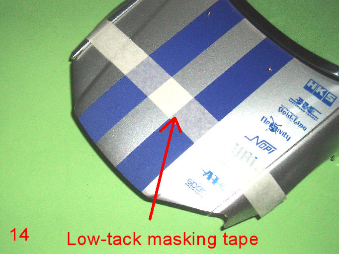

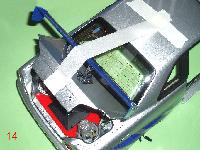

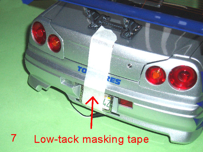

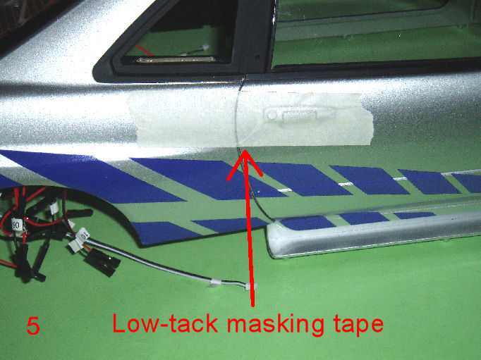

Pic 14: Use low tack masking tape to hold the boot open for now.

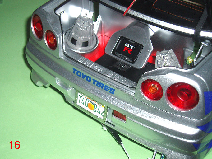

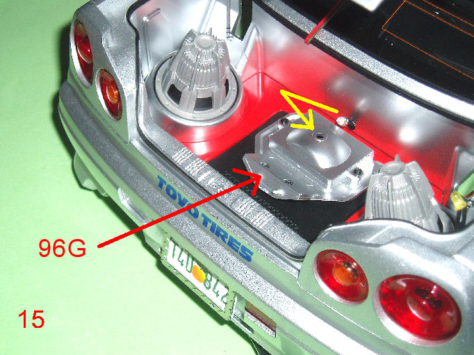

Pic 15: Retrieve the multimedia unit 96G and fit the LED ‘S’ into the hole on the rear. This is VERY fiddly so take your time.
Pic 16: Fit the multimedia unit in place in the boot locating the two pins on the upper edge in the holes in the rear of the boot.

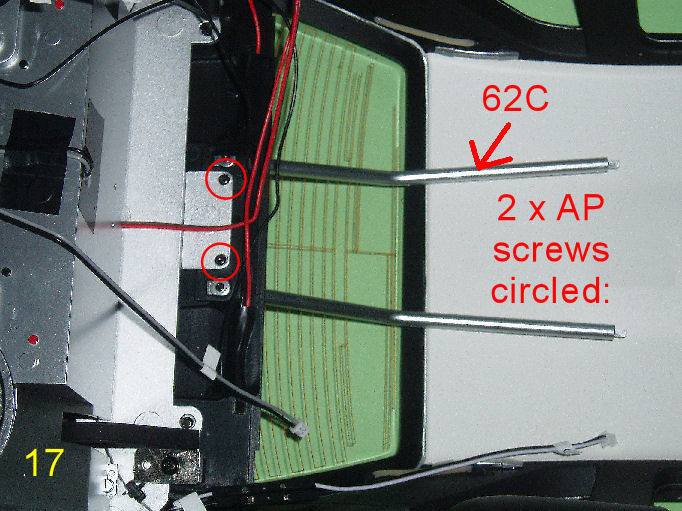

Pic 17: Retrieve the roll cage 62C previously saved and fit it into the rear of the parcel shelf.
The wide bracket should be under the parcel shelf when seen from above as in the picture.
Fix using 2 x AP screws.
Pic 18: Store the model safely.

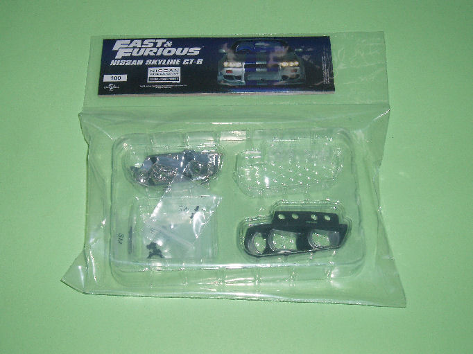

STAGE 100A:
This is a BIG stage.
Left headlight.

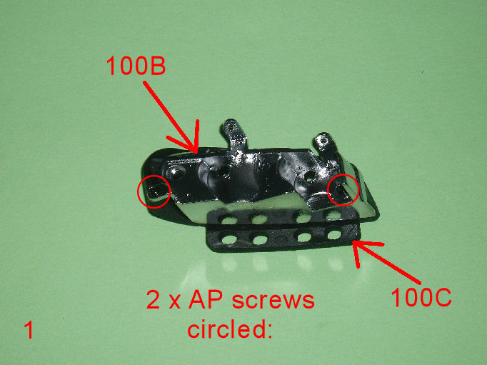

Pic 1: Fit the two headlight housing parts 100B and 100C together and fix using 2 x AP screws.

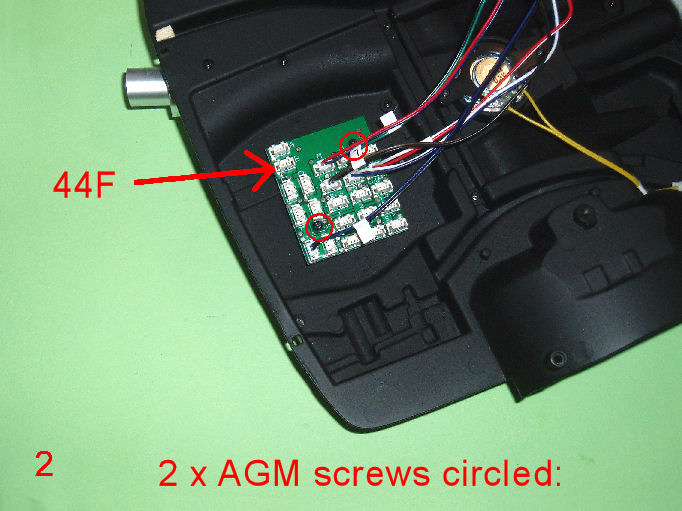

Pic 2: Fit the PCB 44F into the rear of the car floor as shown and fix with 2 x AGM screws.

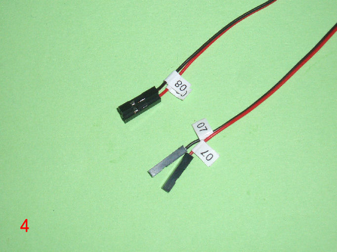

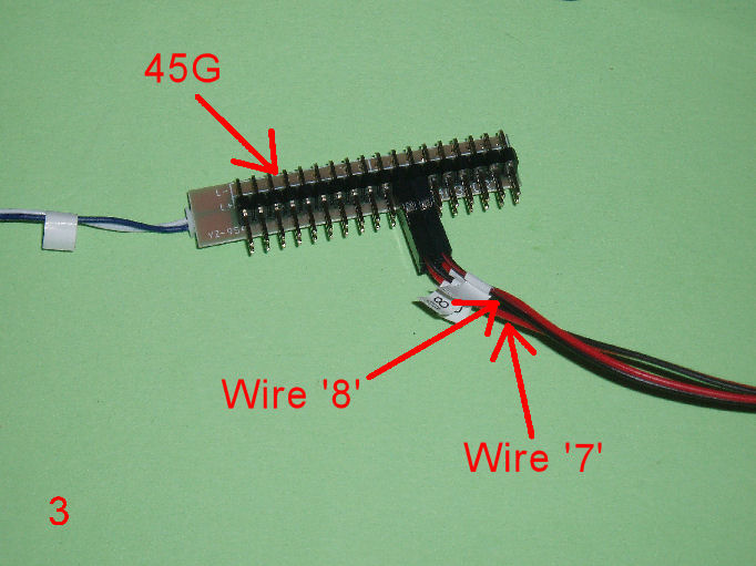

Pic 3: Locate the two wires ‘08’ and ‘07’ on the PCB 45G.
Pic 4: Carefully remove the two wires.

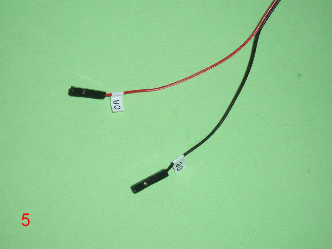

Pic 5: Peel the two wires ‘08’ apart.

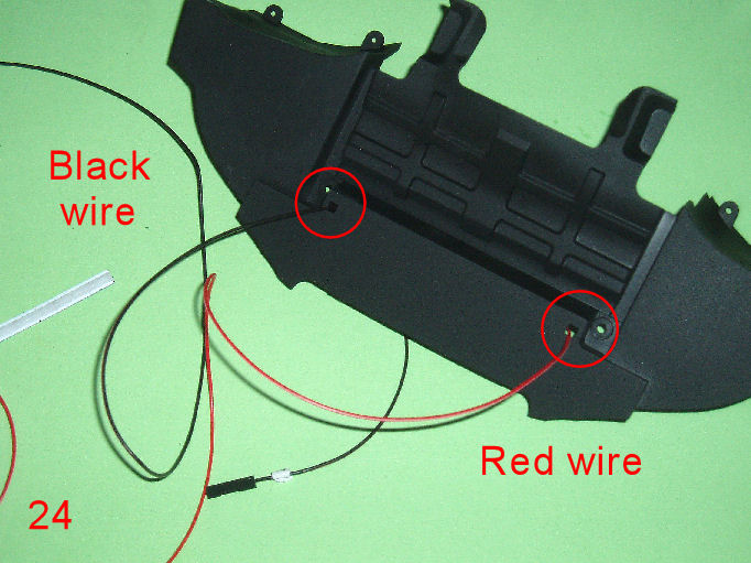

#5 Posted : 01 August 2025 15:11:22
Posts: 5,188
Points: 15,713
STAGE 100B:

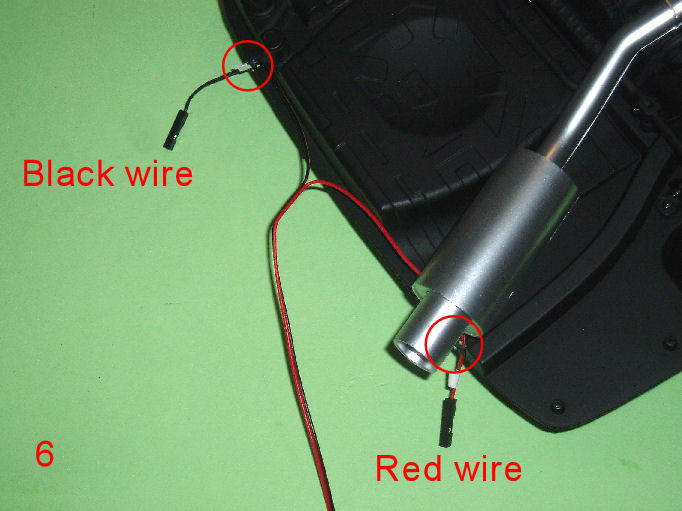

Pic 6: Fit the two plugs on ‘08’ through the square holes in the rear of the floor from underneath as shown.
Make sure the red and black wires go through the correct holes.

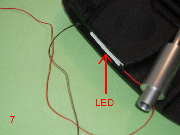

Pic 7: Pull the wires all the way through and then peel the backing from the LED.
Press the LED in place as shown.

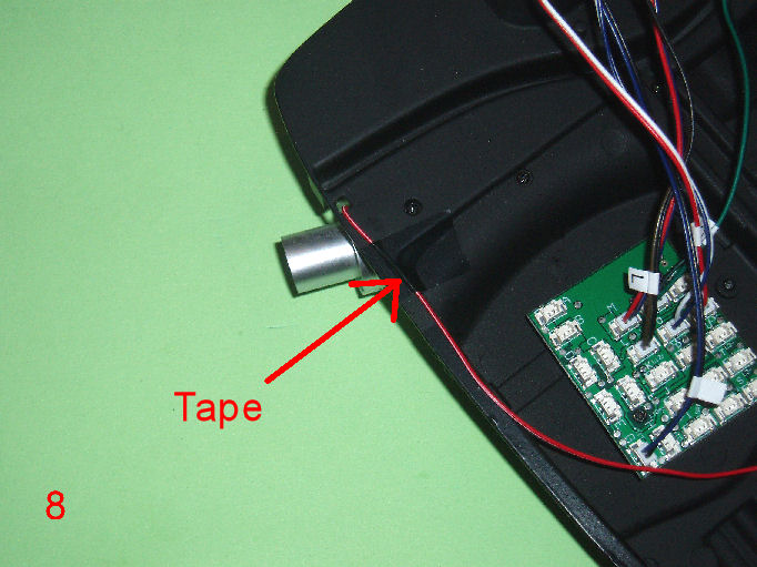

Pic 8: Turn the model over and tape the red wire in place as shown.

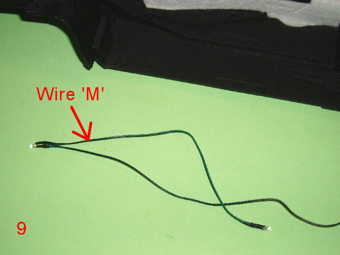

Pic 9: Locate wire ‘M’ on the main PCB but do not unplug it.
Pic 10: Carefully feed the wires and LED’s through the hole in the firewall as shown.

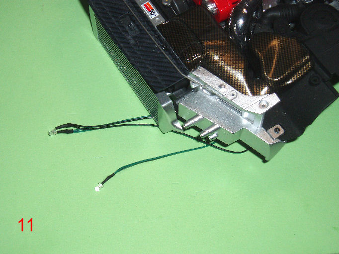

Pic 11: Showing both LED’s in position.

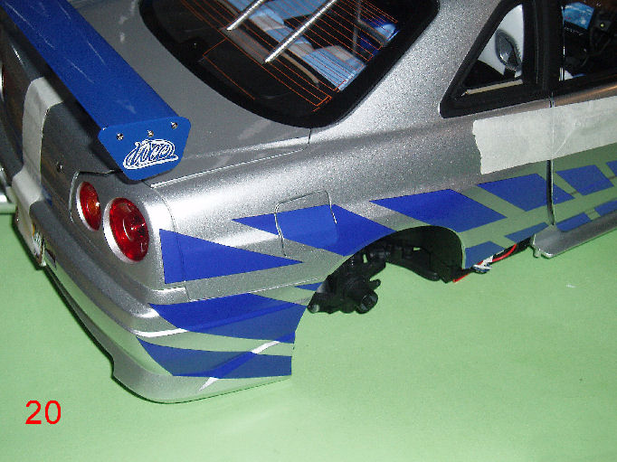

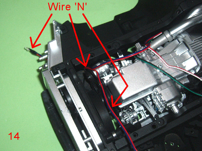

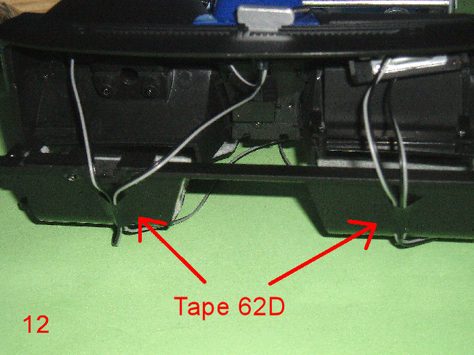

Pic 12: Repeat with the wires/LED’s ‘N’.

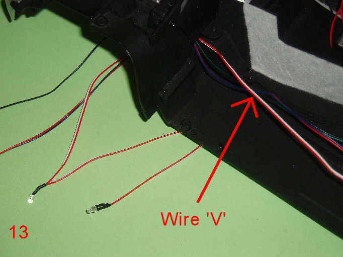

Pic 13: Repeat with the wires/LED’s ‘V’.

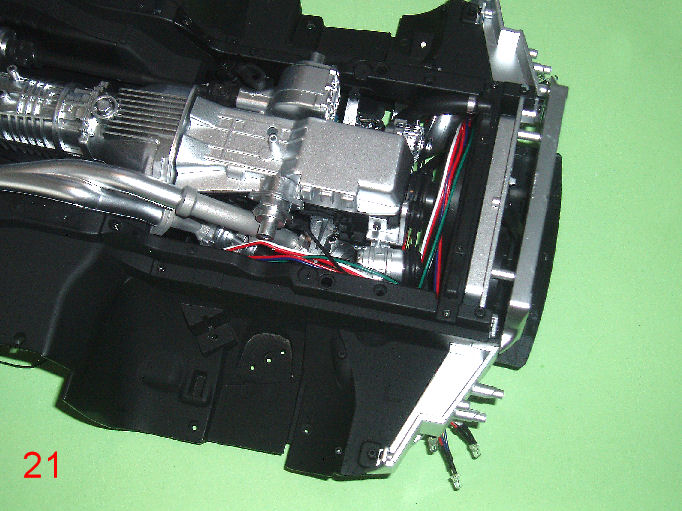

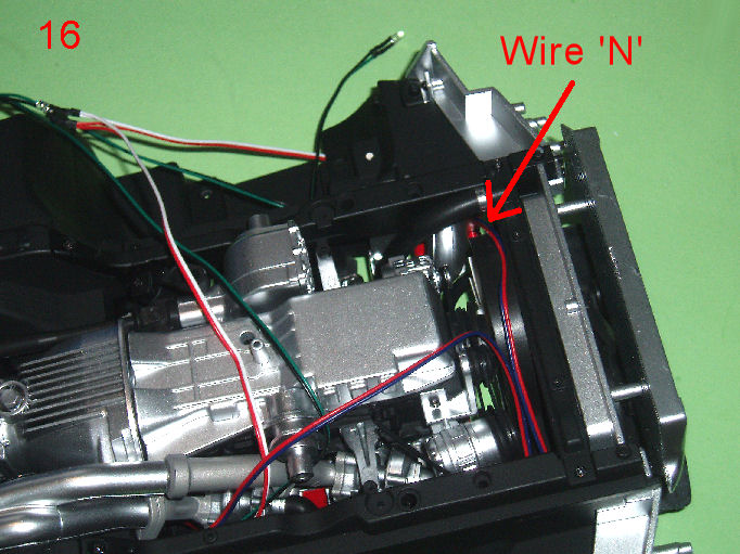

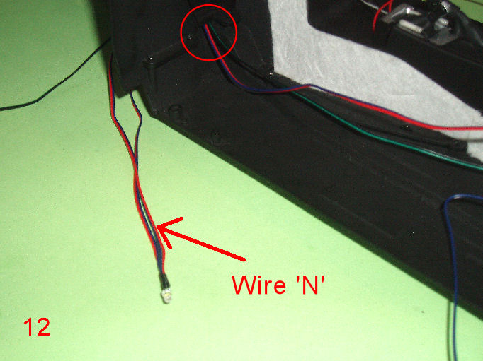

Pic 14: Turn the model upside down and locate the red and blue wires ‘N’.
One of the LED’s is on a longer separate wire.

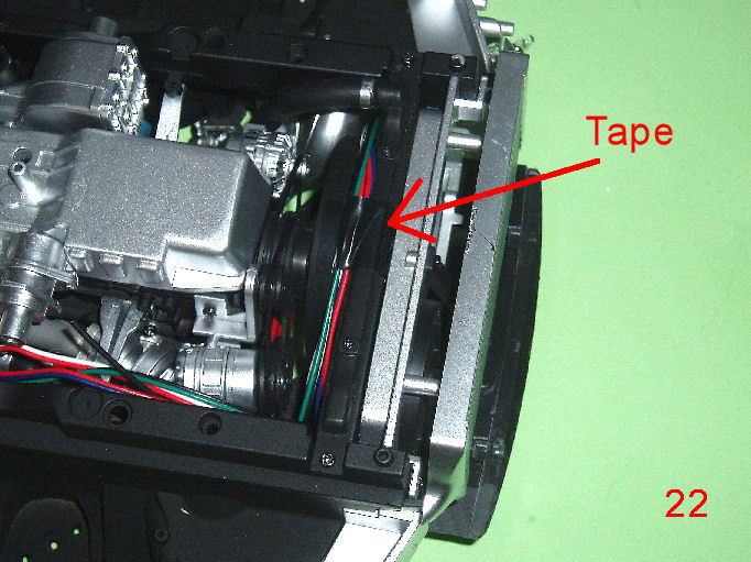

Keep this to one side and feed the other LED down the front side of the engine bay so it comes out at the front of the car.
It sounds fiddly but it’s actually quite easy.

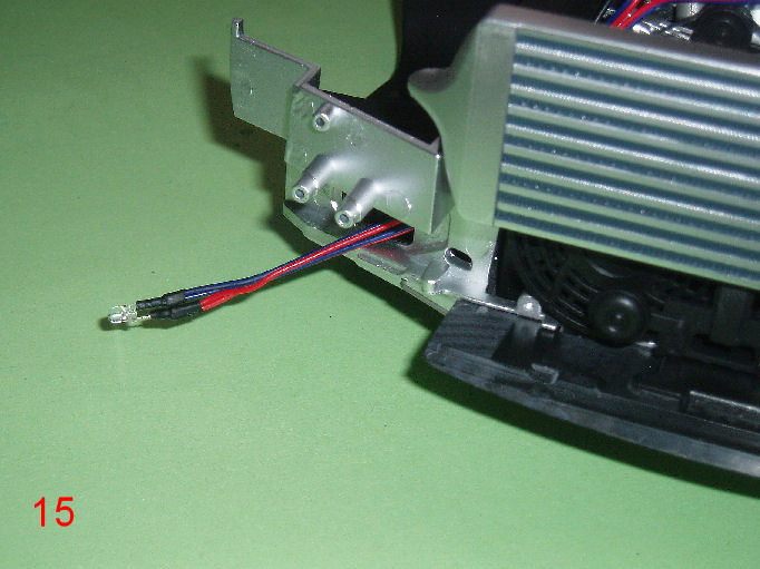

Pic 15: Showing the correct position of the LED.
Pic 16: Feed the other red/blue wire ‘N’ through the other side of the engine bay.
Pic 17: Showing the correct position of the LED.

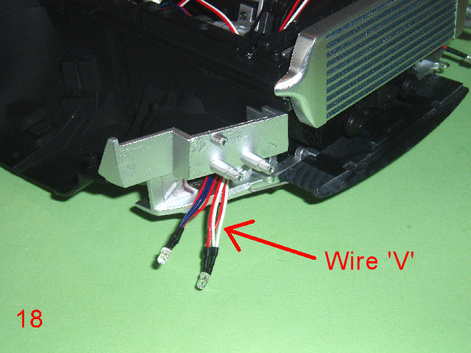

STAGE 100D:

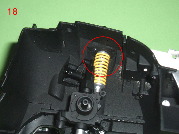

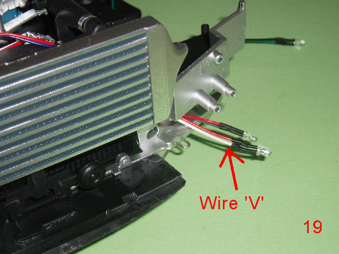

Pic 18: Repeat the whole process with the two LED’s on the red/white wires ‘V’.
Pic 19: Showing the correct position of the LED.

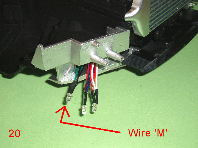

Pic 20: Now do it all again with the green wires/LED’s ‘M’.
Pic 21: Carefully position all the wires as shown.

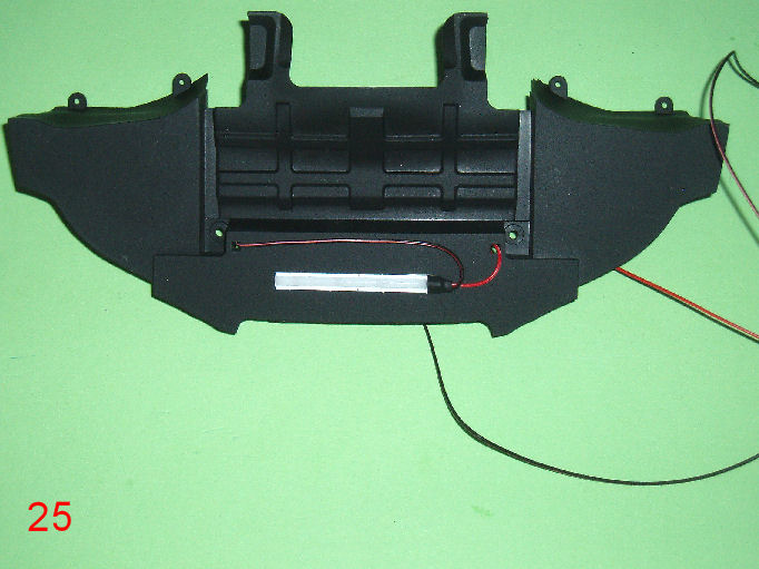

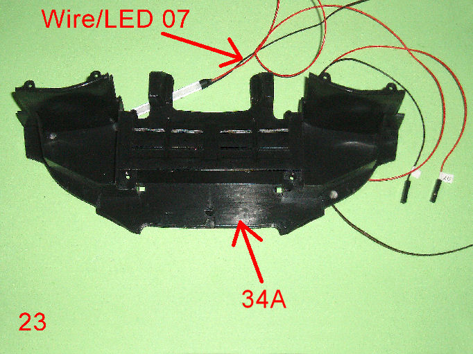

Pic 23: Locate the lower panel 34A saved from stage 34, and retrieve the wire ‘07’.
Pic 24: Feed the wires through the panel as shown keeping the correct colours in the right place.
Pic 25: Pull the wires all the way through and peel the backing from the LED.

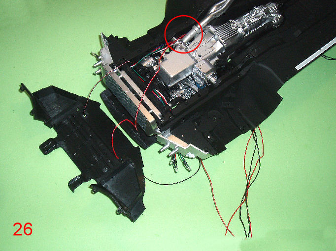

Pic 26: Position the panel in front of the car as shown and feed the two plugs/wires back through the same hole used for the other wires.
You will find this much easier if you undo the two screws holding the firewall in place but do not try to remove the firewall.
Again, long tweezers will make the task easier. Do not forget to re-tighten the firewall screws.

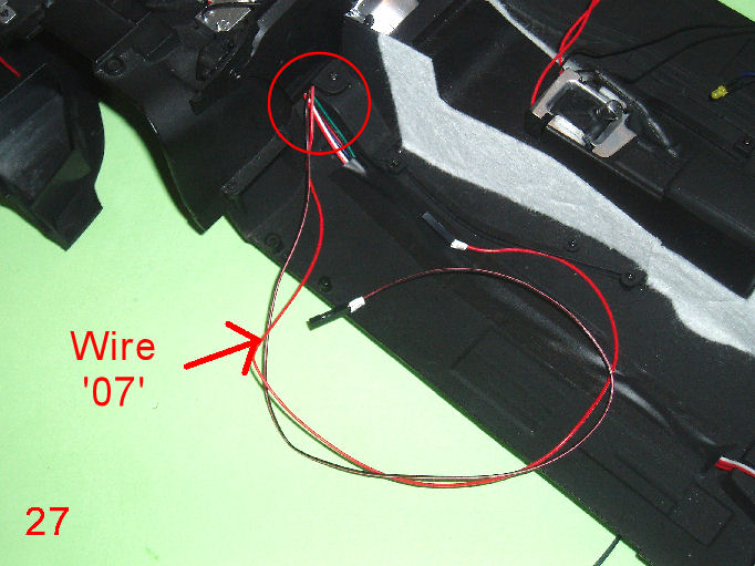

Pic 27: Showing the correct position of the wires ‘07’.

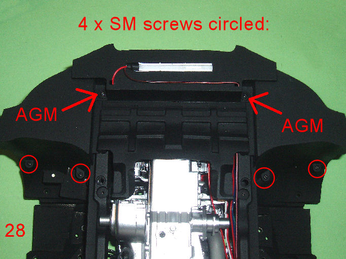

Pic 28: With the model upside down, fit the front panel and secure it with 2 x AGM screws and 4 x SM screws.

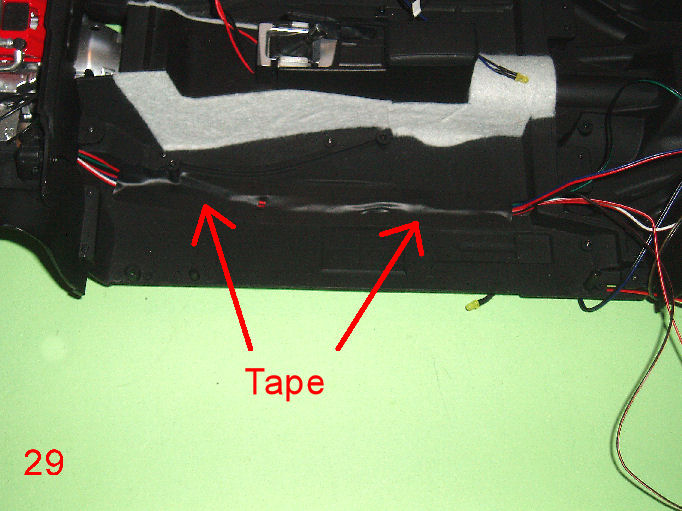

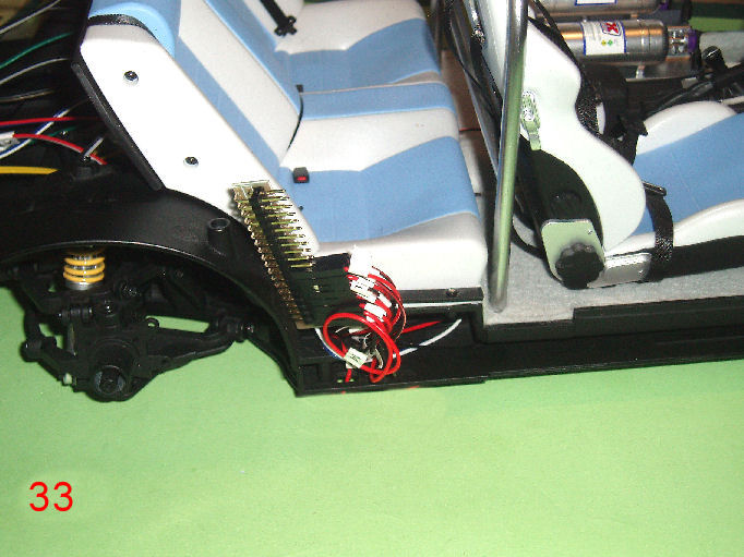

Pic 29: There are a LOT of wires in this model so to help keep things easier to manage, you could run all the wires fitted in this stage through the channel in the floor and keep then in place with tape.

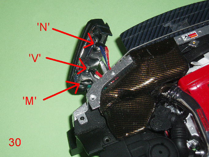

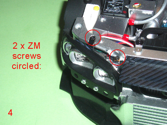

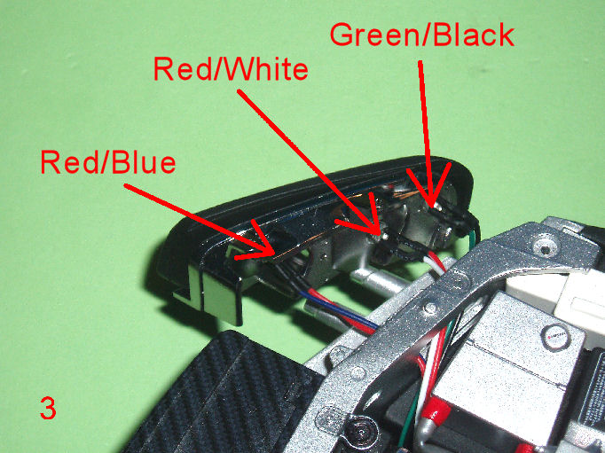

Pic 30: Retrieve the assembled headlight unit and plug in the three LED’s as shown keeping them in the right order.

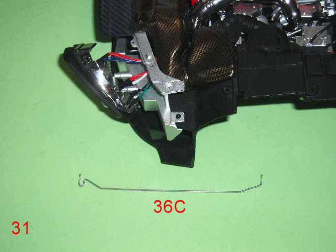

Pic 31: Remove the bonnet support for now and store it safely.

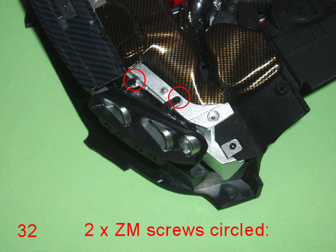

Pic 32: Fit the headlight unit as shown and secure with 2 x ZM screws.

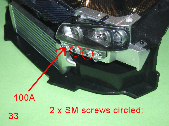

Pic 33: Fit the clear light cover 100A and fix with 2 x SM screws.

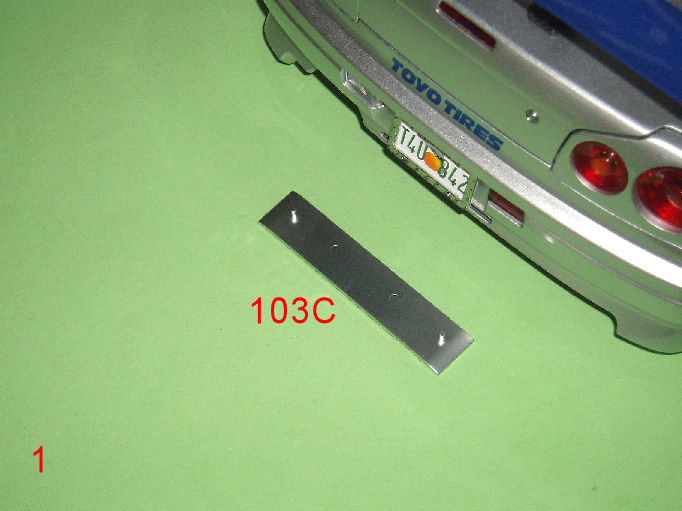

STAGE 101A:
Right headlight and front subframe.
NOTE: The order and manner of fitting the front subframe shown here is different to the printed instructions.
If you try to follow those instructions you will find assembly extremely difficult, if not almost impossible. The assembly is too springy and floppy for that method to work easily. The parts will not stay in place as you proceed.
The method described below will make the assembly far easier.
This is entirely at the builder’s discretion and you may wish to follow the printed instructions.

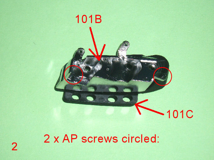

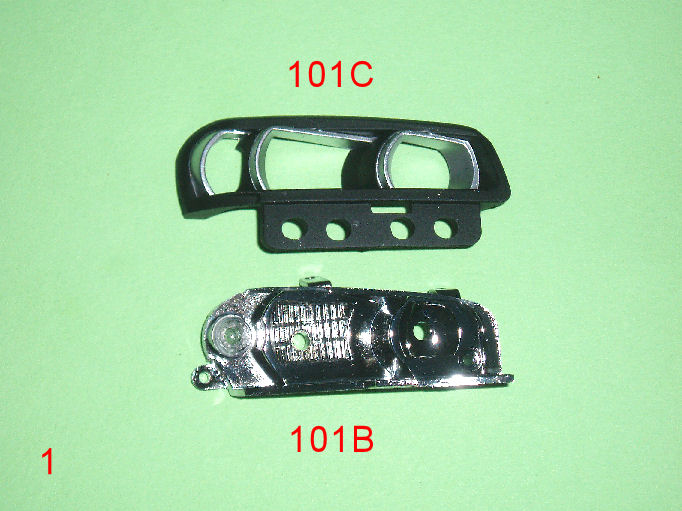

Pic 1: Locate the headlight parts 101B and 101C.
Pic 2: Fit the parts together and fix with 2 x AP screws.
Pic 3: Connect the LED’s into the rear of the light in the order shown.
Pic 4: Fit the light assembly to the body as shown and fix with 2 x ZM screws.

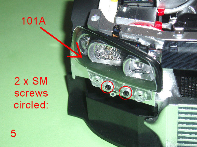

Pic 5: Fit the clear cover in place and fix with 2 x SM screws.

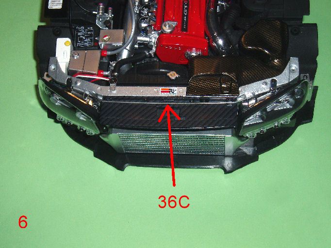

Pic 6: Re-fit the bonnet support 36C removed in the previous stage.

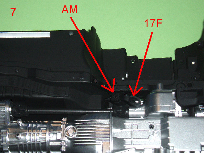

STAGE 101B:

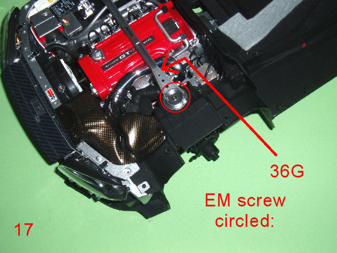

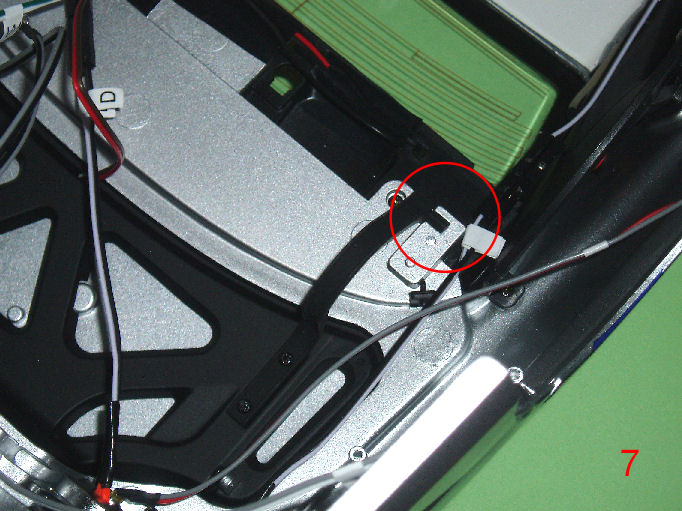

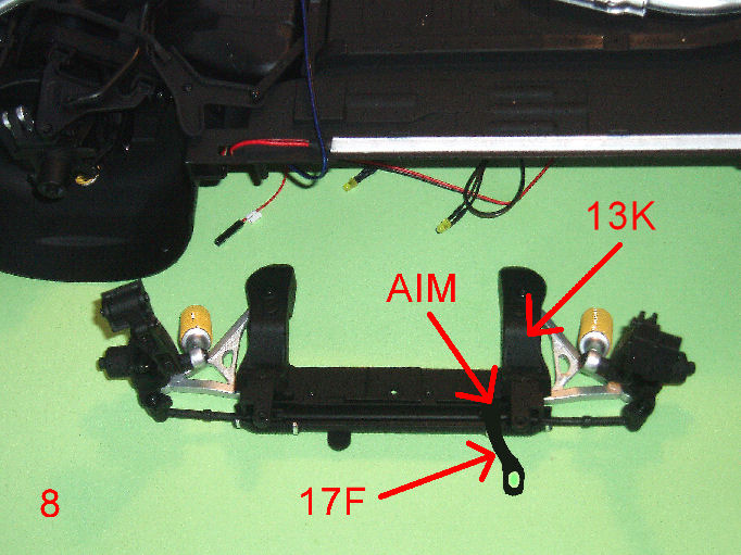

Pic 7: Turn the model upside down and remove the AIM screw and idler arm 17F. The screw can be discarded.
Pic 8: Retrieve the front suspension subframe assembly and fit the idler arm to the locating pin on the right side of 13K. Fix with I x AIM screw.

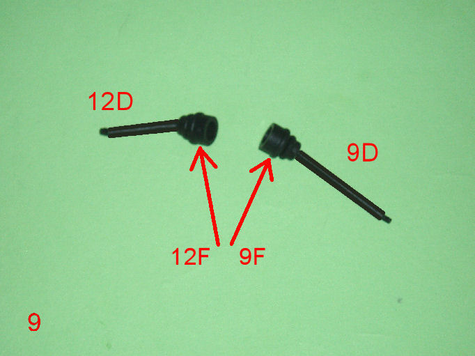

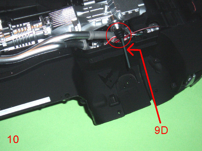

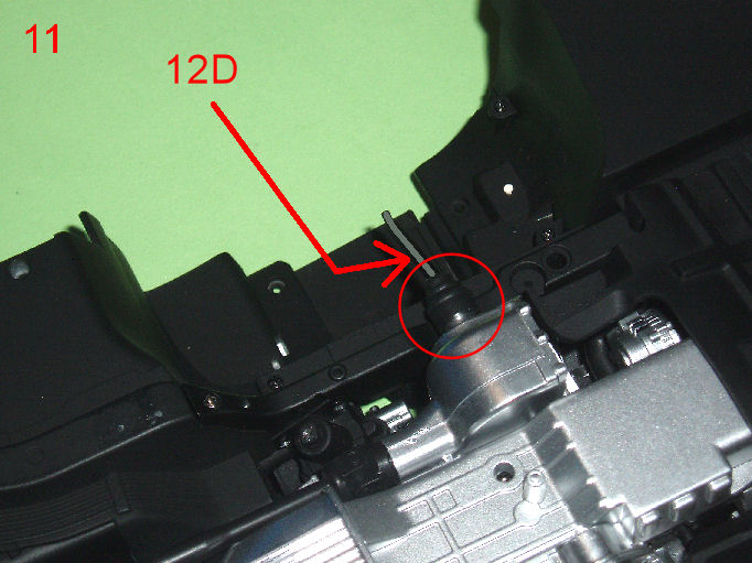

Pic 9: Assemble the shafts 9D and 9F, and 12D and 12F.
Note that 12D is shorter than 9D.
Pic 10: Press-fit 9D/F onto the left output housing as shown.
Pic 11: Repeat on the other side with 9D/F.
Pic 12: Lower the subframe assembly onto the main chassis.

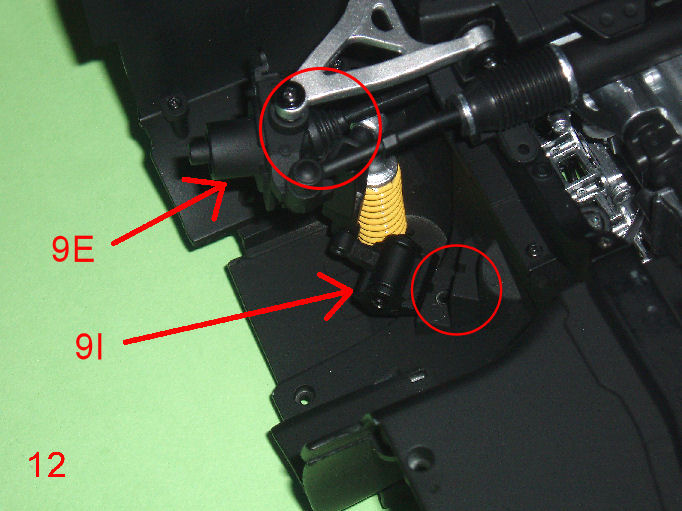

Note that the bracket 9I will locate in the area circled.
Be patient as this is quite fiddly.

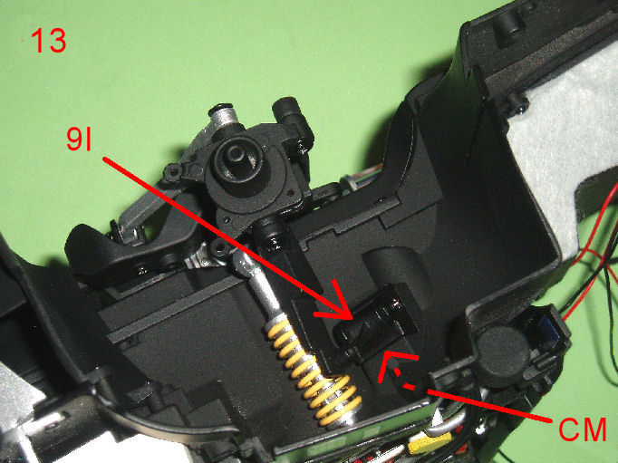

Pic 13: With the model on its side, fit the bracket 9I into place and hold it there while fitting the retaining screw CM from the other side through the hole in the wheel arch.

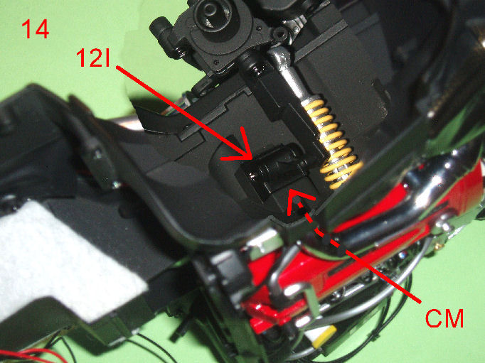

Pic 14: Repeat on the other side of the model, holding the bracket 12I in place while securing with a CM screw from the other side through the hole in the wheel arch.

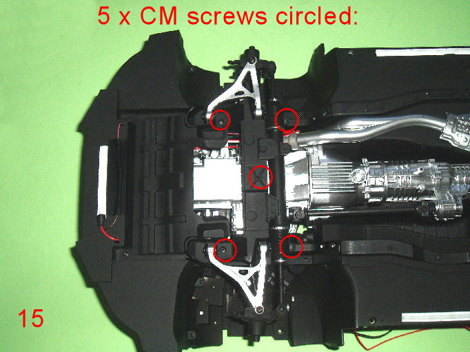

Pic 15: Fit the main assembly in place as shown and secure with 5 x CM screws.

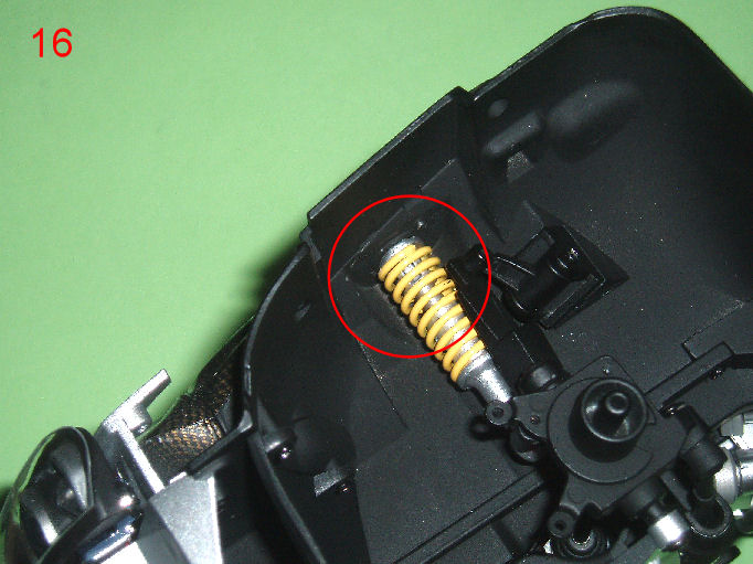

Pic 16: Make sure the left shock absorber is correctly located in place on the wheel arch as shown.

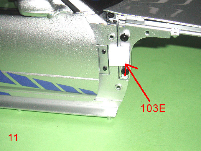

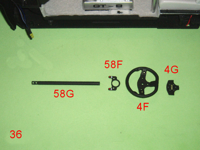

Pic 17: Retrieve the turret bar 36G saved from stage 36 and fit it as shown and fix it using 1 x EM screw through the wheel arch and into the shock absorber underneath.

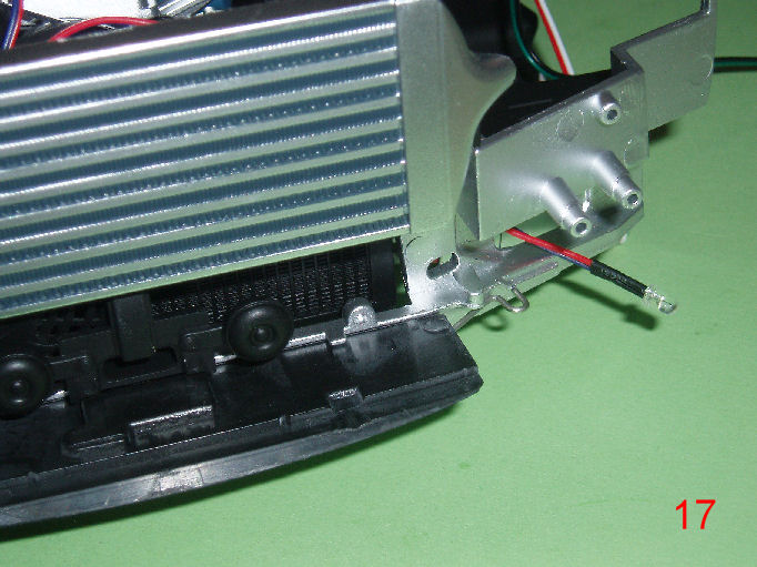

Pic 18: Make sure the right shock absorber is correctly located in place on the wheel arch as shown.

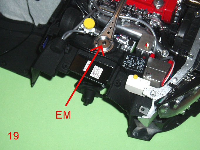

Pic 19: Fix the parts from above as before using 1 x EM screw.

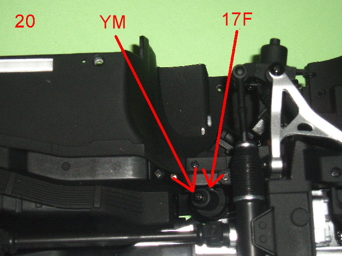

Pic 20: With the model upside down, fit 1 x YM screw where the idler arm had been previously fitted to 17F.

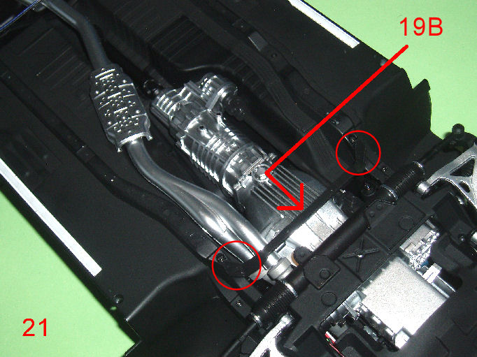

Pic 21: Retrieve the steering box support 19B saved from stage 19 and press-fit it in place as shown.
It will only fit one way.

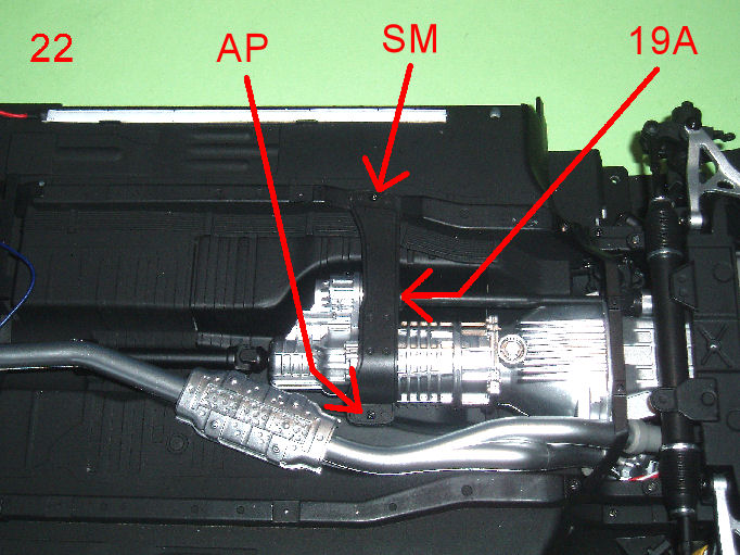

Pic 22: Fit the rear support 19A previously saved as shown and fix using 1 x AP screw and 1 x SM screw.

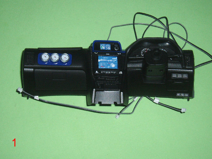

Pic 1: Retrieve the dashboard assembly.

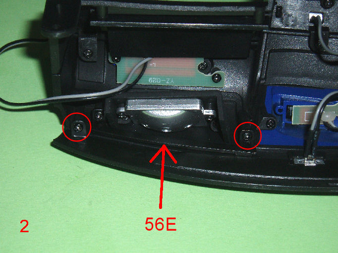

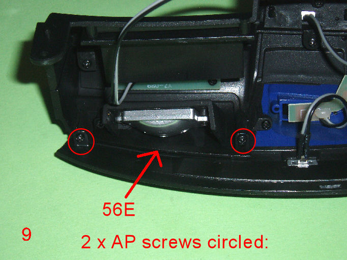

Pic 2: Locate the bracket 56E and screws shown.
Pic 3: Remove the bracket and screws and put to one side.
Pic 4: Take out the multimedia housing.

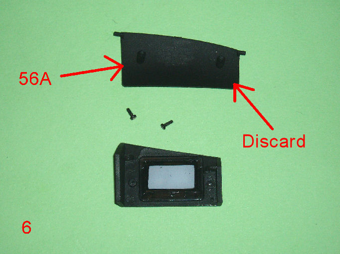

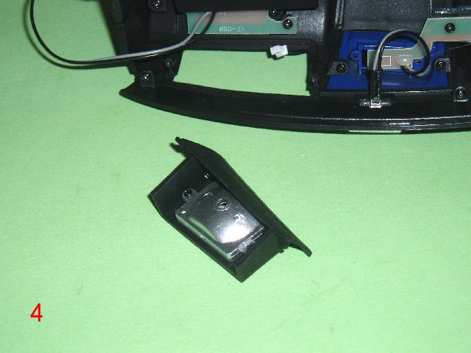

Pic 6: Remove the housing lid 56A and discard it but keep the screws.

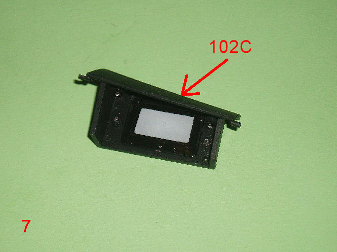

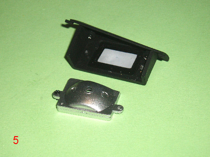

Pic 7: Fit the new lid 102C as shown.

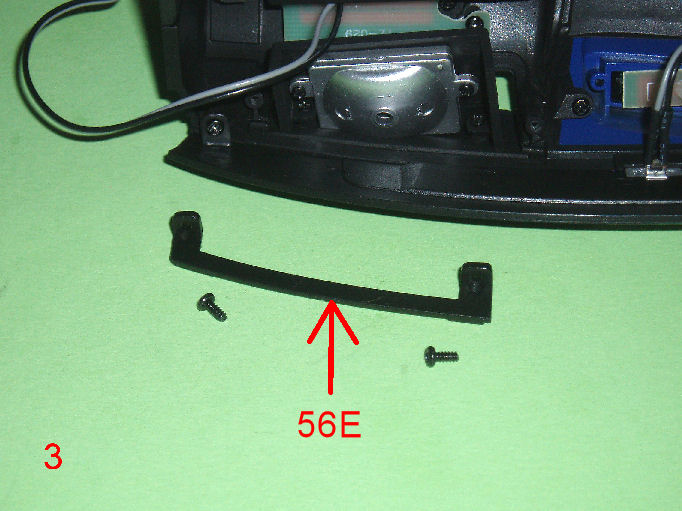

#14 Posted : 16 August 2025 15:18:02
Posts: 5,188
Points: 15,713

Pic 8: Re-fit the light housing.
Pic 9: Reassemble the housing and retaining bracket as shown.

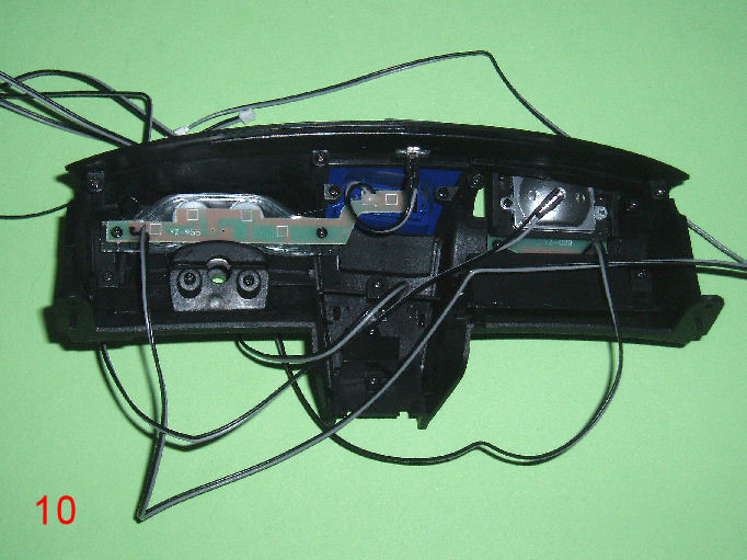

Pic 10: The dashboard reassembled with the LED put back in the multimedia unit.

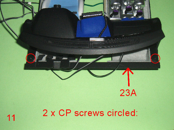

Pic 11: Retrieve the interior assembly and fit the dashboard in place as shown, fixing with 2 x CP screws.

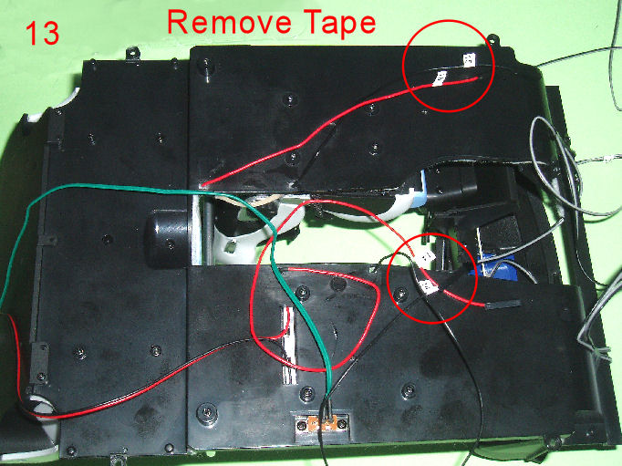

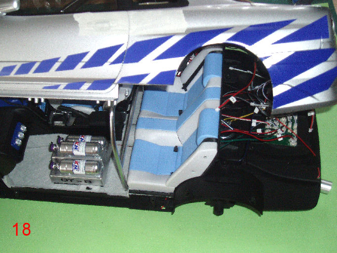

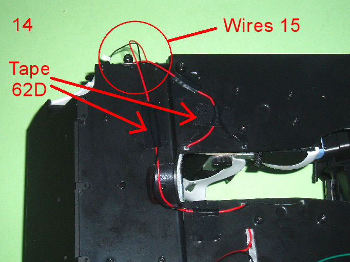

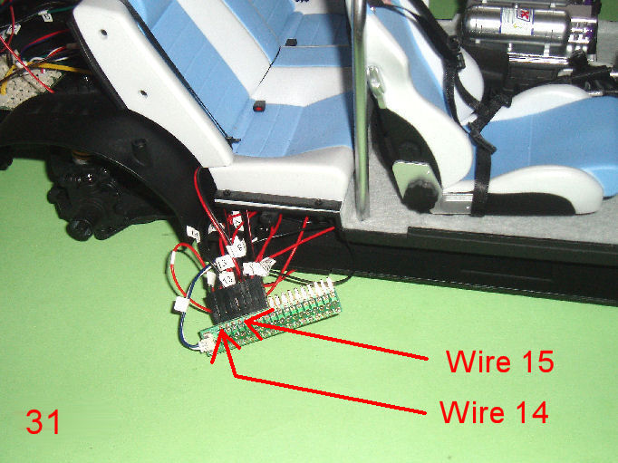

Pic 13: Turn the interior assembly over and remove the tape holding the wires 14 and 15.

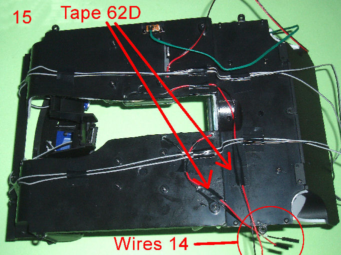

Pic 14: Tape the two wires ‘15’ as shown so they exit at the rear side of the floor.
Pic 15: Move the wires ‘14’ so they exit the floor next to the wires ‘15’ and tape them in place as shown.

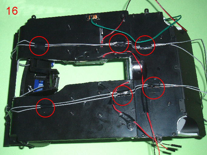

Pic 16: Tape the grey dashboard wires along the underside of the floor.

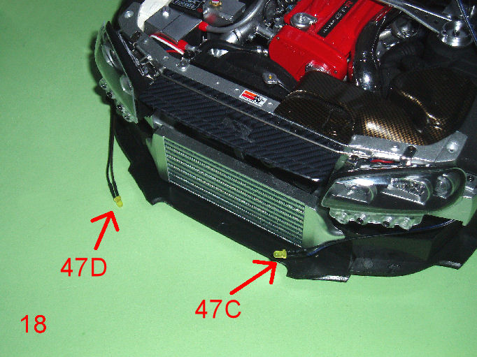

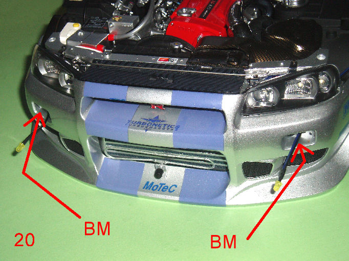

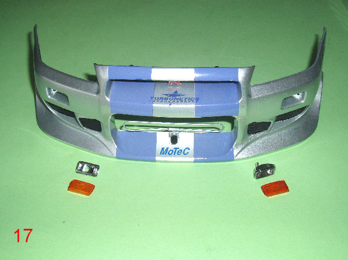

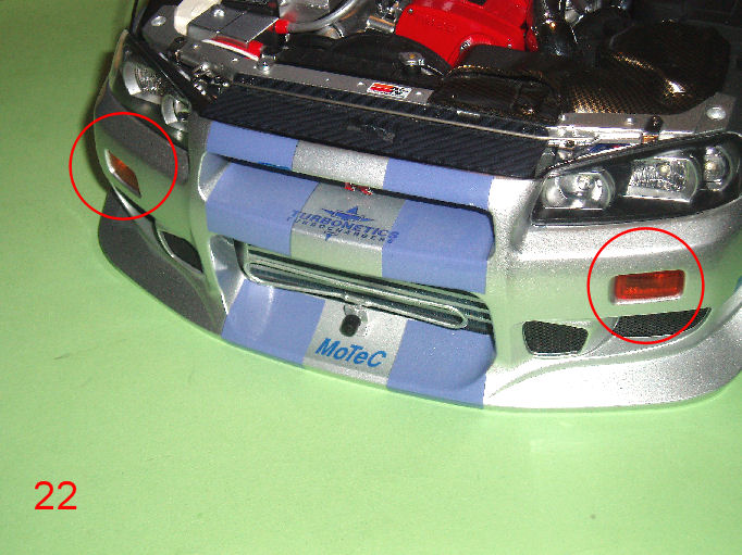

Pic 17: Retrieve the car body front panel and carefully push the sidelight assemblies out from behind.

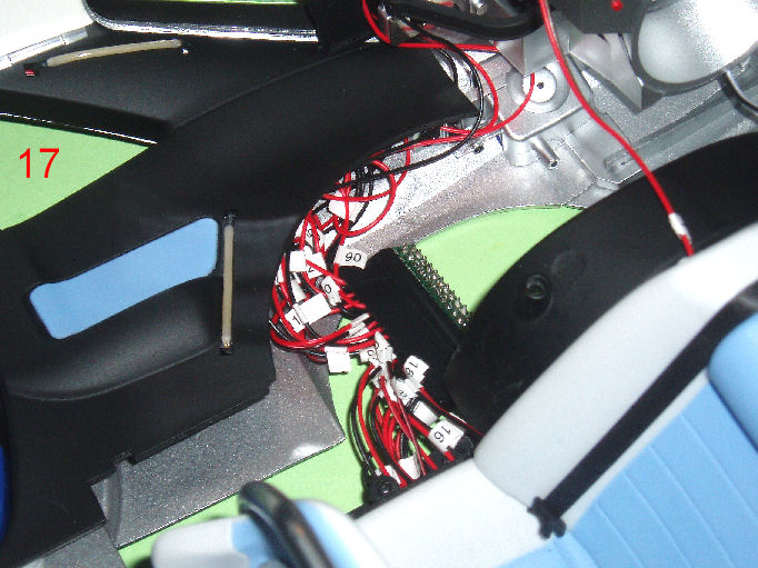

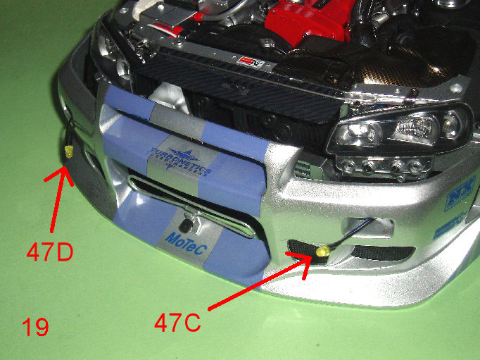

Pic 18: Locate the LED wires 47C and 47D and run them along the chassis from the rear to exit at the front as shown.
Pic 19: Position the front body with the LED’s exiting from the sidelight apertures.
Pic 20: Fix the front body in place using 2 x BM screws through the light apertures.

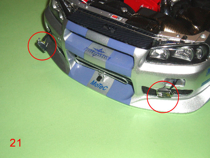

Pic 21: Press the LED’S into the light reflectors.
Pic 22: Reassemble the light units as shown.

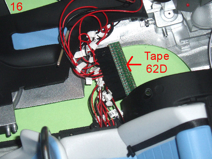

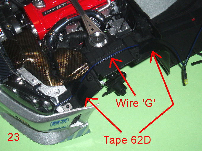

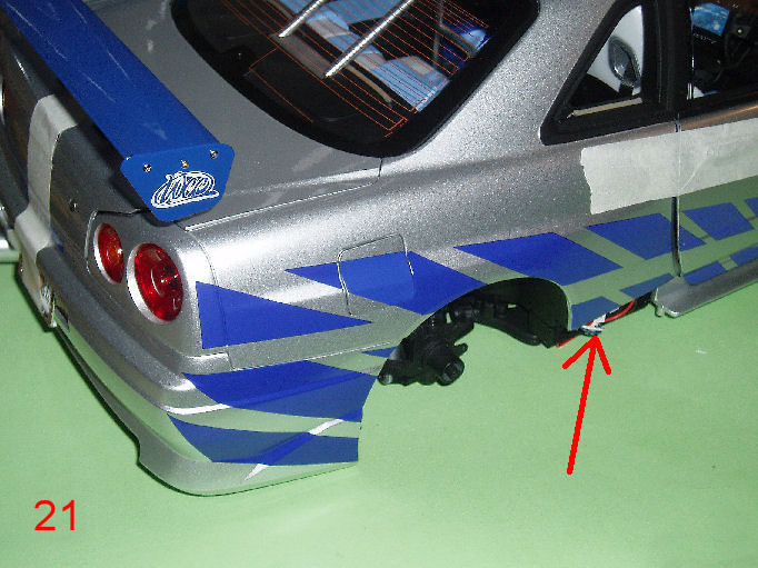

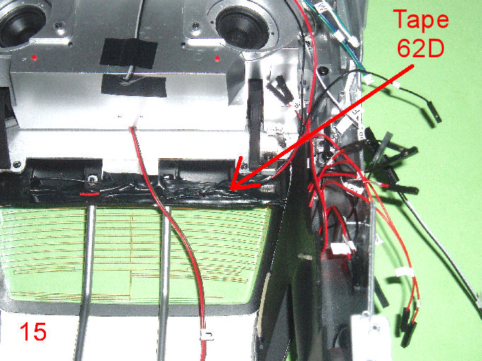

Pic 23: Run the blue wires ‘G’ over the wheel arch as shown and fix using tape 62D.

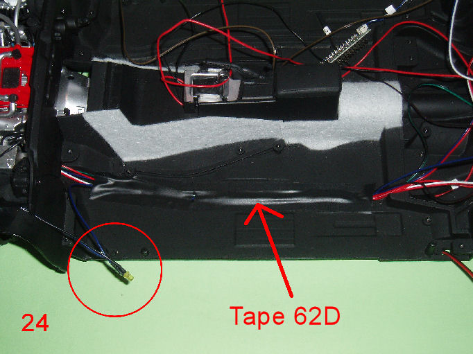

Pic 24: Making sure the second LED on the wires is free, tape the wires along the floor as shown.

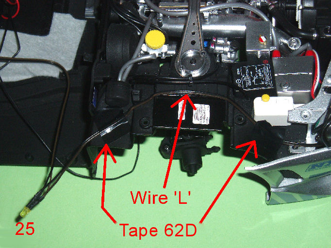

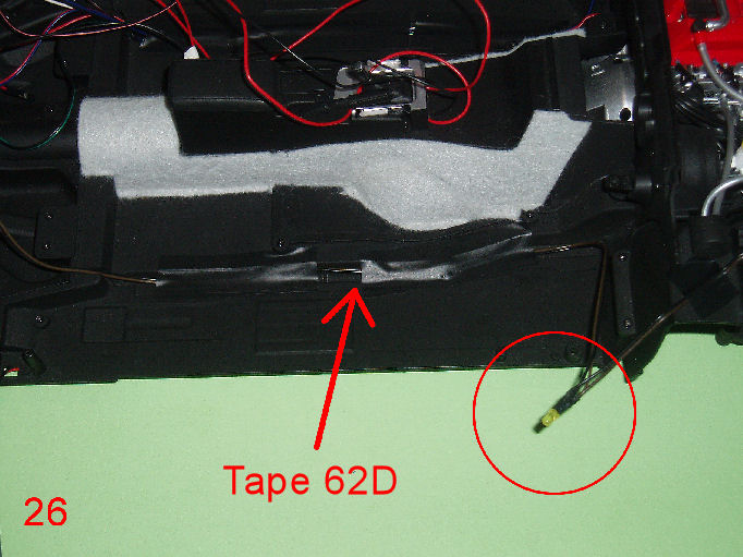

Pic 25: Run the brown wires ‘L’ over the wheel arch as shown and fix using tape 62D.

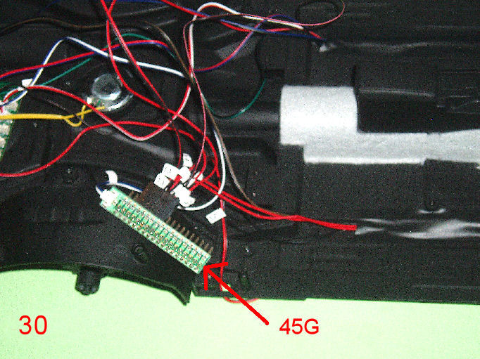

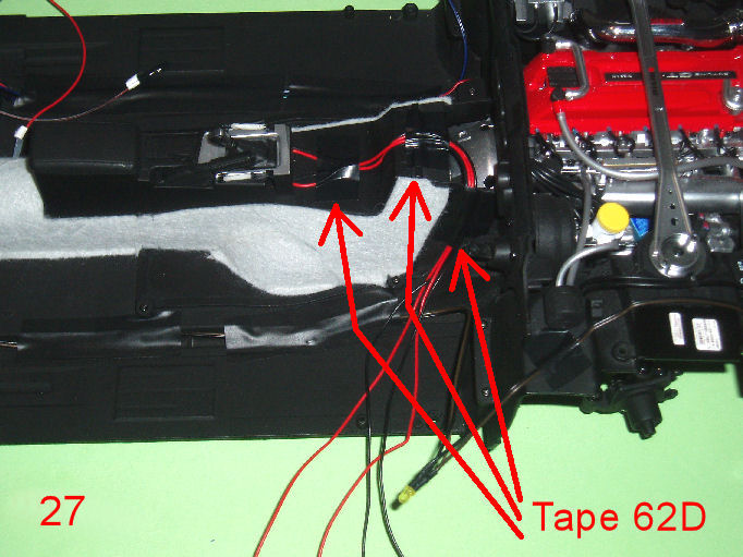

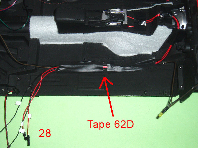

Pic 27: Tape all of the wires from the transmission tunnel in place as shown.
Pic 28: Tape the wires along the chassis floor as shown.

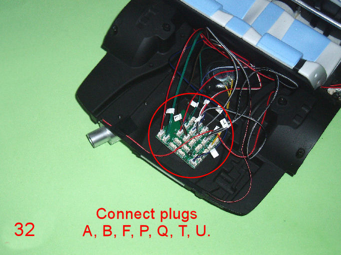

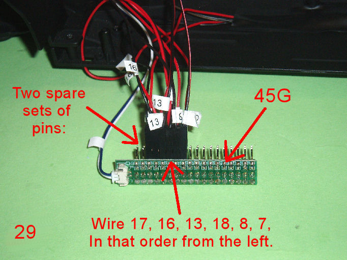

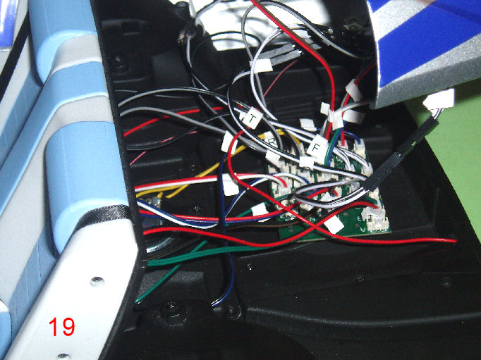

Pic 29: Connect the plugs on the wires to the PCB as show, noting that the first two pairs of connector pins are left free.
Connect the wires in the order shown with the black wires at the rear and the red wires at the front.
Pic 30: The PCB will fit here eventually.
Pic 31: Connect wires 14 and 15 to the end pairs of pins on the PCB with 14 at the end. Fit the interior assembly in place making sure all of the wires exit as shown.

STAGE 102E:
Pic 32: At the rear of the car, connect all of the plugs as shown to the PCB.
NOTE – The wiring can all be tested now by inserting batteries into the car and the remote control unit.
Follow the testing descriptions in the printed instructions which are not duplicated here as it would involve an unnecessary large number of extra pictures which are not needed.
When you are happy everything works as it should you can proceed.
Pic 33: The PCB should now be positioned as shown.
Pic 34: Fix the interior to the chassis using 2 x CM screws.
Pic 35: On the other side, fix the interior to the chassis using 2 x CM screws.
Pic 36: Locate the steering wheel parts saved from previous issues.
They will assemble in the order shown.
Pic 37: Fix the parts together using 1 x AM screw through the wheel centre before fitting the centre cap.

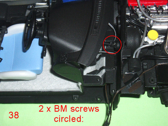

Pic 38: Slide the steering column through the dashboard mount and fix at the front using 2 x BM screws.
You will have a number of CM screws left over.
Keep them to one side for the next stage.

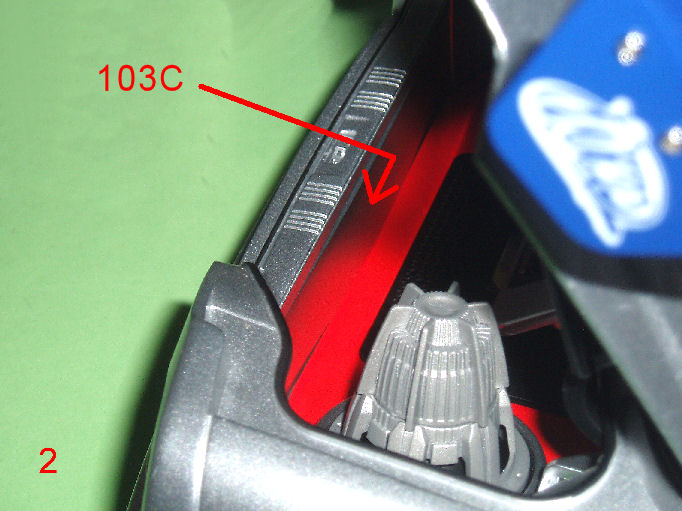

Pic 1: Locate the inner boot panel 103C.
Pic 2: Press-fit the panel inside the boot as shown. It will only fit one way.
Pic 3: The printed instructions do not mention this but you can now fit the boot struts together on each side.

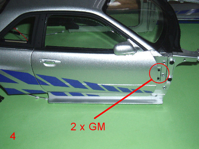

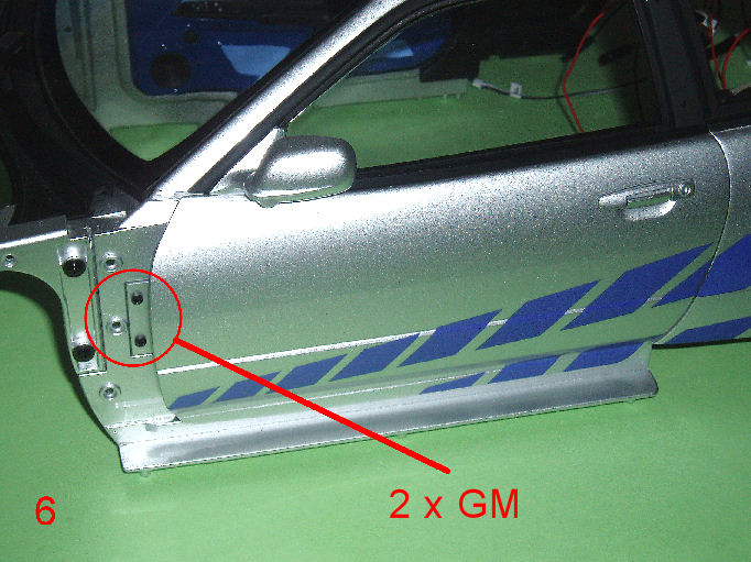

Pic 4: Fit the driver’s door and secure with 2 x GM screws.
Pic 5: You can temporarily tape the door shut. This will be helpful for future parts of this stage.
This is at the builder’s discretion.
Pic 6: Fit the passenger door and secure with 2 x GM screws.
Pic 7: You can temporarily tape the boot shut. This will be helpful for future parts of this stage.

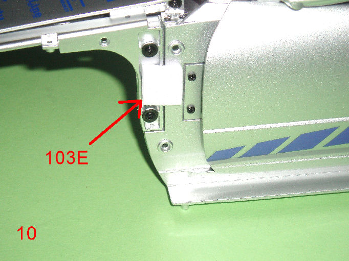

Pic 8: Fit the bonnet to the front of the body and fix with 2 x TM screws on each side.

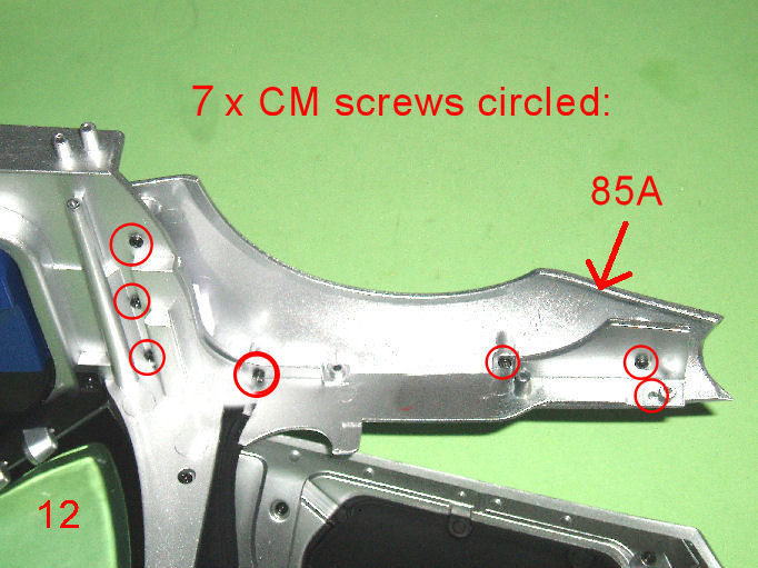

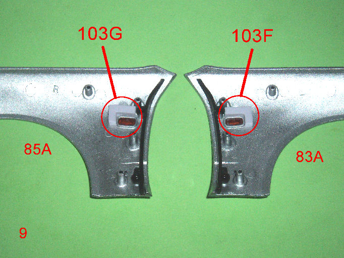

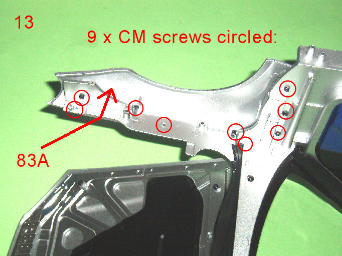

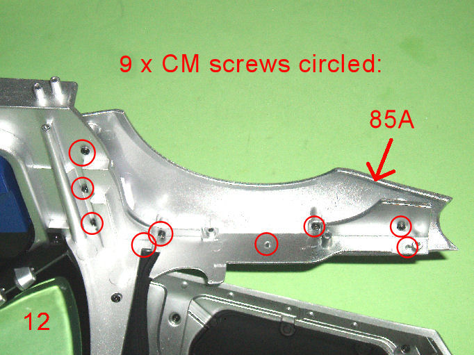

Pic 9: Retrieve the front wing panels 83A and 85A and fix the self-adhesive pads 103F and 103G in place as shown.
Pic 10: Stick the self-adhesive pad 103E to the body just in front of the door hinge as shown.
Pic 11: Stick the self-adhesive pad 103E to the other side of the body just in front of the door hinge as shown.
Pic 12: With the model upside down fit the front wing 85A in place and fix from the inside using 6 x CM screws.
NOTE – The printed instructions do not mention the 1 x CM screw that must be fitted from the top of the wing at the front, with the body the right way up. DO NOT fit screws in the two other holes on the top edge of the wing
Pic 13: With the model upside down fit the front wing 83A in place and fix from the inside using 6 x CM screws.
NOTE – The printed instructions do not mention the 1 x CM screw that must be fitted from the top of the wing at the front, with the body the right way up. DO NOT fit screws in the other two holes on the top edge of the wing
Pic 14: You can temporarily tape the bonnet shut. This will be helpful for future parts of this stage.
Pic 15: With the main body upside down in the position shown, tape all of the wires from the left body side so that they exit with the main set of wires on the right.
This does not include any wires from the boot area.

STAGE 103C:
Pic 16A: This shows the instructions from the printed set, part 103-11.
Connect all the wires from the body to the PCB in the order shown in the circled image in the printed instructions for 103-11.
NOTE – The larger illustration is incorrect. DO NOT follow that diagram.
Wires ‘1’ must be on the right, at the end of the PCB, with the others following numerically to the left.
Pic 16: Prop the main body on its side as close to the floor section as you can, as shown.
NOTE – As stated in 16A, the larger illustration is incorrect. DO NOT follow that diagram.
When this is done, you can tape all of the connections together using tape 62D to prevent any of the plugs coming undone in the next few steps.
Pic 17: Tuck any loose wires up inside the body panel as shown.
Pic 18: VERY carefully tilt the body over the chassis and prop it up so there is access to the PCB in the boot.
If you do not do this you will be unable to connect the final wiring plugs at the rear.
Pic 19: Following the wiring diagram in the printed instructions, connect all of the wires that are not yet plugged in to the PCB.
Take your time here as access to the PCB is quite difficult due to some of the wires being quite short.
MAKE SURE ALL PLUGS ARE CONNECTED.
At this stage you can test all the recently installed electrics.
To avoid a large number of unnecessary pics, follow the guide in the printed instructions.
When you are satisfied everything works properly, proceed with the build.
Pic 20: Carefully fit the body over the top of the chassis, starting at the back.
Pic 21: Make sure the PCB at the side of the car is sitting upright and is not trapped anywhere.
Pic 22: Lift the front of the body and prop it up so there is some access to the inside area.
Do not try to lift it too high as you may dislodge plugs in the side PCB.
