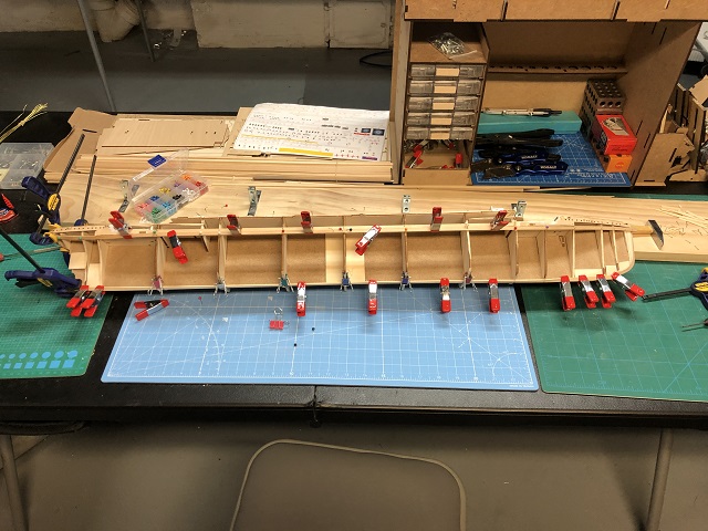

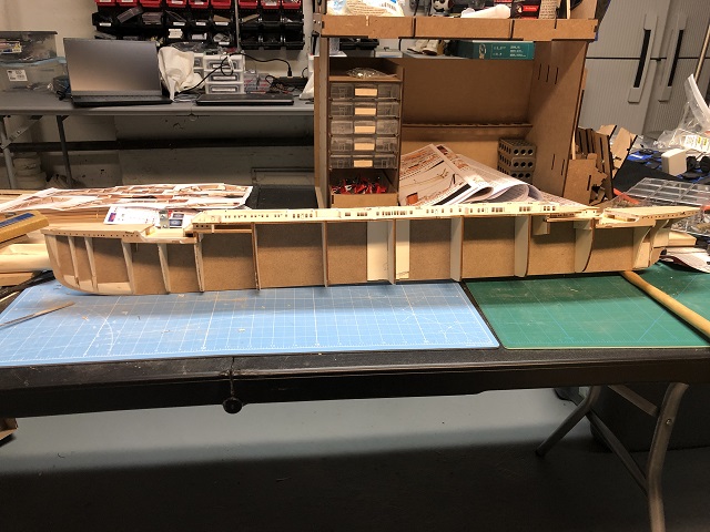

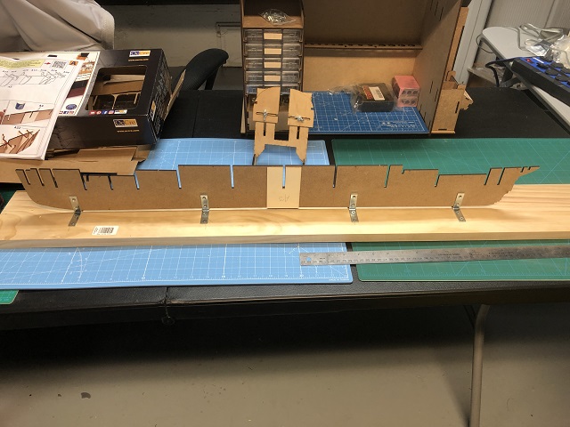

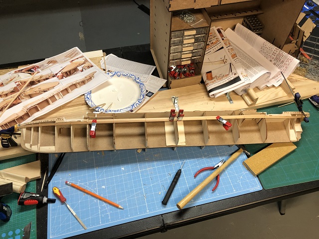

The main hull section is in 2 parts that need to be glued together.The fit was a bit sloppy, but once assembled the part was very straight with no warp.I tried using the Model Expo fair a frame device to hold the hull up but to be honest it was about as much use as a chocolate teapot so I reverted to my usual technique of using shelf brackets screwed on to a flat board.Each bulkhead fit quite well into the slots but they were a bit loose so I used a right angle to make sure the bulkheads were truly perpendicular to the hull.
As you fit the bulkheads you also start construction of the deck.This involves planking the deck and building the structures that make up the cabins. these are built from straight parts that you glue together to make boxes.You then fill the seams of the boxes and paitn them white.Due to the small scale of the kit windows and doors are represented by stickers that you apply over the white painted boxes.

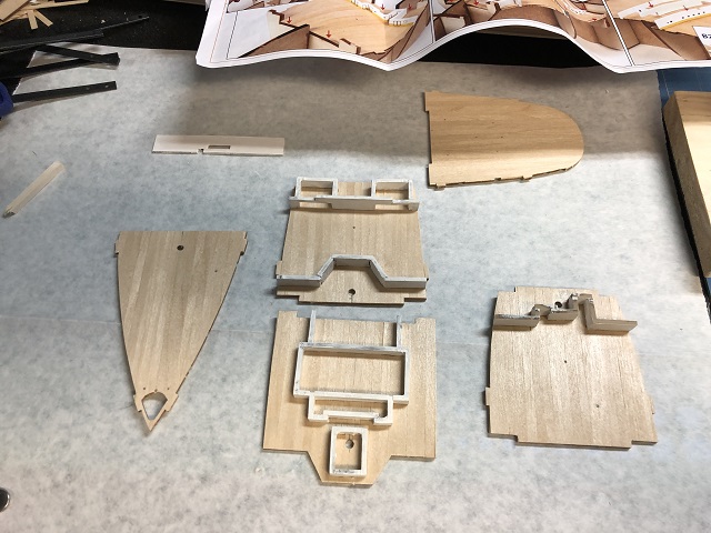

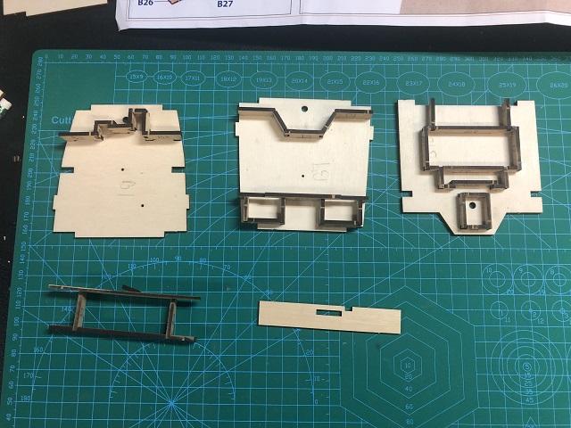

#7 Posted : 12 March 2023 17:46:35

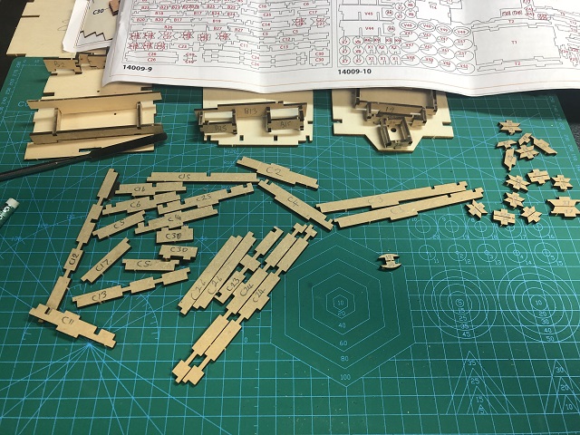

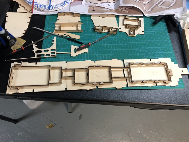

Ok the next step is to assemble the cabins that sit on top of the lower deck.These are made of flat pieces that interlock together and then you sand the joints and paint them white.Stickers will be used to represent windows.You can use the lower deck to align the parts and make sure that they will slot into the holes in the deck once assembled.

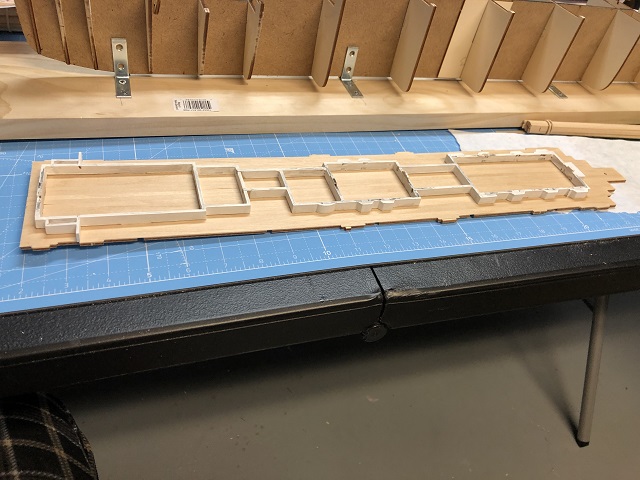

#9 Posted : 15 March 2023 20:29:06
OK the next step is to apply the deck planking to the lower decks.this was a bit frustrating because it was clear from the photos that some of the holes in the deck need to be planked over and some need to be open.So if you build this kit pay close attention to the build videos as it is much cleaer on those where you need to cut through the deck planking.A couple of coats of sating vernish were applied to the decks.Once the decks were dry the previously constructed deck structures were glued to the decks.

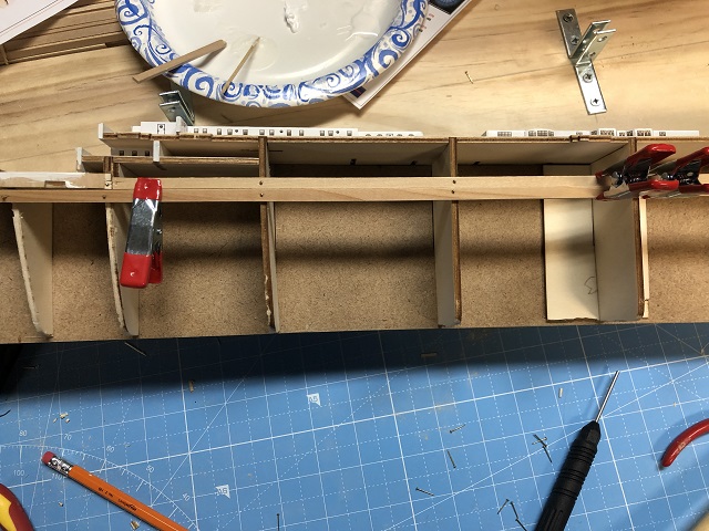

#10 Posted : 19 March 2023 16:53:28
In the next step we apply the decks to the bulkheads and start the planking.this is a single planked hull and since the real hull was metal the planking detail will all be covered by paint so there is no need to follow the ships lines to make perfect planks.I love planking .I find it so satisfying to see the hull really take shape.
Once the decks were attached I faired the hull.the bow has a very sharp point to it and the bow is a rounded shape.
The first 2 "planks" are applied at the bow and stern.These have some portholes in them and they help establish the run of planks
I sokaed the planks and then temporarily atached them to the hull so they took on the hull shape as they dried.There are no really tight bends with this hull so I didnt need to use a plank bender.

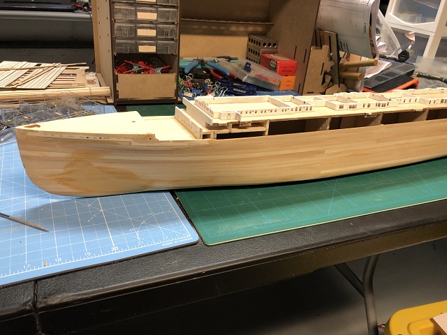

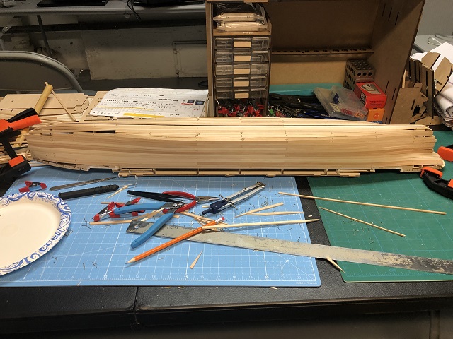

#12 Posted : 23 March 2023 23:41:58

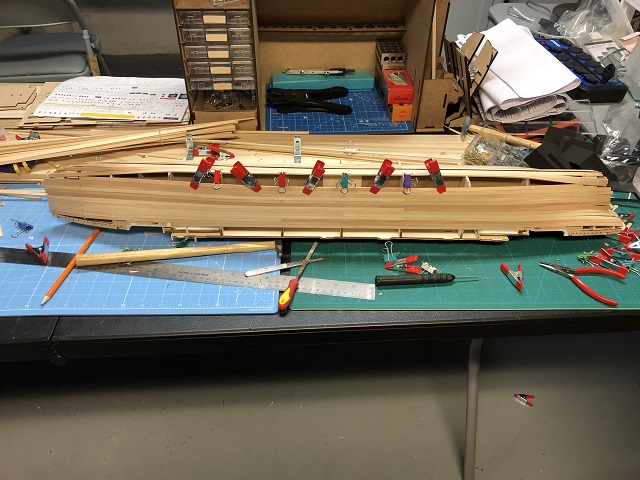

planking planking and more planking.I use bulldog clips and small clamps to hold the sokaed planks in place until they dry out and take up the curve of the hull and then I glue them in place.It takes a bit longer to do it this way, but it saves you having to bend the planks with a plank bender.
#13 Posted : 29 March 2023 19:54:59

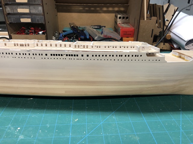

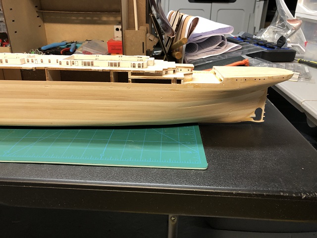

OK all of the stealer planks were fitted to complete the hull and then I used wood filler and sanding to start the process of smoothing the hull.Since there will be multiple parts stuck onto the side of the hull to mimic the hull plating the hull doesnt have to be perfect, but I wanted it as smooth as possible.The hull plates are made of cardboard and I have read people having major issues getting them to stick to the wood so I didnt want it glass smooth.
The next step after this is to fit the lower level side pieces that have the windows cut into them.

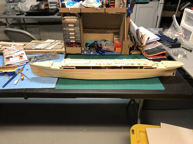

#15 Posted : 05 April 2023 18:17:44

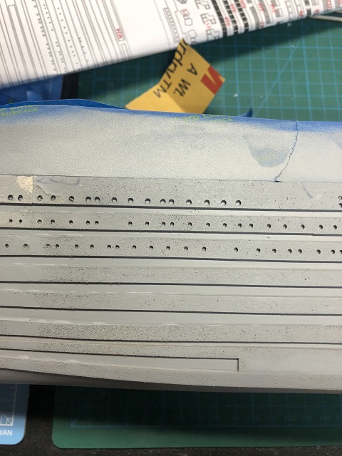

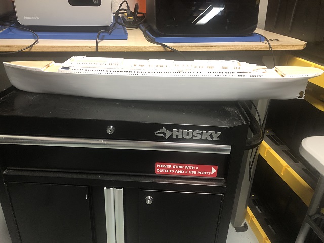

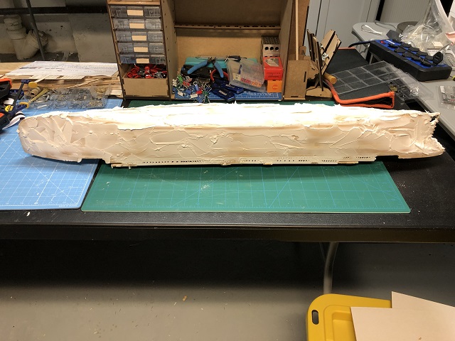

OK next step was to apply filler to the hull to make is smooth.it doesnt have to be perfect because there are additional planks you apply to recreate some the the details.I used lightweight spackle.I really made a mistake here.Following OCCREs recommendations I covered the whole hull in spackle (filler).it then took me HOURS to sand it all off.I watched a video afterwards from someone buildign this and he applied a thin coat of primer to highlight the rough spots and then just applied filler there.That is what I will do next time.
I sanded the spackle off with 120 then 220 and 320 grit sandpaper.Once that was done I applied 2 coats of tamiya grey primer to the hull.Again I should have applied a sanding sealer first.I used dilute PVA glue to coat the hull to seal the pores in the wood, but it ddint work that well.
Now the hull is primed the next step is to apply the side details.These are paper strips.They look really good because they are quite thins and to scale.I have read that they are a bit of a nightmare to apply because they are made of paper and getting them to stick to the hull is diffiult and when you try to sand them to hide the seams in the parts they tend to fall apart.

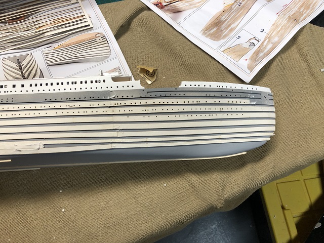

#17 Posted : 13 April 2023 19:18:09
Thanks Derek.

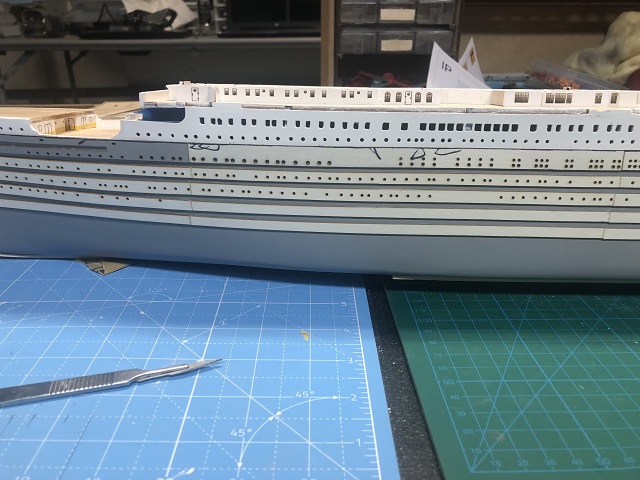

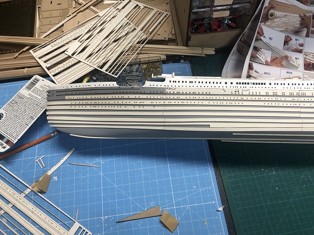

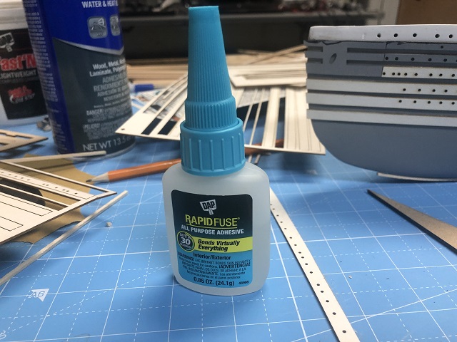

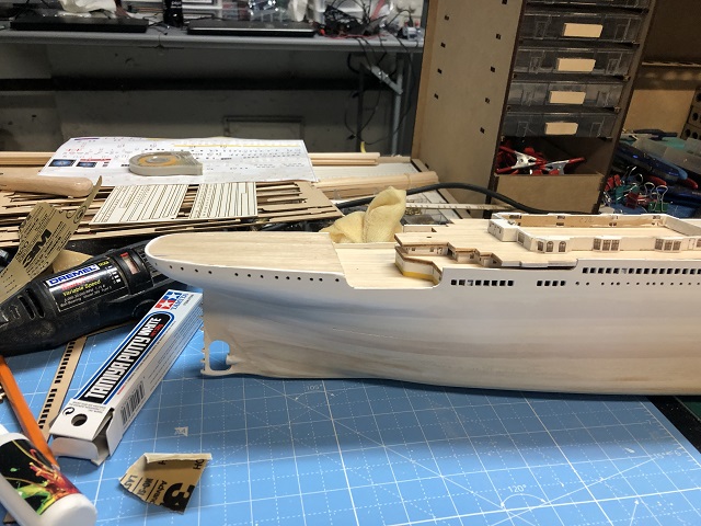

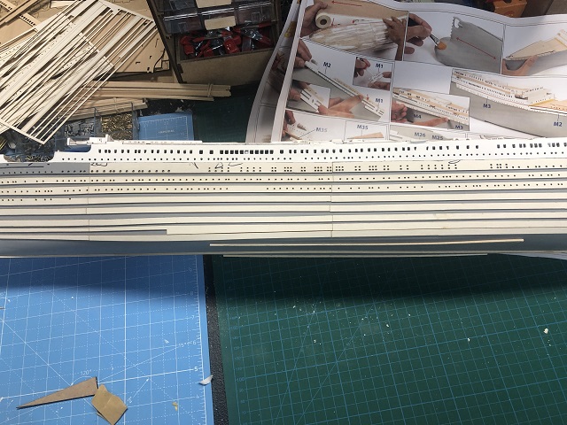

So now we start adding the dreaded side detail parts.These are made of cardboard ( I think). I have watched some build diares that say these are a devil to work with .they dont stick well to the hull and they disintegrate when you sand them.
So with this in mind I toom a deep breath and started.I can confrim they are no fun to work with.They are quite delicate and will crease if you apply any pressure to them. I used a 30 second superglue which actually worked very well except it did spooge out in some areas.I think I used too much glue because I was nervous they wouldnt stick.If they dont stick well you will need to repalce the part you stuck because there is no way to get a partially stuck pice off again without it ripping.
occre gives you a spacer to figure out the spacing but it was hard to use that and hold the piece against the hull for 30 seconds so I just eyeballed the positioning.

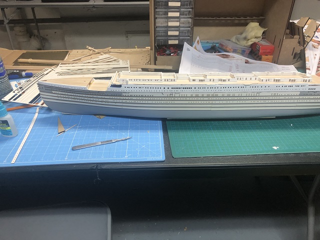

#18 Posted : 13 April 2023 19:21:21

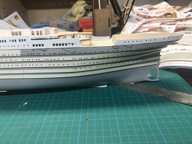

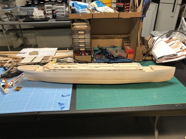

SO there are 35 of these cardboard peice to apply to each side of the hull.Once they are all applied you need to use filler to hide the seams between the pieces prior to painting and then you prime the hull in preparation for the final hull colors.I also added the keel piece and the 2 outer pieces to the turn of the hull.
#19 Posted : 13 April 2023 19:25:22
I used lightweight spackle again for filler and applied it very sparingly.I read that you cant use anything under 320 grit sandpaper to sand these parts of they just fall apart. I used 400 grit to sand them seams and put a light coat of primer on a test area.As you can see it looks awful.This will likely need repeat sanding with 600-800 grit sandpaper to get a smooth result and you have to go VERY slowly or the paper just starts peeling up ans you can see it did on the top piece in the photo.
#20 Posted : 13 April 2023 19:30:54
