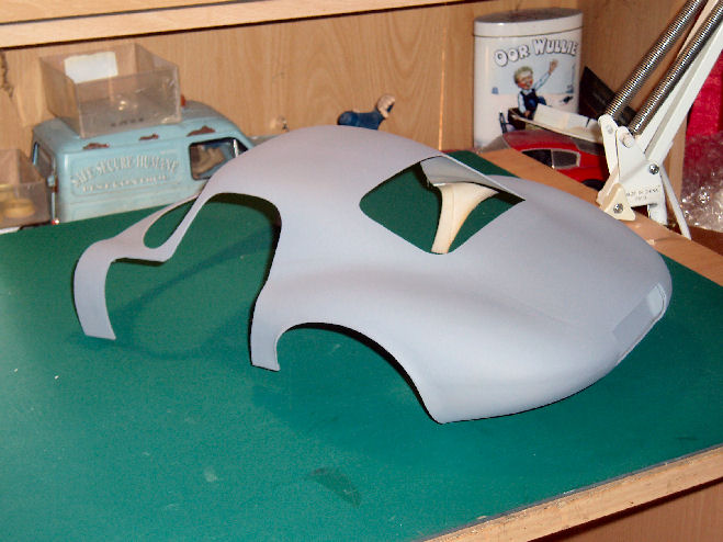

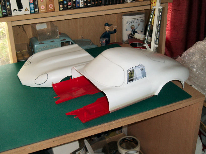

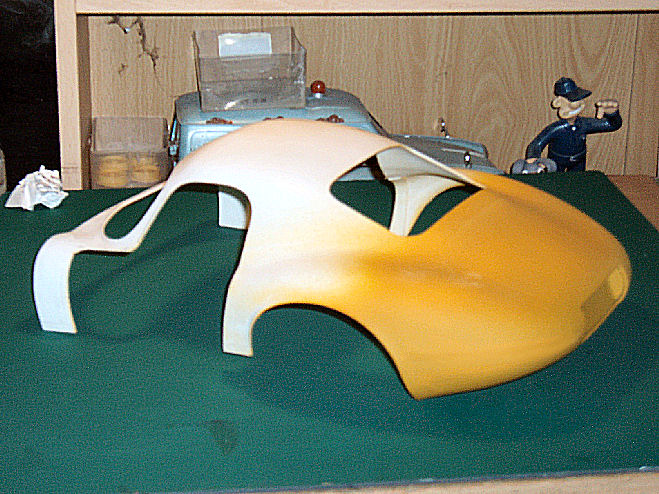

This has been on the back burner for a long time but I've decided to make a start on it in between my other builds.
As far as I know, there isn't a 1/8 model of this incredibly famous E Type.
I'm going to add all the bits - engine, interior, opening doors etc.
This one will use a few bits of the big Revell kit - floorpan, suspension parts, uprights, diff cage etc.
The body has been floating about for an age and it was made from a rough carved wood buck years ago, and then vac formed. It will need a lot of filler and sanding.
Anyway, fingers crossed.LOL LOL LOL

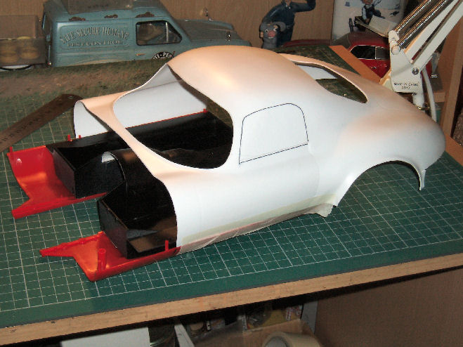

#3 Posted : 18 January 2023 16:35:37
Posts: 5,188
Points: 15,713
Many thanks Mark.

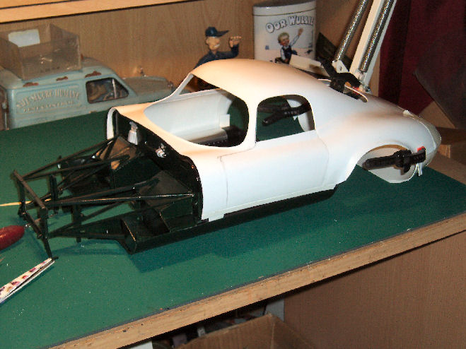

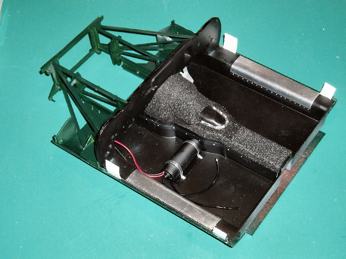

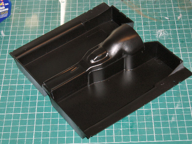

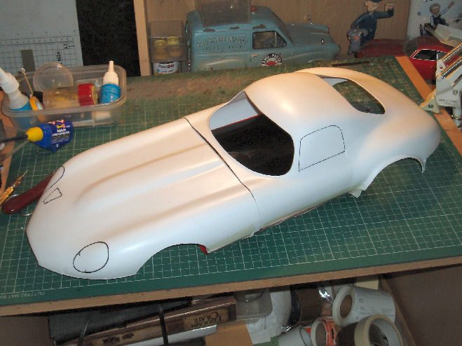

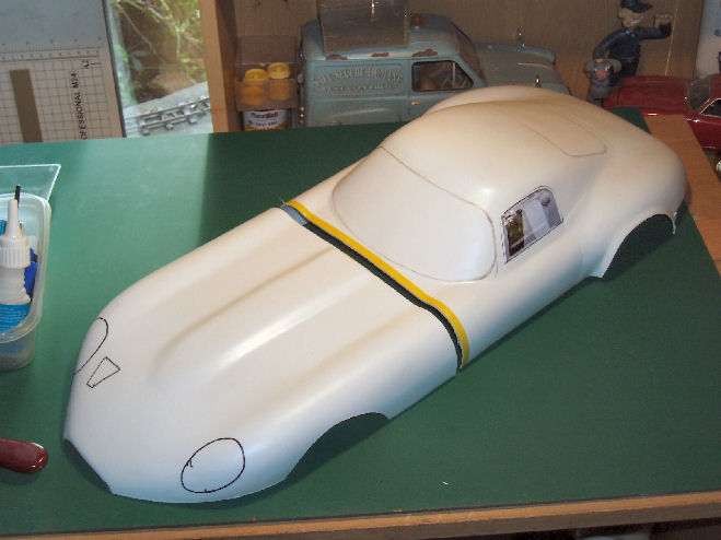

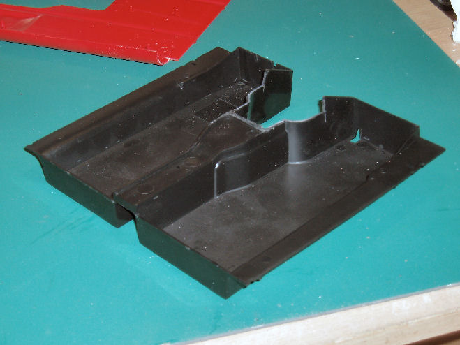

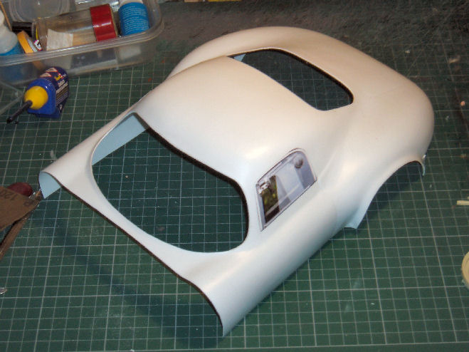

A bit of 'mocking up' today.
Side window templates were easy - scaled up from a side-on view of the real car.
Floor part checking for fit - all ok so far.

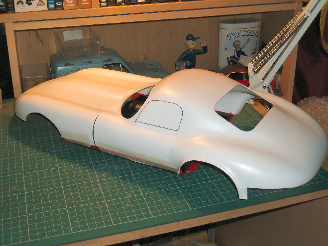

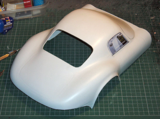

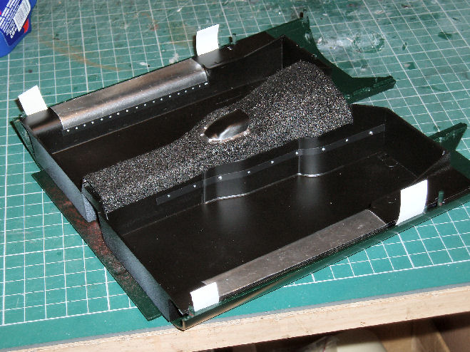

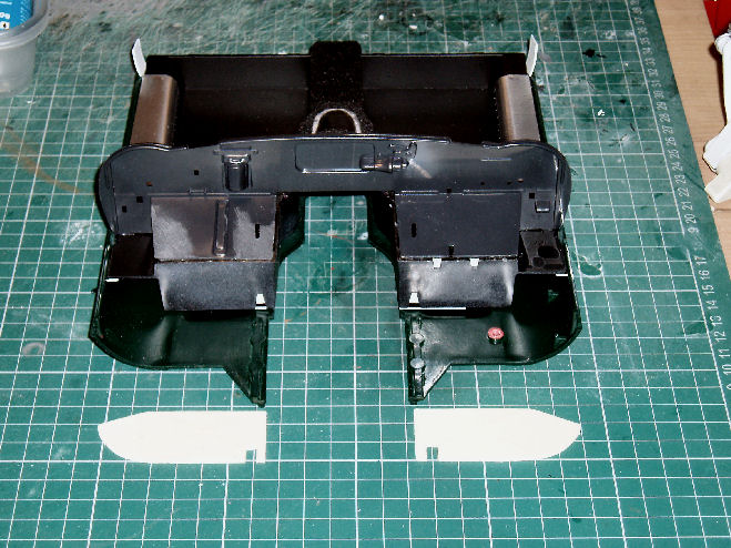

A bit more...

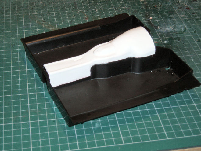

I've chopped the transmission tunnel dashboard end off, and fitted in a moulding of my own that is a more accurate shape for this car.
The upper area needs to be carpeted.

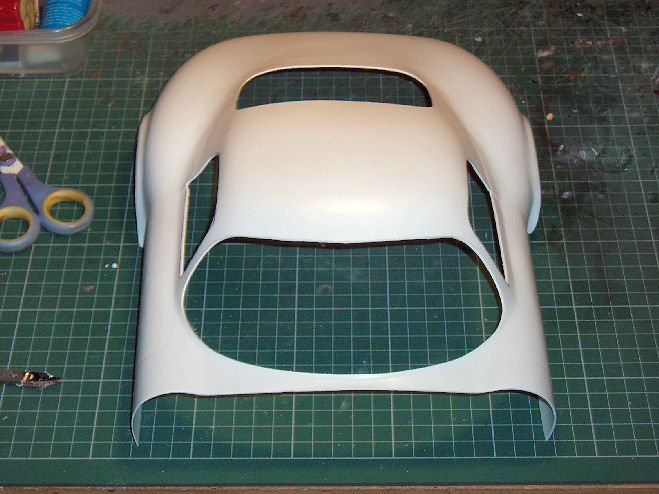

Rear window now cut out but it needs a bit of tidying up.
Front screen next.

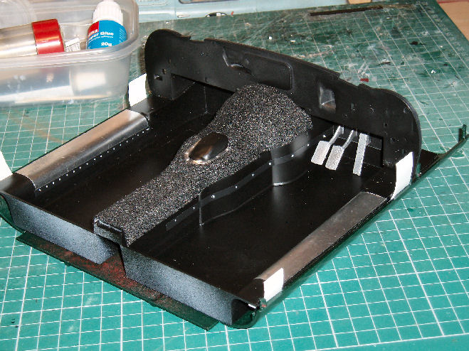

#5 Posted : 24 January 2023 13:16:14
Posts: 5,188
Points: 15,713

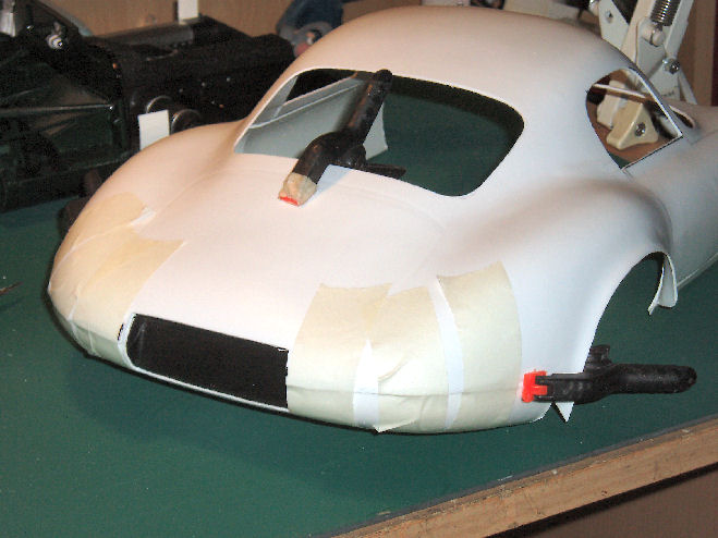

More window-chopping and test fitting of parts.
Nothing exciting yet.BigGrin
#6 Posted : 26 January 2023 16:53:31
Posts: 5,188
Points: 15,713
For those following...

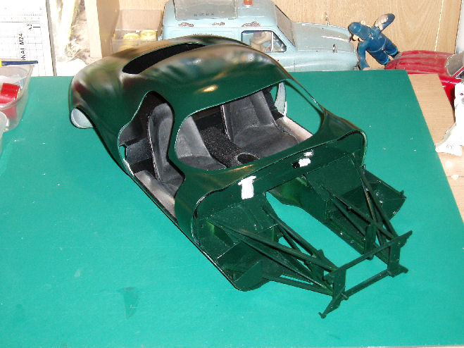

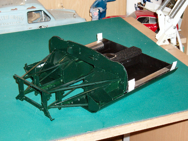

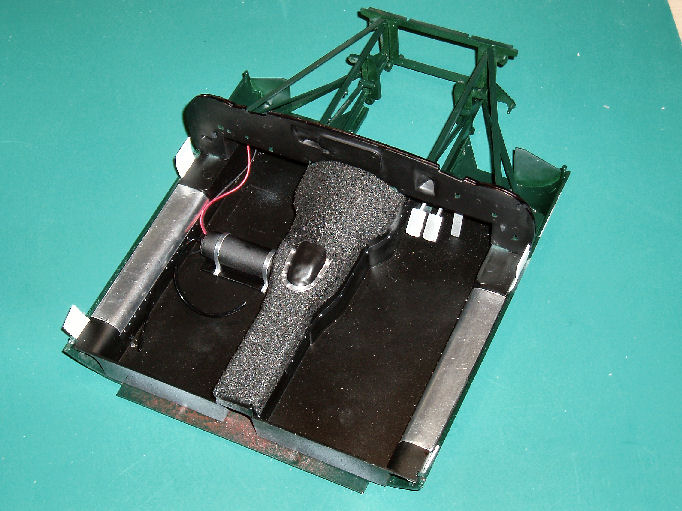

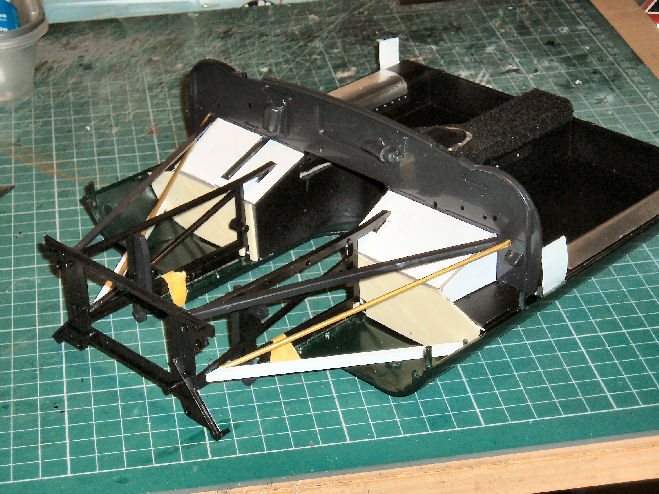

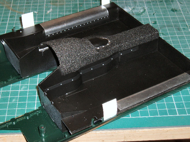

I've done some more on the interior, based on pics of the real car. Carpeting the compound shapes of the tunnel top was fun.
Front firewall in and a start made on the engine frames. It will all get a coat of dark green shortly.

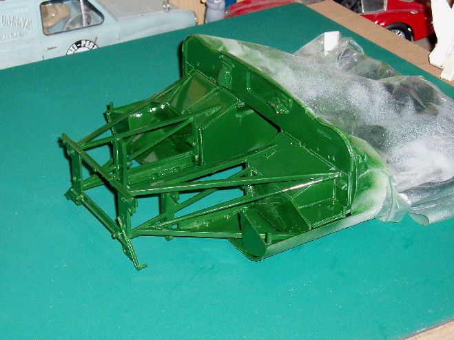

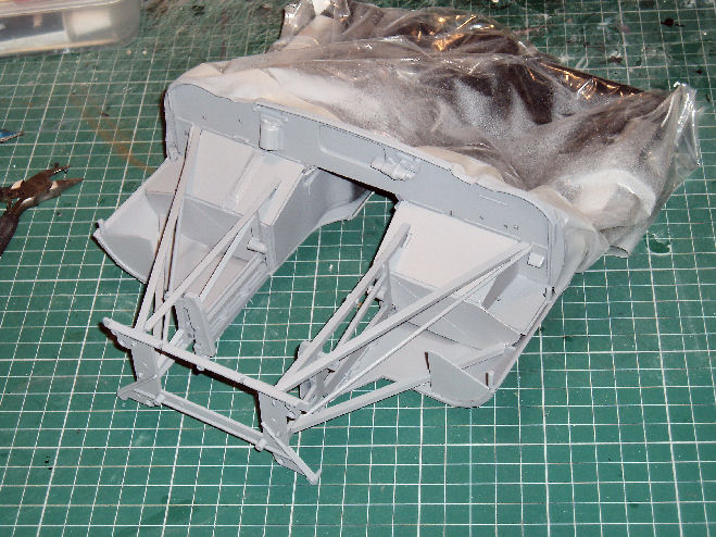

Another update on this one.
The front end was masked using an old poly bag and tape.
After a coat of grey primer I added some green, only to discover I'd used the wrong colour - DOH!
24 hours later, the correct green was put on and the masking was removed when it was dry...

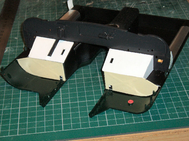

#8 Posted : 01 March 2023 15:21:20
Posts: 5,188
Points: 15,713

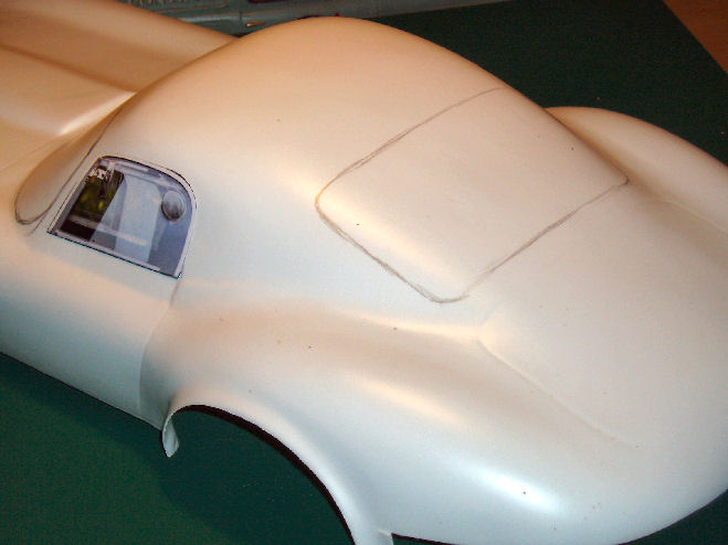

Some more done on this one.
The fire system has been scratch made and installed but decals are still needed.
The door bottoms have been lengthened to fit better on the floor pan, and the rear under body has now been attached.
It's glued and held together with clamps and tape.
Next it will get a good bit of filler and sanding.
Another task soon will be to cut out the doors.
That might be a bit of a mission...

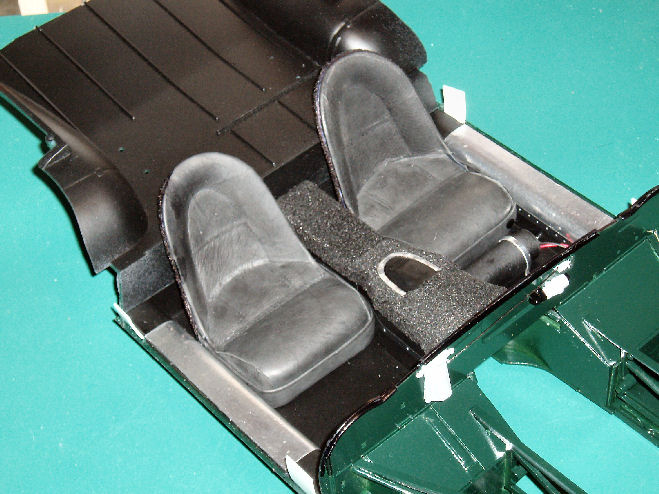

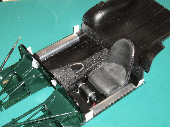

I've now added the seats - covered in very dark grey leather.

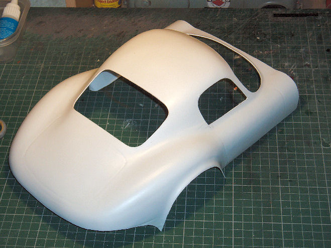

Also, the rear body is nearing paint and then fitting.
Lots of filler, sanding and high-build primer around the join at the tail.
I'm quite happy with it so far.

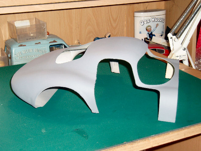

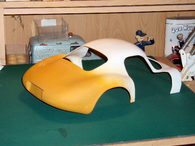

More sanding, filling, primer, sanding...
Now a base primer for a final fine sand, then some green...

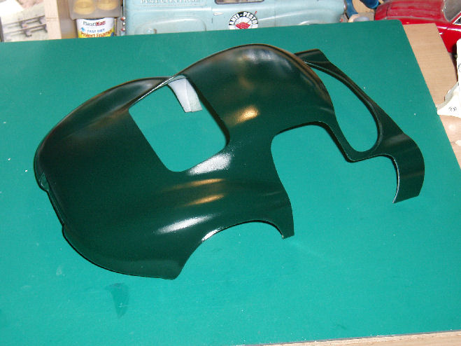

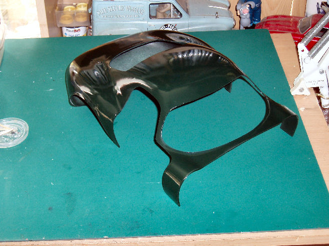

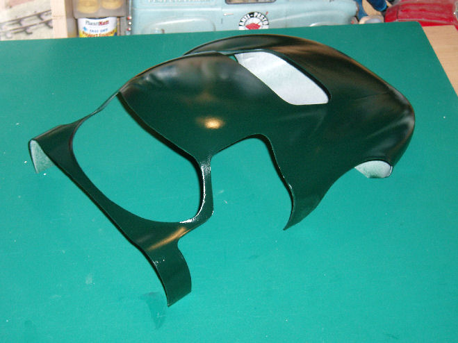

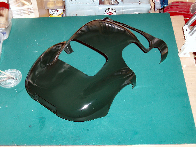

Final sanding of the grey primer and a first coat of green.
More sanding tomorrow and then more green.
The body is only placed on the tub to see how it looks.

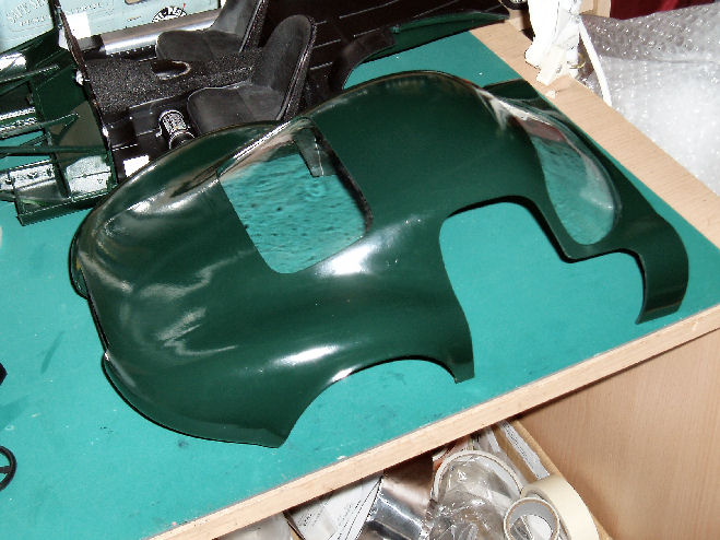

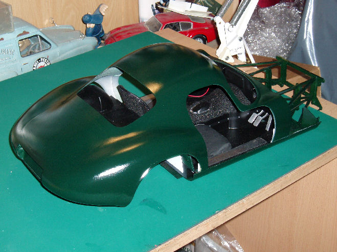

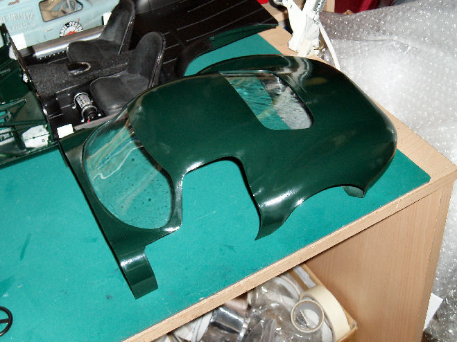

A fine wet sanding and a final coat of Jaguar racing green.

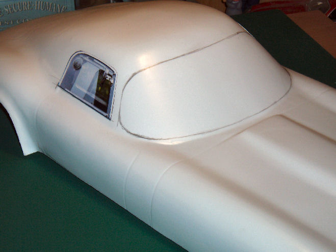

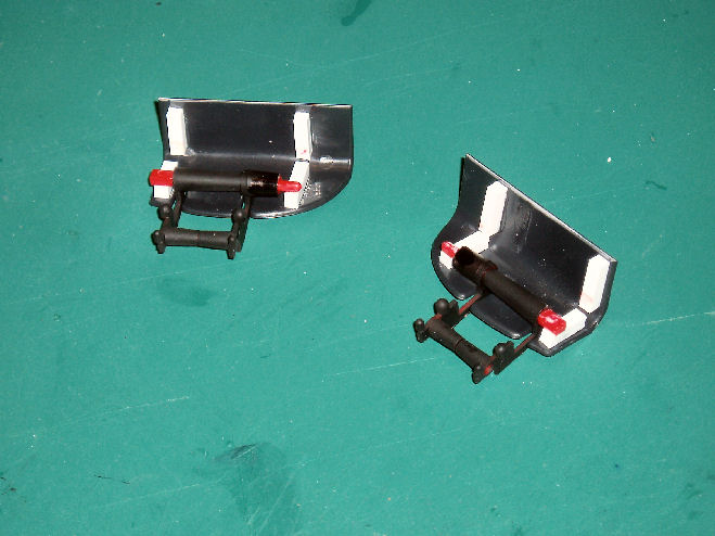

It will get a good polishing eventually but next will be to create hinges for the door skins and then get them fitted.
After that, screens in and body fixed to the main tub.

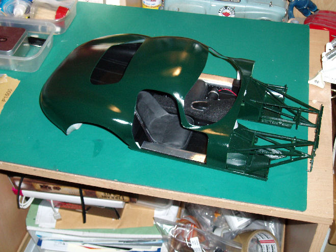

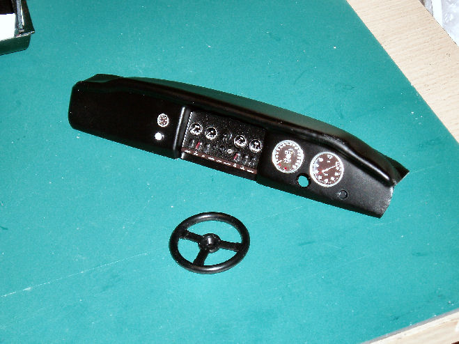

Dashboard underway - still some details to add as per my reference pictures.
I'm going to take a rubber mould from a 1/8 Lotus 72 kit steering wheel to make a resin copy as it's much more like the wheel in the real Jag.
Revell kit door hinges being modded to (hopefully) work with my body shell and doors.
Front and rear screens now in the body. Rubber screen surrounds still to make and add.
