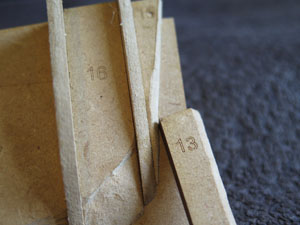

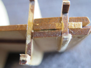

Essentially, how to unstick two pieces of face stuck thin mdf.
So given up hope for getting any parts any time soon for my De Agostini builds. Inspired by CaptainBirdseye’s build diary of Vanguard Models ‘Lady Eleanor’ – I decided to order it. It arrived in 2-3 days, all present & correct. As comparison, I find that nicely impressive. I will be creating my own diary when I have a few photo’s under my belt…
(Note: all below wood is 3mm MDF). Now the reason I’m a twit. Got the bulwarks placed on the false keel and the lower deck which serves to lock the bulkheads in place. Then it is pre-bevel the ‘Planking filling Pattern’ which fit between the foremost and stern-most bulkheads. Then place them on the false keel. There are 5 pairs 3 destined for the stern & 2 for the bow. Now comes the twit part. I successfully glued (titebond) 3 pairs at the bow & 1 at the stern (which is when I realised what I had done). Unfortunately, the 3 had been left overnight to dry. Now I’m left with the dilemma of how to remove & place correctly. Crying
Tried so far; One side of widest piece. Managed to insert scalpel blade down over near full width but not long enough for full length. So far managed to stop it re-sticking. Tried cold water but not progressed. Read suggestion regarding the Victory wonky top mast and use of hot water. Might try that but nervous of effect on 3mm MDF …
My other thought, not yet tried, is to sand, drill, burr tool, whatever, to forcefully remove all mdf and then cut new mdf to fit.
What I’m asking, is, any more alternate ideas that I haven’t yet thought of please? - Very afraid of breaking something I don't want to.

I'm guessing my original explanation was as clear as mud. So now pictures to try and clarify my problem.
Definitely no 'heat gun', just an old hair dryer (and I'm not in the habit of trying to burn off my hair). If you have any ideas how I can get a saw into the available space ... why I have been using a scalpel blade as chisel but the blade is not long enough. The waste mdf from the kit is insufficient area to really test, so I've sent for a sheet from CMB. So when that arrives, I can try a bit of fun. Have thought of heat from an electric plank bender (if I can find the safe place it is stored in ...)
Sue

I meant to say that part 13 is the piece that is meant to be there instead of part 15 - difference in width - which is what woke me up to my 'mistake'.

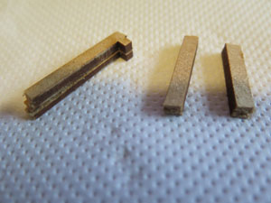

Well turns out IPA does not touch Titebond white glue. As in picture below
I created two test pieces, think of fat matchstick size. Two glass vials, one with water, the other with IPA. Gave them 10-15 minutes. Frankly I was expecting them (water one anyway) to disintegrate into the constituent sawdust ... Well stayed in one piece and the glued halves wouldn't pull apart either.
So left overnight. IPA version still solid against being pulled apart. Water version amazingly enough had fallen apart and not disintegrated into sawdust The two parts still felt firm to the touch so I will let them dry slowly and check no distortion and then may try suspending bow/stern in water for as little time as needed to get the 'Planking filling Pattern' (weird name!)to come lose via scalpel blade chisel rather than saw!!
Derek, 'varnish remover' is normally acetone. I know I used to have some, whether still around I'll have to find out. Be interesting to find out if that works.

Yeah, its the rd label 'Original'. Maybe direct application would work but seems getting it to seep into the very narrow plane doesn't. My 'matchstick' test set are clamped together whilst curing the glue layer thickness must be very thin.
I found a very small quantity of acetone (smell is right but rather faint so not sure of pureness. Enough to submerse matchstick for a few hours now. Also fails to separate. This is just trying to twist on stick off the other - not trying to scalpel chisel apart.
I've ordered some acetone from Amazon, so shall play again. I'll have my new mdf sheet by then.

Experiment-wise. First I realised the mdf sheet from Cornwall Boats was a slightly lesser quality - it felt a little less dense. So ability to separate 2 pieces stuck with Titebond Wood Glue; acetone, no effect on glue nor mdf, yes it wets the mdf but promptly evaporates with no deleterious effect. Ditto IPA. Water, soaks in over time and starts to delaminate the mdf before it really breaks up the glue.
I finally removed the 6 pieces at one end - but unfortunately did a lovely job of screwing up the false keel -as in twisting it.
So gathered my pride and rang VM at about 10:15 on Tuesday. Described my dilemma, got a lot of sympathetic understanding and then 'so which bits do you want ...'. By 10:25, I had an email from UPS, indicating a delivery had been booked. It was scheduled for a morning slot but on Wednesday morning, UPS updated that to arrive Wednesday and it arrived 14:00. I call that well above and beyond the call of duty. I have no idea who I spoke to but I am assuming it was Chris himself.
So an enormous thanks to Chris(?) and now I can start again, try not to make the same silly mistake ... etc! But first one of my cats wants to turn my arm into her pillow for a time. She who must be obeyed.
So I'll end this thread and start a build diary this time. Thanks everyone who put in suggestions but as it turns out Titebond is a little too good. If using, be sure you want it to be stuck!!
