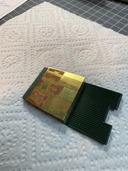

I bought some aftermarket product including a PE-Overkill from Eduard.

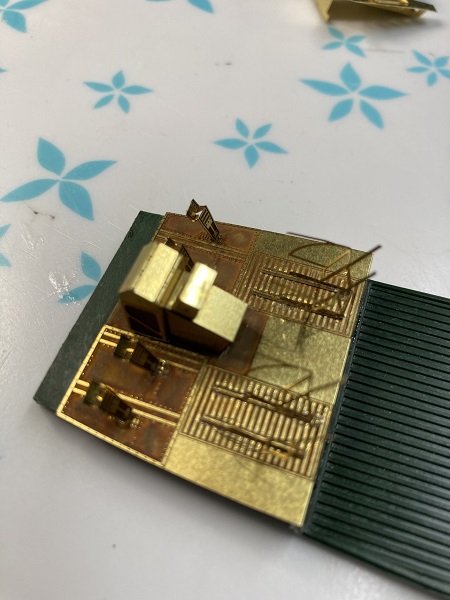

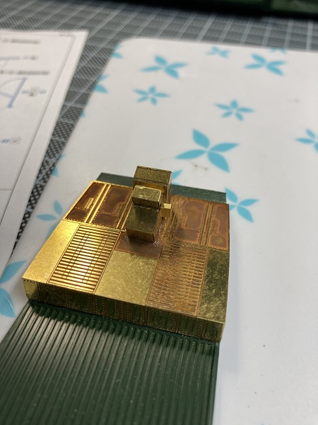

#3 Posted : 26 July 2022 11:13:52
As some of you know, i have very little experience with the airbrush and next to no experience with PE - so this will be a challenge, also regarding the old mouldings with raised details!!
So please don`t be too harsh with your comments :)

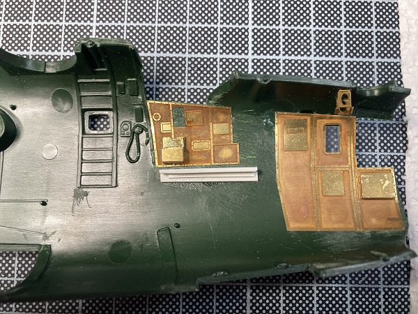

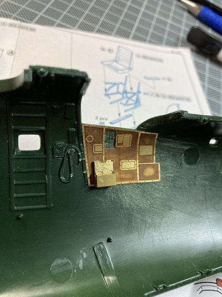

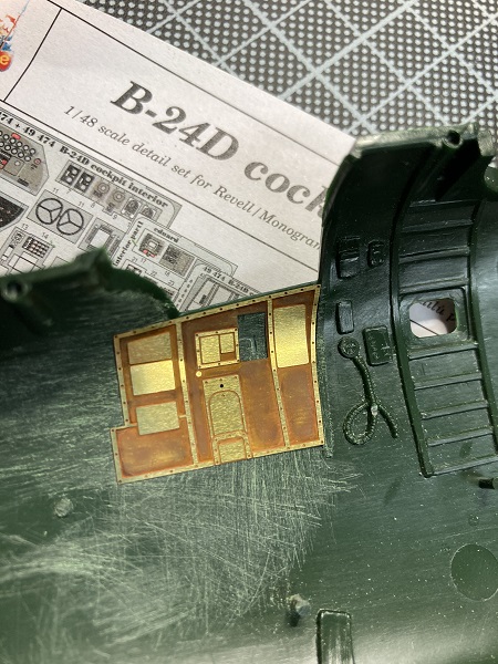

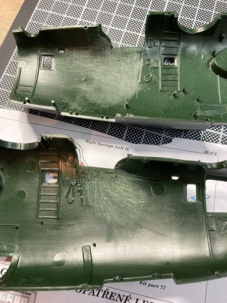

So i gave it a go yesterday.
Scratched away all the original detail of the cockpit and replaced it with PE.
In the Eduard set, there are a lot of prepainted and self-adhesive PE-parts which makes me unsure of when to attach which part regarding the painting.
I only can hope i get everything right.

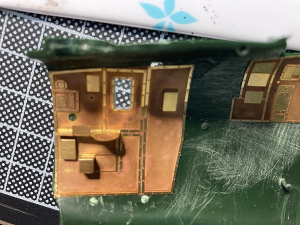

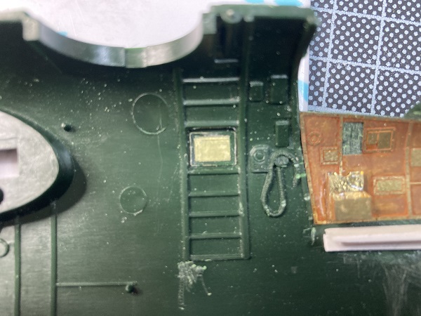

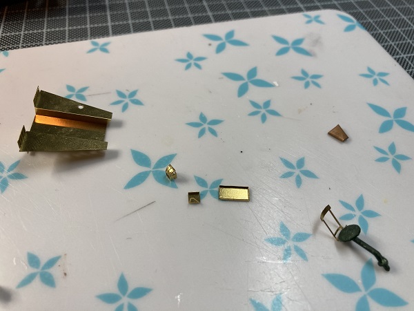

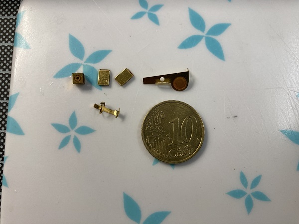

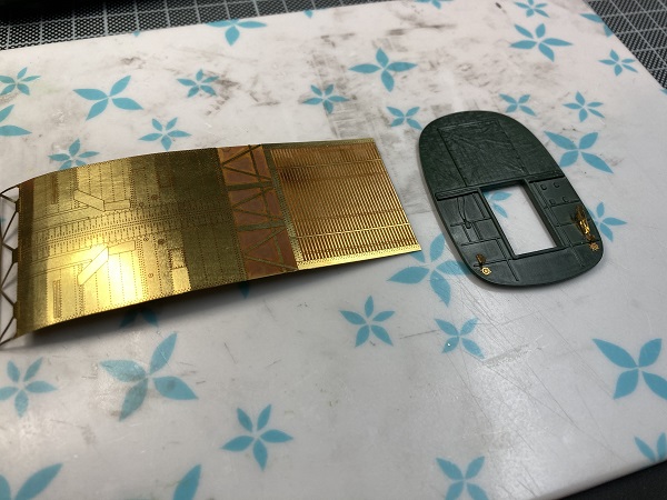

More removal of original details and replacement with PE.
Almost forgot to fit the little window before attaching the PE!!

Nice work so far Walter, looking very good. I note from your photos that you are bending those PE parts in their raw state, i.e. straight from the brass fret, hence their nice shiny brass colouration and it is probably why they are breaking so easily when you try to bend them? The metal is hard and brittle in its' raw state? You will find PE much easier to work with and bend, if you anneal the whole PE sheet before you start cutting the parts out. This can be done by holding the PE sheet in some pliers or tweezers and then holding it above a cigarette lighter flame until the brass glows red hot and discolours as it cools down? This will anneal the metal and make it much softer, removing the tendency for it to snap when you try to bend it! You will be painting over the parts when they've been added to your model, so the discolouration won't matter?
Hope that helps you Walter and keep those updates coming, I will be watching. Cool ThumpUp

Thanks for that tip, Kev - i will try that at the next occation.

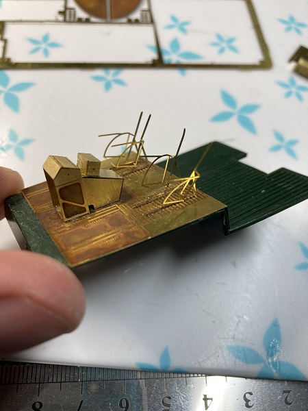

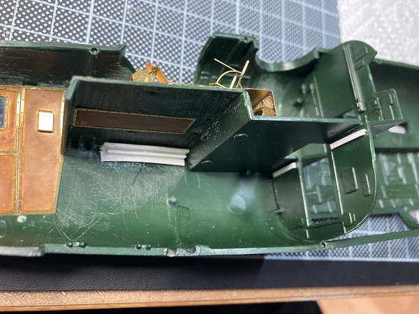

I´ve been at home forr a few hours between two holiday trips - and after thinking a lot about how all that PE-interior should stay at its place - i came up with the solution of scratch-building some supports.
Also some parts for the waist interior were prepared.

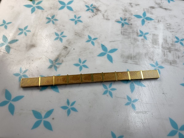

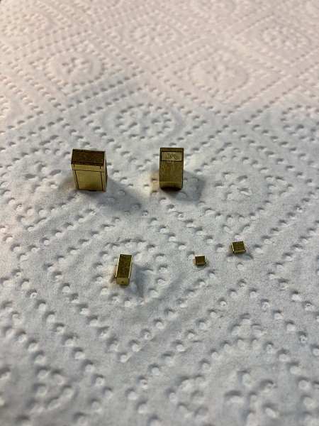

Little progress - started with preparation of parts for the bomb bay.
No idea how this should all come together in the end - especially with the the two halves of the hull having to still fit with all the interior stuff.

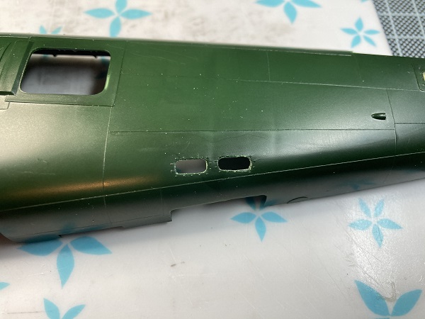

I covered up the windows from the inside to prepare for the first spraying action.
Also i openend up some additional windows at the waist.

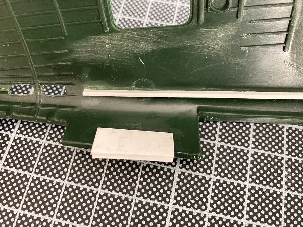

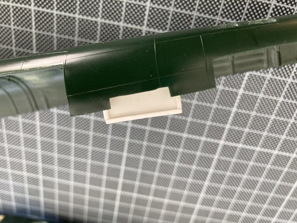

As i won`t use the kit part for the waist gunposition i had to build a small box for the "bumper" at the lower waist.
