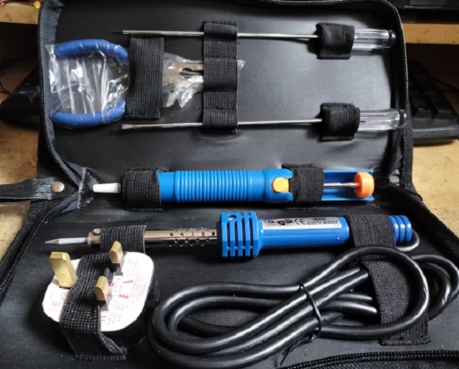

Well I`ve done a run through of what was in the two boxes and everything seems to be in order.ThumpUp
All mags and parts appear to be there, plus untouched tool kit and sundry items.
Having looked through the first ten instruction mags, you have a robot that actually does something (all be it very basic) from issue four. It then develops into a robot that can detect and follow light, recognise anything in its way and avoid it, to following a black line on a large piece of paper.

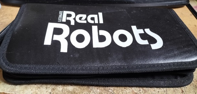

Have attached a few pics of some of the kit contents. More to follow soon.

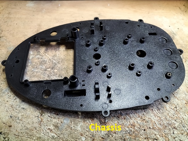

Well here we go: BigGrin
I`ve opened up the three layered pack of parts that are issue 1.
The main part is the "Cybot" chassis.
Then three parts for each gearbox casing.

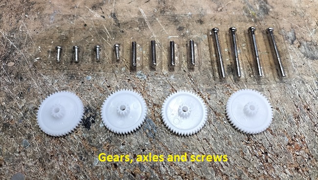

Gears, axles and screws and

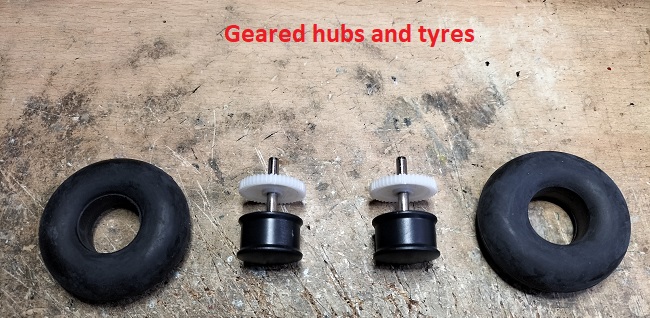

Finally, geared hubs on axles and tyres.
More soon:

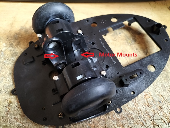

1: One gear box base in place and the other built up to the mid level.
2: One gear box up to mid level (without the wheel and hub)
3: Both gear boxes complete. (Red arrows show where the electric motors are mounted)
In the next stage the motors are fitted, so the top caps of the gearbox have to come off for this to happen and the gears get greased up.

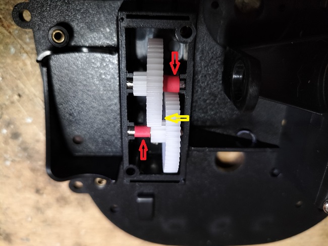

Ok, I`m back and for I think what is a first, I`ve come up with a mod.
Blink Confused Crying Flapper BigGrin

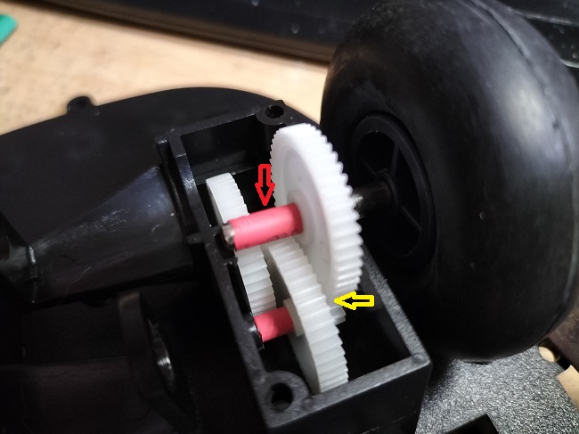

Thanks to Skyfire, who mentioned that the wheel gears made a lot of noise and could/does affect the ultra sonics that are fitted later, I`ve come up with a possible solution.
Albeit that I have not put grease in the gearboxes yet, the noise made by the gears was mad. There was sufficient movement of the gears on their shafts that they rubbed together.
So, the gears needed spacing.
My solution so far is to use some heat shrink (not shrunk) to hold the gears in a fixed position.
In the attached pics, red arrows highlight the heat shrink added and the yellow arrows show where the gear spacing has been achieved. I guesstimate that the noise has been reduced by 50% pre-greasing. It may be that I will need to use a more substantial tubing (Like wire insulation) to make a longer lasting effect, but we`ll see.
So, pic 1 shows the lower gears spaced apart and pic 2 shows the hub gear spaced.
Will have to do the same on the other side if it works properly, but an easy low cost fix if it works.

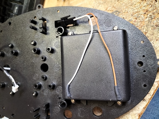

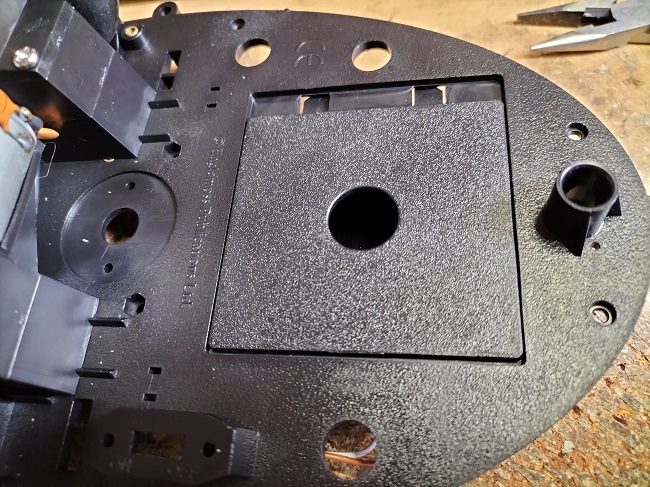

#16 Posted : 03 May 2022 17:50:58
Hi All, BigGrin
The previously mentioned mod to the gearbox has now been done on both sides and the gears are all well greased up.

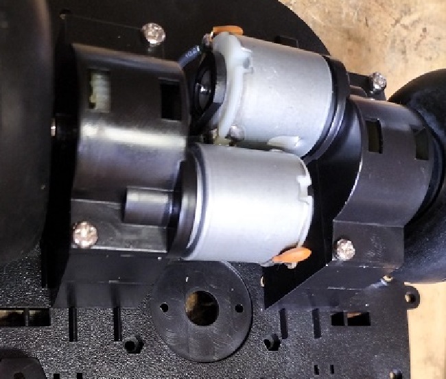

So, stage 2 is where the two electric motors are fitted (see pic 1). Until I get to issue 4 and power up the motors I won`t be sure if the gearbox Mod has worked. Blink Blink
Next job was to fit the 6v battery box with four screws (see pic 2) and place the battery cover (see pic 3).
Coming in issue 3:
Build and fit front castor wheel.
Fit front and rear bumpers.
Fit Power switch.
Thanks for now and stay safe.

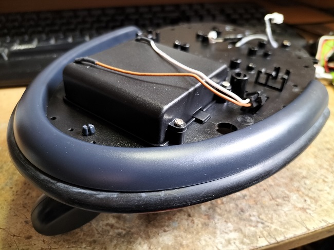

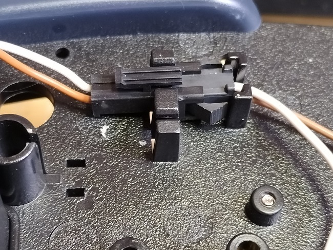

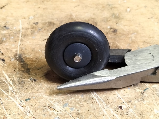

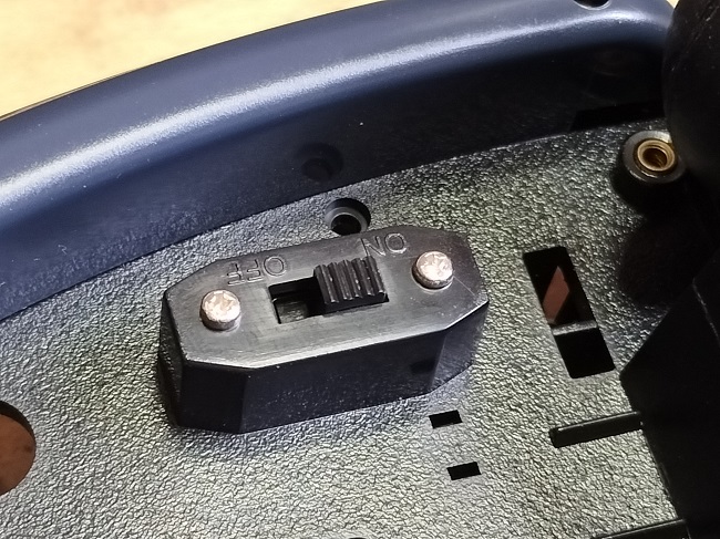

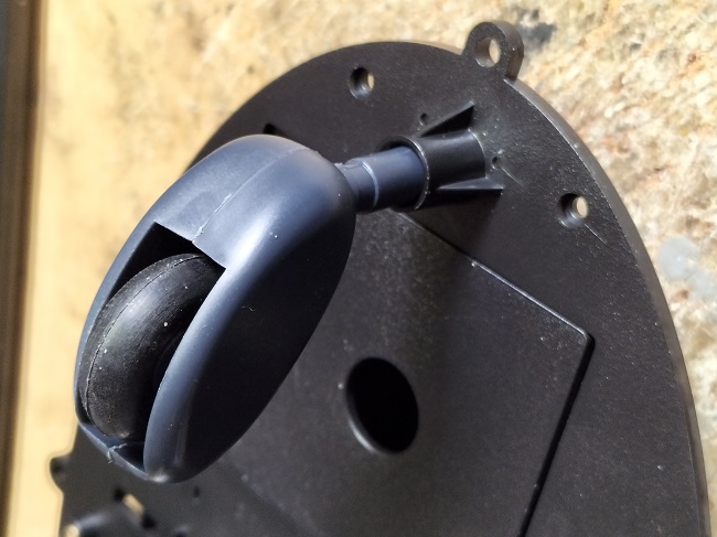

Ok, onto issue 3: This is fun.BigGrin
Cybot has three wheels for a reason. If a vehicle has four wheels on rough ground, then two wheels can lose contact at the same time causing drive issues. With three wheels the chance of losing contact with the drive surface is eliminated/reduced.
Cybot has two rear wheels (driveable from the motors) and a castor front wheel to maintain steering.
In this issue Cybot gets his castor front wheel.
Pic 1: Hub inserted into the wheel and the axle put in place.
Pic 2: The axle snaps into the castor housing and is held fast.
Pic 3: The castor leg fits into the base plate by clicking into place.

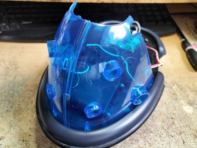

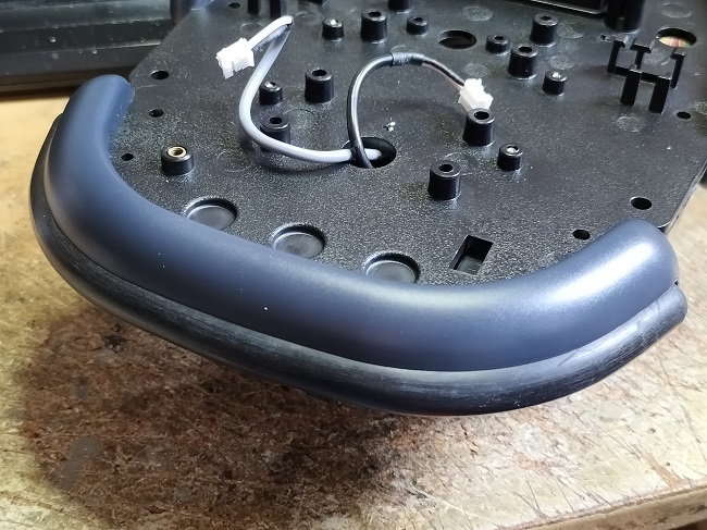

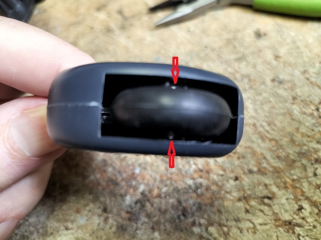

Pic 4 and 5: Cybot gets some bumper protection. An upper and lower plastic frame holds a rubber bump strip in place that is secured to the base frame by three screws front and back.
Pic 6, 7 and 8: Time to start getting Cybot ready for some power.
The power switch is put in place, secured by two screws and then the 6v power base is connected to the switch.
In the next stage (issue 4) Cybot gets to move under his own power, but lacks any control. More to come.

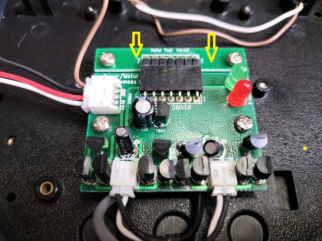

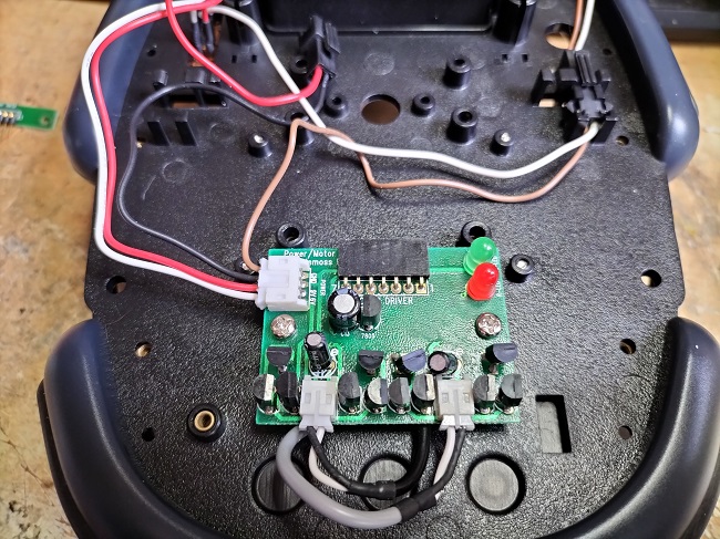

Now in issue 4, Cybot gets some power to his/her motors. (What do you call a robot ?). The motor board is connected up with three cables and then mounted to the rear with a couple of bolts and captive nuts. (Pic 1)
Then, a test board is connected into the motor board (Pic 2)
Add some decent AA batteries, switch on and off he or she goes, all be it uncontrollably as there are no censors fixed at this point, but it does go in a forward straight line. I should have built this in 2001 I could have kept up with it in them days. LOL Blink
That`s it for issue four.
