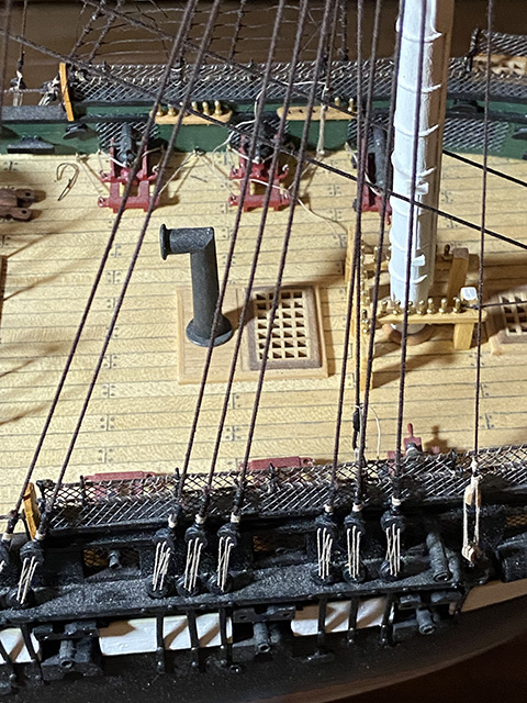

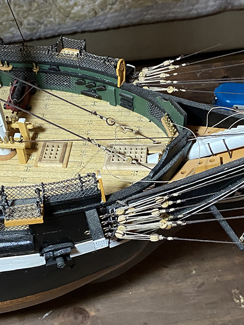

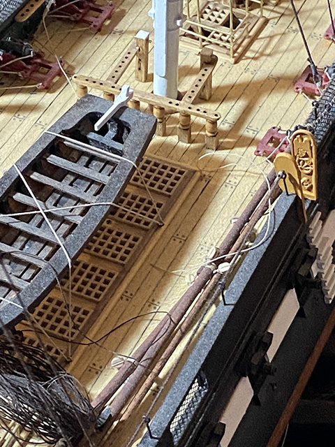

The logistics issues plaguing our world appear to be persistent for at least the next several months. Sadly, this has greatly reduced, and in some instances completely stopped the ability to buy model subscriptions and in some cases full kits. This will not last forever, but in the meantime it is important that we model with what we can get our hands on or, in this case, what we already have.
I started this build back in October, 2018 and made some good and steady progress for the first year or so. Within that time I got to where I was finishing up the standing rigging and pretty much only had the ratlines left before I moved onto the running rigging and sails. Unfortunately, life got in the way as it often does and this ship sat in its current state since pretty much the beginning of these Covid years. Or, from an optimists perspective, fortunately this ship has sat since then and it now gives me the opportunity to finish it up and share the remaining work online.
tenderfoot attached the following image(s):
COMPLETED:
IN PROGRESS:

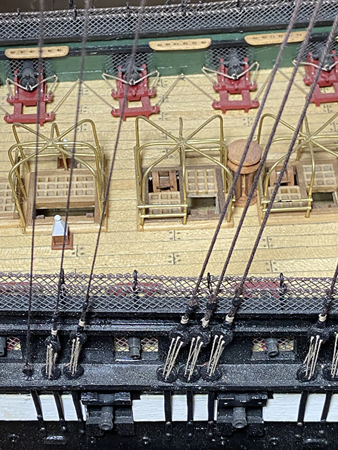

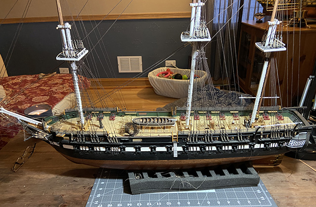

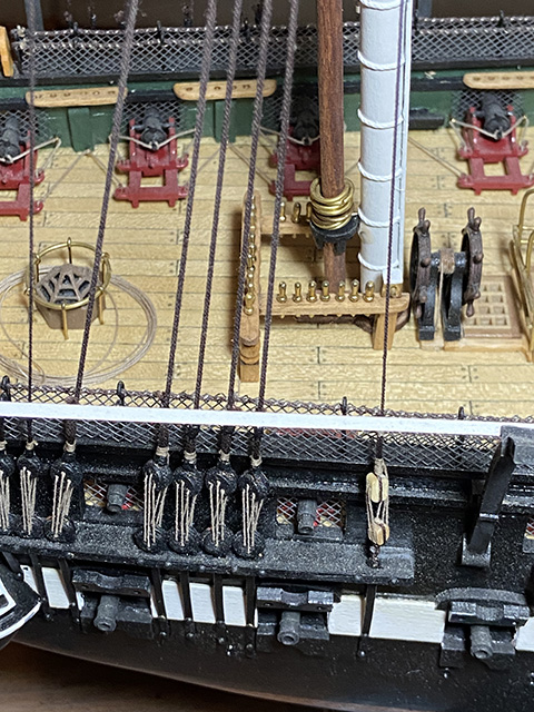

Before I can go anywhere on this thing it needs a serious cleaning. Over a year of dust is pretty impressive, but not desirable. So for the next couple days my modeling adventures will be with a soft brush, canned air, toothpicks, q-tips, and a small bit of water. This is, by far, my least favorite thing to do. But my oh my, when you see the state of things as they currently stand with this build there is no way around it...a good cleaning is the first order of business.
And since I haven't started this build until now, it is a good time to share some photos from various angles to give you an idea of what has been done...and how much dust collected on this poor thing.
COMPLETED:
IN PROGRESS:

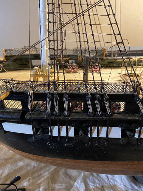

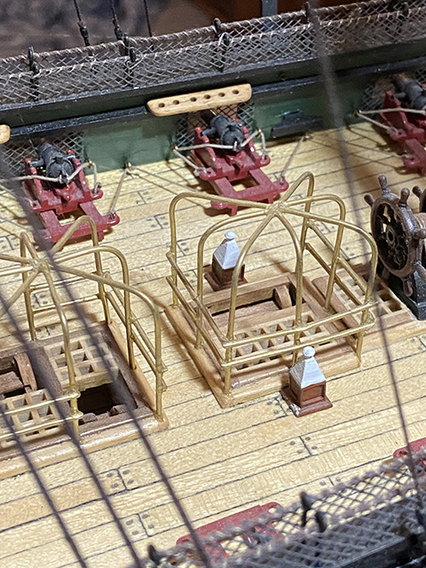

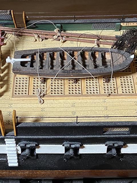

And here are some additional shots. Again...LOTS OF DUST
COMPLETED:
IN PROGRESS:

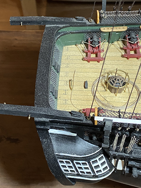

As you can see from the previous photos, there is a lot of cleaning to do before I do anything else. To give you an idea, here is a before and after shot of some of the shrouds on the mainmast. The after photo was after about 10 minutes of work in that particular area and there is still a bit more cleaning to do. This is going to take some time.
I am thinking about doing a tutorial on model ship cleaning since it is necessary every so often. And this would have been a good use case. However, I also have my completed Victory build that I never encased and it hasn't been cleaned in two years so I will instead use the Victory for a cleaning tutorial. So now it is time to get into this thing and de-dust it as best I can.
COMPLETED:
IN PROGRESS:

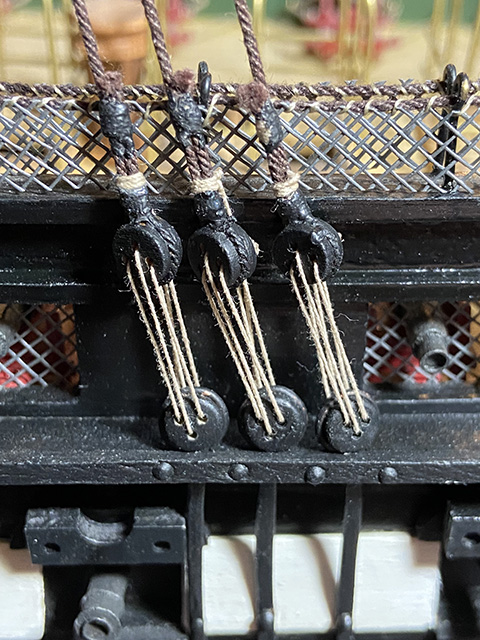

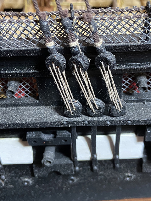

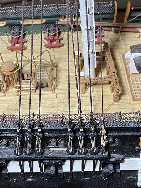

I am still plugging away at cleaning the Connie and getting a good look at what I did. As I was cleaning the chainplates one thing kept bothering me - the way I installed them. I have them all perpendicular where they should be at the same angle as the shroud line.
This is my second build of a large sailing ship so I have a lot to learn and at the time I did not know better. I just went with what I thought looked good to me. Now that I am seeing it again after two years, and with the knowledge I now have, it doesn't look right at all. So I have decided to correct them.
I will post the results as I go along. Also, the kit called for a simple wire wrapped around a nail to mimic the chains. I did not like the look of that at all and I still don't. So I made my own chain plates. I will also include a post or two soon that shows how I made those.

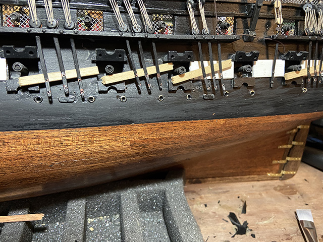

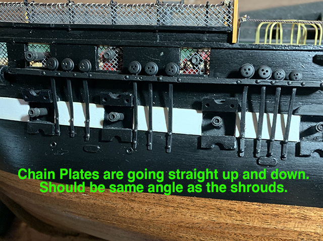

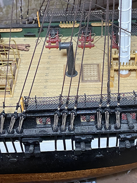

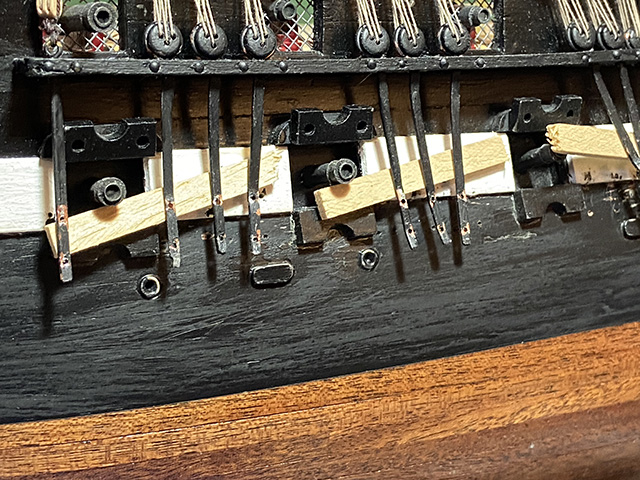

It took me about a week of cleaning - an hour here and there every day or so - and the Connie was clean. On the plus side, I also cleaned some other models I have that have been collecting dust as well.

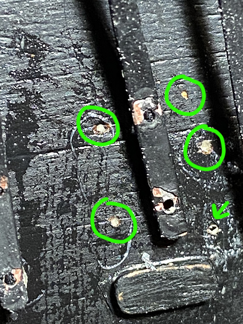

Once clean, and as I mentioned in an earlier post, I started working on adjusting the chain plates so they align properly with the shrouds. I started by pulling the nails from each chain plate carefully. I used a sprue cutter and carefully worked it under the head of the nail and then pulled directly away from the hull. I made sure not to try to lever the nail out of place as that would definitely put a dink in the wood of the hull. It only took a few minutes to do this to one side of the ship.
I then took some scrap pieces of wood and put them in place so as to hold the chain plates away from the hull. I was initially going to try to slide the chainplates back up through the plank, but they were in there just a bit too tight in most cases. After I had the plates lifted I could then asses the situation, and it wasn't good.
First off, I noticed that the poly had started peeling away in the areas where the chain plates had been attached to the hull. You can see this in the image below circled in green. This was not a good sign. I took a soft brush and tried to carefully work away the raised poly only to find that it just kept peeling further and further and worst of all...it was doing so way to easily. This could only mean that I had mistakingly applied a coat of poly over a previous one without any sanding. Not sure how I managed that, but I did. I will chock it up to a novice mistake as this was only my second build - gotta go easy on myself.
COMPLETED:
IN PROGRESS:

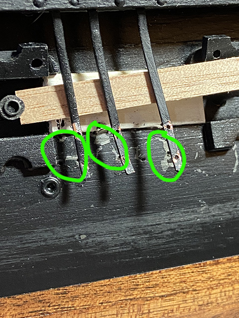

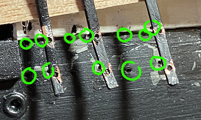

Second thing I noticed was that I had a lot of nail holes I would need to fill in. In most cases the chain plates would not rest in the same spot and those old nail holes would then be visible. I also felt they were a bit to large to simply cover with some paint. Additionally, I found some extra holes where, I imagine, I had tried and failed to attach the plates in the past...or...I put a few in place and tweaked them later. Regardless, there are extra holes and since I am the only in this house that has worked on this thing it is only I who can be blamed. You can see in the image below how there should only be 6 nail holes but there are obviously many more. Either way, need to fill them in before I go further.
COMPLETED:
IN PROGRESS:

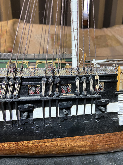

Now that I had an idea of what kind of repair work needed to be done I started to remove all that improperly applied poly. This was an awfully tedious process but thankfully it was removable with a small soft paint brush for the most part. In the nooks and crannies I did need to follow up with a sharp blade and scrape away. I took on the port side first and it took me the better part of four hours to get the poly removed. I then spent about an hour going back over the entire area with some 600 grit sandpaper. Of course, throughout the process I was constantly cleaning with a brush. That poly really picks up the static and sticks to everything and can be a real pain to wipe away.
You will also note that a couple sections of the white whales ( the white stripe) are missing. These popped away when removing the nails from the chain plates so they were not effectively installed to begin with. Again, my second build and a lesson learned. I simply marked these two pieces so I knew how they went back into place and will reattach them a bit later.
After about 5 hours of scraping, brushing, and cleaning the end result was pretty satisfactory. At first it hurt my should a bit to look at what had been done because it was all looking so good just a week ago. However, I do think it is worth the effort as the improperly installed chain plates would have bothered me endlessly.
COMPLETED:
IN PROGRESS:

Because I now have a better understanding of how the actual ships were built I am completely happy that I have undertaken the effort to rework the chainplates for the Connie. The next step was filling in the old nail holes. To do this I simply mixed a bit of saw dust I made from a piece of scrap wood rubbed vigorously over some mid-grain sandpaper with a small bit of watered down wood glue until I got the consistency I needed. It actually needed to be a bit runny to ensure it would work itself well into the little pin holes - using a standard wood filler would have been messy and difficult to work into those holes.
I applied the filler with an old paint brush. After waiting only a couple minutes I then went back with the same brush but this time with a bit of clean water and carefully worked away any extra wood filler. Was pretty happy with the results (shown in green circles below) but a bit disappointed that I completely missed a hole (shown by the green arrow below). But that was a quick fix as well.
Now on to taping and re-painting.
COMPLETED:

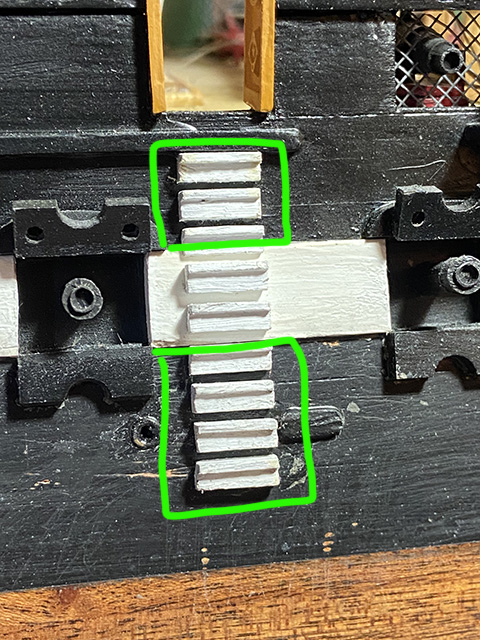

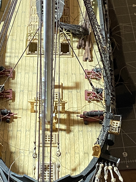

I also picked up a copy of The Anatomy of the Ship - The 44-Gun Frigate USS Constitution by Karl Heinz Marquardt. On a recent build I just completed (HMS Bounty by DeAgostini) I grabbed the related book for the Bounty and it was a fantastic find. It really helped me understand the history of the ship, the workings, rigging, decking, etc. These are marvelous books if you are truly interested in the details of the ship you are working on.
Having quickly flipped through the book one thing struck me immediately - the painting scheme for the hull steps. I had painted all of the steps white. In reality, they would have been black where the hull was black, and white where the hull was white. Now, the Constitution did change over time due to overhauls so this may not be the actual original scheme - I believe the original Constitution used the standard mustard yellow paint instead of white. But I really like the look of the white on black and it has become synonymous with the Constitution, so I am staying with it. And the cover of the book goes with the white and black - and I do like those books.
So I will also repaint the steps and add some black in the areas marked by green below.
COMPLETED:
IN PROGRESS:
