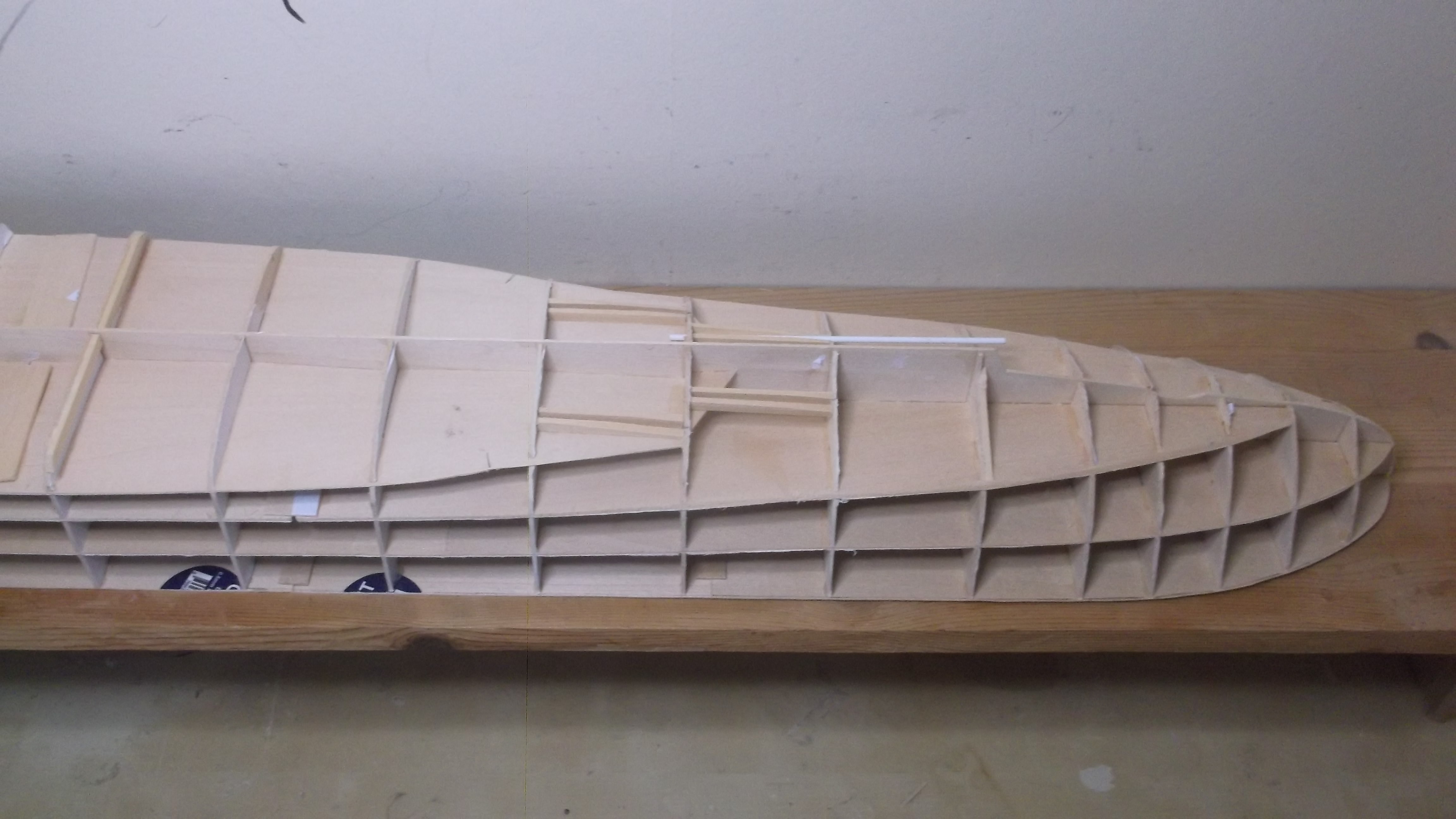

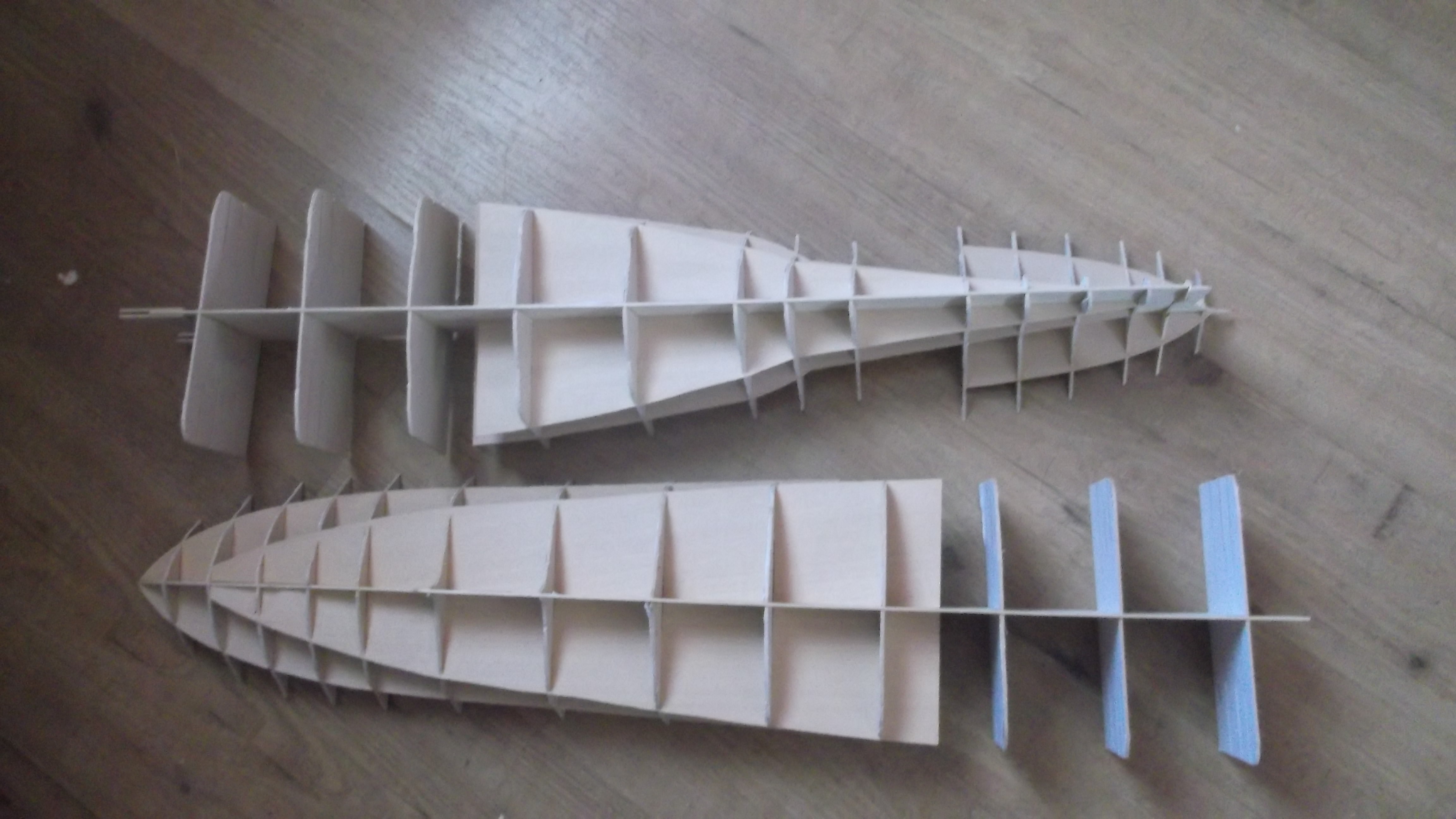

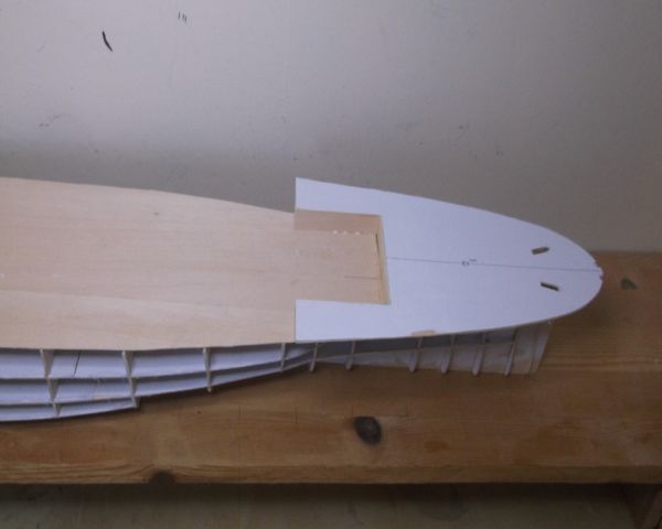

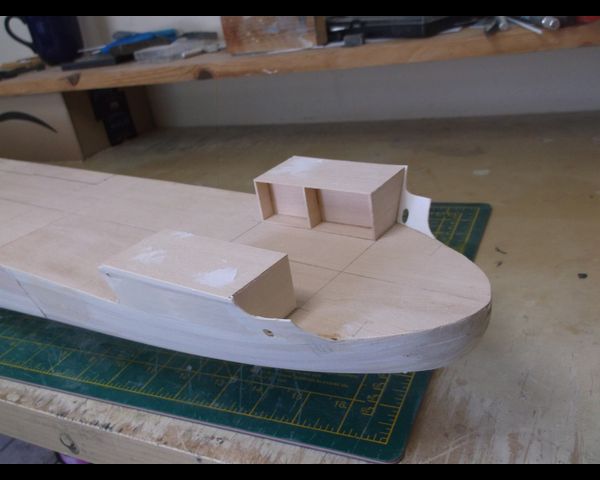

Hi Folks.
Photocopied all hull parts and transferred to timber. Cut out and glued together.
Following the same construction as for card, a strong and rigid hull is achieved.
Reduced outline of all frames by 1mm to allow for the first layer of planking
Ken

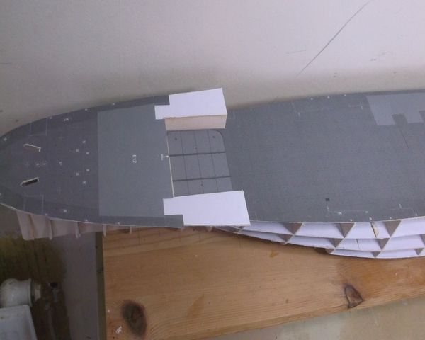

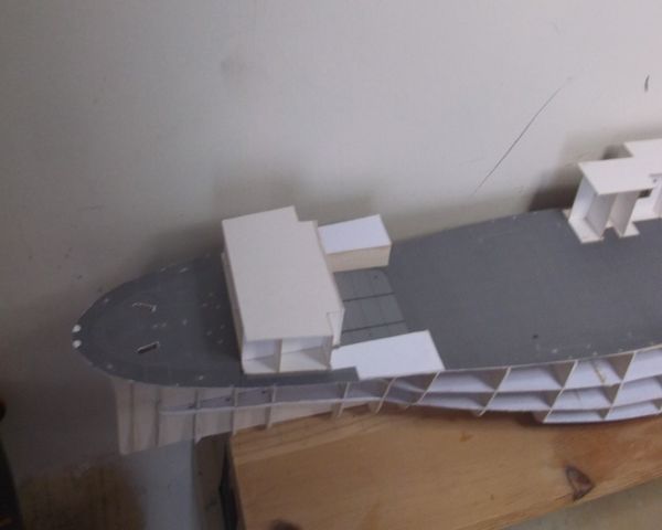

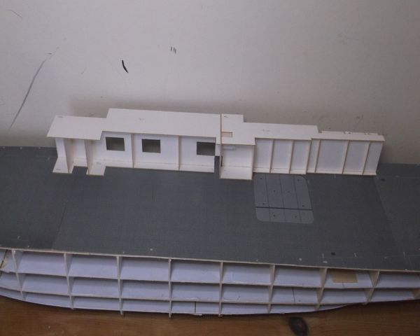

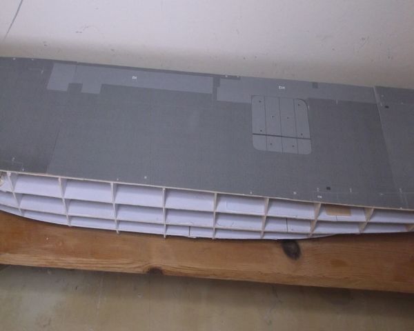

Hi All,
Timber decks fitted and card decks loose fitted to check for alignment and sizing.
Positioned some of the card structure which will be covered using plastic card and sections.
Ken

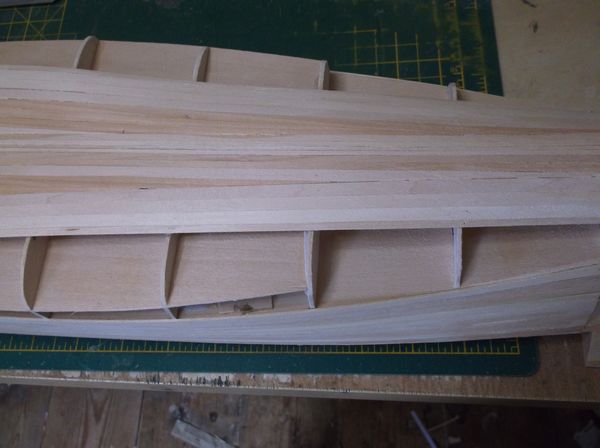

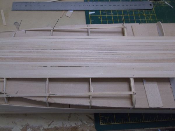

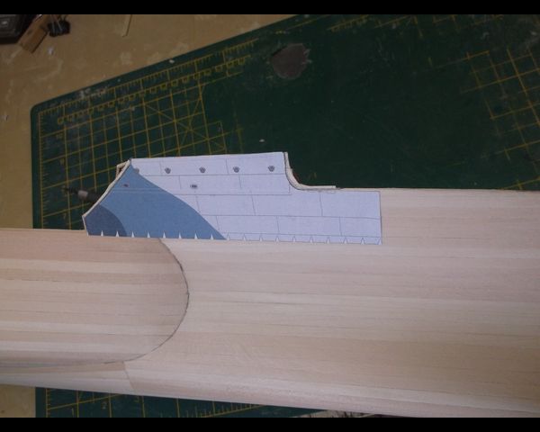

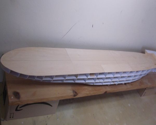

Hi All
Hopefully I`ve got the pictures right. Started the first layer of planking. The model of Enterprise (1944) I`m building had torpedo bulges added and this makes the first layer slightly more involved. Started planking where there are definite lines between bulge and hull as seen on the frames. I also used the card sections as a reference on the hull where solid timber will be shaped. the bow and stern sections will be filled with solid timber when the second layer is completed.

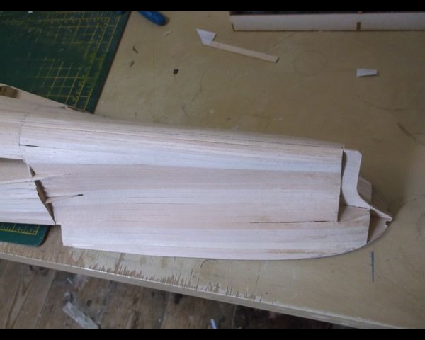

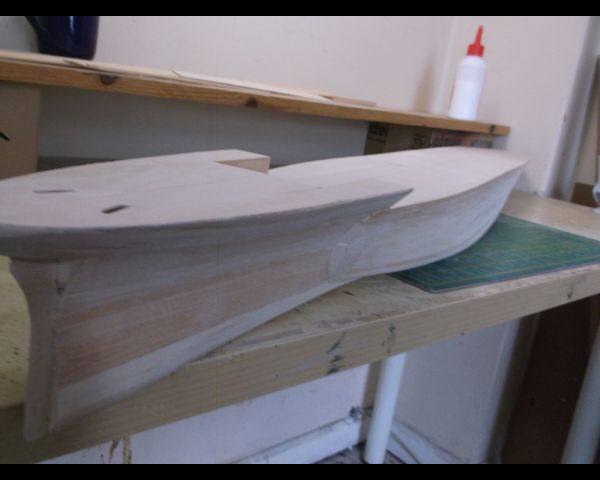

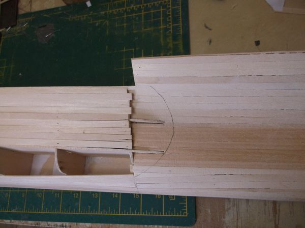

Hi All,
Thanks for the comments. First layer complete and sanded smooth ready for layer 2.

nice smooth hullDrool
Looks like the frames are quite thin for pinning the hull planks to but looks like this has not given you any issuesDrool
Ken
#19 Posted : 13 July 2021 12:10:57
Joined: 06/09/2011
Posts: 115
Points: 354
Location: Bristol
Hi Budgie,
The frames are 1.5mm lime and the 1st layer of planking is only 1mm thick and vary from 5mm to 2mm wide and using dressmaker pins and planks moistened for the ends and sharp bends they can be carefully pinned without too much splitting.
Ken

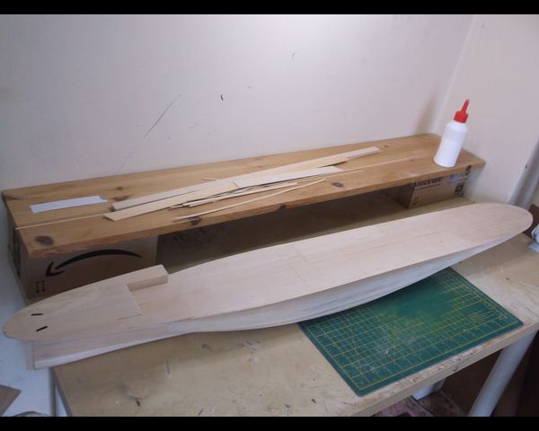

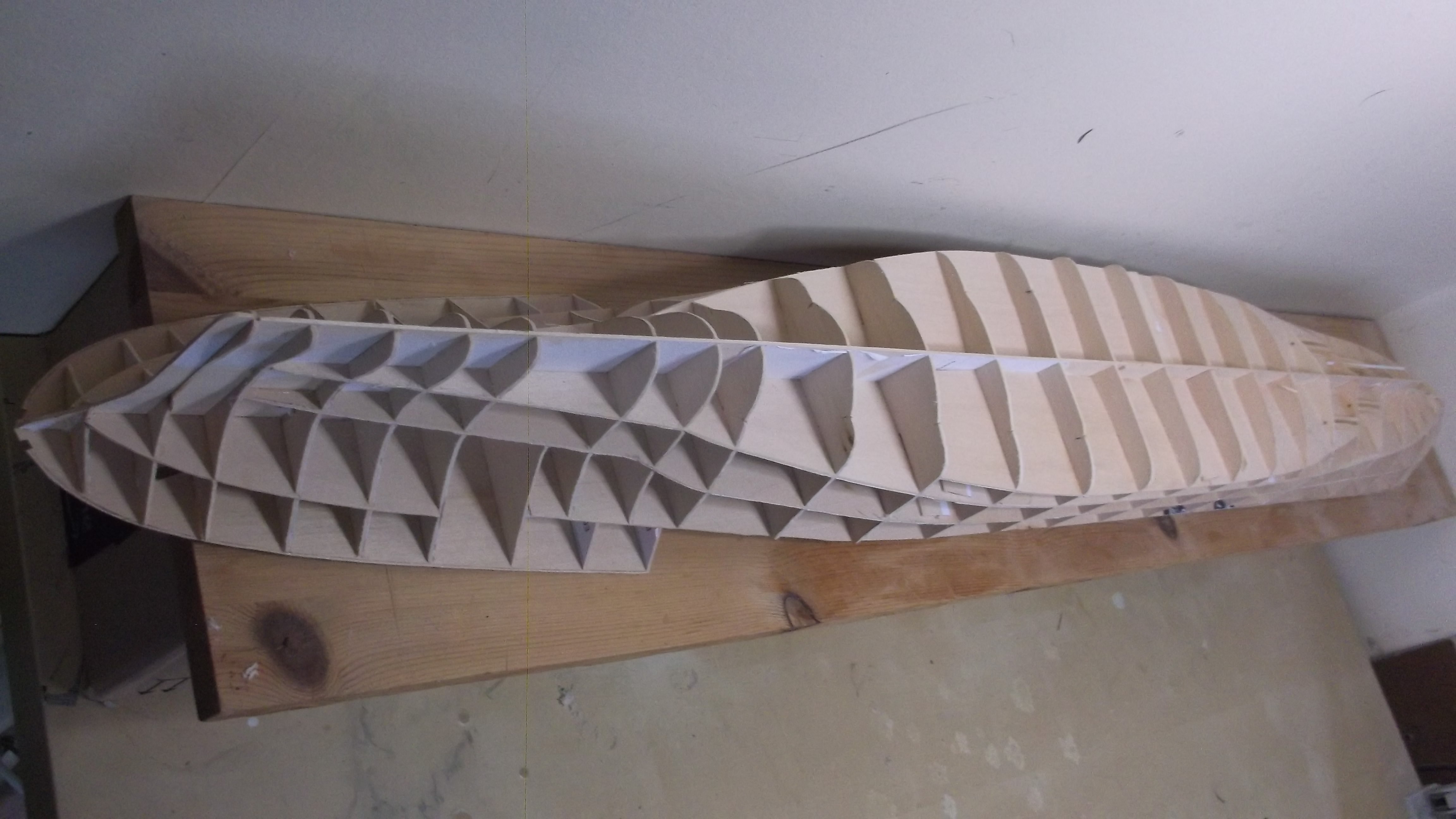

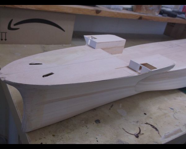

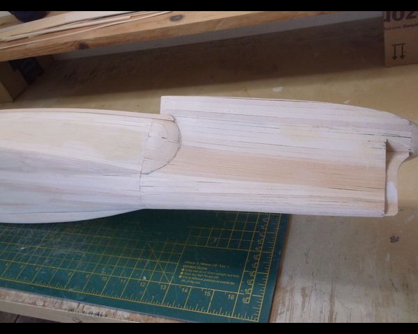

Hi All,
2nd layer of planking completed and sanded. Bow and stern also filled and sanded smooth ready for prepping for paint.
