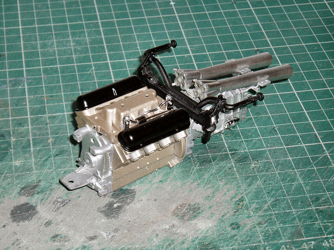

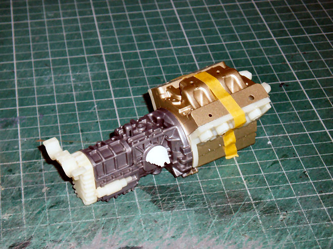

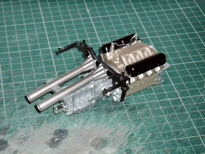

A start on the engine parts.
It's really crazy that two of the kit parts are pre-painted in steel and champagne gold, and the other parts are in a thick, horrible chrome.
Needless to say, the chrome was striped off using bleach.
With the main block etc assembled, it will all be painted.

Thanks for the comments chaps.
The main lump of the engine is assembled and it's all going ok so far - except for the ridiculous amount of chromed parts there are that have to be stripped and then repainted.
There are around 9 sprues of parts in the kit - 4 of them chromed!
Absolutely stupid.
I'm following the colours of my reference car so black cam covers it is - not polished metal.

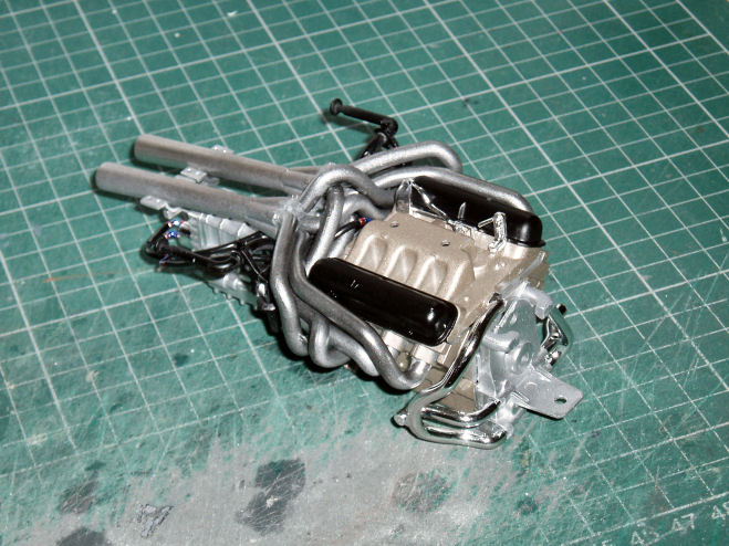

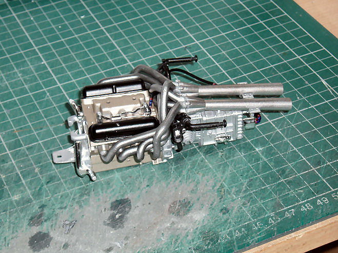

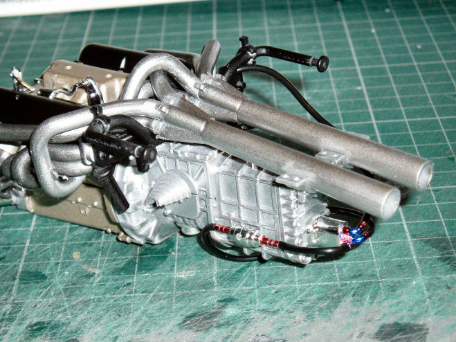

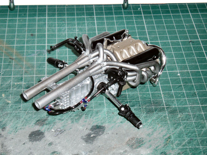

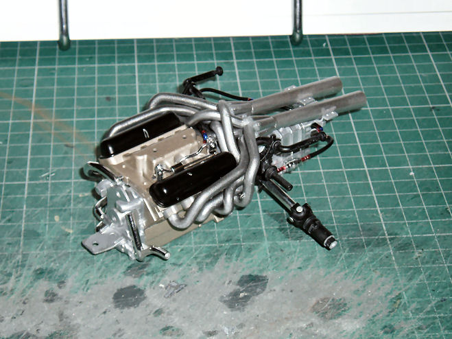

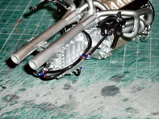

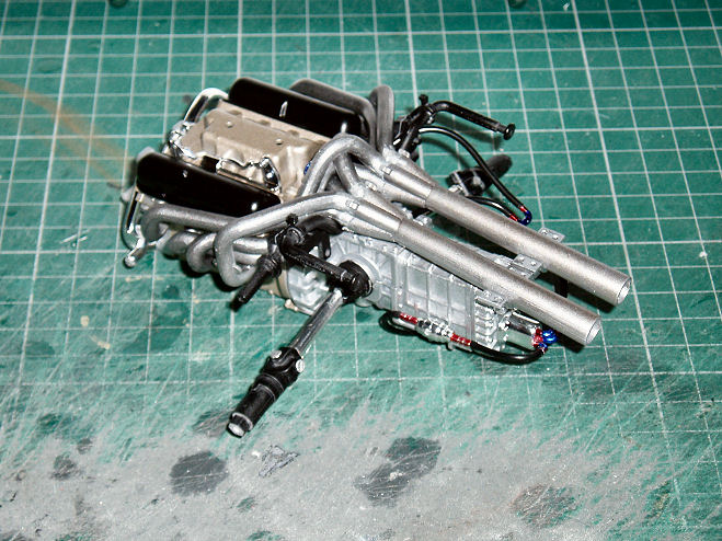

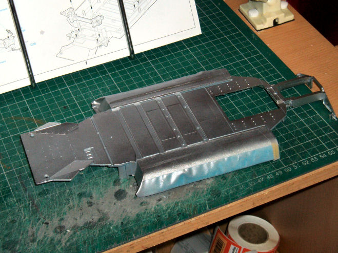

A bit more on this one today.
The exhaust parts are all in - little retaining springs still to add.
I have to say that the exhaust parts are without doubt the best I've ever come across in 1/12 scale for fitting.
WAY better than anything Tamiya have ever done.
The parts actually FIT without any headaches.
These kinds of complex exhausts are usually the part of a build of this kind that most modellers dread.
Not this time. A genuine doddle.
Some pipework added, and the drive shafts are in.
The lower floor has been masked and painted. The picture makes the silver area look a bit patchy but in reality it isn't at all. That's camera flash for you...

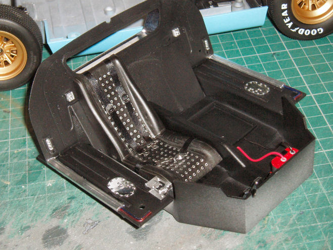

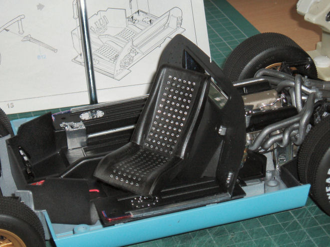

I've sorted one of the seats now.
I applied ally foil tape to the seat faces and burnished it down really firmly. Then, a coat of matt black went on and was allowed to dry.
After that, the rivet surfaces were very lightly sanded with 600 grit wet and dry.
I think it worked out ok.
Now the other seat...

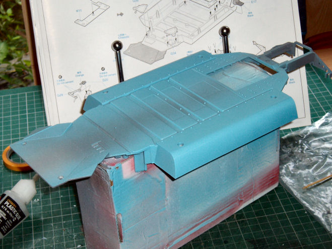

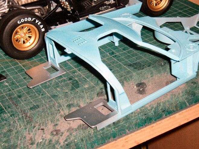

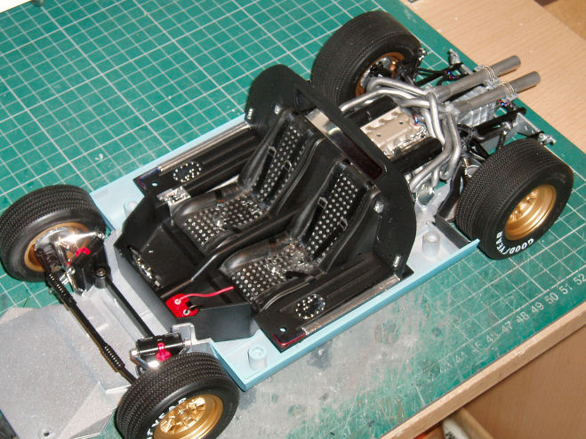

Points: 15,320
An update for those following...
The lower body/cockpit just about sorted.
Now getting on to the upper bits.
Fingers crossed it goes ok.
As it transpires, it's not a very detailed kit and many parts are a tad 'iffy' in terms of fit or even accurate placing.
However, this is one where I'm going to do my best with what's provided but fix stuff where I can.
I just want it to be a fairly good model of the real car.
