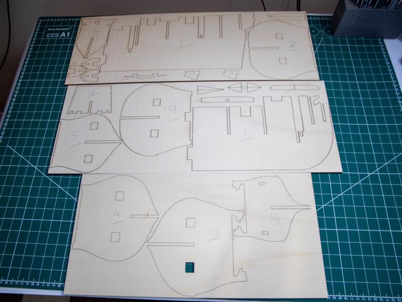

Stage 1 - The Skeleton

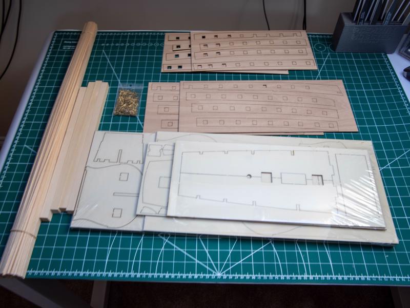

As mentioned, i am buying this in Stages (never knew you could do that with these kits). This will help with storage, but does cost a little more than the full kit though.

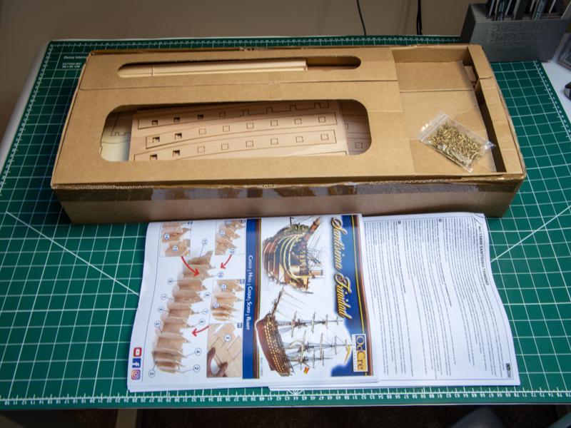

First impressions? The initial box is huge, and well packaged. Stage 1 comprises of 2 false keel sections, Keel brace parts, the bulkheads, 4 rib strengtheners (not in the MS version), pre-cut gun-ports, lower and middle decks, planks and a bag of pins. The instructions come in two parts: one full colour and the other numbered instructions.
So Far, so good ThumpUp

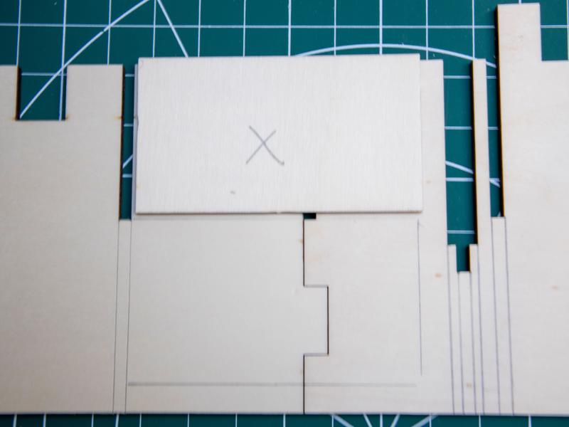

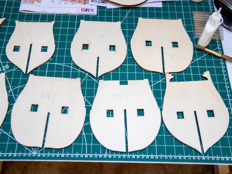

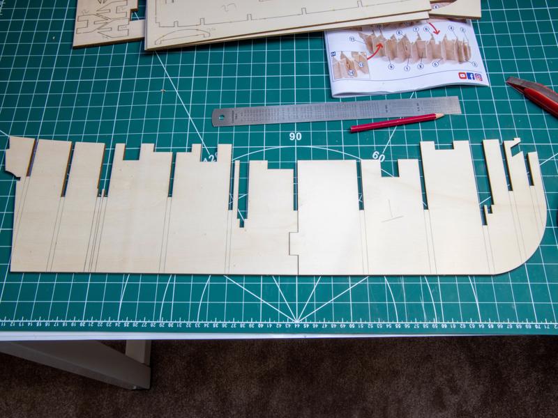

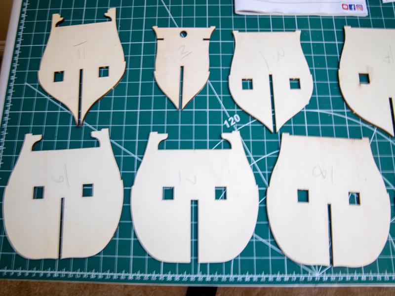

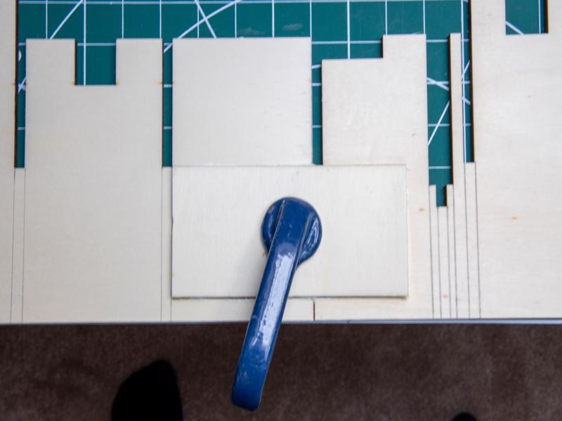

First job, remove all the bulkheads (hull formers) and false keel, clean up the edges and number the parts. The false keel is in two sections, again differing from the MS version.
Using a flat work surface, these are glued together and braced over the join on both sides.

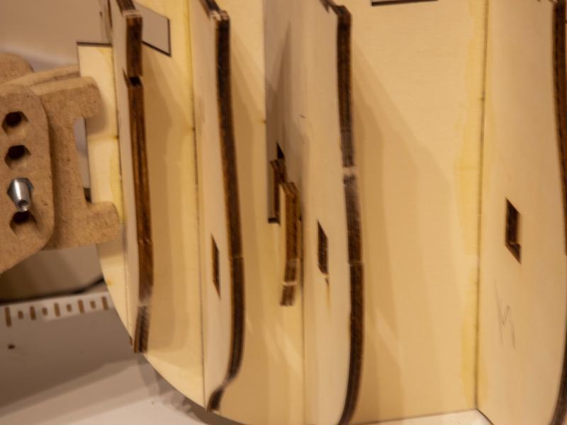

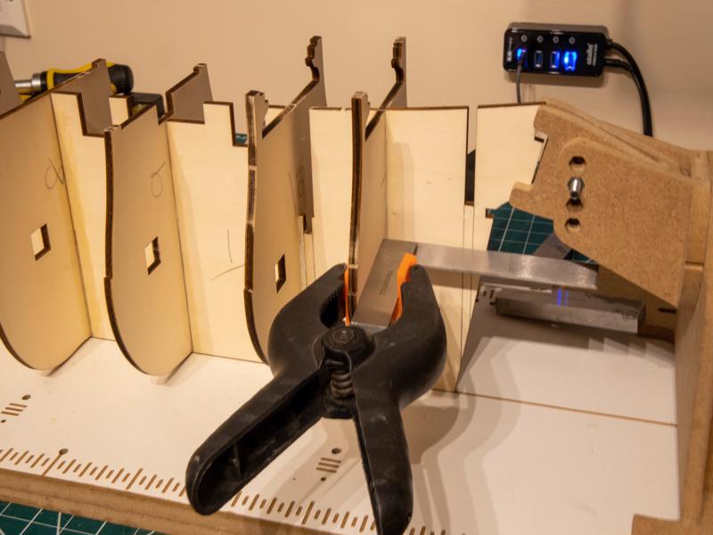

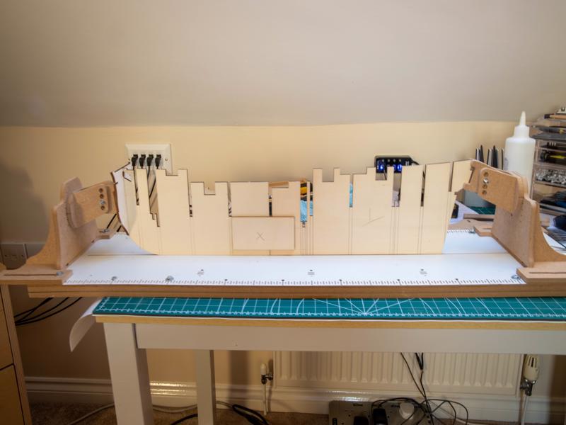

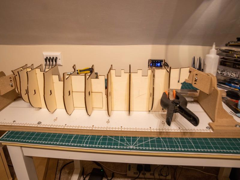

#9 Posted : 01 March 2021 22:11:50

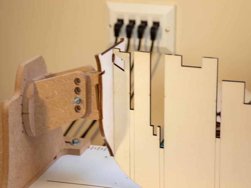

Next task is setting up my Hobbyzone jig, making sure everything is square. The hull formers are then sanded for ease of fitment, and glued in place.
Two things noticed here: no warpage on the keel, and the formers nearly all sat square without having to clamp to a set square! (oddly enough only the first and last former need squaring).
It is important that the hull formers sit suare to the keel, and seated fully into the keel slots, otherwise problems could occur later when fitting the decks.
Once the formers are dry, the mast and deck support braces are fitted.

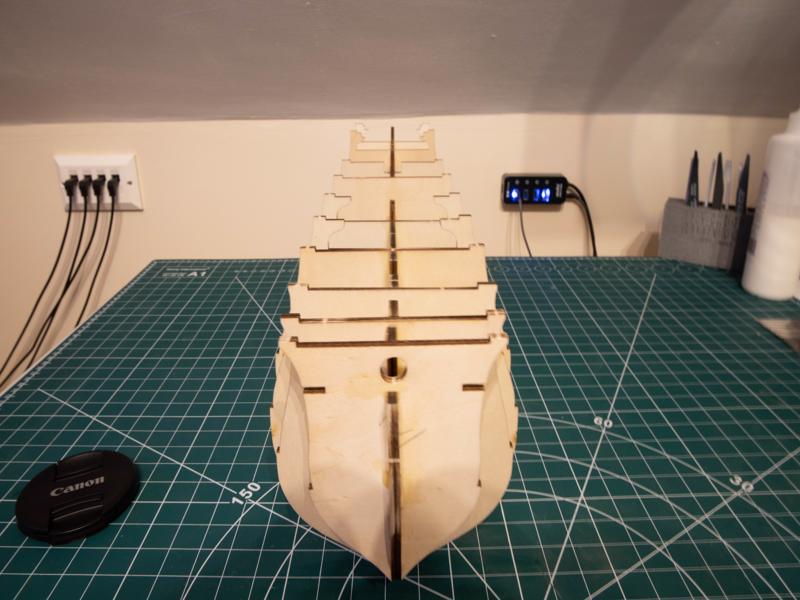

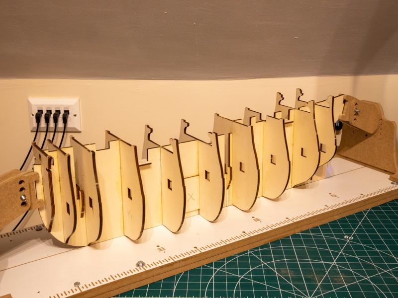

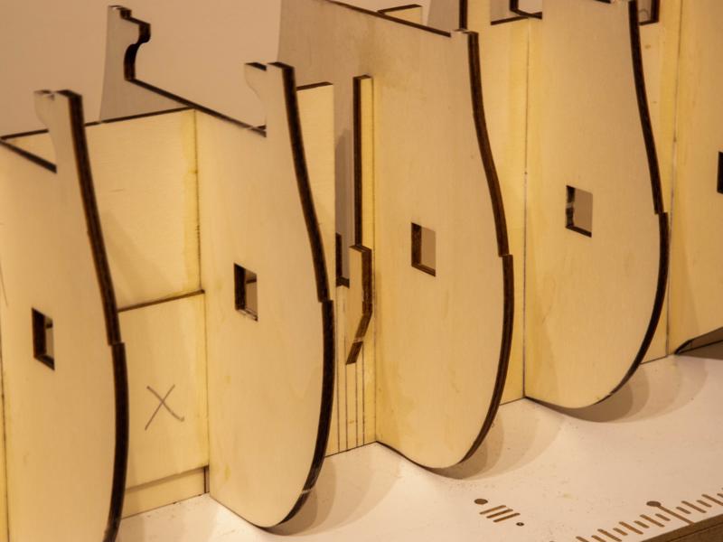

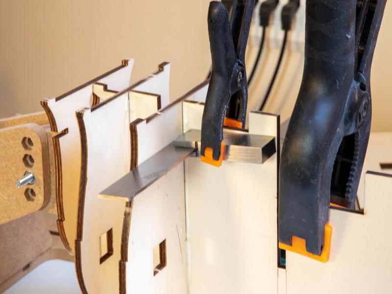

Just a small update. The first photo shows all the formers installed, and looking mightily straight ThumpUp.

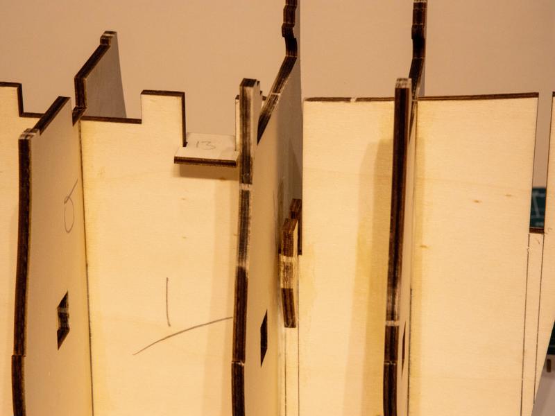

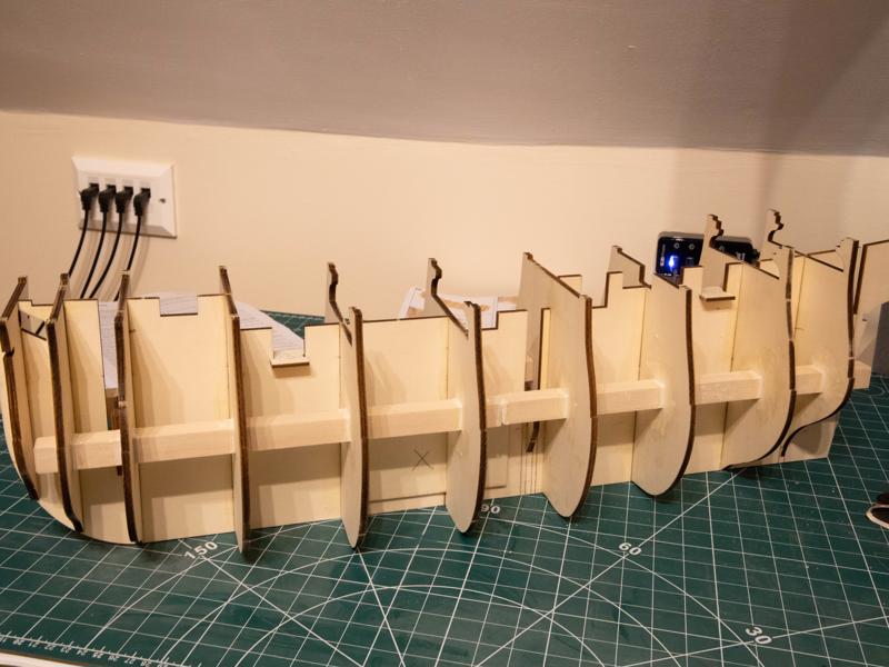

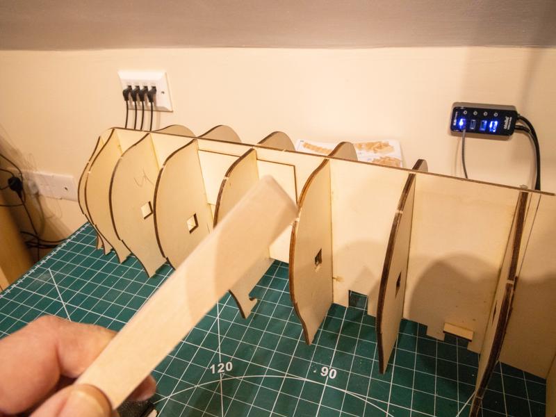

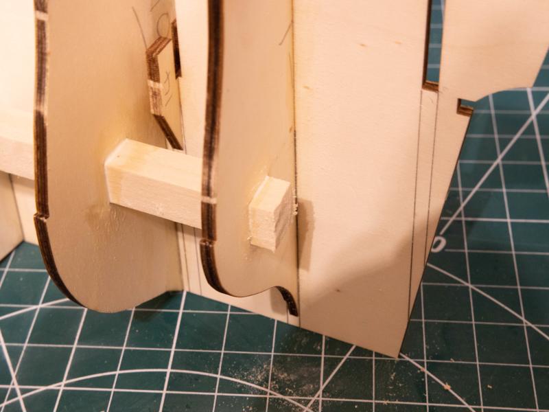

Next came the task of fitting the 'bracing beams' for want of a better word. Inverting the skeleton of the hull, the four beams are prepared to slide through the square holes in the hull formers.
TIP I thought it would make the job easier to give each beam a light sanding, and also to chamfer one end so it would slide through easier.
I superglued the ends of the two beams to hold in place, and then added glue where the beam and formers touched. This was repeated for the opposite side.
The beam in situ looked too long to me, so , fearing it would interfere with the hull planking, i removed about 2cm from the stern end.
