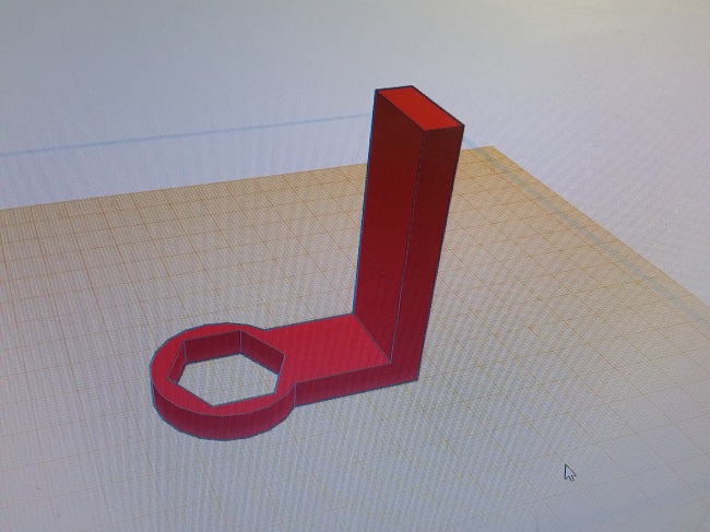

The light bulb moment as far as my design skills are concerned came when I looked into the 3D design programme by "Tinkercad". They have on site lessons in how to 3D design and its FREE.Tinkercad 3D design
I have not got as far as printing yet, but the basic design process I now have sorted, (nothing technical yet).
So my first design after a few hours schooling on Tinkercad is a specific use spanner for tightening the afore mentioned valve to the barrel lid. (See attached pic).

Pic 1: A spanner for an application specific for a need of my own.

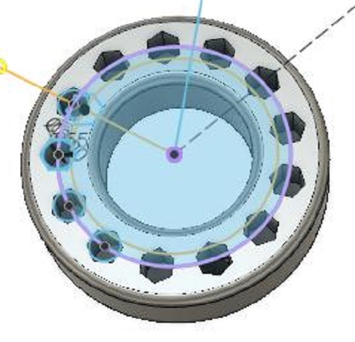

Then decided that something a little more complex was needed in the form of a drill stand for thirteen drills that once out of their packing ended up rolling around in a drawer. To that end I moved onto "Fusion 360" which is a more refined design programme with more functions.
Pic 2: Drill stand for 13 drills with hexagonal end fixings.

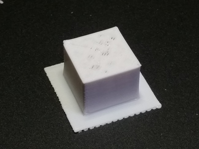

Today I started to attempt to print something. Designed a basic cube shape.
20mm by 20mm base with a height of 15mm just to be different.LOL LOL
Now it did print, but I think the settings need some adjustment (working on that) as the shape grew taller it reduced in size by 1mm in the last 10mm of height. Cursing Cursing Cursing
I think its the support structure that needs changing, any advice would be gratefully accepted. Cool
Pic 3: The first print off my IDbox after numerous years. Blushing Blushing

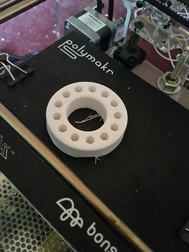

Not one to give up too easily, today I tried a print on the IDBOX of a larger item, the drill stand I designed on "Fusion 360".
Now this was a basic print without raft or brim so I expected an issue or two, but it will give me something to work on when the new printer arrives.
Pic 1: shows the finished print still on the print bed.
Pic 2: shows the underside of the print. Blink Without a heated bed and no raft/brim its not flat, but for a one off print it could easily be sanded flat.
Pic 3: shows the finished print. Not bad for what its meant to do except, when I designed the print I gave it exact dimensions. The drill bits would have fitted perfectly had I made the hexagonal holes 0.1mm larger. I now know for next time.LOL LOL LOL
In preparation for the new printer, I`m going to design something with just one hexagonal hole to check out the sizing.

There is always an issue with tolerance with 3d parts.if you make 2 parts that are supposed to fit together maybe with a alignment peg like in a plastic model you would think that would be easy.However, when you design the pars in your CAd software they fit fine, but when you print the parts they dont fit.There are several reasons for that.Firstly,especially with FDM printers you may get some oozing of plastic into the hole. Secondly as each layers prints you may get misalignment of the layers so the hole is not perfectly formed.Finally there is the issue of tolerance. When you look at the parts in your CAd they slot together
perfectly, but in real life there needs to be a slight gap between the 2 parts for them to join together.So if you are designing parts you need to allow some tolerance.Either you can make the peg a bit smaller than the hole in my example or the hole a bit bigger than the peg for them to fit together.how much of a gap you need varies from part to part and sometimes it is a bit of trial and error.

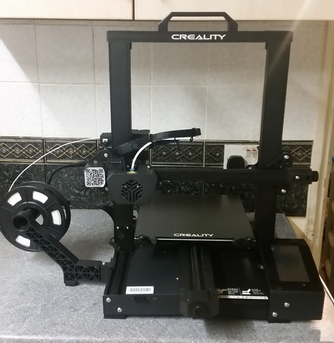

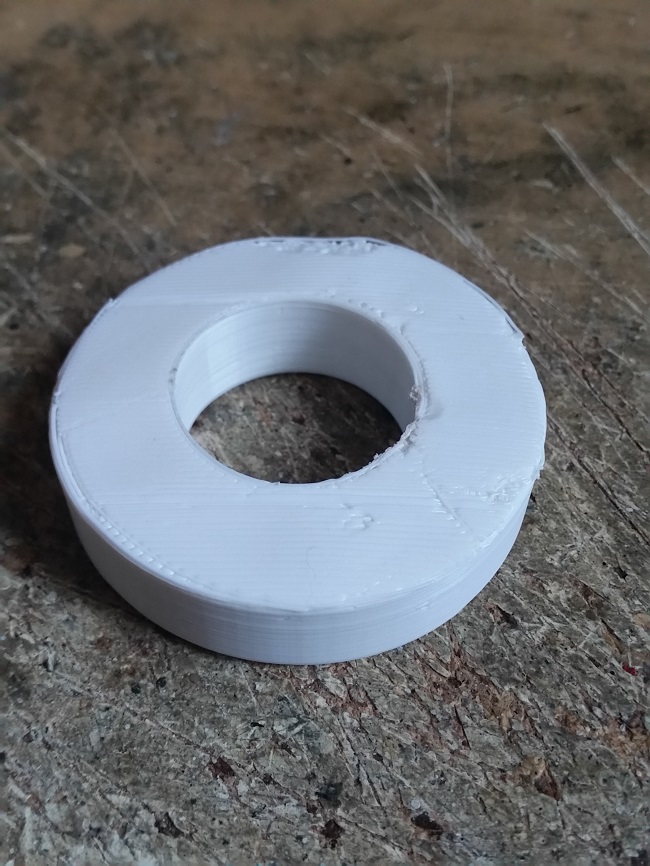

Well my new printer arrived a day early, but I`m not complaining. LOL
A little confused as I received an email from UPS at 11:42 today saying delivery tomorrow and the tracking said item still at Tamworth after 3 days, then at midday a knock on the door and there was my printer.ThumpUp ThumpUp ThumpUp
So after some faffing around, uploading more up to date software I managed to get the first print.

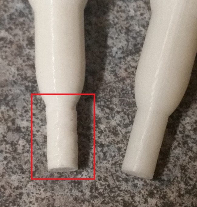

Below I`ve attached two pics:
1: The new printer
2: Old and new print of the top of the same item. Old pic on the left, you can see the errors over the new print on the right.
I don`t think that all the errors are down to the IDbox. Possibly settings, quality of filament supplied and/or both plus me at the controls.LOL
Anyway I`m a happy bunny.

Razz Are those skittles you’re printing LOL BigGrin LOL
That new printer looks a right weapon.
#19 Posted : 01 March 2021 23:19:09
No, not skittles LOL . Just a small 6cm high little tool for replacing seals on a valve. Without the tool I managed to get two in place out of eight (six split).

Very nice Derek. Love Love . It is a great little printer, I’m extremely pleased with my purchase as you know.
