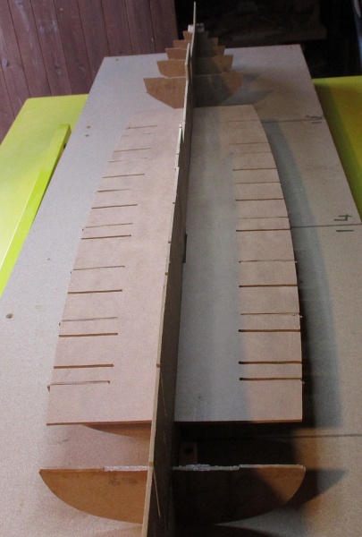

Looking for an aid to constructing the hull of SMS Scharnhorst I came across her sister ship SMS Gneisenau.
The construction of this model is slightly different as the upper frames are off set to the lower frames.
Love She still has all the cool lines from the armour belts and decksLove

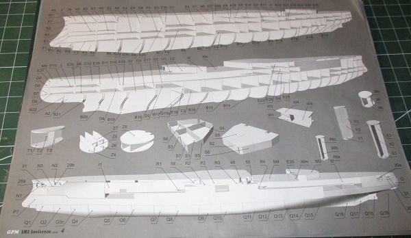

Noticed that they have supplied templates on each side of the lower frames thus making it easier to "plank" the gaps in betweenCool
Making a start

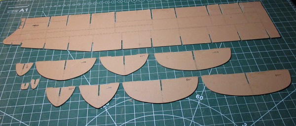

Enlarged the templates by 200% on to kraftpaper giving a scale of 1/100.
The copier paper tray was set for Heavy 1 and went through without jamming.
Templates cut out and used carpet spray glue to stick them to 2mm thick MDF
Cut and sanded one half off the keel and some lower frames.
The slits were cut and sanded to give a smooth fit without putting any stress on the keel
Plenty more to go
Thanks for lookin'

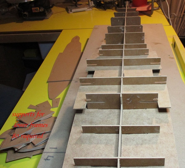

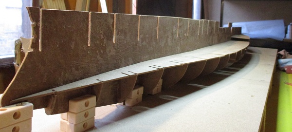

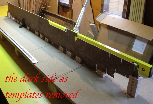

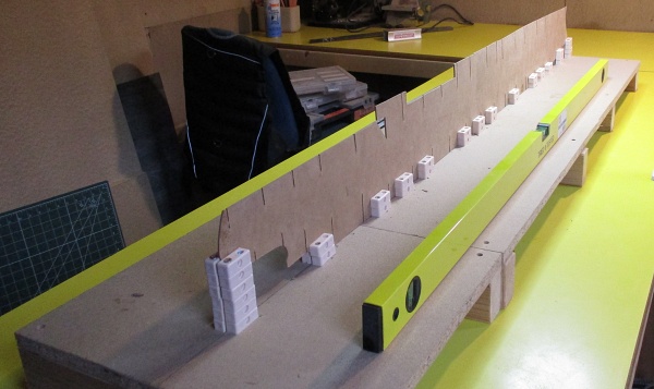

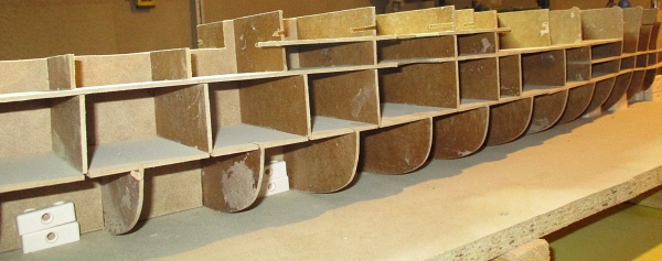

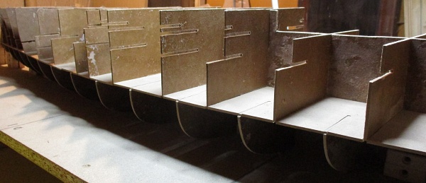

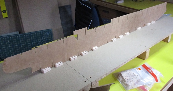

Anyhoos...There are tabs on the lower hull frames which slots into a false deck (if done properly LOL )
This should keep everything square..ishCrying
Thought it still best to make some kind of build board come jig to hold things together to start with.
Removed the card template from the mdf
The keel is in 2 parts not glued together yet
Thanks for lookin'
budgie attached the following image(s):
#7 Posted : 14 November 2020 17:36:12
Hi off to a great start, look forward to following your build. Cheers mick.BigGrin
#8 Posted : 14 November 2020 20:42:08
Good steady progress as usual from you, looking good....Cool Cool

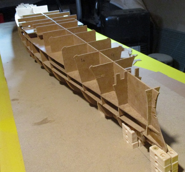

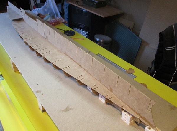

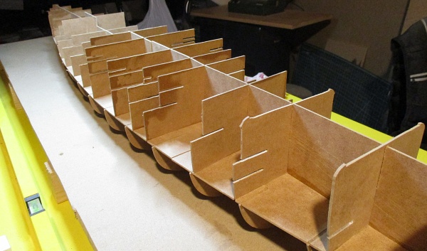

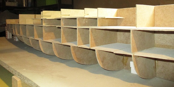

Lower hull frames cut out and inserted into keel
Nothing glued as yet
I want to get as much slotted together first to see how it all comes together and sitting nice n straight

#12 Posted : 17 November 2020 00:15:01
Looking good Budgie and she looks like she's going to be a big un....Cool Cool Cool

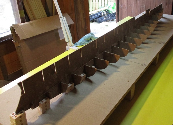

budgie
#13 Posted : 18 November 2020 10:26:36
Joined: 20/03/2010
Posts: 1,199
Points: 3,473
Location: Glenrothes
BigGrin Morning' Folks

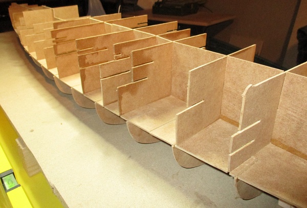

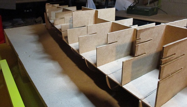

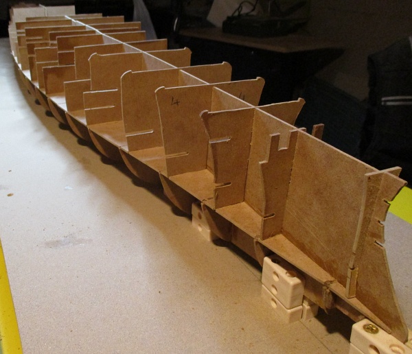

False deck loosely dry fitted with lower frames in their slots
Nothing glued at moment (darker patches are glue stains from the templates)
Off to cut out the upper frames
#14 Posted : 18 November 2020 10:34:34
Hi Budgie, BigGrin
This a monster build in that scale and looking good. Cool Drool Cool
Good luck, its an interesting project that I will certainly be following.

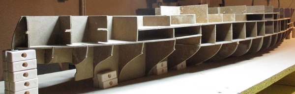

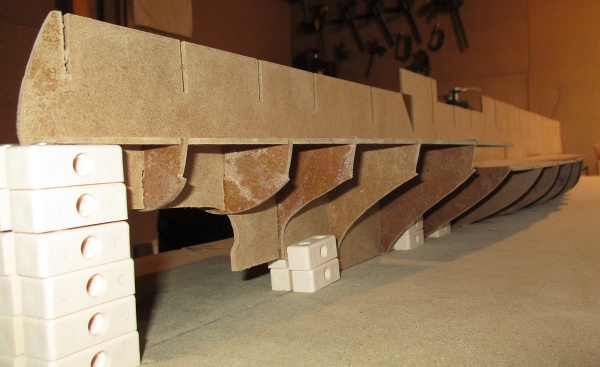

BigGrin Hi Derek
the real ship was 144meters long my attempt at 1/100 scale should be 144cm
#16 Posted : 18 November 2020 22:13:59
Love Just love how this is going together ThumpUp
And the use of those blocks is genius BigGrin
#17 Posted : 18 November 2020 23:39:53
Great update Budgie. Coming along nicely and at that size hope you have a massive shelf for it to sit. LOL
#18 Posted : 19 November 2020 08:59:28

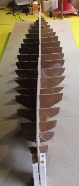

#19 Posted : 20 November 2020 18:15:37
Joined: 20/03/2010
Posts: 1,199
Points: 3,473
LOL LOL Thats awfully optimistic of you Chris, thinking that I may require a shelf with my track recordLOL LOL

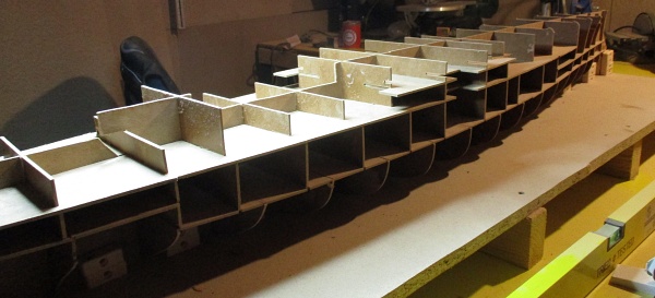

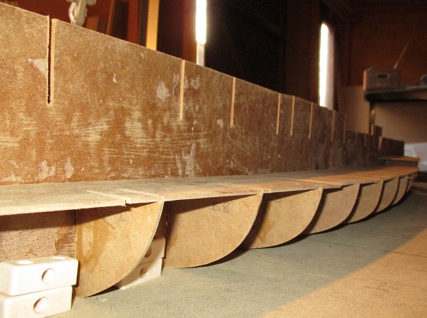

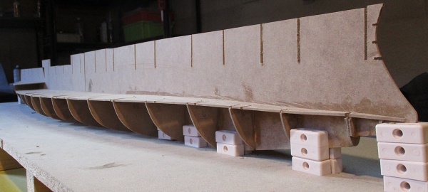

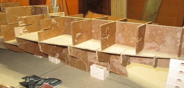

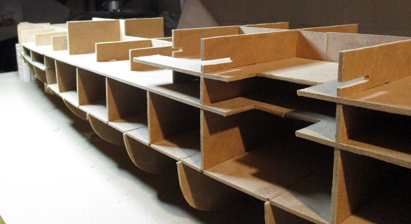

Anyhoos Folks
some pictures of progress before I start dismantling her.
Nothing has been glued yet but I think it best to strip her down and get some glue and supports on the lower frames
This will also give me a chance to see if I can redo a couple of them.
The ones that have wee pointy bits for the thin line that runs along the hull
Thanks for lookin'
#20 Posted : 20 November 2020 18:21:35
Posts: 6,970
Points: 21,217
Looking good, that is quite some size.Drool You could almost get a mini champagne bottle to launch her with once finished.LOL
