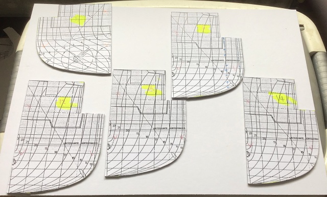

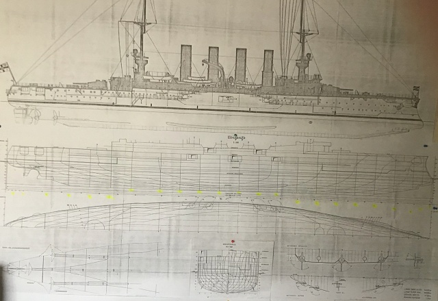

1/2 templates cut out.
This is the max width so they will need to be reduced by the planking thickness I decide to go with before making the full templates.
Not sure how that goes for frame 22 the one at the pointy end as it is tiny already
(Frames are numbered 1 at the stern working up to 22 at the bow)

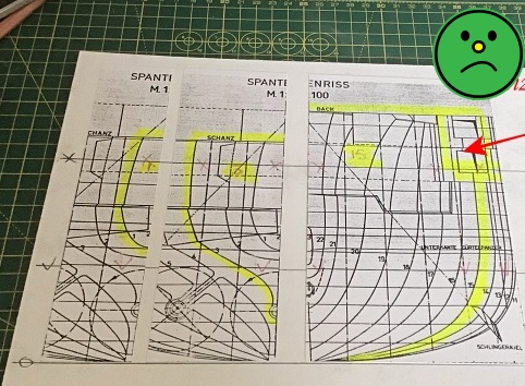

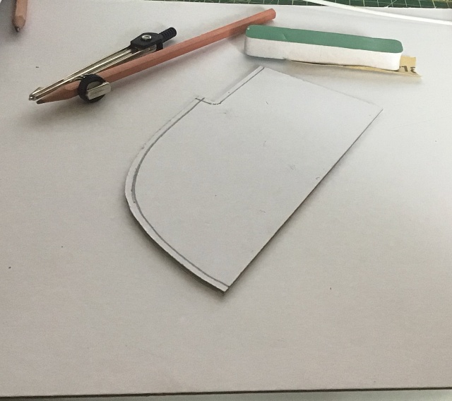

How much to reduce the frame by to compensate for the planking was decided by the minimum width of my compass used to draw round the frame. 3mm thats double planking with 1500micro card a bit off for sanding and a layer of craft card.
Sounds like a planCrying
I was thinking about ply or MDF but it will be too thick for the bottom of the frames at the pointy end so will lose the shape.
As my last attempt at trying to build a hull out of card ended up being very solid and surprisingly heavy (just misshaped at prop areaCursing but can be used as fuel for the log fireCool ) thats the way I will go.

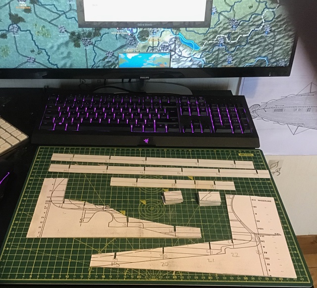

I am using 2cm high card for the keel between fore and aft
I have not cut out the shape of the bow and stern bottoms as I will feel more confident that those parts are definitely touching the straight line on the build board.
Cheers
ps thats Strategic Command WW1 on the pc, can play with model while waiting for the AI to make up its mindLOL

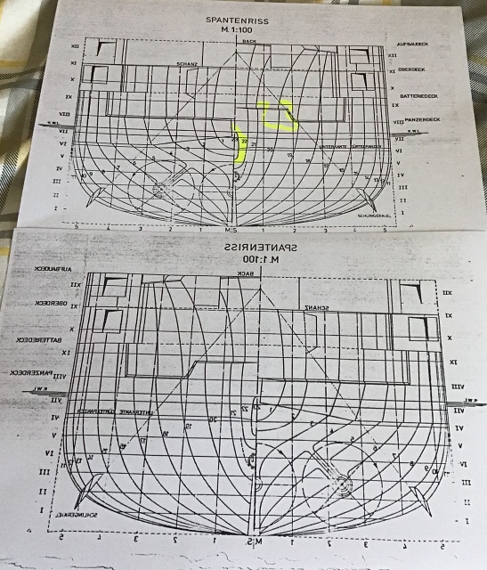

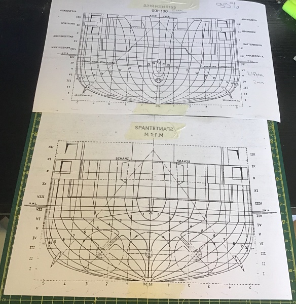

Progress is a lot slower than my last attempt (so it should take longer for me to ******* it upFlapper ) as I have been taken off furlough for the past 3 weeks
I was making the templates as per guidance from what I found on the web
Body plan only gives 1/2 a frame
Make template for the 1/2 frames
Place on card draw round outline of the 1/2 frame flip it over and draw round frame
As there are body plan lines on one side only ,flipping it over on to the reverse side is blank
Is it lined up properly? Looks OK (don't get called Mr Magoo for nothing u knowFlapper )
Not even trusting my self to draw a straight line at the moment let alone curves and diagonals had to rethink this
Those frames will determine the shape of the hull so I need to feel confident that I have done this as accurate as I can
Cool Going to redo the templates by printing out as normal but at 97% to allow for thickness off planking then print off choosing mirror image
This will allow me to join the 2 1/2s up more accurately with reference lines on both sides
Sounds like a planLOL
Will get to a copier tomorrow and see how it goes
Thanks for lookin'

as there are 23 frames 1 took 50 mirror copies to allow for errorsLOL LOL
Crying On hind site if I had taken my cutting ruler and scalpel with me I could have made 2 masters by joining the normal and mirror sides together first
Then photocopied them to give a full frame copy. Hey Ho

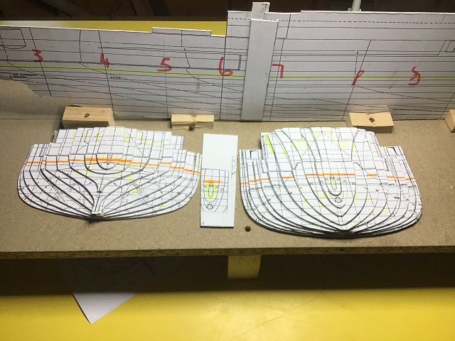

Been humming and hawing over these templates unable to commit to the best way forward especially as they also represent where the armour plating, panzerdeck, batterie deck etc go
Cool Copying the body plan and joining the mirror image to give a full template was a positive
Copying those templates at original size would be good, but realising I would add several mm to both sides with the planking not so good
Using a compass to reduce the sides and bottom of the templates and cutting them again not so good as this could in my hands mishape them causing the planking to not touch the edges or be too high plus I would need to at least Crying Crying double plankDrool Drool
Reducing the master on a copier would be cool but it also alters the height
Decided in order to move forward I have copied them at 99%
This reduces the template at the sides and top to bottom by 2mm
The planking I will be using is 1.5mm thick. So thats only a mm thicker but after sanding and adding the thin kraftcard should be acceptable.
The height can be corrected by adding a false deck at the waterline as in card models splitting the templates in 2 halves
The shape off the deck can be taken from the 1/2 breadth plan with again a mirror image
Flapper Sounds goodFlapper

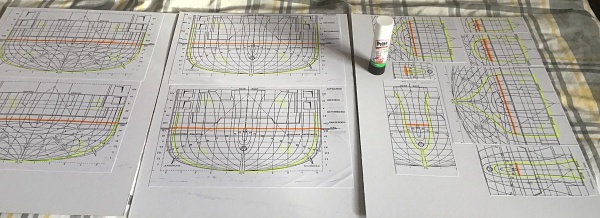

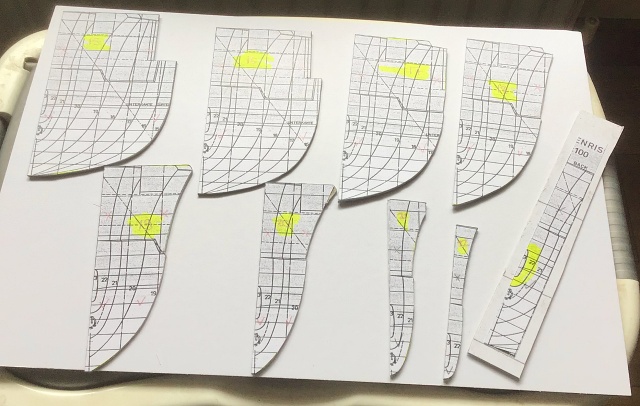

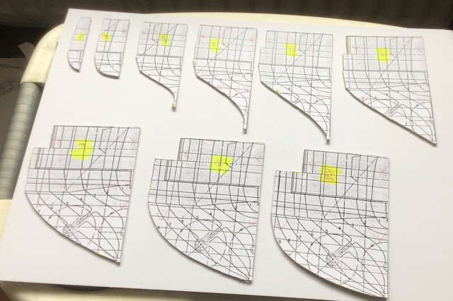

Had a slack day today so made the decision and stuck all the card templates to the mount board
Pic shows some of them
The yellow highlighter shows where I have to cut out the shape of the frames
Some of them are not completed all the way round as I am not yet clear as to which way to follow the lines above the quarter deck .
Depend if I plank the hull all the way up then cut out the "gun ports"
Will decide later when it hopefully becomes clearer on a dry fit of the frames
The orange line is where I will half the template with a false deck in-between
Thanks for lookin'

#14 Posted : 27 May 2020 22:14:34
That looks a very complicated but at the same time interesting project.
So those pictures you have do they represent all of the ships frames piled 1 on top of the other?
budgie
#15 Posted : 28 May 2020 05:38:12
Joined: 20/03/2010
Posts: 1,199
Points: 3,473
Location: Glenrothes
BigGrin Morning Tony
Thanks for looking
Yes that’s the frames lying on top of each other
It does look complicated with all those lines and all the same colour

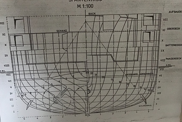

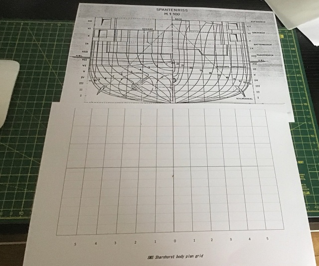

This is how I understand it
The Original body plan only shows half the frame
The horizontal base line along the bottom of the grid is your reference point for taking measurements
There are vertical grid lines numbered 5 to 0 to 5 and where the frame lines touches those lines you can measure with a ruler or divider and mark the spot on the opposite side of the grid.
Join the dots with french curves and you then have a full frame
The horizontal lines are the waterlines and deck lines the distance between each one can be different
Again you can take measurements from where the frame touches those lines by measuring to a vertical line
You could also just fold the paper in half and cut out the half frame open the paper up and you have a full frame
I feel that using the mirror image option is more accurate
That way I can blame the photocopier rather than my ability LOL LOL
I've probably made my interpretation of the body plan more confusingCrying but I have lots of spare copies I can highlight the lines etc to make it clearer
Need to go to work just now so can do it later if anyone is interested

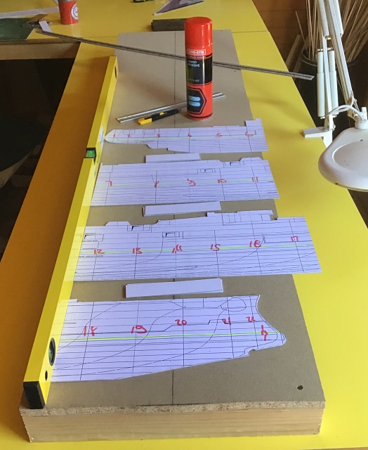

Finally got my finger out after a lot of humming and hawingCrying

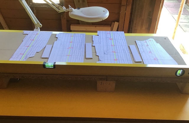

copied sheer plan and used a fine mist of carpet spray to stick to the 1.5mm mountboard
I have left some superstructure outlines on at the moment thinking it will be easier to remove rather than add if required for moving forward
budgie attached the following image(s):
