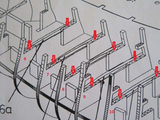

A question regarding the build of the 'Mary Rose' from Caldercraft.
Searching the forum, I find only one build diary - dated June 2010 !! And it is (was?) only 4 entries long … At least there is a photo of a completed ship.
However, that does not answer my question. I am more used to seeing the detailed instructions from Deagostini with good photos etc. Unfortunately for me this build uses plans (8 x A0 sheets of paper Crying ) with not-clear detail and brief 'Builders Notes'.
'Cut out and glue the lower deck camber beams into place using PVA wood glue (DRAWING D), parts 6a, 7a, 8a, 9a & 10a,) Use crocodile clips or clothes pegs to clamp the beams in position until the glue has dried.'
Problem being - where to place the beams.

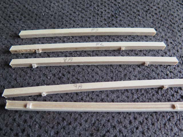

suey attached the following image(s):

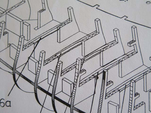

So to continue the story, next picture will be a close up of 'DRAWING D' and my model as it stands so far.
The camber beams are far too long to stand on the deck supports (just above the 'dummy barrel blocks'). The only way that seems to fit, is to place alongside the bulkheads, at the level of the deck supports. Only I do not think much of the diagram detail and not certain this is what is intended.
Can someone with building plan experience advise me please?

#3 Posted : 25 April 2020 17:45:14
Hi Suey, BigGrin
I have adapted your pic of the plan (attached below)
The parts 6a - 10a look like curved deck support beams so looking at your plan it looks like they sit on the ribs between the vertical extensions.
Have a look at the numbering of the ribs in your instructions and see if they match the numbering I have put on the pic.
Check them all for fit before you go anywhere near the glue.
Hope this helps.

You and me both, would expect the camber beams to sit on top of the frame. Hurried photo.

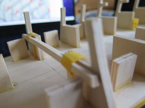

This is frame 6 with the associated camber beam loosely taped to the forward face of the frame. Although it isn't centred properly, I think you can see that it is too long to fit within the bounds of the verticals.
Not so obvious with frame 6, but more so with frame 9, which has a more angled tumblehome. The ends of the camber beams match the outside face of the frames very closely. Hence my supposition that the beams should be placed alongside the frames, at the level of the main deck supports. To fit on top, I would have to saw every beam from both ends to keep the symmetry of the camber.
This might also account for the use of crocodile clip/clothes pegs to clamp the beams. I don't see them being much use if sitting on top of the frame shoulder.
Any opinion?
Regards Sue

#5 Posted : 25 April 2020 20:45:46
Hi Sue, BigGrin
Having seen that latest pic, it makes sense what you have said and done with frame 6 and the use of clamps of some description.
The lines depicting the beams look like they have been put on freehand as an after thought and very badly.
What I would suggest is to clamp the beams in place from the outside of the ribs and see how the deck fits.
I hope the rest of the plans are better to make your life easier.
Looking forward to seeing more of your build here as you progress.
Good Luck.BigGrin
#6 Posted : 25 April 2020 22:20:45
Hi Sue
One way to check if the beams are fixed to the sides or on top is to dry fit the deck that goes on top of those beams. If the cut outs that line up to fit the frames with the beams along the sides then you have your answer.
If the cut outs on the deck parts are not fitting that way try doing the same thing but with the beams on top of the frames to see if they fit that way.

You're right.
Those beams sit next to the bulkheads, and not on them. Here's my hull...

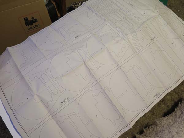

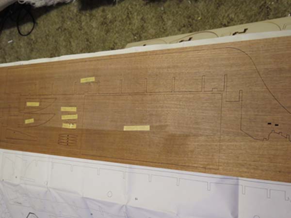

Bit back I promised to run build diary from beginning. My photo editor is on a different PC, so fun resizing & moving images to this PC. So here's first few images.
